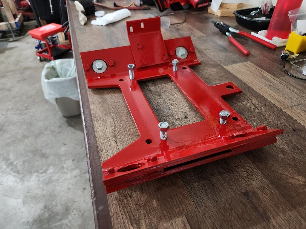

Racinbob 13,111 #17 Posted December 23, 2024 There will be speed bumps along the way but nothing that can't be easily overcome. I'm not dealing with swapping a wobble engine with a solid one but it does show me what some of the issues could be. Here's the wobble plate for the Dino C121 I'm currently working on. The main thing is the elimination of the rubber mounts. You can see how I did that. There are things on the engine that have to be supported from the mounting plate and not the frame when the wobblesolators are used. Note the lower PTO loop and muffler supports. Not important on a solid mount conversion but it makes a difference with a conversion like you're doing. In your case I would think using mounting bolts and spacers to mount the engine directly to the frame would be best. You can't just make a spacer plate because there's a protrusion on the bottom of the oil pan that drops down in that rectangular opening on the plate. The oil drain is tapped into the bottom of that protrusion as well. With the four bolts and spacers holding the engine at the correct height you should be able to use the original frame mounted brackets from your 1975 for the bottom of the PTO loop and your original loop will work. If I would have had the correct PTO parts from a solid mount tractor I would have gone the four bolt method but I had the parts for a wobble mount and decided to make things work. Simply buying the solid mounts that are available would have been easier but not as much fun. I realize my situation is different from yours but I hope this helps with your thought process as you ponder what you need to do. 1 Share this post Link to post Share on other sites
fourwheelhorseman 362 #18 Posted December 23, 2024 2 hours ago, Racinbob said: In your case I would think using mounting bolts and spacers to mount the engine directly to the frame would be best. You can't just make a spacer plate because there's a protrusion on the bottom of the oil pan that drops down in that rectangular opening on the plate. I have not spent much time on it yet, still in the planning process and will most likely get on it after Christmas,I had thought about starting with 1/2” spacers to see if that was enough. I’ll have to measure the holes on the block vs the holes in my frame to see if I’ll have to drill any extra holes. I had not taken k to consideration any PTO mounts.. thanks for the heads up! 1 Share this post Link to post Share on other sites
Racinbob 13,111 #19 Posted December 23, 2024 28 minutes ago, fourwheelhorseman said: I have not spent much time on it yet, still in the planning process and will most likely get on it after Christmas,I had thought about starting with 1/2” spacers to see if that was enough. I’ll have to measure the holes on the block vs the holes in my frame to see if I’ll have to drill any extra holes. I had not taken k to consideration any PTO mounts.. thanks for the heads up! Pondering points was the reason for my post. It's well spent time. First, basically ignore the four 3/8" bolts sticking up through the plate with the loose nuts. Those are there only to keep the plate up off the workbench as the paint cures more. I can't get you a precise measurement for the thickness of the spacers because I ran into an oil drain clearance issue. Since it will be a few days before you get at it I can get it to you by then. I'm going to say it's probably closer to 1". Better yet, maybe someone who has an unmodified wobble mount can measure it for you. 2 Share this post Link to post Share on other sites
fourwheelhorseman 362 #20 Posted December 23, 2024 51 minutes ago, Racinbob said: Pondering points was the reason for my post. It's well spent time. First, basically ignore the four 3/8" bolts sticking up through the plate with the loose nuts. Those are there only to keep the plate up off the workbench as the paint cures more. I can't get you a precise measurement for the thickness of the spacers because I ran into an oil drain clearance issue. Since it will be a few days before you get at it I can get it to you by then. I'm going to say it's probably closer to 1". Better yet, maybe someone who has an unmodified wobble mount can measure it for you. I’ve got the unmodified wobbler mount and planned on measuring it. I’ll take some photos and try and document my journey when I start. Thanks everyone you’ve gave me plenty to think on! 1 Share this post Link to post Share on other sites
Racinbob 13,111 #21 Posted December 23, 2024 Take a look at @Ed Kennell thread on his low rider. I just did and I would have seen it sooner. I like the way he modified the engine plate way better than what I did. To the point that I might just change mine. It still has the lower mount for the PTO loop and it's a clean setup. I don't think the front support for the muffler is needed on a solid mount engine. I don't have one on my other tractors. I'm thinking that the wobble mount shook so much that it was needed. It looks like he used 1/2" spacers plus the plate thickness. That's pretty close to what I thought. I don't think that +/- 1/8"-1/4" would be an issue. 1 1 Share this post Link to post Share on other sites
Ed Kennell 46,985 #22 Posted December 23, 2024 22 minutes ago, Racinbob said: . It looks like he used 1/2" spacers plus the plate thickness. That's exactly what I did Bob. And the only reason I raised the engine 1/2" was due to the oil pan hitting the steering shaft. I didn't need a PTO so I also cut the hoop bracket off. Using this plate with spacers would allow total XYZ positioning of the engine to match the belt guard location. 2 Share this post Link to post Share on other sites

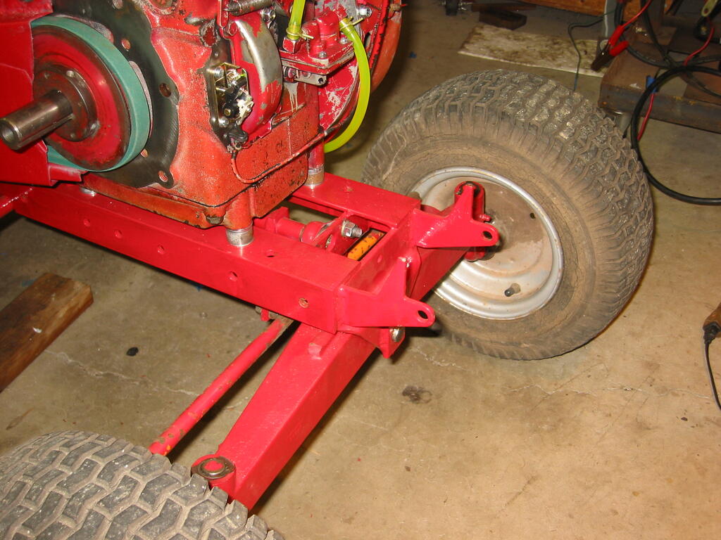

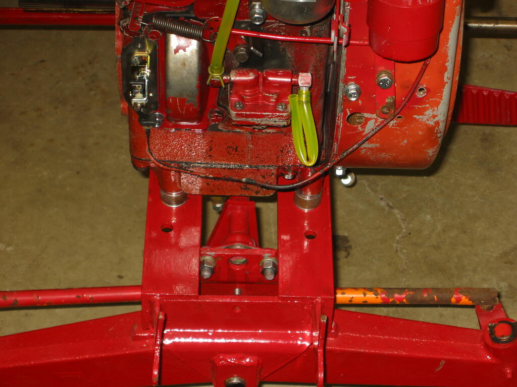

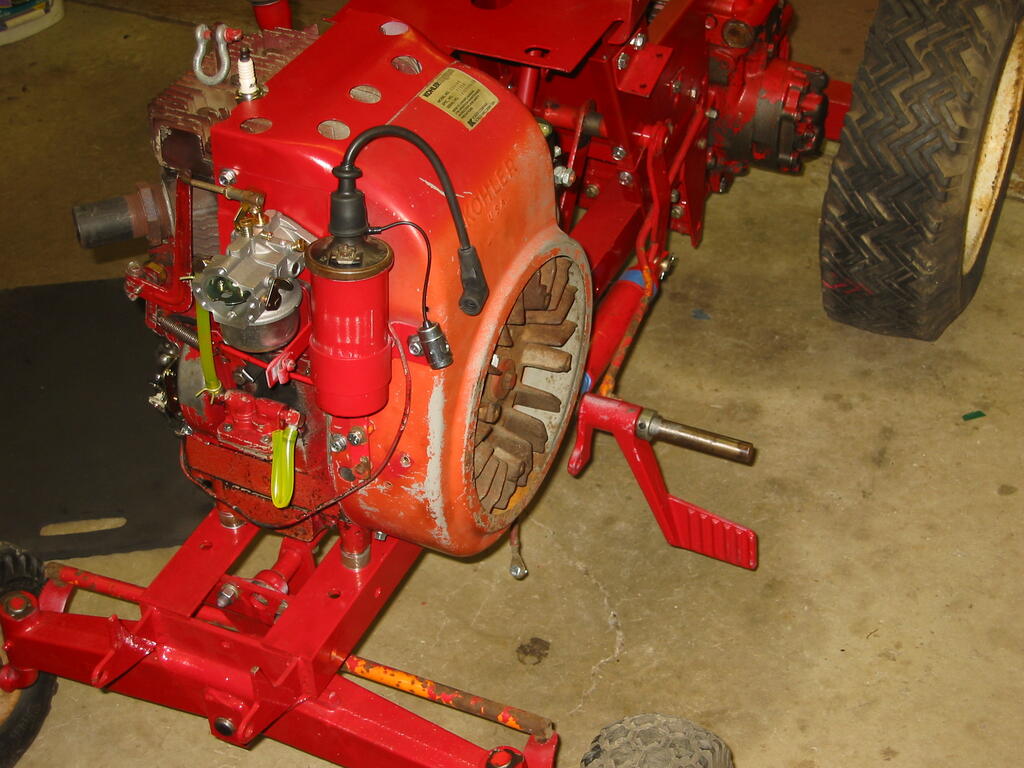

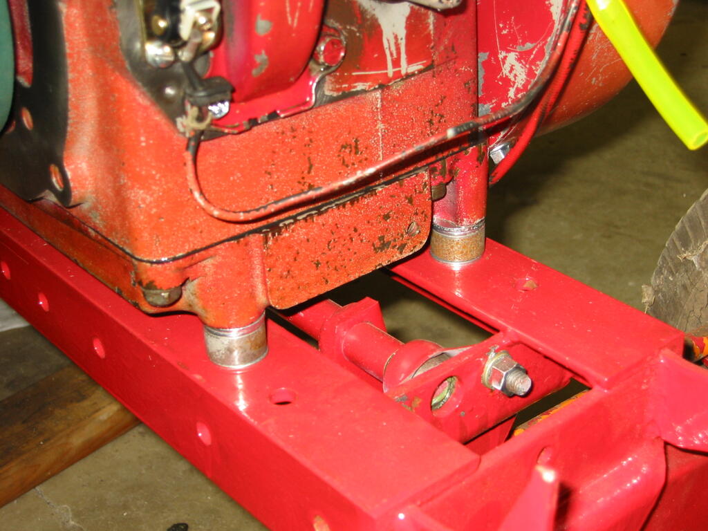

pfrederi 21,048 #23 Posted December 23, 2024 Really simple I put a shaker mount K-341 engine directly on a Charger frame. Just need 4 spacers and a couple washers. I think I had to drill two holes (front) in the frame. The drop down part of oil pan fits between the frame rails and is above the steering shaft, Also have to get a piece of angle iron to make the bottom mount for the PTO hoop. 2 2 Share this post Link to post Share on other sites
Racinbob 13,111 #24 Posted December 23, 2024 57 minutes ago, pfrederi said: Really simple I put a shaker mount K-341 engine directly on a Charger frame. Just need 4 spacers and a couple washers. I think I had to drill two holes (front) in the frame. The drop down part of oil pan fits between the frame rails and is above the steering shaft, Also have to get a piece of angle iron to make the bottom mount for the PTO hoop. There you go @fourwheelhorseman He can give you the correct spacer thickness. All our talk about the PTO loop can be ignored since you have what you need on the frame already. 1 Share this post Link to post Share on other sites
