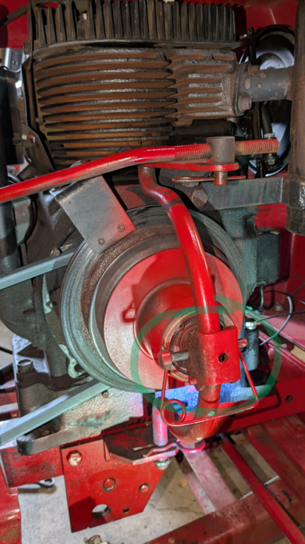

Alrashid2 468 #1 Posted December 20, 2024 (edited) Hey guys. Noticed for whatever reason recently that my PTO on my 312-8 is chattering to no end. I notice it most if I'm not at full throttle, and yes I can hear it through my earplugs! Sounds like a constant, high pitched rattling like someone tapping on a glass or cymbal. While running I grabbed the little pin and clevis that holds it all onto the crankshaft, it stops - so it's definitely those components jiggling around. Just wanted to ask if this is normal, any trick to tighten it up, and/or if I'm just being too OCD here haha. Wanted to make sure it wasn't a sign that my pulley was out of balance, or that I might have put together the assembly wrong. Thanks all! Edited December 20, 2024 by Alrashid2 Share this post Link to post Share on other sites

Alrashid2 468 #5 Posted December 20, 2024 interesting! So does the spring just put a hair bit of tension on the rod? I should have mentioned this only happens when PTO is OFF. If I push the rod forward and clamp the PTO to the clutch, rattling stops... Share this post Link to post Share on other sites
peter lena 9,764 #6 Posted December 20, 2024 @Bar Nuthin @Alrashid2 literal gold mine for improvement , in that very sloppy area , did that years ago it starts at side of battery tray mounting area , eliminate the 1/2 " of play with metal / plastic washers , silicone grease , correct as you go ! that rod end can easily be threaded over with a , fine thread die nut to match a threaded heim joint female fitting , also the swing arm going to the pto , engagement area , slide pin clip , can be lightly extension spring retained to the lower end of swing arm retainer clip , stops noisy buzzing . this is basic improvement stuff , eliminate the problem , no noise or failures since change over , pete 1 Share this post Link to post Share on other sites

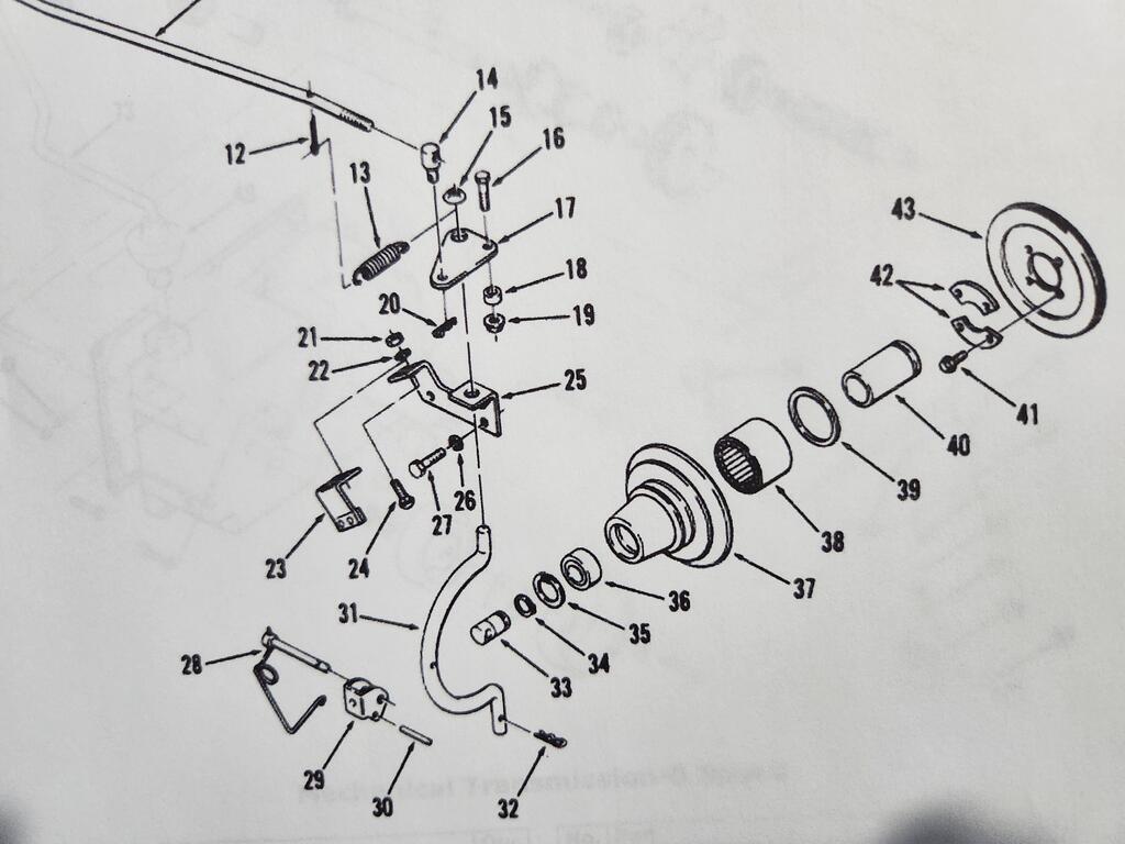

Alrashid2 468 #8 Posted December 21, 2024 Thanks @peter lena! I'll look at it tonight - more tinkering... I better be careful this time! @8ntruck I think I saw an old parts diagram online that showed that! Unfortunately, at the time I compared it to my 312-8's diagram and it looked like it wouldn't work for me. Wonder why Wheel Horse did away with the spring setup? Share this post Link to post Share on other sites
peter lena 9,764 #9 Posted December 21, 2024 @Alrashid2 personally do not understand the problem / and cure starring right at you , that slide pin clip that connects , the swing arm to the PTO CONE assembly , is mounted backwards. the left lower corner spring wind circle , should be on the right corner side , then a light extension spring , goes from there to lower , hitch pin clip swing arm , tying it all together , stopping vibrating noise . on the other hand , doubt that the pto cone , has ever had a inner needle bearing hi temp grease application , that also has to be very light , or it slings to clutch face , the outer bearing is sealed , napa has it , probably noisy and rough . replace it . wheel horse was always minimal at lonnection areas . also changed out that lever rod end TRUNDLE, for a female heim joint , smooth . solid .quiet . look at my improved lever action picture , of the improved . washered up lever start point , no noise or vibration , easy , pete Share this post Link to post Share on other sites

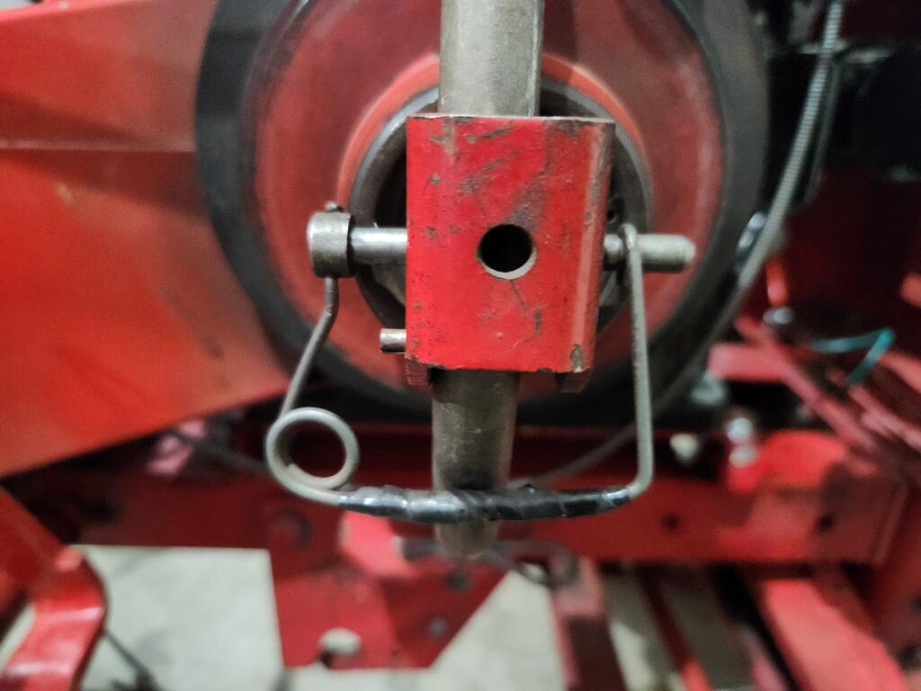

Racinbob 12,765 #10 Posted December 21, 2024 @Alrashid2 There's no need to reinvent the wheel on a PTO setup that had worked great for decades and, in my opinion is the best one Wheel Horse has ever used. That hitch pin will rattle with the PTO disengaged. It stops when you engage it because that puts tension on it. I noticed that on my 1976 over 45 years ago. It was annoying. Digging deep into my rocket scientist, engineering brain surgeon type noggin I came up with this complex fix. That was supposed to be an experimental temporary fix to see if it worked. I did that in the 70's. Annoying rattle gone. Go figure. An electrician using electrical tape. I did coat it with something but I don't remember what. I'm still experimenting though. I'm testing the lifespan of the complex fix. +/- 45 years and counting. . 1 2 1 Share this post Link to post Share on other sites
Racinbob 12,765 #11 Posted December 21, 2024 Your hitch pin is correct but it really doesn't matter what direction it's put in. There is a spring (#13) but it's connected to the pivot plate to the rod and won't do anything about the pin rattle. I don't use it. Share this post Link to post Share on other sites
peter lena 9,764 #12 Posted December 21, 2024 @Racinbob looking right at it , notice the lower HITCH PIN CLIP , at lower swing arm mount ? turn the upper pin around so the hole is on the same side as lower hitch pin clip , connect with an extension spring , holds a perfect , silent tension , just a little tweak , its the sloppy connection rod ,about 1/2 " of washers , start fit on the trunnion mount point , and side of battery tray that adds to noise and irregular movement . finish with a die nutted fine threading , female heim joint , and its ridiculously smooth / silent / effortless, all 3 of mine , silently in use for years , only if you want to , pete 1 Share this post Link to post Share on other sites
8ntruck 8,602 #13 Posted December 21, 2024 I'll add a couple more comments here: Spring pin #30. The proper part here is a spiroll pin. This is a spring pin that is two layers thick, instead of the typical hardware parts drawer spring pin that is only a single layer. The single layer spring pin works for a quick fix, but will break sooner than the spiroll pin. A Toro parts dealer should be able to supply the proper pin. Hitch pin #28. Watch that the head on the hitch pin does not rub on the end of the clutch bell #37. When I got my C-195, the pto was inoperative. The clutch bell was bolted on the crank. Closer inspection revealed that the end of the clutch bell was worn down to the groove for the #35 snap ring. The only thing in that area to cause the wear is the hitch pin - or maybe the PO substituted an alternate piece of hardware that rubbed on the clutch bell. Whatever happened, the fix was to replace the clutch bell. Turns out that the pto on a C-195 is a cone clutch, not the common flat clutch - longer search time & higher part cost. 1 Share this post Link to post Share on other sites
Alrashid2 468 #14 Posted December 21, 2024 @peter lena looked over your post - very good ideas there! Unfortunately my rattling isn't from the lever - I've now realized the rattling is from Parts 29 and 31 in the diagram posted previously in this discussion. Not exactly sure how I could tighten that up other than adding more tension to the PTO lever which obviously can't do as that would cause friction between the bell and clutch. @Racinbob that is exactly what I tried yesterday! That's how I figured out it's not the pin so much as it is 29 and 31 rattling. Peter, great idea with the spring between the clips! Let me go look at that. Have to source a spring though.... I honestly don't use the PTO at all as I'm not mowing or blowing with this. I wonder if I could just remove the assembly entirely? I only use the PTO lever when I want to be able to manually turn over the engine to watch belt movement! Share this post Link to post Share on other sites

Alrashid2 468 #21 Posted December 21, 2024 So, I only had a few minutes to test this out, but came up with a simple solution! I zip tied the clevis pin to the swing mount. That tightened up the movemenr of the pin and little bracket piece and seemed to have stopped the rattling! 3 Share this post Link to post Share on other sites
