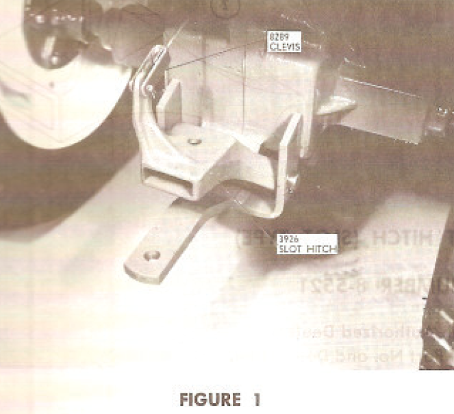

Bar Nuthin 3,246 #1 Posted December 18, 2024 I found an old slot hitch, which seems like it might be a handy addition. I don't have a particular use in mind for it just yet, but I'm not one to turn down free stuff!!! I'm wondering if there is strength guideline - i.e. how much force can it handle? The cable is kind of ratty, so I'll be replacing that. The cable seems like it would be the weak link as far as lifting capacity goes (assuming I get my hydro-lift installed successfully). Share this post Link to post Share on other sites

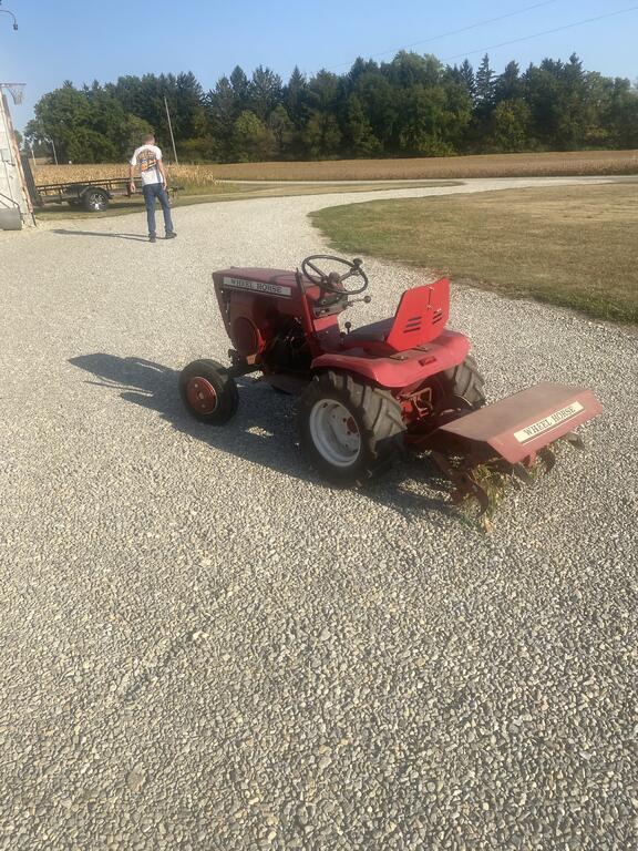

Achto 32,759 #5 Posted December 18, 2024 I run my Brinly attachment with an adaptor slid into the slot hitch. A cultivator hanging off the back with 40 extra pounds added way to the back of it has never been an issue. Same with a disc harrow or moldboard plow 4 2 Share this post Link to post Share on other sites
Lane Ranger 12,107 #6 Posted December 18, 2024 When you have a straight tongued implement and it is inserted in the slot hitch correctly and pinned with a hitch pin an early Wheel Horse tractor with a Hein-Werner hydro pump added on will lift over 300 pounds without damage. Not if you have an implement with addiotnal weight, improperly hooked up or snagged on something -yes you could probably break or damage the cast iron slot hitch. 4 Share this post Link to post Share on other sites
Handy Don 17,480 #7 Posted December 18, 2024 2 hours ago, Bar Nuthin said: I'll have to check the tongue weight on my trailer. A slip-ball hitch might be handy. Something to keep in mind when hooking up via a ball hitch--because the slot hitch is offset upward from the transaxle pin, it is held by the cable from pitching downward with trailer tongue weight, but there is nothing stopping it from pitching upward! If the trailer on a ball pushes against the tractor, it’ll almost certainly pivot the hitch upward. I have a slip-in ball hitch for the slot (thanks @953 nut!) but I am very cautions and use it only on level ground at slow speeds. The slot dimensions are ⅝” H x 2” W -- not a common size for bar stock. 1 3 Share this post Link to post Share on other sites

Handy Don 17,480 #13 Posted December 19, 2024 (edited) 16 hours ago, 953 nut said: The cable had just been replaced with a new Wheel Horse Parts and More unit or it probably would have broken. I agree that the cable is likely designed to be the weakest point. A failure here is probably the least dangerous. I just looked up the tensile strength of ⅛” wire rope -- approx 1,700+ lbs at breaking. Of course the condition of the wire and swages might lessen that. And other parts like the pins and clevises might be more or less. The arm and socket on the hitch casting are probably strong enough but I’m no metallurgist. And can one’s arm (or the hydro) generate that much force? IDK! The pivot at the transaxle is about 7” from the cable attaching point so I’ll start with 11,900 lb inches An 80 lb load centered 30” out from the pivot is only 2,400 lb inches. A 200 lb load (ex. disc harrow & extra weights) centered 40” out from the pivot gets to 8,000 lb inches but still only two thirds of the break strength. So from a back-of-the envelope, “looks about right” calculation, it’d take 300 lbs at 40” out to be at the “something is sure to break" limit! Yep, lifting the front of the tractor probably takes less! Edited December 19, 2024 by Handy Don 3 Share this post Link to post Share on other sites
Bar Nuthin 3,246 #14 Posted December 19, 2024 (edited) 58 minutes ago, Handy Don said: The pivot at the transaxle is about 7” from the cable attaching point so I’ll start with 11,900 lb inches An 80 lb load centered 30” out from the pivot is only 2,400 lb inches. A 200 lb load (ex. disc harrow & extra weights) centered 40” out from the pivot gets to 8,000 lb inches but still only two thirds of the break strength. Edited December 19, 2024 by Bar Nuthin 4 Share this post Link to post Share on other sites

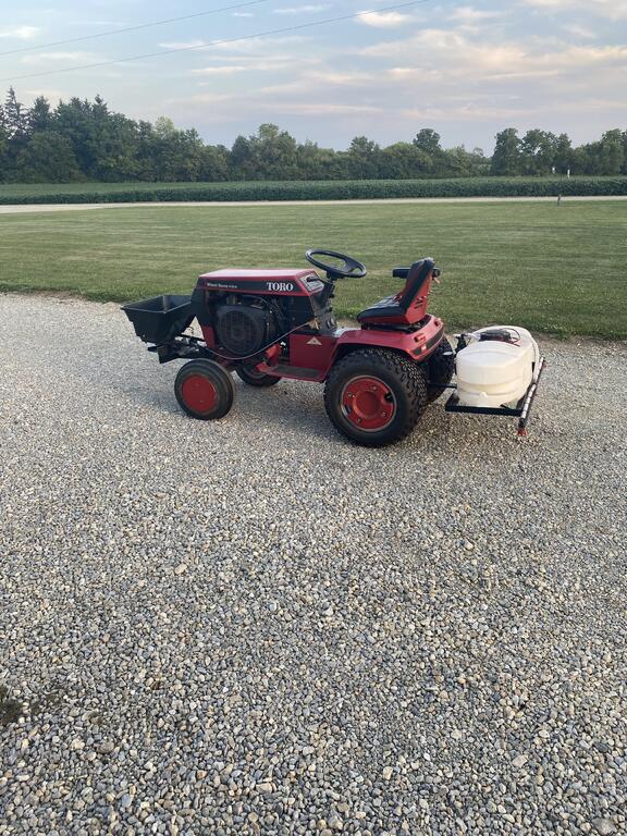

Tonytoro416 1,387 #15 Posted December 19, 2024 I run several attachments from the slot hitch. I find it the easiest platform to build custom tools from. The sprayer is 20 gallon and the harrow is pretty heavy on its own and sometimes run wheel weights on it if I need more 3 2 Share this post Link to post Share on other sites
Bar Nuthin 3,246 #16 Posted December 19, 2024 8 minutes ago, Tonytoro416 said: I find it the easiest platform to build custom tools from. That's kinda what I was thinking when first saw it. Now I got a few fresh ideas. 2 1 Share this post Link to post Share on other sites
Handy Don 17,480 #17 Posted December 19, 2024 13 hours ago, Tonytoro416 said: The sprayer is 20 gallon 160 lbs of liquid, 40 lbs of hitch and container (?) so 200 lbs at maybe 20” out? Easy peasy at 4,000 lb inches 2 1 Share this post Link to post Share on other sites

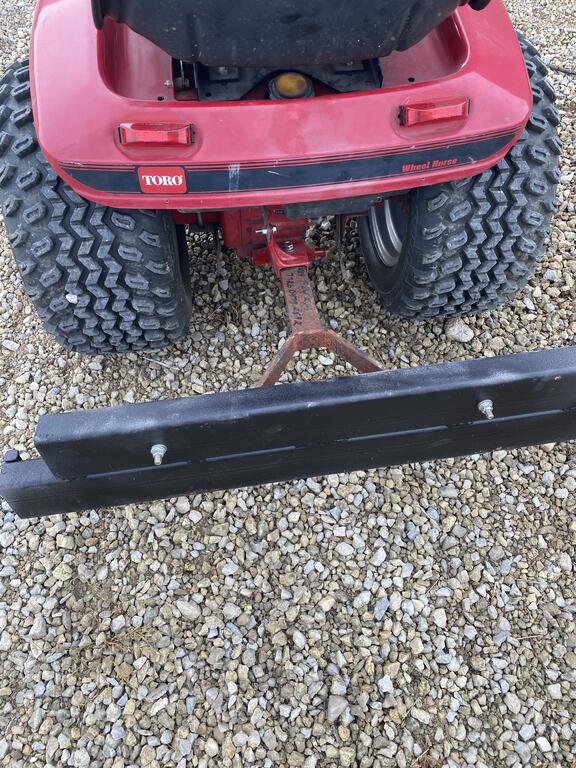

Bar Nuthin 3,246 #18 Posted December 19, 2024 14 hours ago, Tonytoro416 said: I find it the easiest platform to build custom tools from. 18 hours ago, Handy Don said: The slot dimensions are ⅝” H x 2” W -- not a common size for bar stock. Any problems with using 2" x 1/2" bar stock to build attachments? Or, would it benefit to shim it to get to the 5/8" that Don indicates? 1 Share this post Link to post Share on other sites
Handy Don 17,480 #19 Posted December 19, 2024 (edited) 4 minutes ago, Bar Nuthin said: Any problems with using 2" x 1/2" bar stock to build attachments? Or, would it benefit to shim it to get to the 5/8" that Don indicates? Using smaller stock will put the loads at the ends of the slot instead of distributing it as it should be. And it’ll permit bouncing which is not good. Were it me, I’d weld up a sandwich of two 5/16” bars or at least add a ⅛” to the ½” and make sure that either sticks out past the ends of the slot. Edited December 19, 2024 by Handy Don 3 Share this post Link to post Share on other sites
Bar Nuthin 3,246 #20 Posted December 19, 2024 9 minutes ago, Handy Don said: Using smaller stock will put the loads at the ends of the slot instead of distributing it as it should be. And it’ll permit bouncing which is not good. Were it me, I’d weld up a sandwich of two 5/16” bars or at least add a ⅛” to the ½” and make sure that either sticks out past the ends of the slot. Another solid answer! Thank you! 1 Share this post Link to post Share on other sites
ebinmaine 80,749 #21 Posted December 19, 2024 2 hours ago, Bar Nuthin said: Another solid answer! Thank you! You pay right close attention to whatever @Handy Don says. 2 1 Share this post Link to post Share on other sites
Tonytoro416 1,387 #22 Posted December 19, 2024 I made shims for the sprayer attachment. Definitely didn’t like the slop created by the narrower bar stock 2 Share this post Link to post Share on other sites
