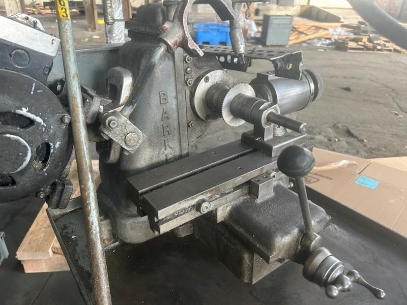

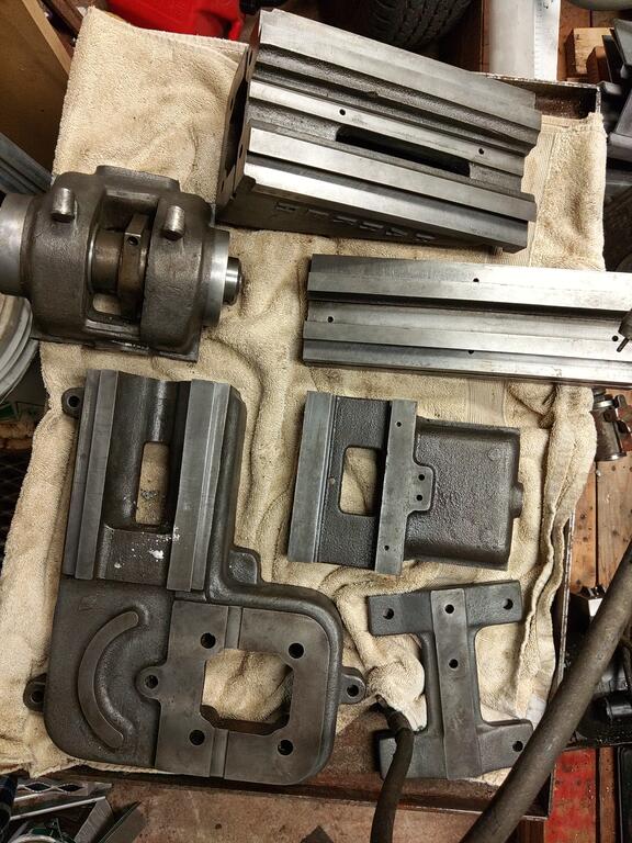

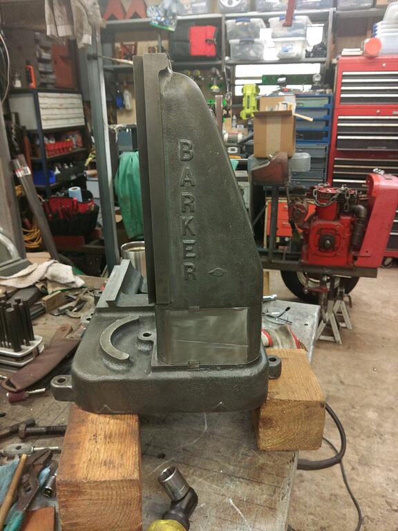

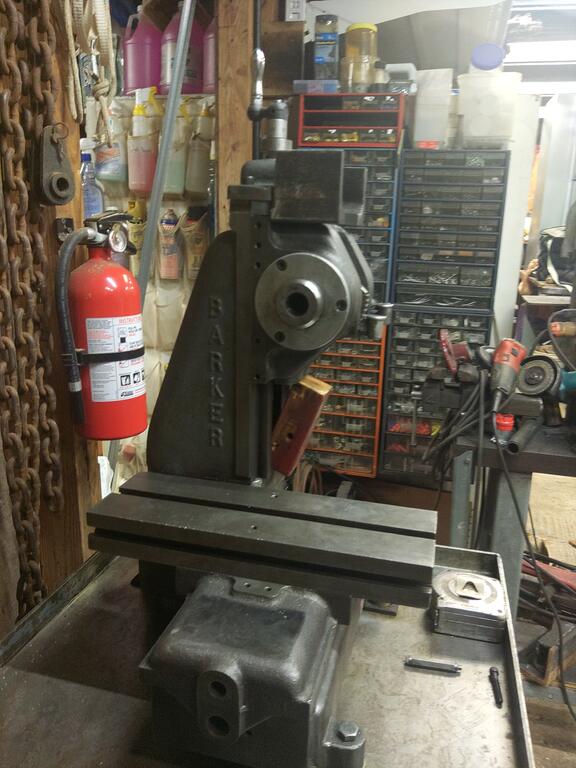

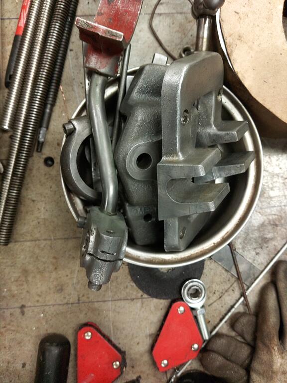

JPWH 6,546 #1 Posted December 18, 2024 (edited) It's an old machine that needs some cleaning and TLC. It's a model PM serial no. 239 I had to disassemble it to move it in the shop so I decided to clean it up so I could paint it before reassembly. Edited December 18, 2024 by JPWH 7 5 2 Share this post Link to post Share on other sites
Mickwhitt 5,259 #2 Posted December 18, 2024 That looks a neat little machine. I'm not sure how robust it will be for larger milling jobs as the Y axis is operated by a lever and rack rather than hand wheel and leadscrew. Kind of like a surface grinder where load on the Y axis is low. Plus it has only a slitting saw mounted on the tool mandrel so it's probably only for light use. Internet says it works well on non ferrous materials, so it may have been made to slit aluminium clamping brackets or the like. I think it would be fairly limited in what it could do but if you have room for it and the right kind of work it would be a fine addition to any shop. Mick 1 Share this post Link to post Share on other sites
JPWH 6,546 #3 Posted December 18, 2024 It is a very robust machine. It will cut steel as long as you understand it's limits and make cuts accordingly. It was made as a production machine. I am replacing the levers and racks with lead screws. It is also limited for speed control so I am replacing the motor with a 3 phase controlled by a vfd. Based on what I cleaned out of this machine I think this one was used for aluminum. I also received several slitting and grooving cutters with the machine as well as an indexer. 3 Share this post Link to post Share on other sites

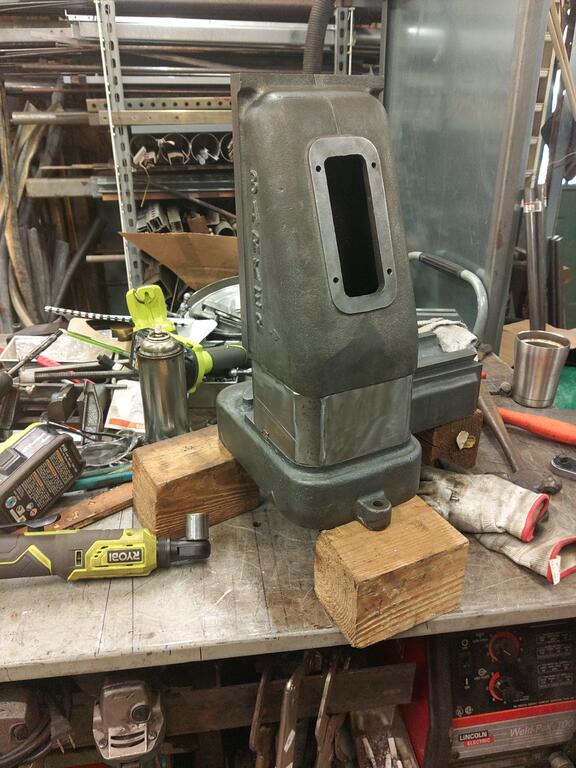

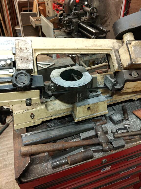

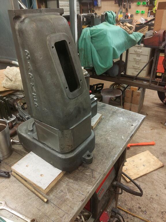

JPWH 6,546 #14 Posted December 28, 2024 My son and his family came Thursday afternoon to visit for the weekend. After work Friday I was showing my son the little milling machine and my idea for the riser block, with his help and some creative clamping we started cutting. My little bandsaw takes a while to cut through 3" steel but it is doing it. 1 1 Share this post Link to post Share on other sites
JPWH 6,546 #15 Posted December 29, 2024 Rough cutting done and 1/2 holes drilled. Test fit to mark keyway location. 1 1 Share this post Link to post Share on other sites

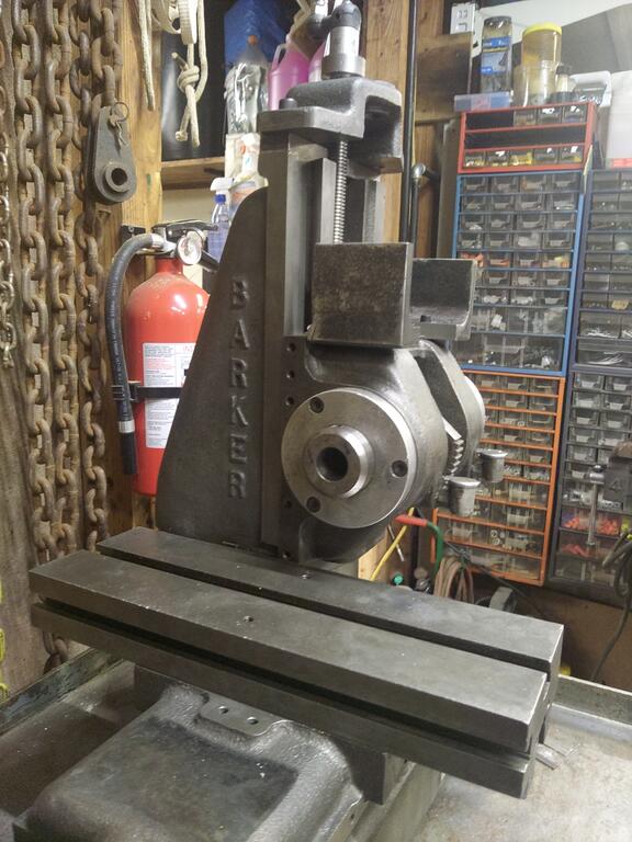

JPWH 6,546 #16 Posted January 5, 2025 Keyways cut and key stock installed . I had to purchase some 1/4 x 1/2 key stock for the added keyway and some 1/2 x 5 1/2 bolts for the added 3 inches to bolt the base to the column. All three parts bolted together. Now to fabricate an overarm support. 2 Share this post Link to post Share on other sites

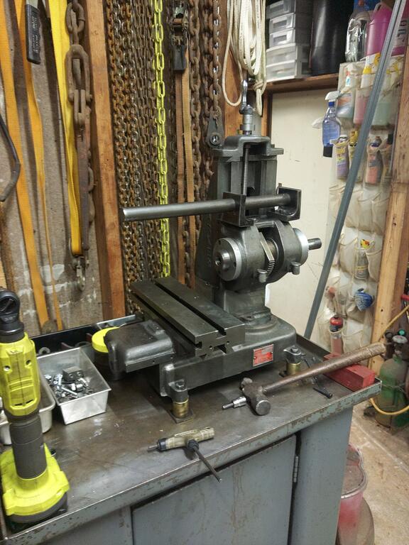

JPWH 6,546 #17 Posted January 10, 2025 I got the milling machine sitting on the cabinet and partially put together so I can lay out the overarm arbor support. The three inch riser block gives me 7 1/2" from the table to the center of the arbor. Plenty room for my dividing head. 2 Share this post Link to post Share on other sites

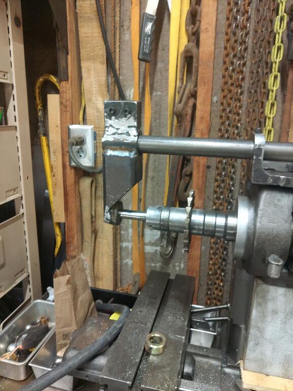

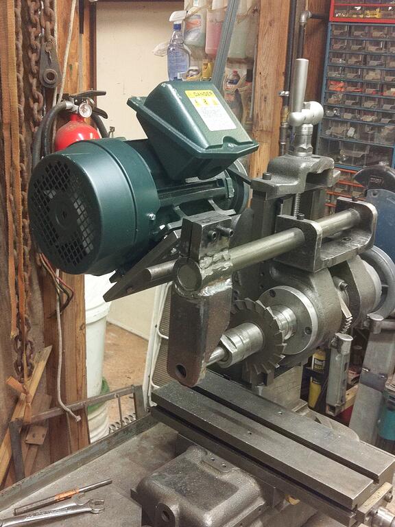

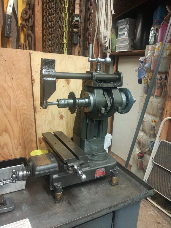

JPWH 6,546 #18 Posted January 12, 2025 Made some progress on the overarm support. 1 Share this post Link to post Share on other sites
JPWH 6,546 #19 Posted March 3, 2025 The arbor overarm support is ready to test. I need to install the motor and vfd and a few other parts and I can test it. I have not ran this machine yet so first run may get interesting. 2 Share this post Link to post Share on other sites

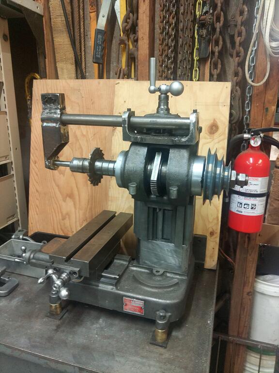

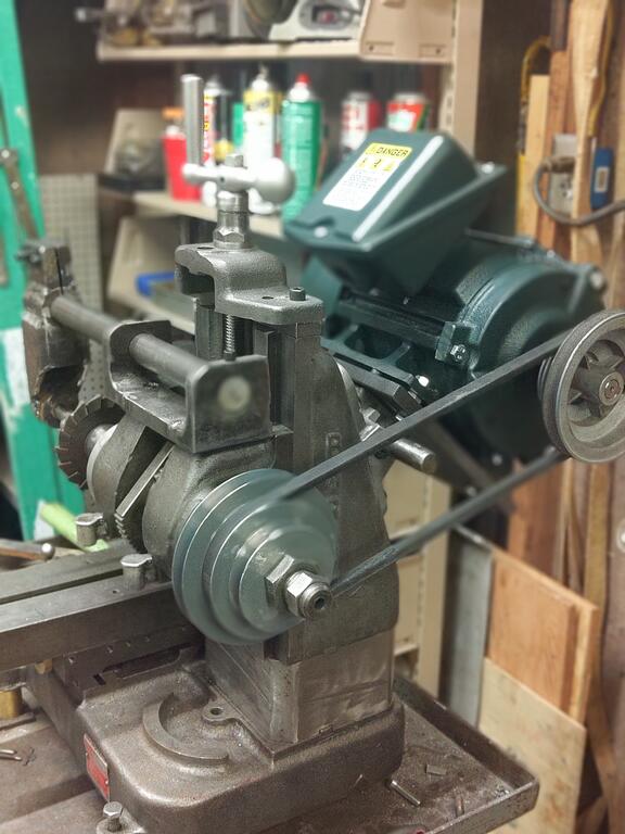

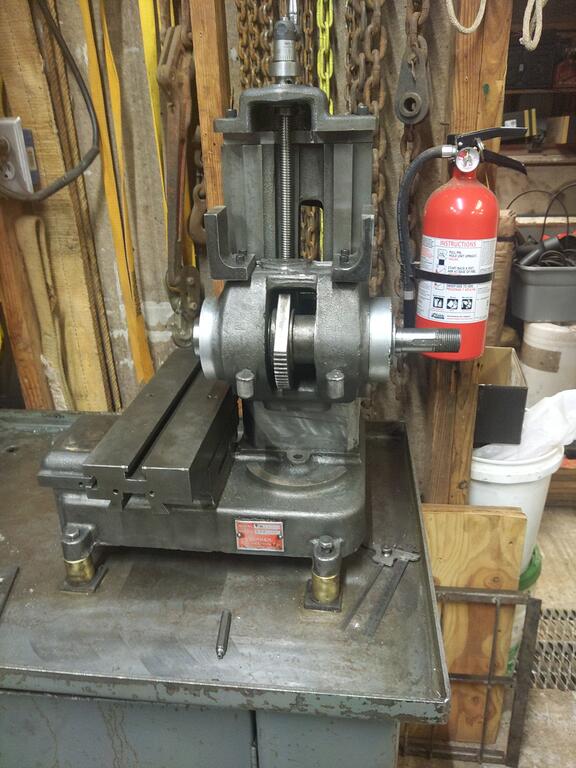

JPWH 6,546 #20 Posted March 22, 2025 I finished the lead screws and mounted the spindle pulley. The pulley was shipped as a one inch bore but was only 7/8. I had to bore it to 1" and make a new key 1/4 x 5/16. 1 Share this post Link to post Share on other sites
JPWH 6,546 #21 Posted May 4, 2025 I had to make a motor mounting plate so I could mount the motor and buy a chain fall for lifting the motor. Cutting the slots was the hardest part especially in 1/2 plate. I also mounted casters under it so I could move it easy. I will mount it on blocks before I use it. Share this post Link to post Share on other sites
