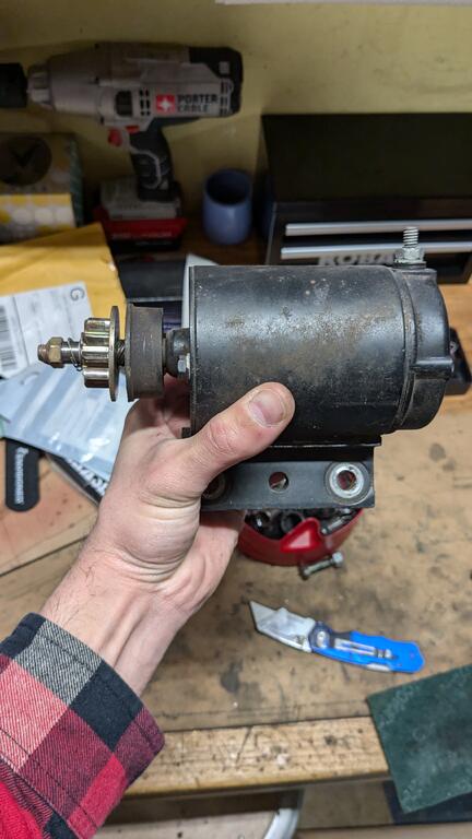

oliver2-44 11,813 #26 Posted December 14, 2024 2 hours ago, Alrashid2 said: Any idea how to get to it? I'm thinking removing the engine shroud? The pieces im moving seem to thread/unthread but not sure which direction they should go Yes you can remove the engine tin shroud. But you have to be very careful undoing those little 1/4” bolts that screw in the aluminum bearing plate. They like to corrode to the aluminum and twist off. Tighten them a tiny bit, loosen a tiny bit, repeat, repeat. When you reinstall them coat them with a light coat of anti-seize. Depending on how things are arrange around you engine it may be easier to pull the starter. On my C160 2 bolts hold the starter and one electrical connection. Some older starter bendix gears are steel and newer one are plastic. On the steel ones you can use brake clean spray. Move/screw the spring loaded gear back and forth to clean the shaft the gear is on. Then lube it with dry graphite. Use no oil or grease because it will collect dirt/grit and cause it to stick. While you have access to the front of the starter check if the brass.bushing (which you can’t see) In the front of the started cover has excessive wear. Push the starter gear sideways hard with you hand. Watch for movement where the shaft enters the front of the starter motor. A tiny bit of movement is normal. A 1/16 is excessive. It will work with a lot of side movement (for a while). But that would be telling you it’s time to replace that front bushing. Sooner than later. 1 1 Share this post Link to post Share on other sites
Alrashid2 476 #27 Posted December 14, 2024 @oliver2-44 thanks for your instruction. I'll be really careful unscrewing them... and will take your advice. I'm thinking maybe I can take your advice and just remove the starter instead. Is it normal for me to be able to twist that piece in my photo/video? It is just rattling around and I don't remember it doing that before 1 Share this post Link to post Share on other sites

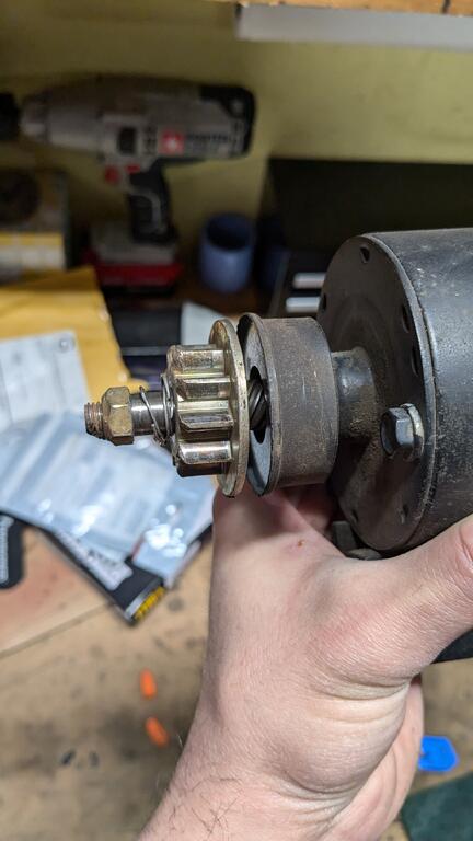

oliver2-44 11,813 #28 Posted December 14, 2024 4 minutes ago, Alrashid2 said: Is it normal for me to be able to twist that piece in my photo/video? It is just rattling around and I don't remember it doing that before It shouldn’t really just easily rattle around. But you should be able to slide it back and forth along the shaft. It is spring loaded to hold it back-disengaged. Then when you engage the starter the rotational force throws it forward enabling the starter gear to engage the flywheel gear. When the engine starts and turns faster that the starter the starter gear disengages and the spring pull it backwards. 1 1 Share this post Link to post Share on other sites
Alrashid2 476 #29 Posted December 14, 2024 (edited) Well that was easy to remove the starter! Thanks @oliver2-44 you saved me a lot of time Well I think I have an idea why those components are loose - I think you guys said it's called the Bendix assembly? Looking online it looks like that mangled metal used to be a spring... Guessing that is what kept these components from rattling around. Any idea how I can repair this? Maybe a new spring? EDIT: Also wondering: How the heck did the spring get mangled like this in the first place!? Unless it was barely hanging onto life from the Previous Owner and I finally killed it! Edited December 14, 2024 by Alrashid2 2 Share this post Link to post Share on other sites

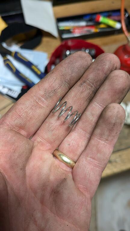

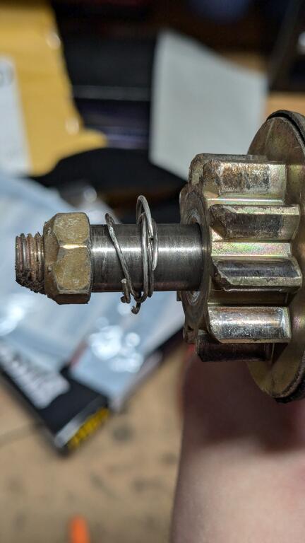

Alrashid2 476 #30 Posted December 14, 2024 Thought I'd post an update Couldn't find any info online. So ended up eventually removing the nut on the end of the Bendix assembly - was pretty difficult as the starter mechanism kept spinning. Eventually with some vise grips and an impact driver I got the nut off. Then I found a spring in my nuts and bolts can, trimmed it down to size, reassembled, and tested her out. Well, she started! I also looked with the hood open and saw the mechanism of action that @oliver2-44 explained: gear moved outward to start, then when engine got going the gear moved back inward via the spring. Not sure where the spring came from and how it'll hold up but she runs again! Would still like to hear your opinions in case I should get back in there and better future proof the repair. Attached a photo of the remaining chunk of spring I cut off when trimming it to length (I estimated number of coils by the mangled rings I found remaining from the original starter). 2 2 Share this post Link to post Share on other sites
oliver2-44 11,813 #31 Posted December 14, 2024 Excellent Did you check that front bushing clearance by trying to move shaft sideways? Your bendix gear sure looks clean with very sign of wear on the teeth. Even the cadmium plating looks intact on the teeth. I wonder if the PO put a new bendix on there and the chinesium spring failed. Does the paint patina on the starter body match the rest of the engine or is it brighter like it could be a complete replacement starter. Share this post Link to post Share on other sites
Alrashid2 476 #32 Posted December 14, 2024 Hey Oliver yes I did check and it seemed like almost no play. I wonder if you're right - the starter does look original though. Paint matches and it has some numbers on the back of the mount in old 80s vintage font The previous owner seemed to take care of this thing though. Lots of little replacement parts and mods I've found. This guy built a custom seat mount that almost looked factory. I bought the tractor off his brother in law who was cleaning out the estate. Hopefully the old Horser is looking down from above and appreciating that I'm continuing to maintain her! Out of curiosity what would you guys have done about the spring? Find a similar spring at Ace and replace? I assume that part isnt around anymore ? Share this post Link to post Share on other sites

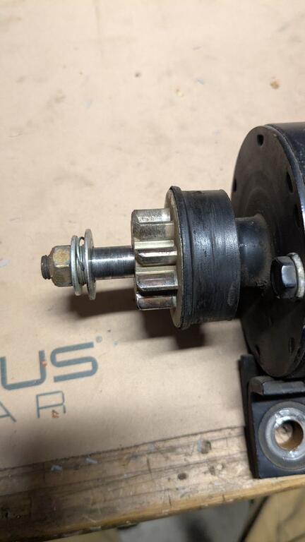

Alrashid2 476 #36 Posted May 18 (edited) Well, my fix on my bendix with a random spring lasted almost a year and a half (17 months) but when starting her up yesterday, I could hear that the starter just didn't sound right. Lo and behold, pulled the starter and the bendix was screwed up again. This time though one of the washers was stuck to the shaft for whatever reason, crushing the spring. Pulled it apart, found a new washer, and clipped off the bent portion of the spring. Unfortunately the spring is too short now, so I stretched it out and put it back together for now. So far, so good. But I'll have to source a new spring at Ace at some point. Hopefully I can find something! Edited May 18 by Alrashid2 1 Share this post Link to post Share on other sites
