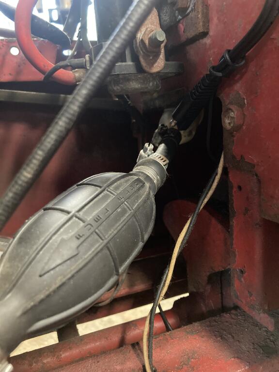

SylvanLakeWH 32,139 #13 Posted December 13, 2024 Primer bulb on mine for years and use rec fuel. No issues. Cheap fix. Quick starts. 5 Share this post Link to post Share on other sites

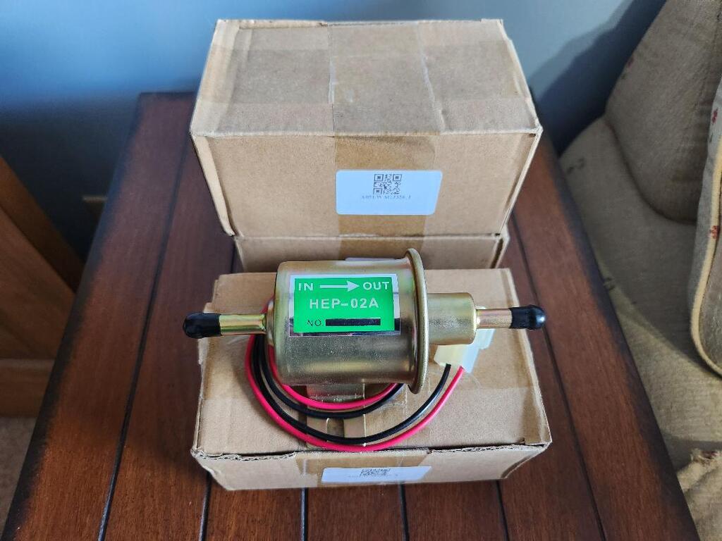

Racinbob 13,111 #17 Posted December 13, 2024 Never had a check valve work. I don't even mess with the original fuel pumps anymore. Quality electrics on the critical machines and I've been using the cheapies on the others. Even though the cheapies are working great I just took delivery of a three fer real cheap just to have spares. 4 3 Share this post Link to post Share on other sites

Horse Newbie 7,405 #25 Posted December 13, 2024 22 hours ago, ebinmaine said: A. Use a primer bulb That’s what I used… problem solved… 4 Share this post Link to post Share on other sites
