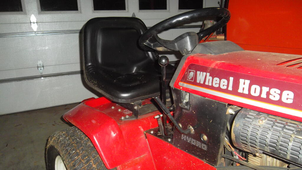

Lee1977 7,750 #1 Posted December 12, 2024 (edited) Extended the control lever, easer to control. Might have to streghten the shifter pattern like Ed did on his 520-H Edited December 12, 2024 by Lee1977 4 2 Share this post Link to post Share on other sites

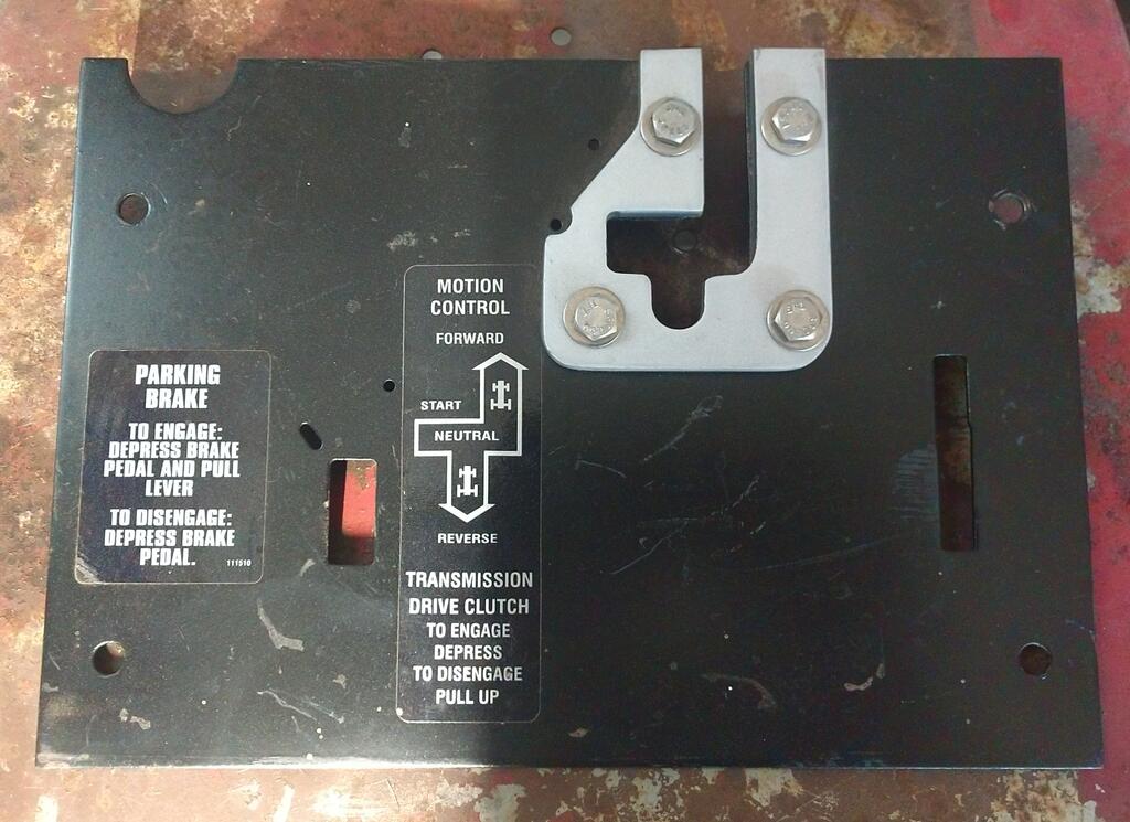

Lee1977 7,750 #3 Posted December 13, 2024 (edited) I found my piece of 1/4" aluminum I had cut a one foot square off it for a router base. I didn't think I used it fot anything else. It's going to be a stright slot with a half round notch for nuteral. Then move the safety switch about 13 /16" .It works like it is now but in nuteral the shifter is inside the steering wheel. With all the extra movemevt of the lever makes more fine control of the hydro. I added 6 1/2" to the lever but the steering wheel was raised 1 3/4" when I fixed the worn out wheel. Edited December 13, 2024 by Lee1977 3 Share this post Link to post Share on other sites

Lee1977 7,750 #7 Posted December 13, 2024 (edited) Got the plate made today now just need to get it bolted down. Edited December 13, 2024 by Lee1977 3 Share this post Link to post Share on other sites
Handy Don 17,373 #8 Posted December 14, 2024 3 hours ago, Lee1977 said: Got the plate made today now just need to get it bolted down. Don't you also have to cut the plate below so it’ll go into reverse without the offset path? Share this post Link to post Share on other sites
Lee1977 7,750 #9 Posted December 14, 2024 2 hours ago, Handy Don said: Don't you also have to cut the plate below so it’ll go into reverse without the offset path? Yes, that's a easy part. Here it is back together. 3 Share this post Link to post Share on other sites
Handy Don 17,373 #10 Posted December 14, 2024 10 hours ago, Lee1977 said: Yes, that's a easy part. Here it is back together. I'm thinking you probably locked the parking brake to force neutral and then aligned the notch to the lever, yes? Share this post Link to post Share on other sites
Lee1977 7,750 #11 Posted December 14, 2024 1 hour ago, Handy Don said: I'm thinking you probably locked the parking brake to force neutral and then aligned the notch to the lever, yes? I just put the notch at the same location it was originally. It just moved about 3/4" to the right. Could need a minor adjustment, finished last night about 11:30. 3 Share this post Link to post Share on other sites
Handy Don 17,373 #12 Posted December 14, 2024 (edited) 52 minutes ago, Lee1977 said: I just put the notch at the same location it was originally. It just moved about 3/4" to the right. Could need a minor adjustment, finished last night about 11:30. I’m going to upgrade a 312 and a 520 to have foot pedal motion control using recently bought kits. We’ve been debating whether to remove the lever or leave the lever. Removing it means futzing with the neutral detector and eliminates any tactile feedback when switching from forward to reverse. Now I’m leaning toward doing something like what you did--leave the lever but with a very shallow notch in an added plate--just enough to “feel" neutral with my foot as the lever moves through. I’d also relocate the neutral safety switch to it can detect when the lever is at the notch. Eventually I might cut down the lever so it sticks up only a few inches so manual control is possible but not in the way. Thanks for the idea. Edited December 14, 2024 by Handy Don Share this post Link to post Share on other sites
