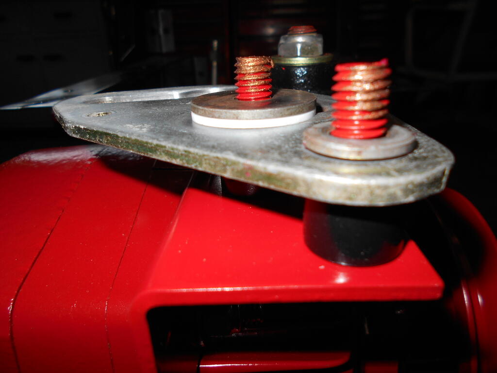

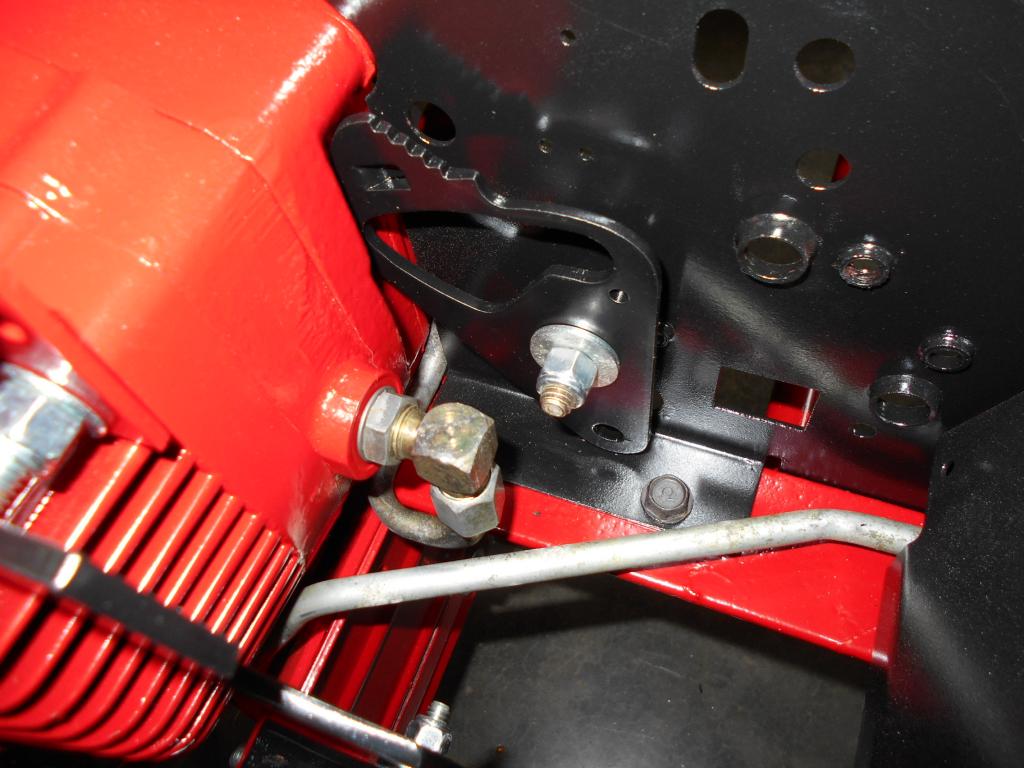

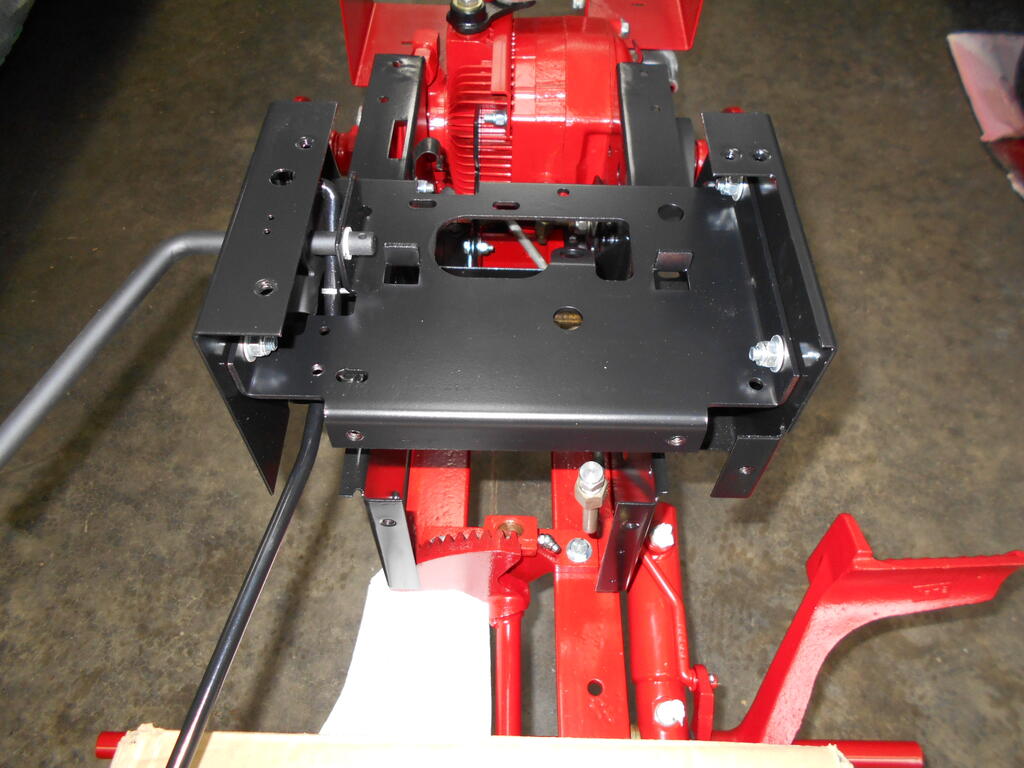

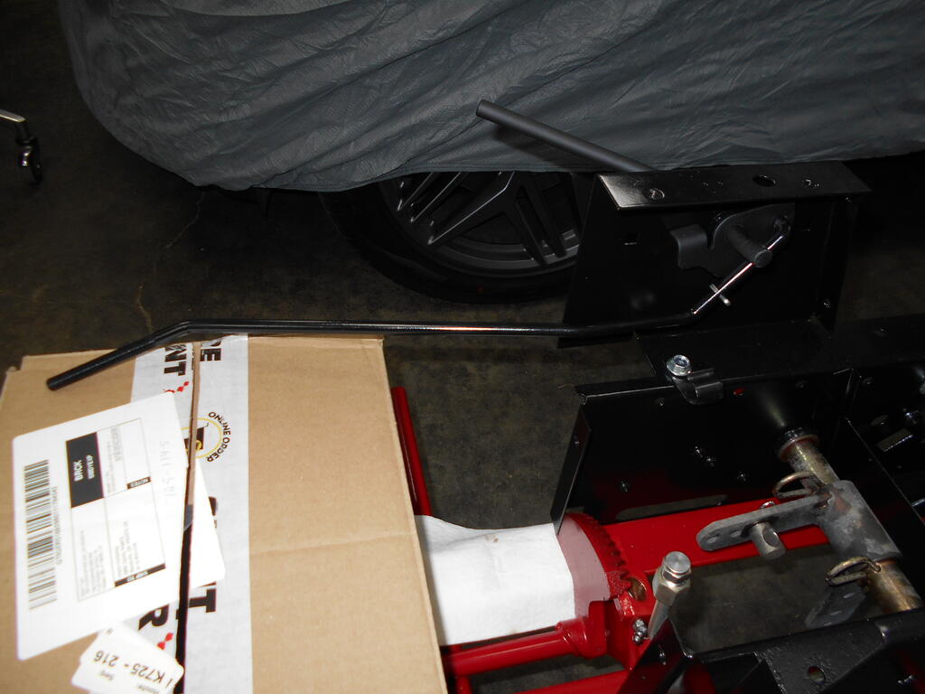

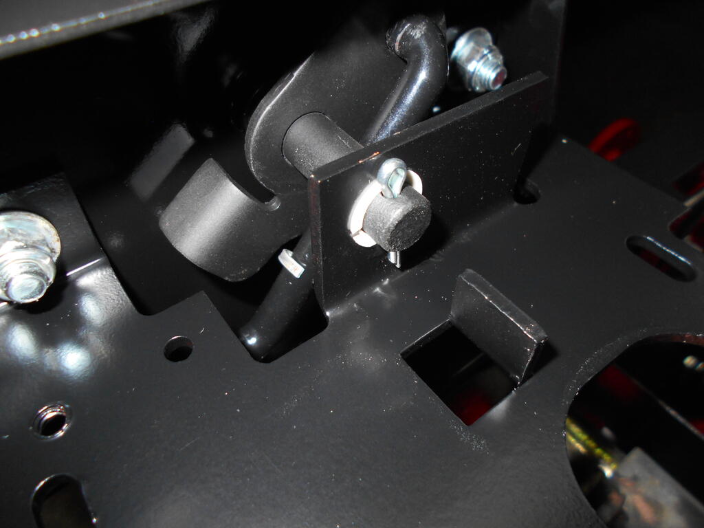

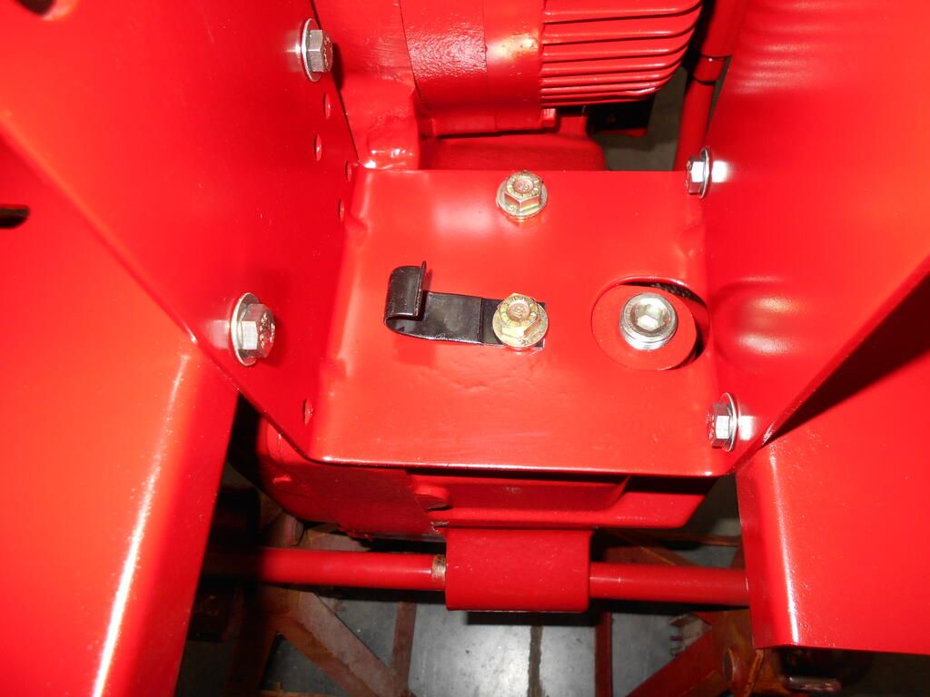

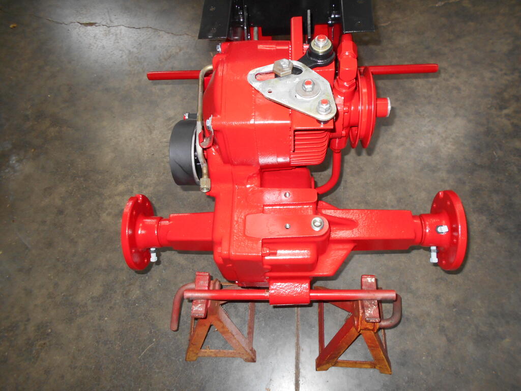

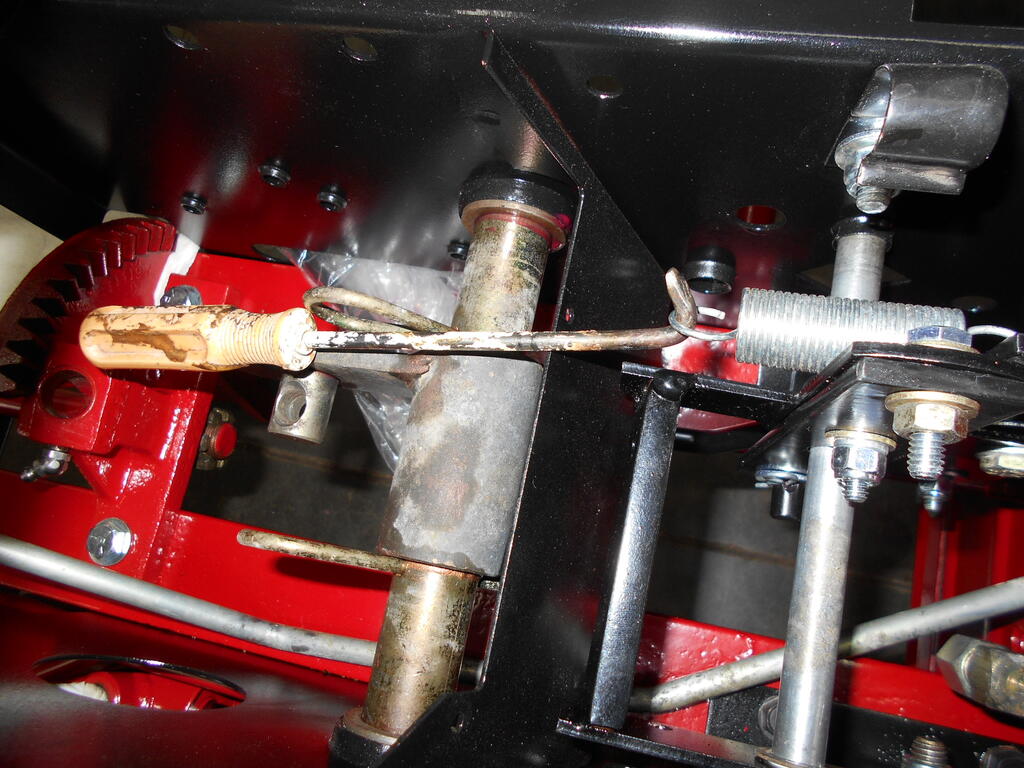

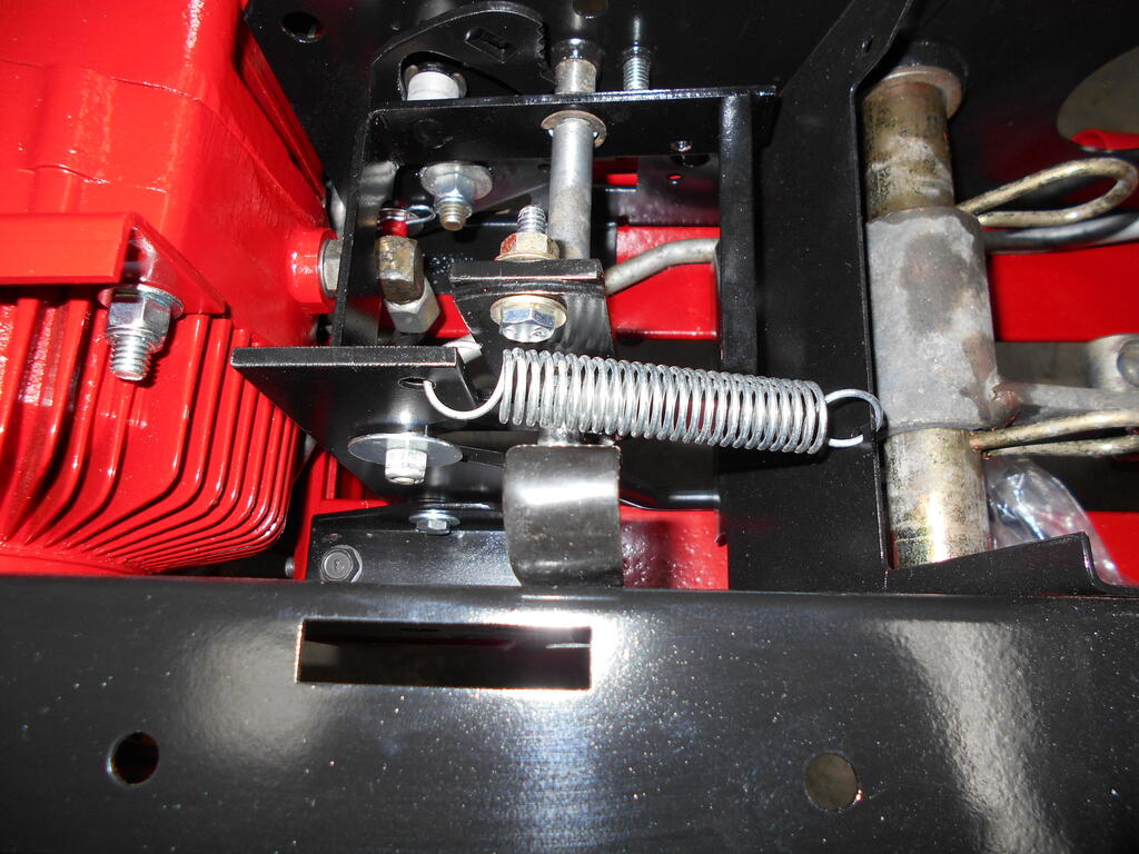

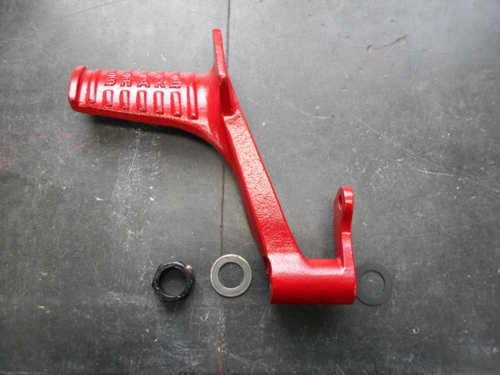

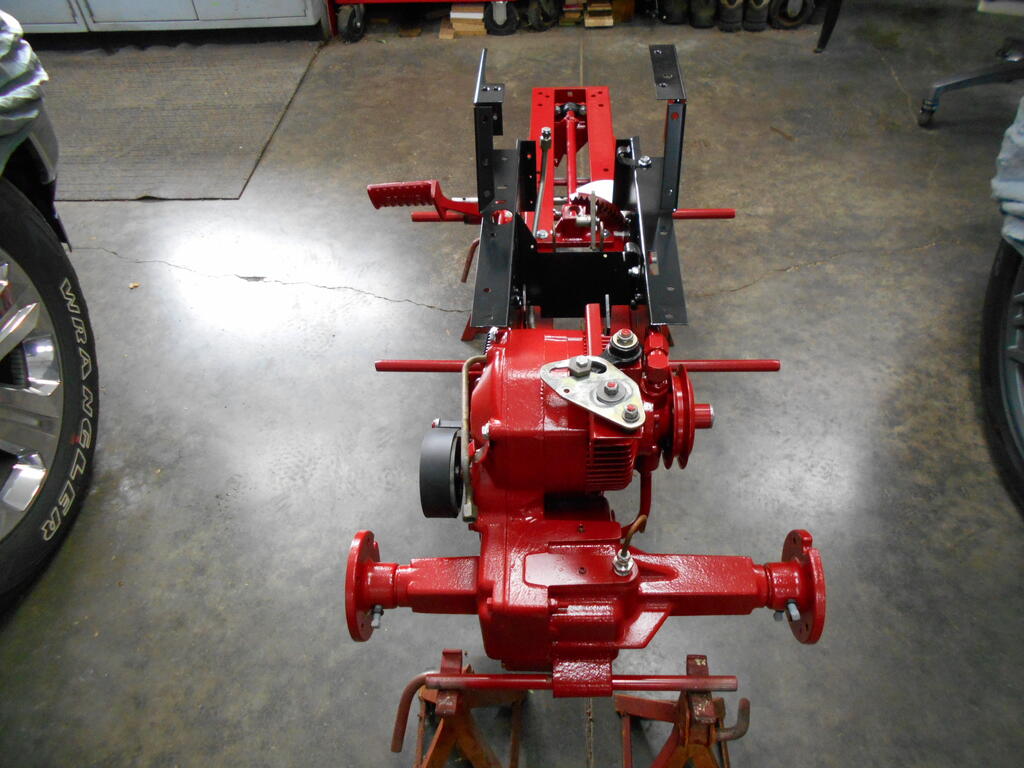

cleat 9,442 #151 Posted November 29, 2025 Parking brake cam plate assembly ready to be installed. Parking brake cam plate installed. Pivot point was lightly greased. 4 Share this post Link to post Share on other sites

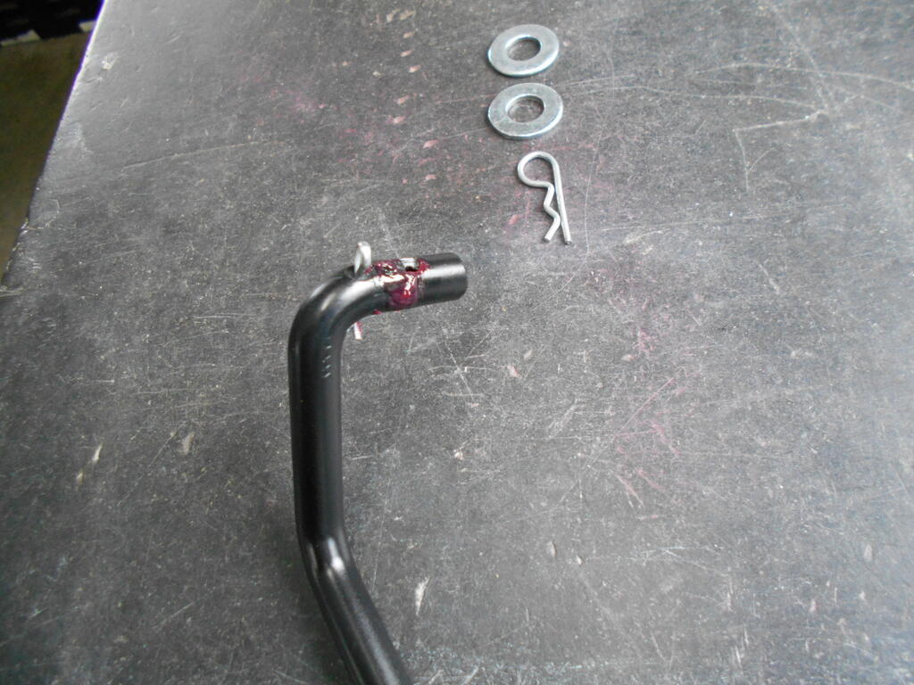

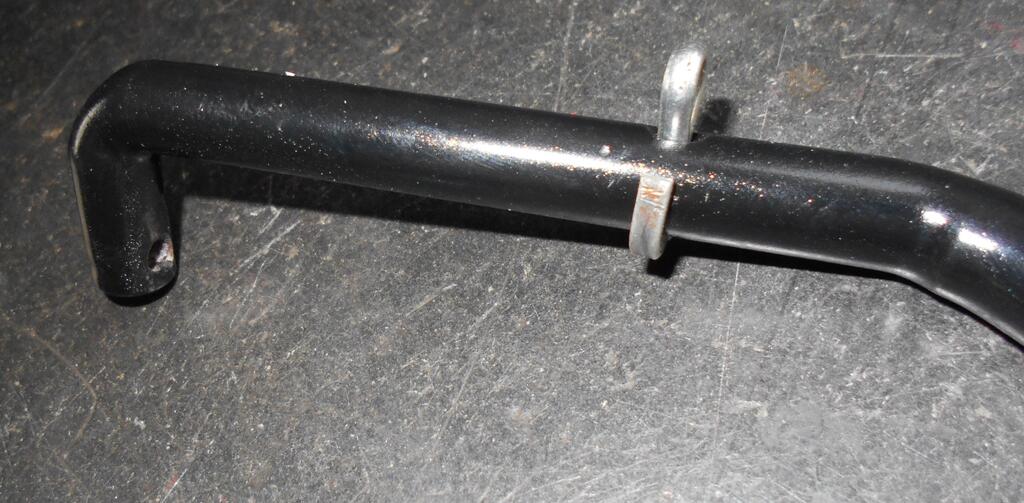

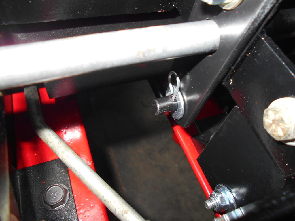

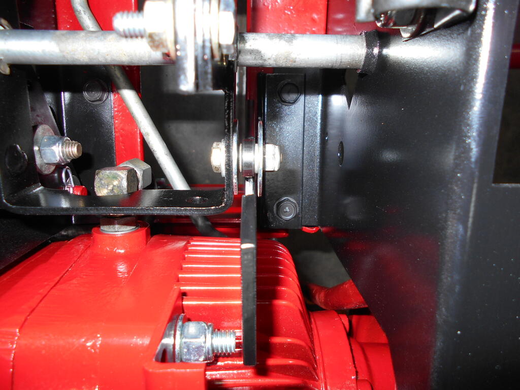

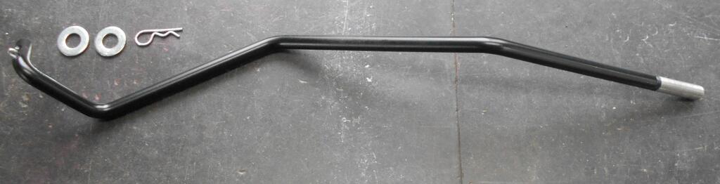

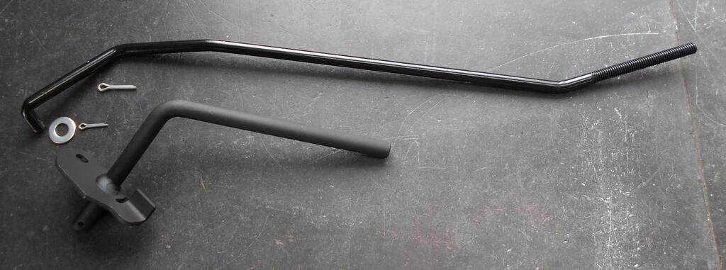

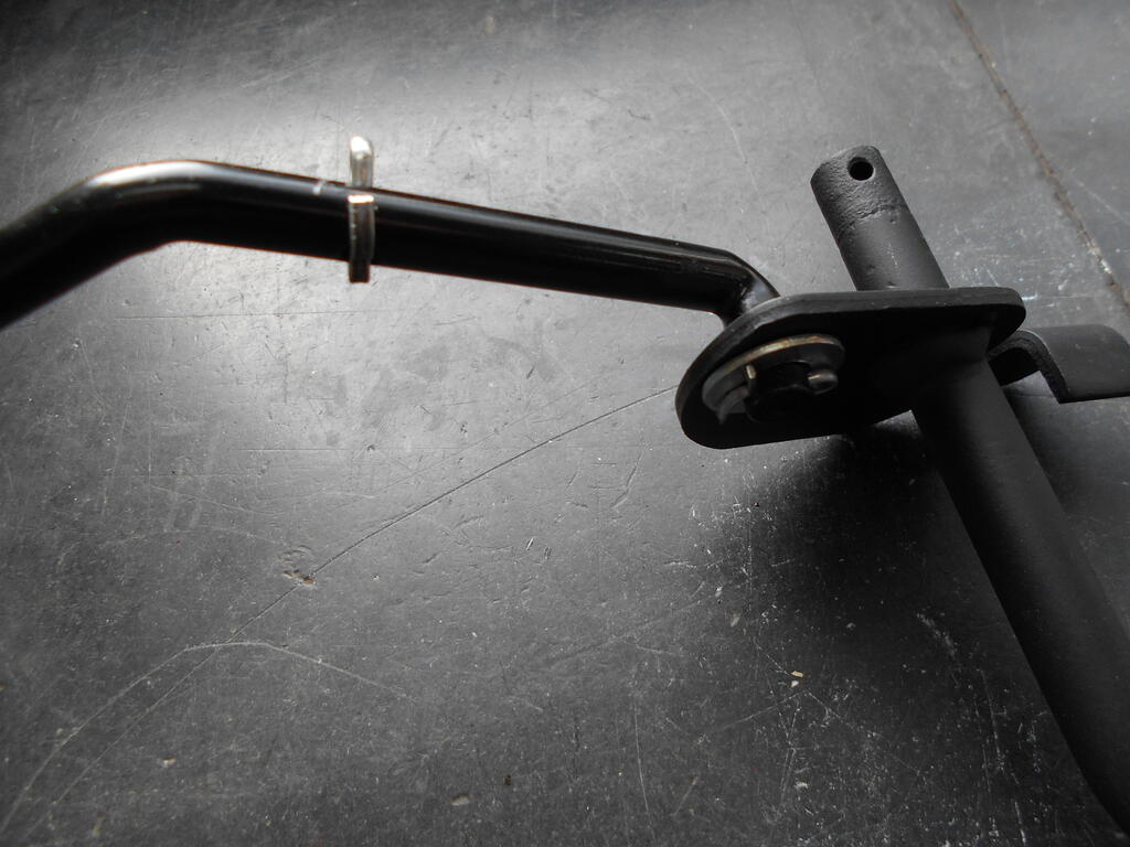

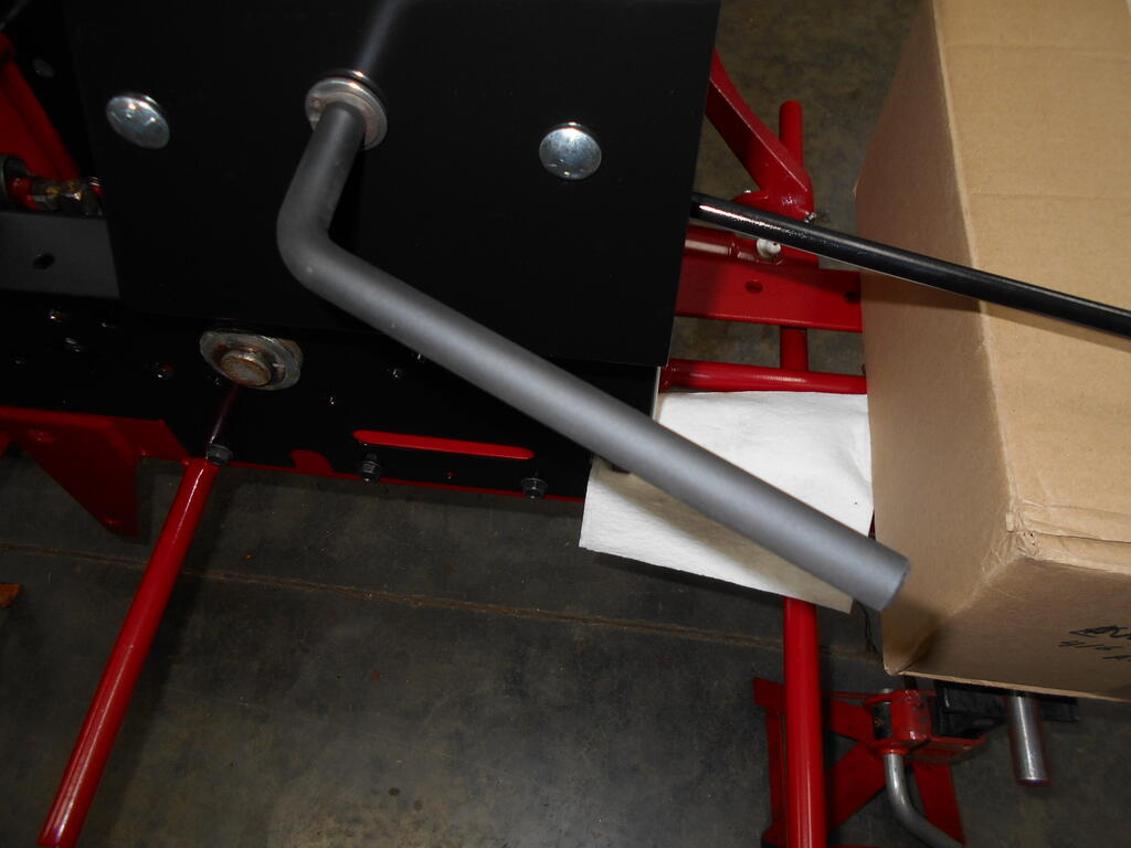

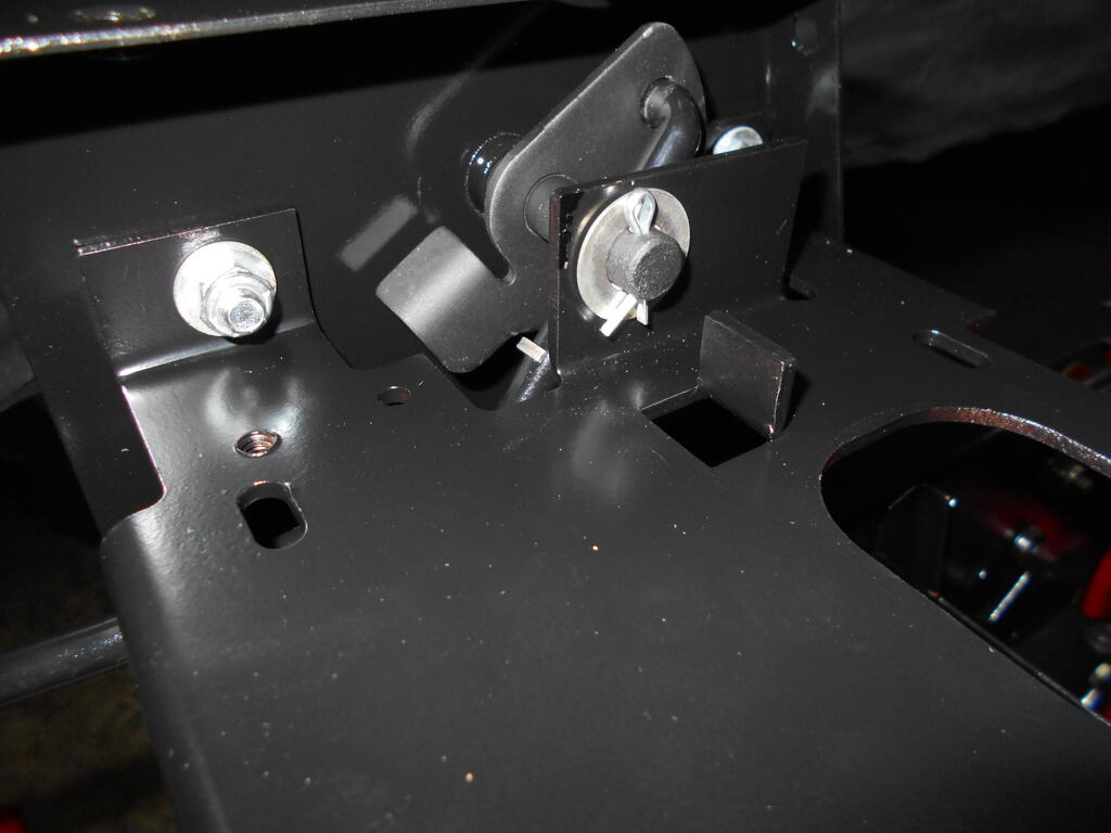

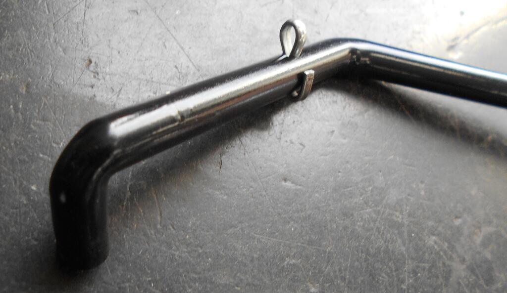

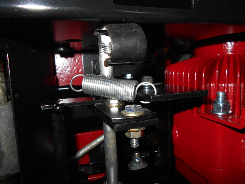

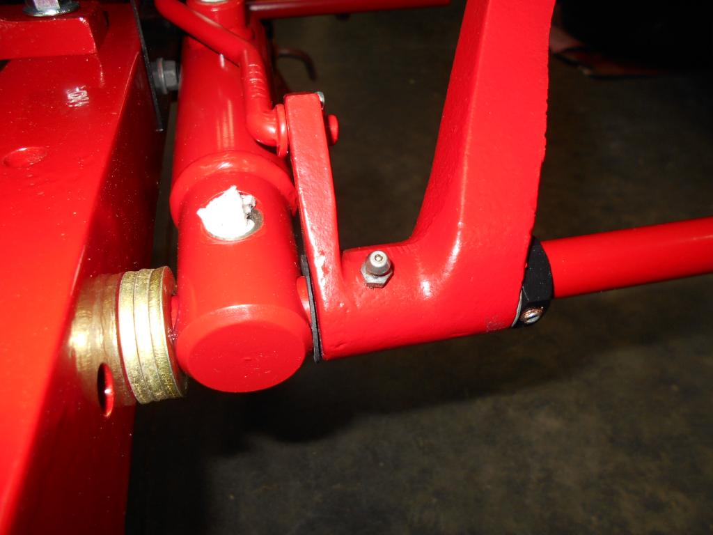

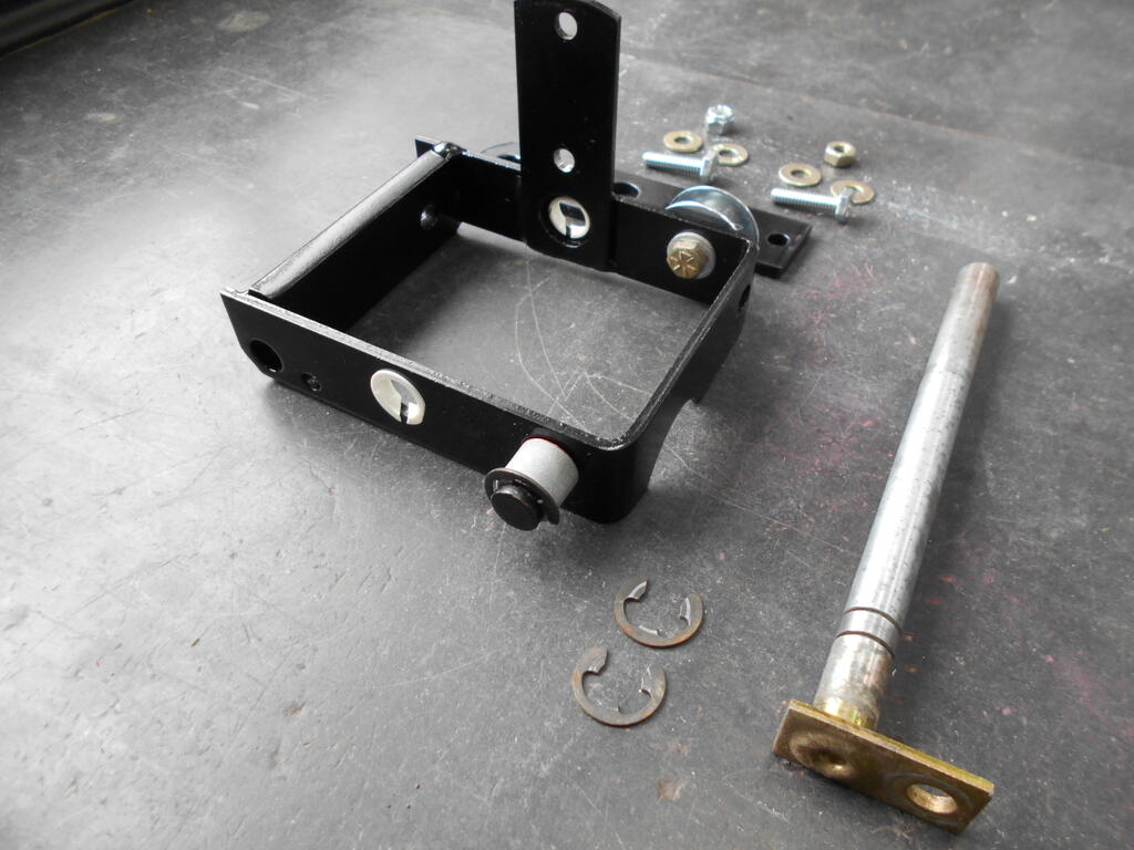

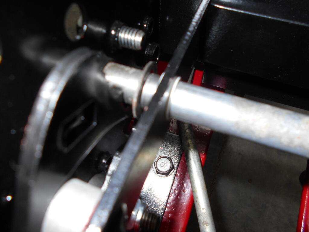

cleat 9,442 #152 Posted November 30, 2025 Brake rod assembly ready to install. Brake rod just inserted into parking brake cam and return spring installed. Rod was greased where it inserts into cam plate. Rod fully inserted into cam plate then washer and clip installed. Note the smaller clip, the one shown earlier was causing interference with the cam plate bolt. Brake return spring with rod fully installed into cam plate. Brake spring and bolt assembly ready to install. There should be 3 washers, only two are shown in this picture. Brake spring assembly installed just finger tight. I will set this later on when parking brake latch is installed. Brake pedal ready to install. Tractor ready to accept brake pedal. Brake pedal installed. Overview of complete brake system. 1 5 Share this post Link to post Share on other sites

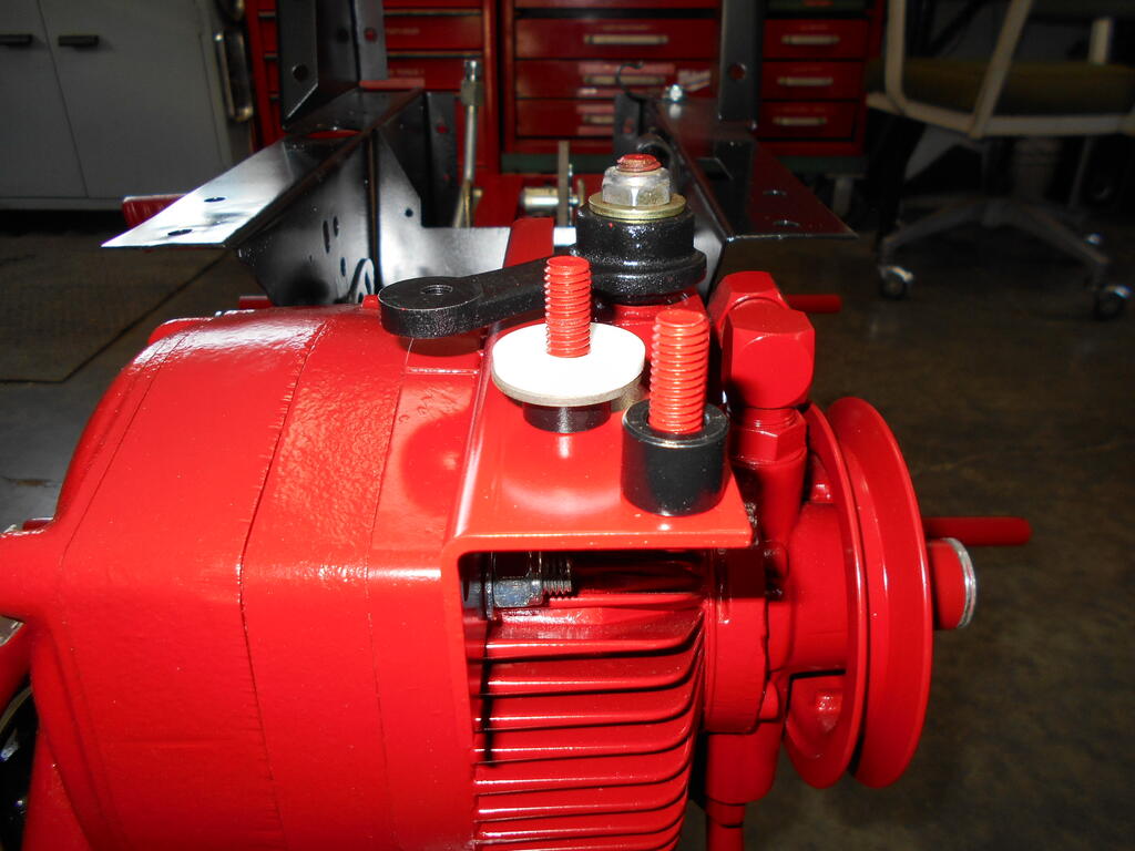

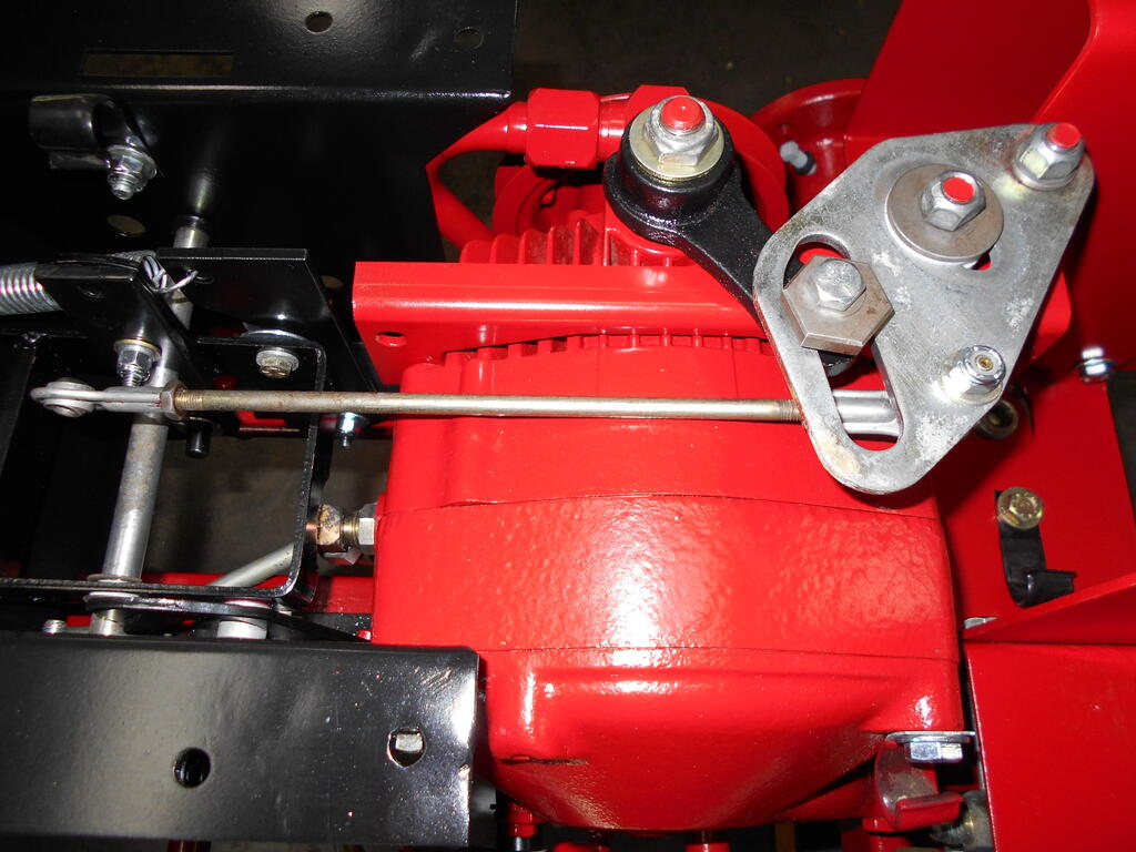

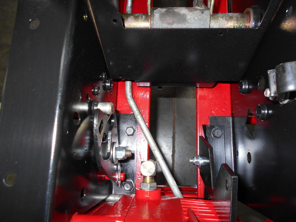

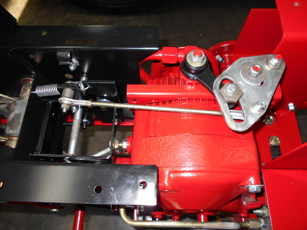

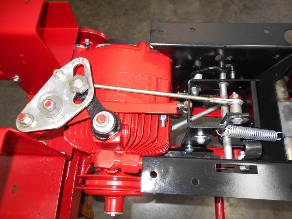

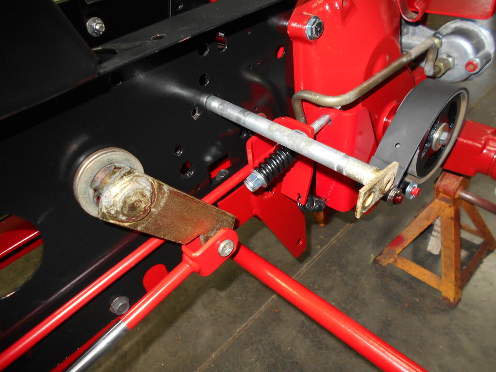

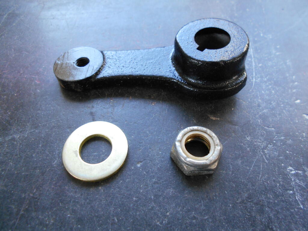

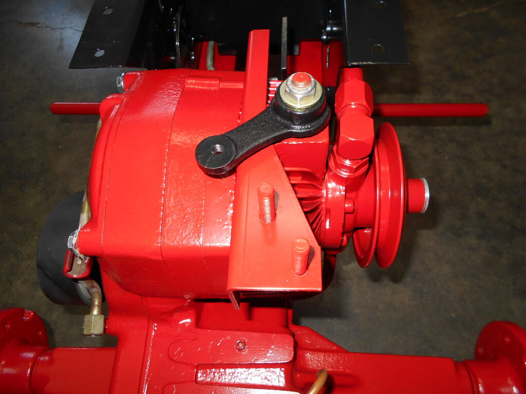

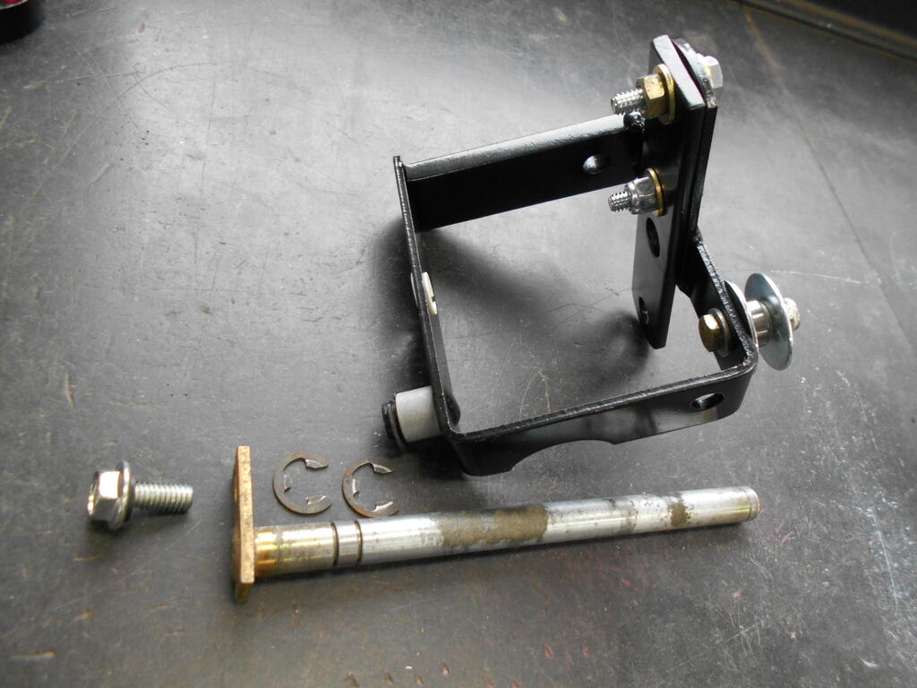

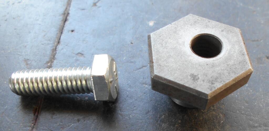

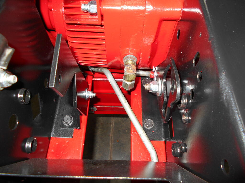

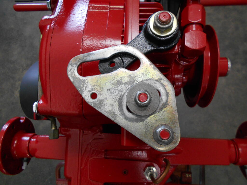

cleat 9,442 #153 Posted December 1, 2025 Hydro cam follower arm ready to install. Hydro cam follower arm installed. I put a tint bit of never seize on the male threads but kept the taper dry. Nut tightened by hand (I was afraid an impact would over tighten and possibly crack the arm on the taper) while holding the arm so as not to break anything in the hydro unit. 5 Share this post Link to post Share on other sites

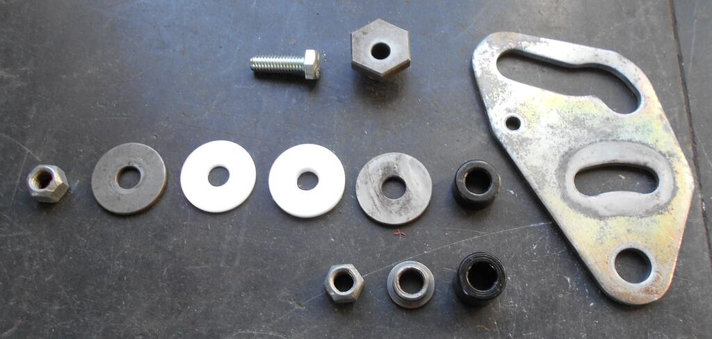

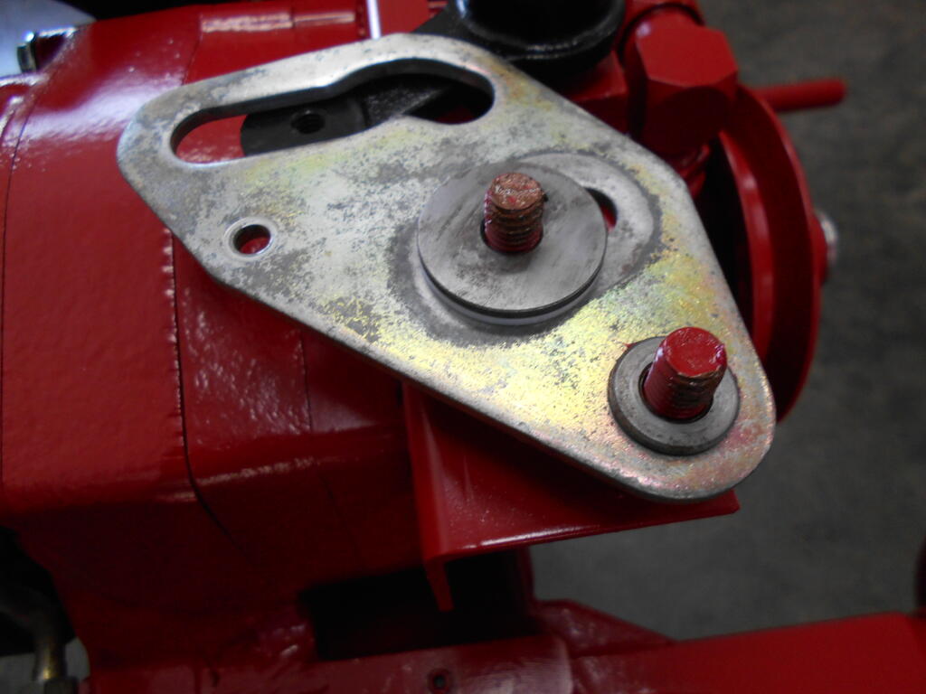

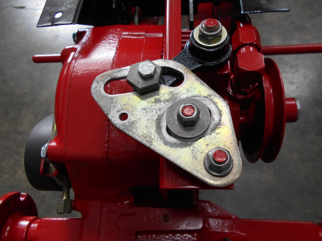

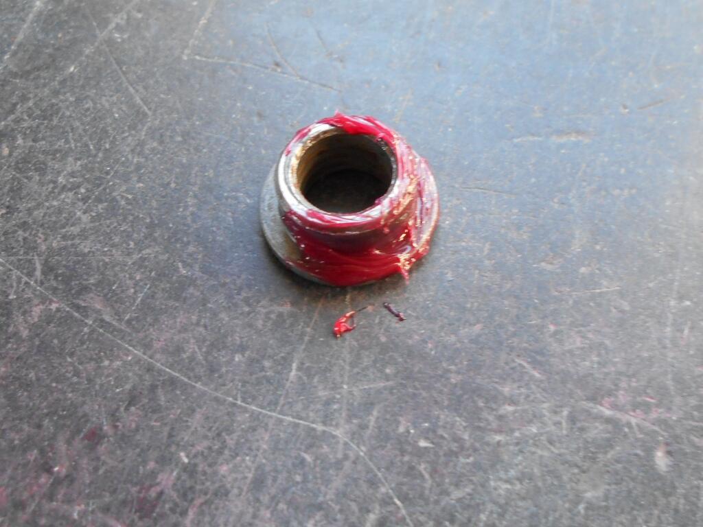

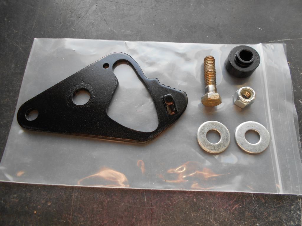

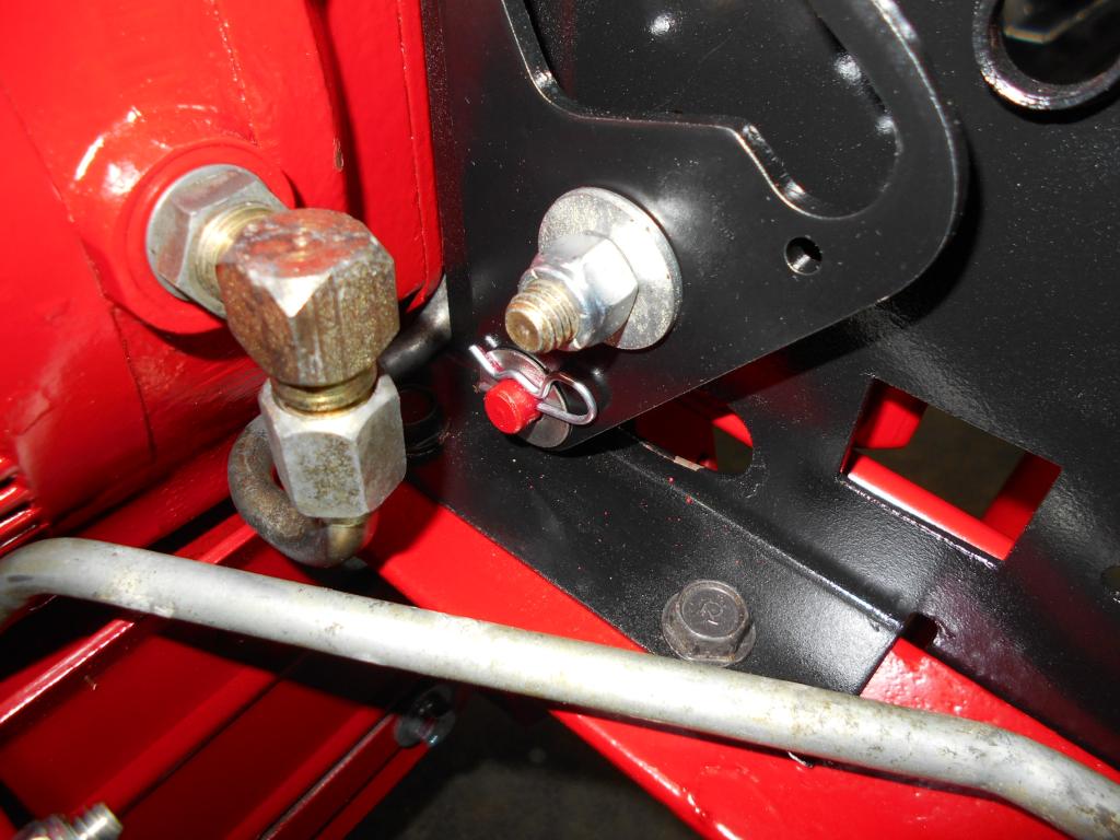

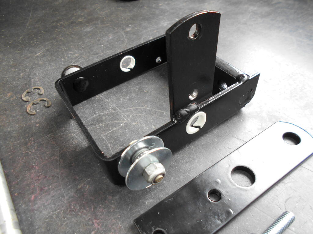

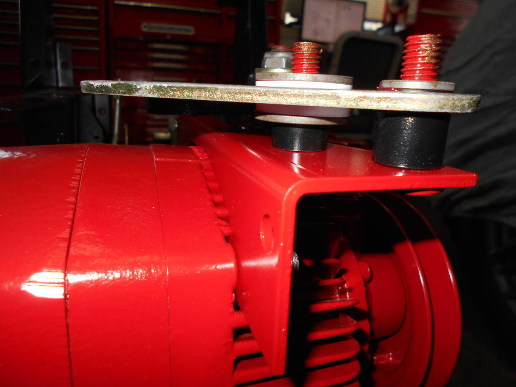

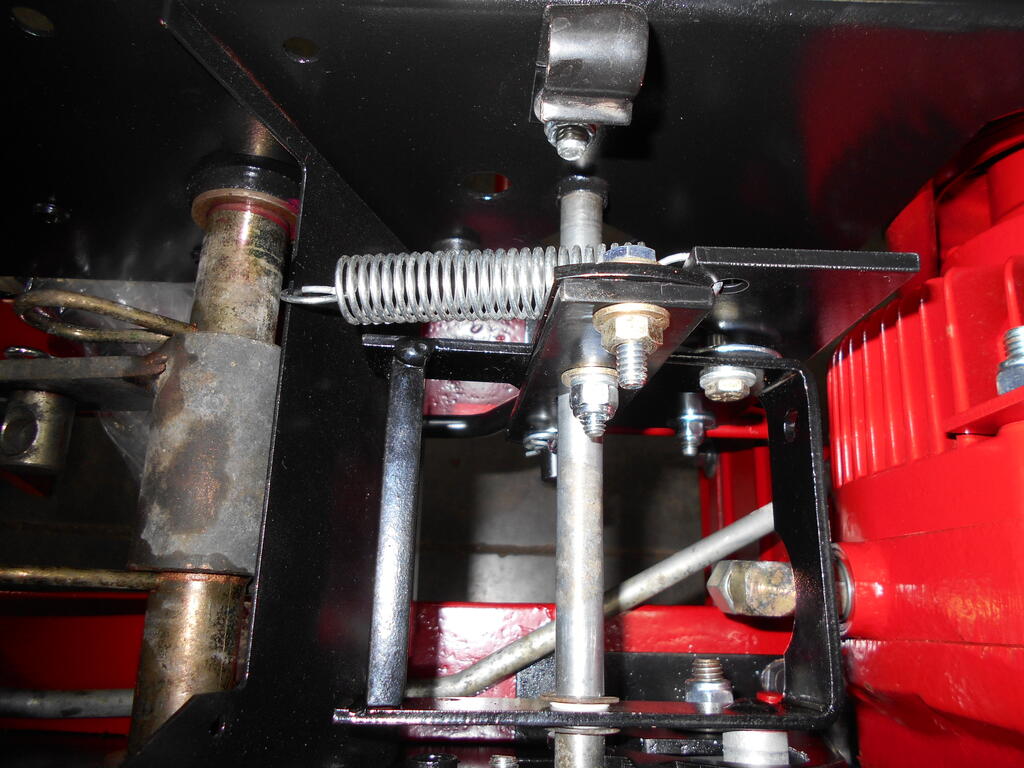

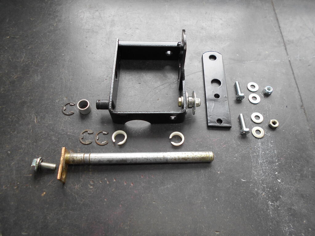

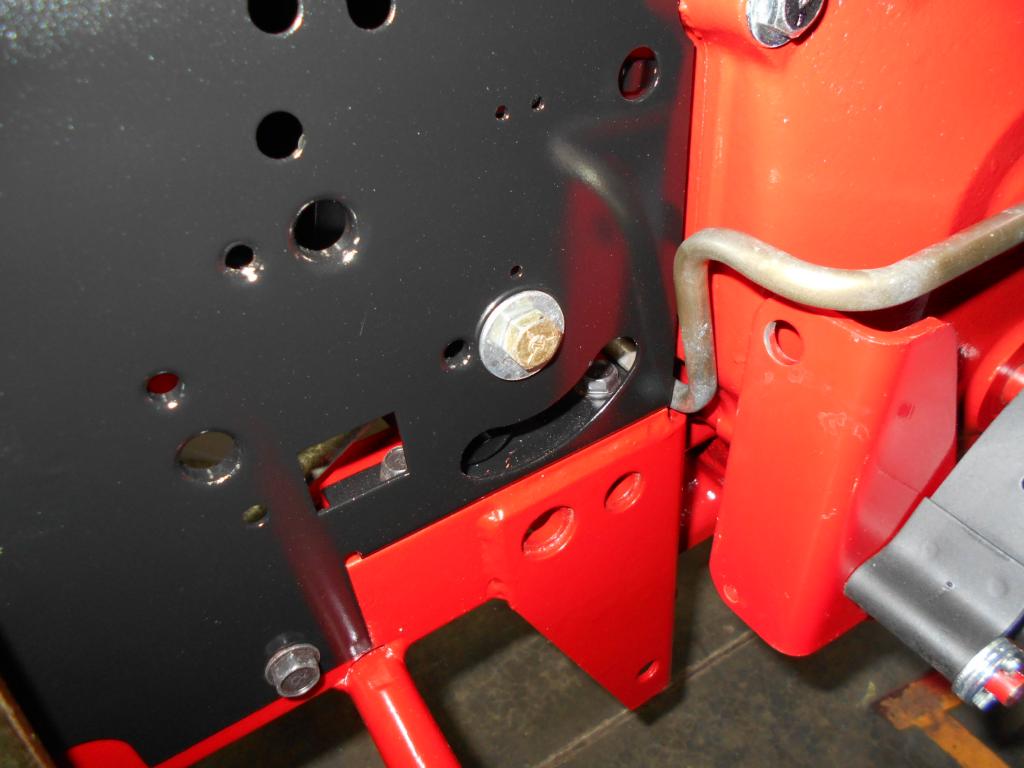

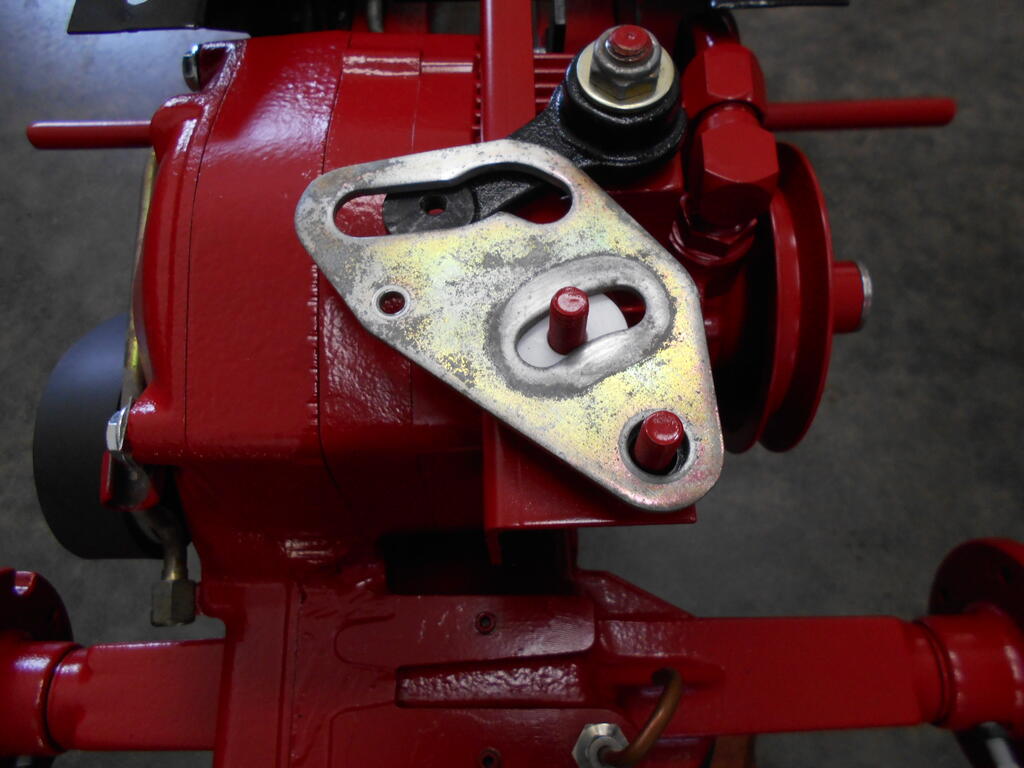

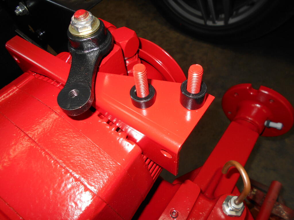

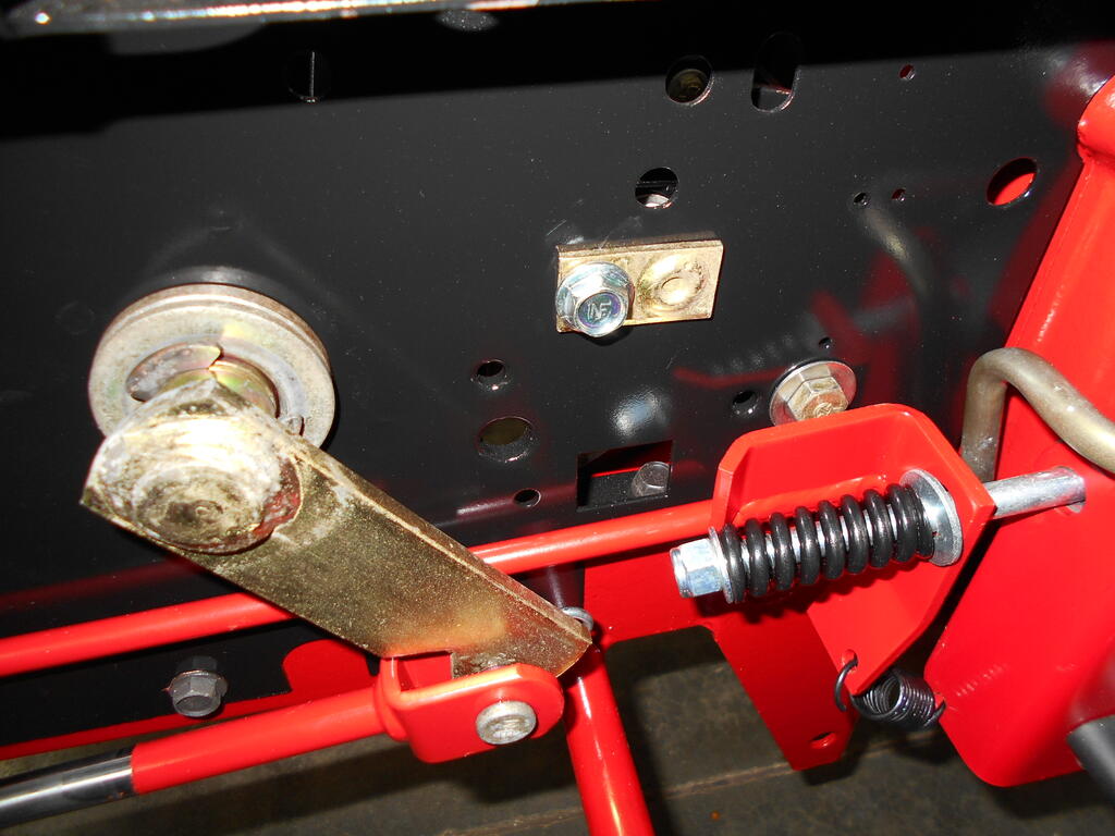

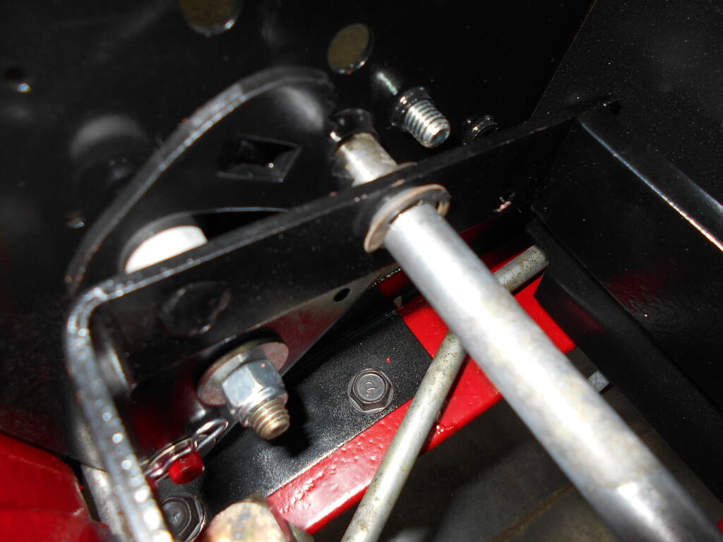

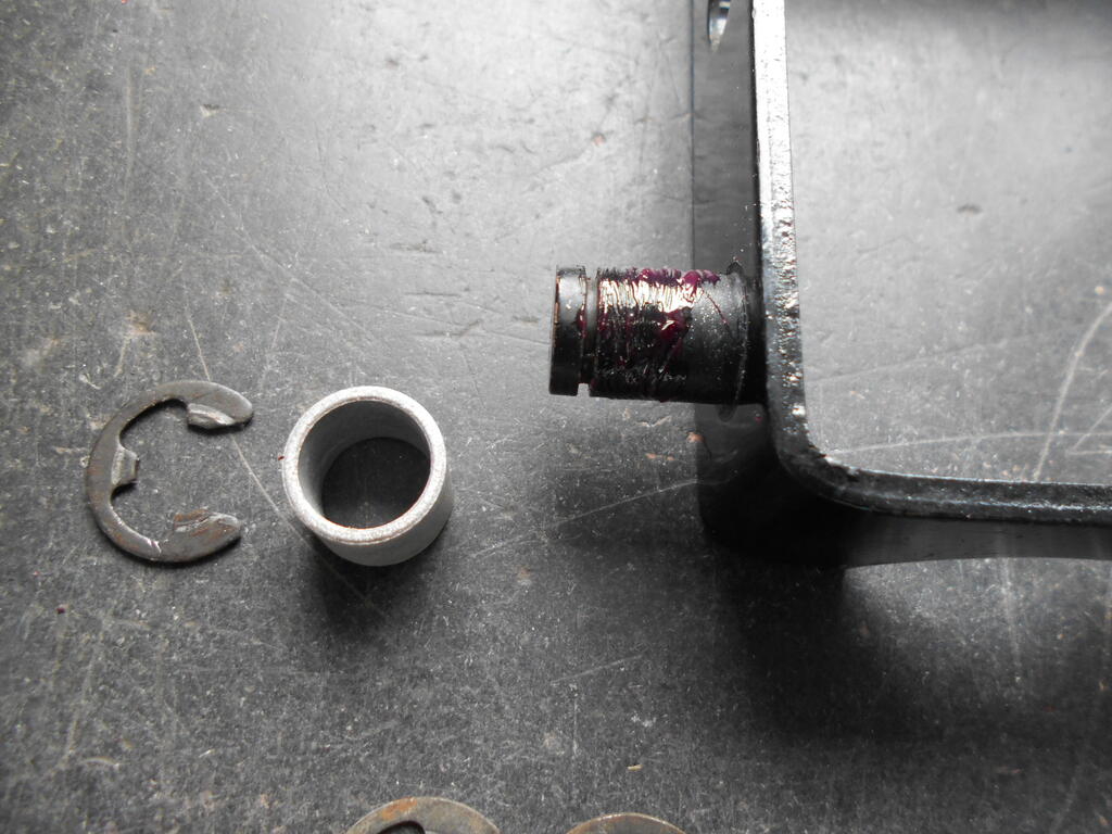

cleat 9,442 #154 Posted December 1, 2025 (edited) Hydro speed control cam plate assembly ready to install. This machine will have foot control so no tension washers are needed. Instead, I punched out some Teflon washers so cam plate will pivot freely. Hydro speed control cam plate spacers installed onto studs. Hydro speed control cam plate lower washers installed. Hydro speed control cam plate sat into place. Hydro speed control cam plate bushing greased and ready to install. I also put a little never seize on the studs. Hydro speed control cam plate upper washers and bushing installed. Hydro speed control cam plate locknuts installed. Nut on bushing stud was firmly tightened. Nut on washers was just turned in until there was little to no free play but the plate will pivot side to side freely. Hydro speed control eccentric cam ready to be installed. Hydro speed control eccentric cam installed and rotated so large side faces the long slot on the cam plate as per the manual. Bolt tightened. You will need a 1" and a 1/2" wrench to do this. Tractor overview as of today. Edited December 1, 2025 by cleat 1 7 Share this post Link to post Share on other sites
ebinmaine 81,274 #155 Posted December 2, 2025 9 hours ago, cleat said: Hydro cam follower arm @JCM has one of these on a rebuilt transmission that's broken basically in half. How does that get removed from the transmission? Special puller? 2 Share this post Link to post Share on other sites
cleat 9,442 #156 Posted December 2, 2025 2 hours ago, ebinmaine said: @JCM has one of these on a rebuilt transmission that's broken basically in half. How does that get removed from the transmission? Special puller? I just loosen the nut a few turns and then use a small 2 jaw puller. Once it pops free of the taper it should just lift off once the nut is removed. Do not pry on it or force it in either direction loosening or tightening the nut as internal transmission damage could occur. 3 2 Share this post Link to post Share on other sites

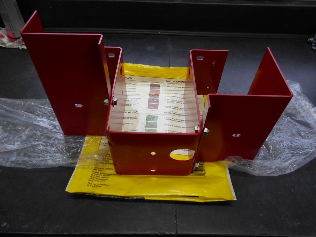

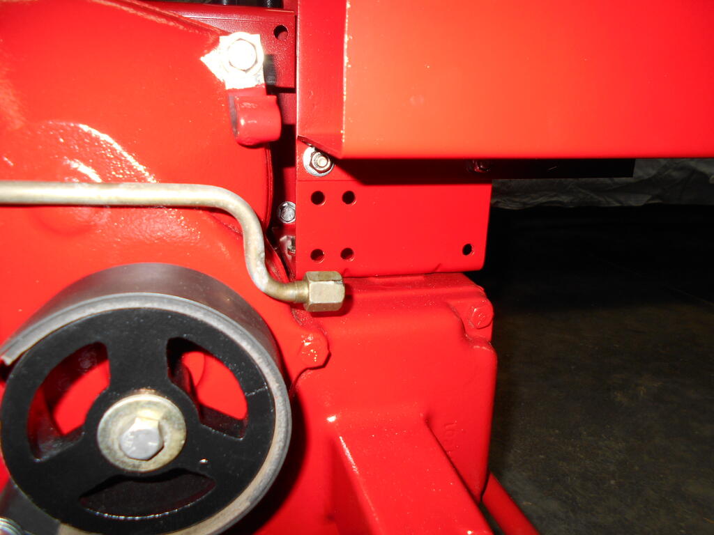

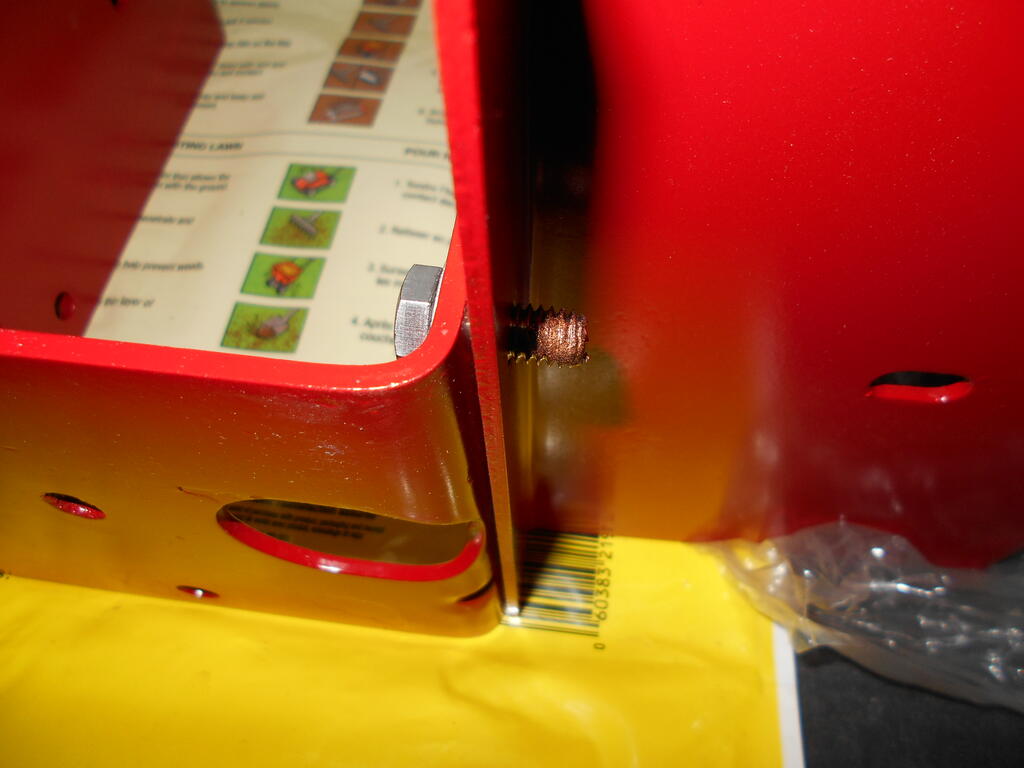

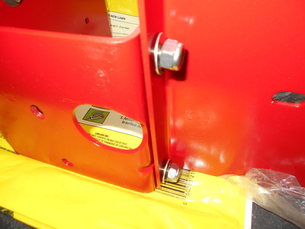

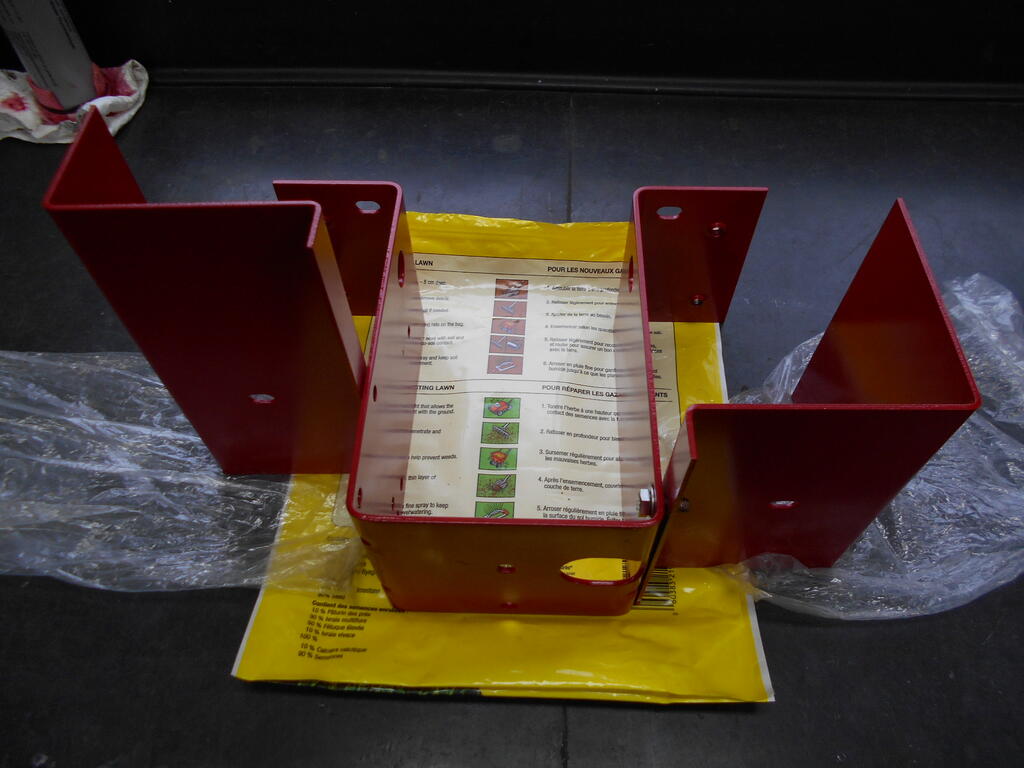

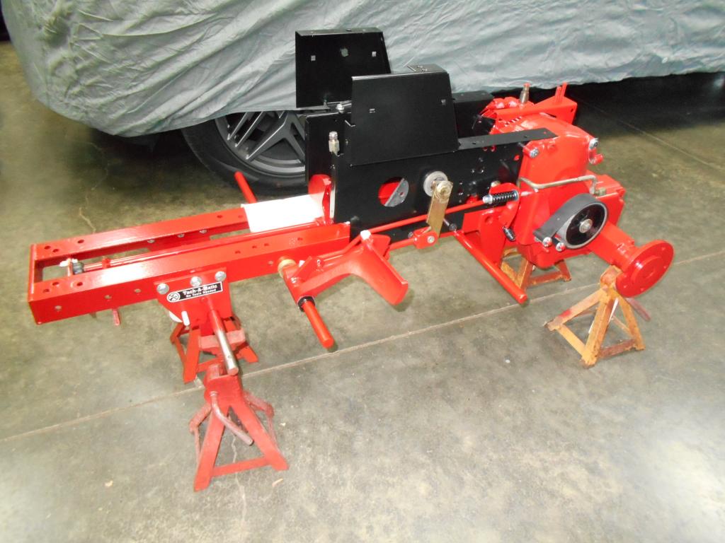

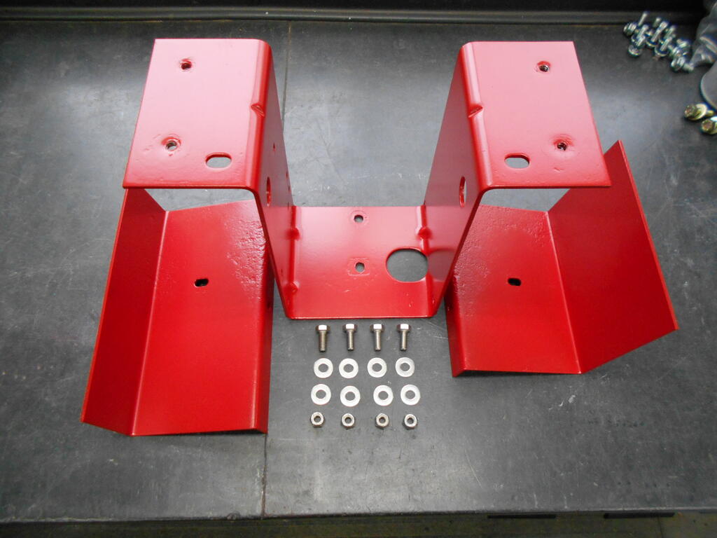

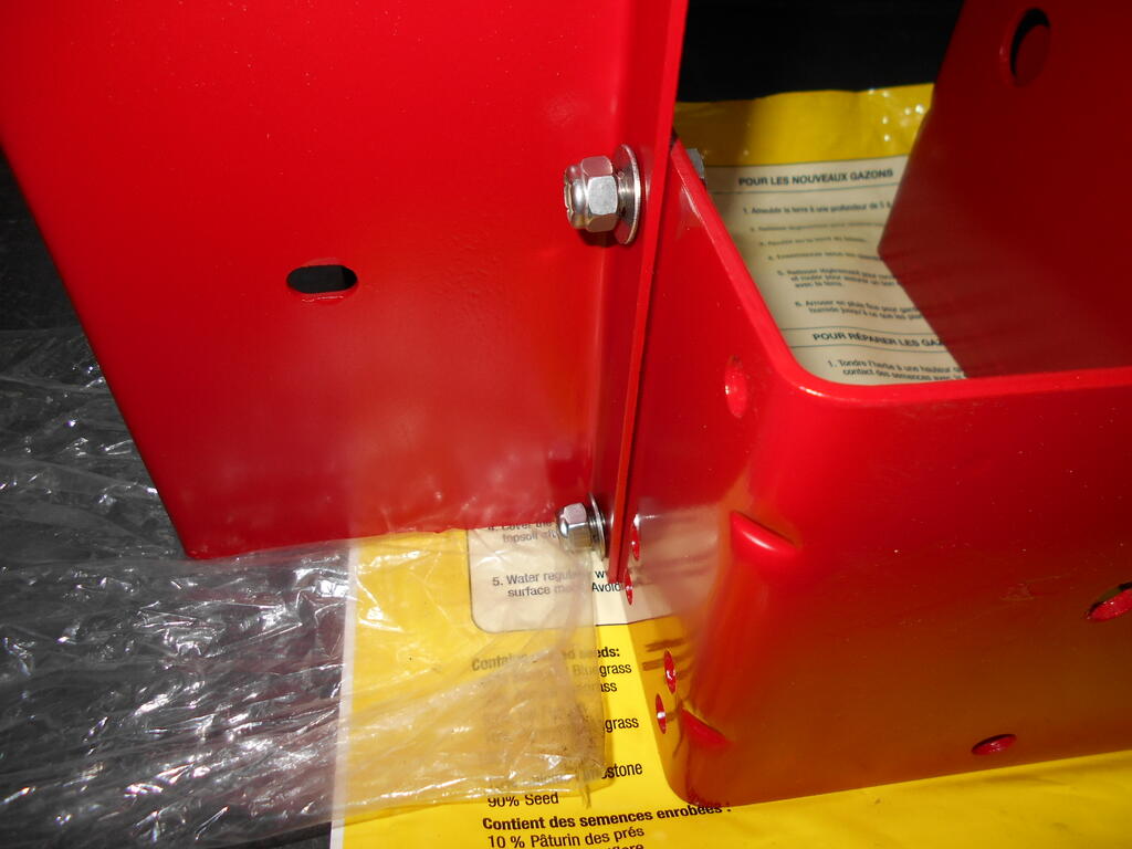

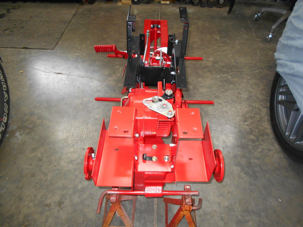

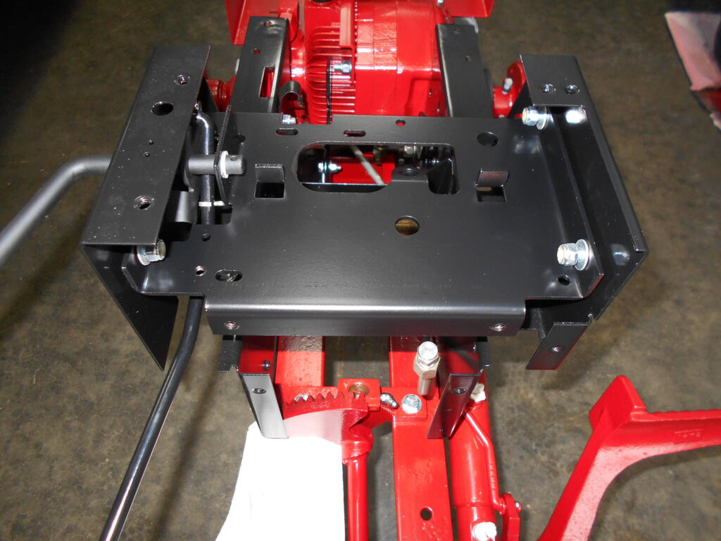

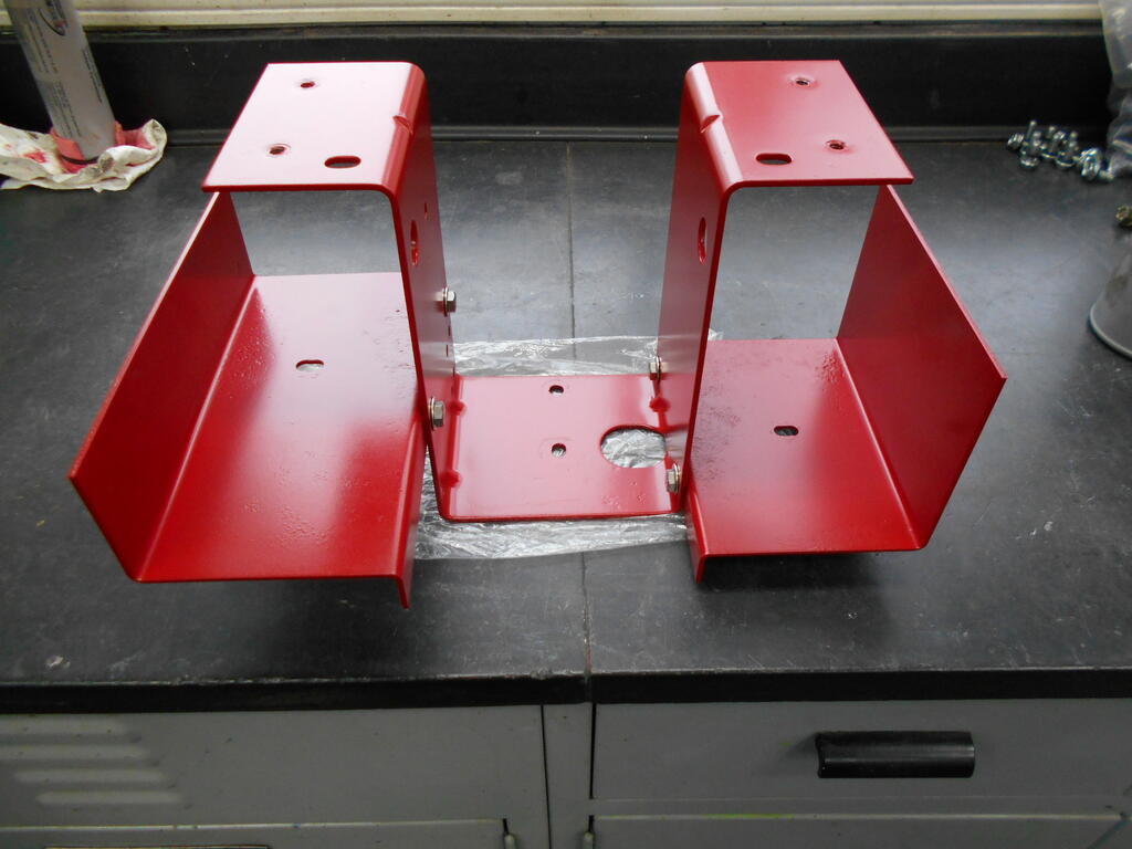

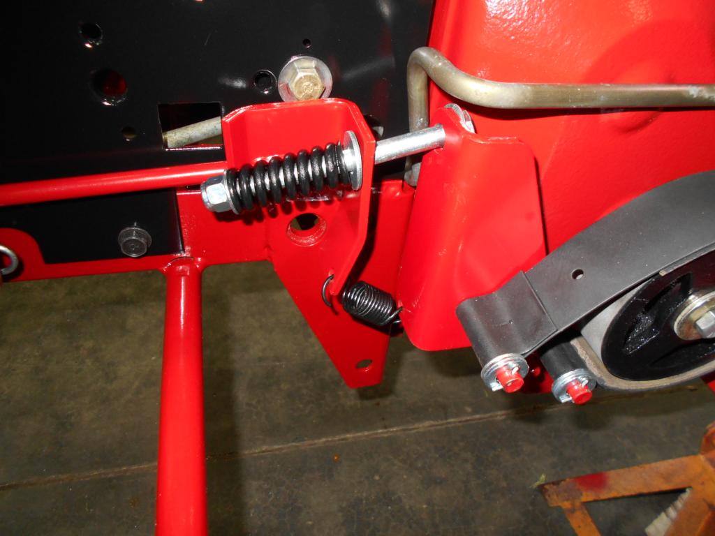

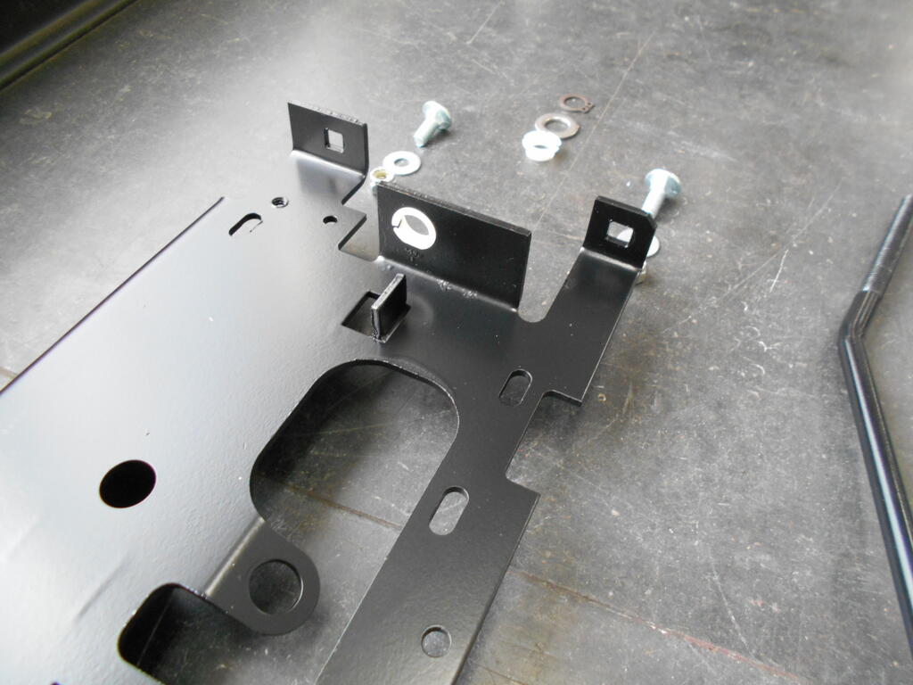

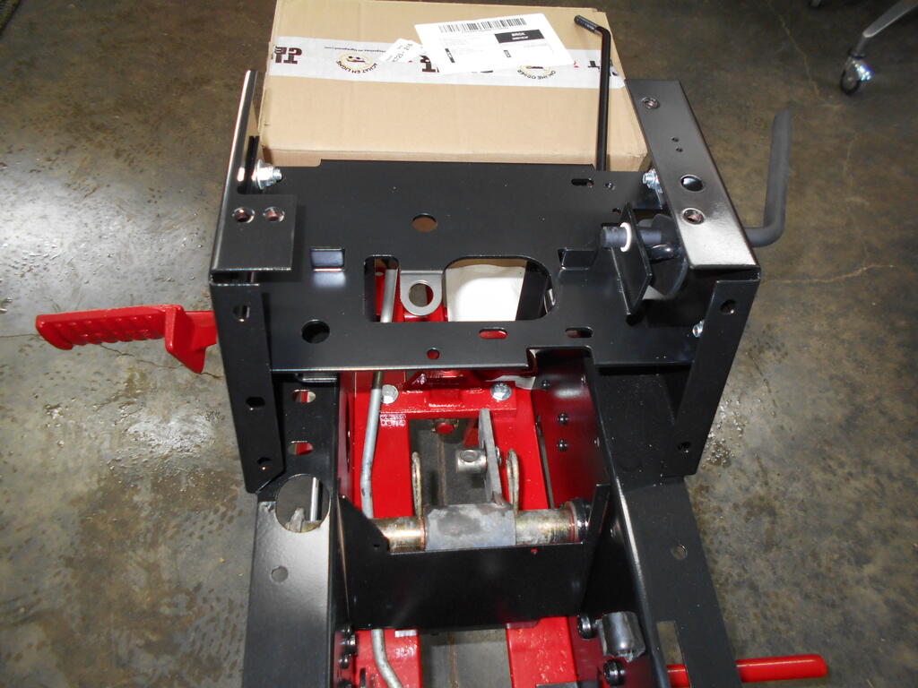

cleat 9,442 #157 Posted December 2, 2025 Fuel tank supports ready to be bolted to fender support bracket. Fuel tank supports and fender support bracket laid down flat on the front side. Bolts all loosely installed after getting a smear of never seize to prevent galling (these are SS bolts). All 4 bolts torqued to 17 ft/lb. 3 5 Share this post Link to post Share on other sites

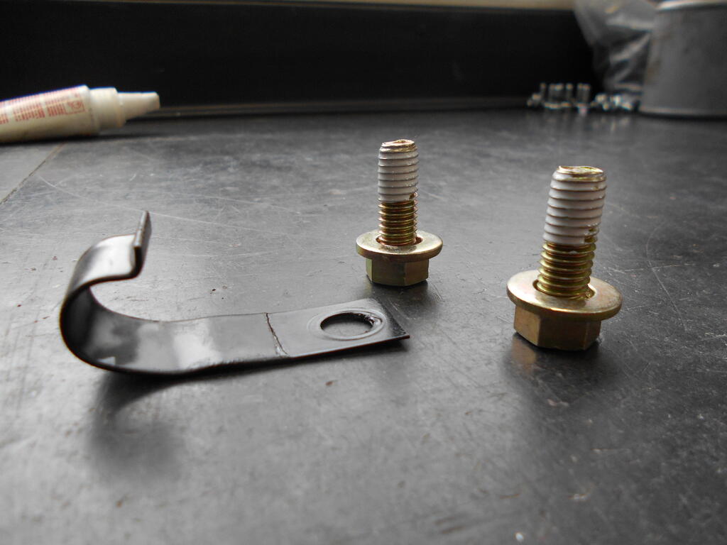

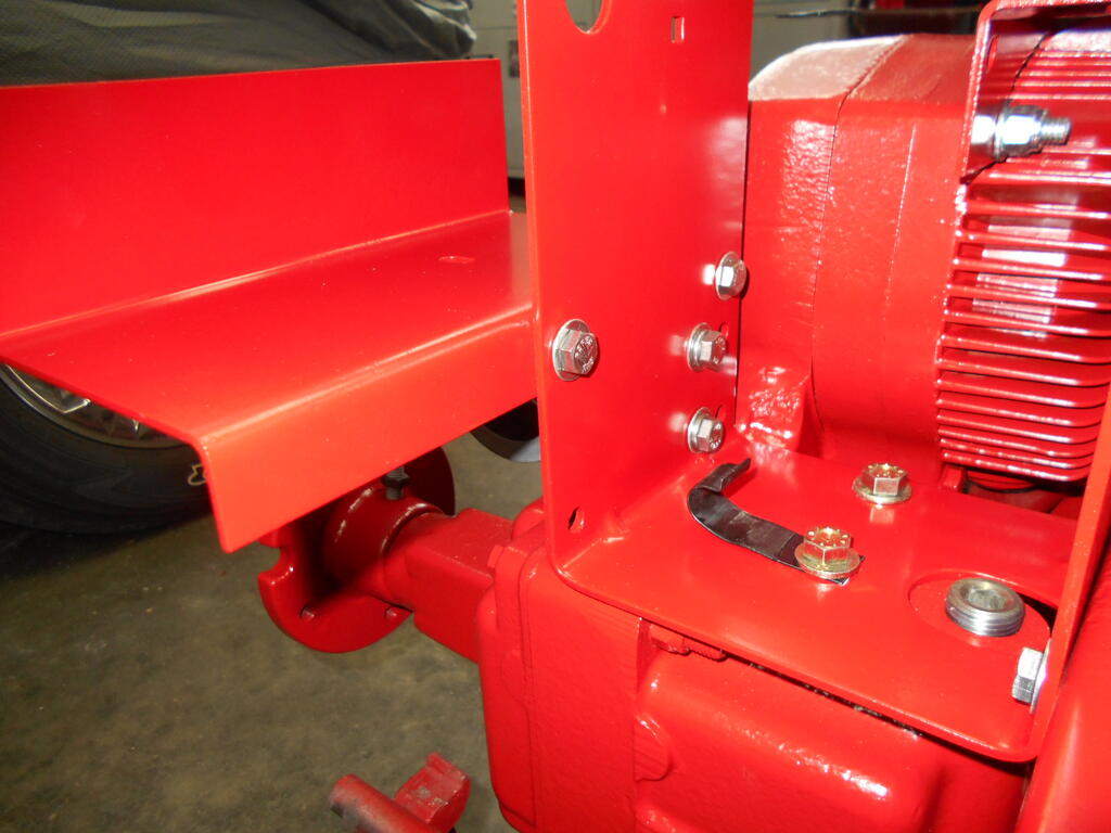

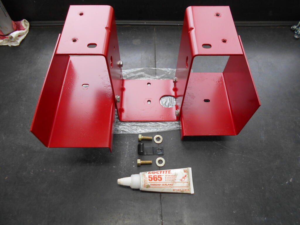

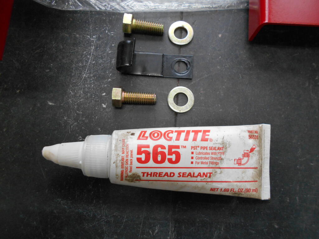

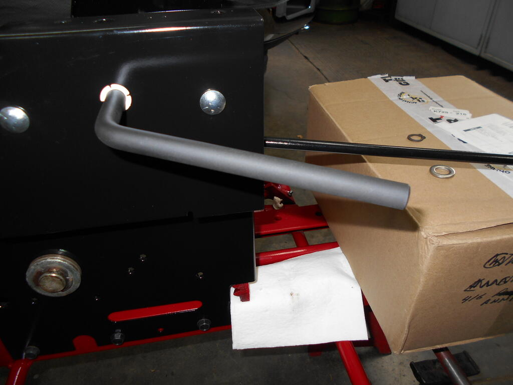

cleat 9,442 #158 Posted December 2, 2025 Fender bracket assembly ready to install. Note the liquid Teflon sealant used on the bolt threads to keep water out and oil in. Do not use Teflon tape as bits of it may end up in the hydro unit causing issues down the road. Tractor ready to receive fender bracket. Sealant was applied to the bolts ensuring there is none on the end of the bolts to get into the transmission. Fender bracket sat into place then the bolts were screwed in finger tight. I then measured between the fender bracket and the hood stand on both sides and fender bracket was moved until the measurements were the exact same on both sides. There is just enough free play in the bolt holes for a bit of adjustment. This should ensure the fender bracket is square and even. Fender support bots were torqued to 26 ft/lb. Tractor as it sits today. 6 4 Share this post Link to post Share on other sites

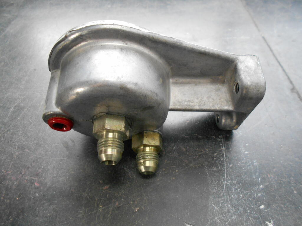

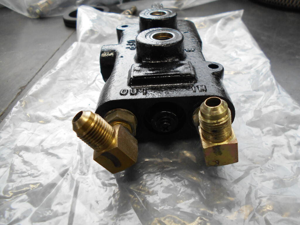

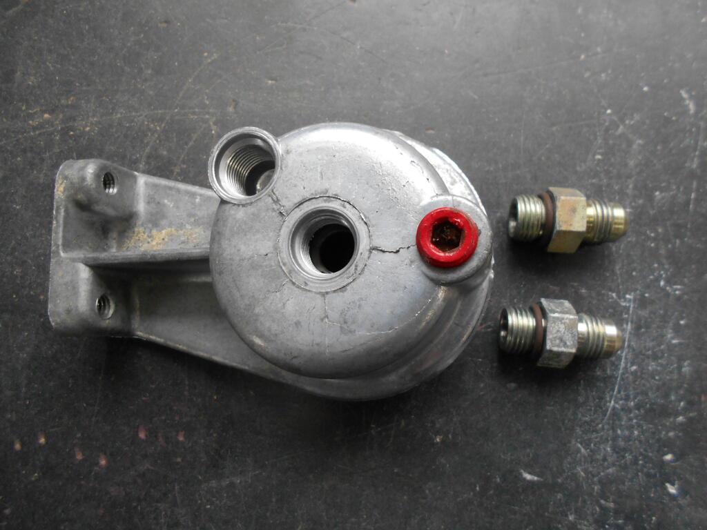

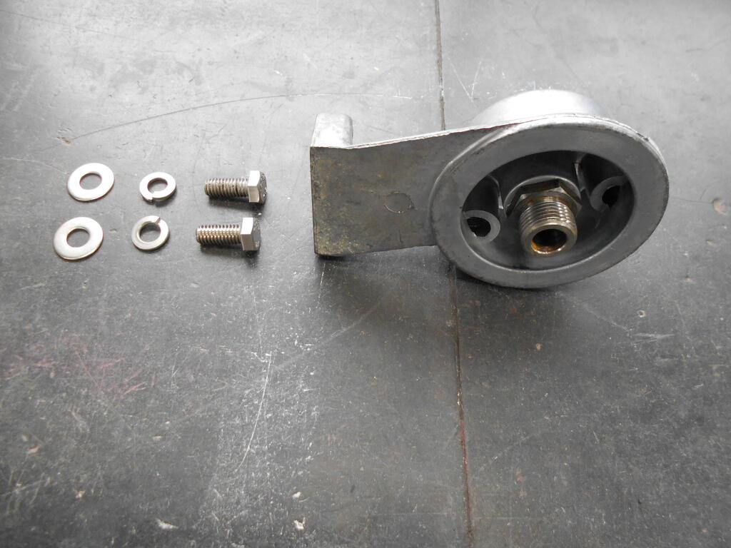

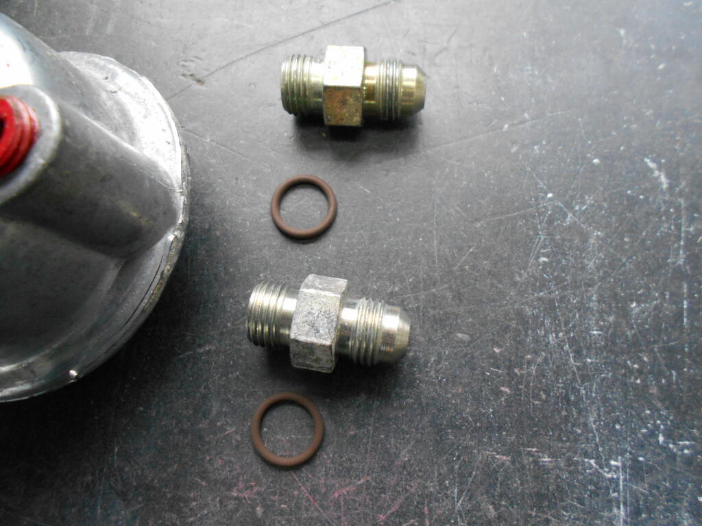

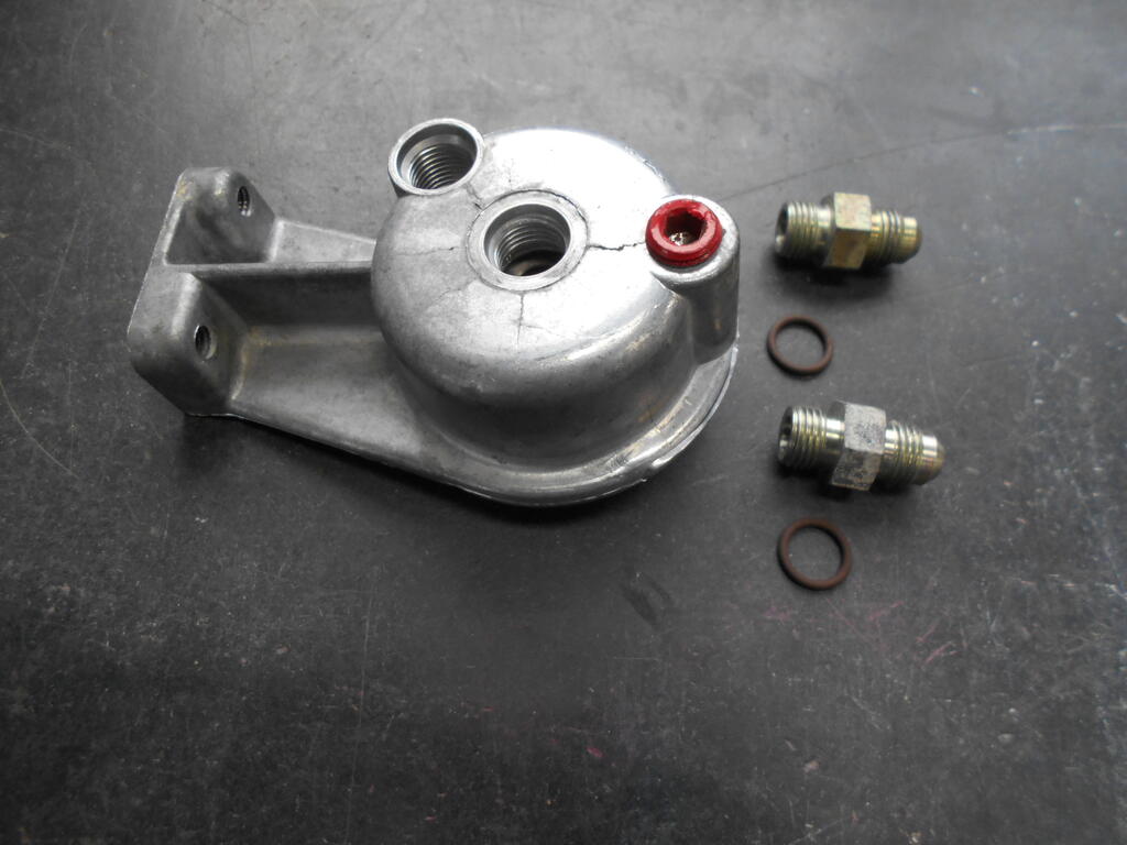

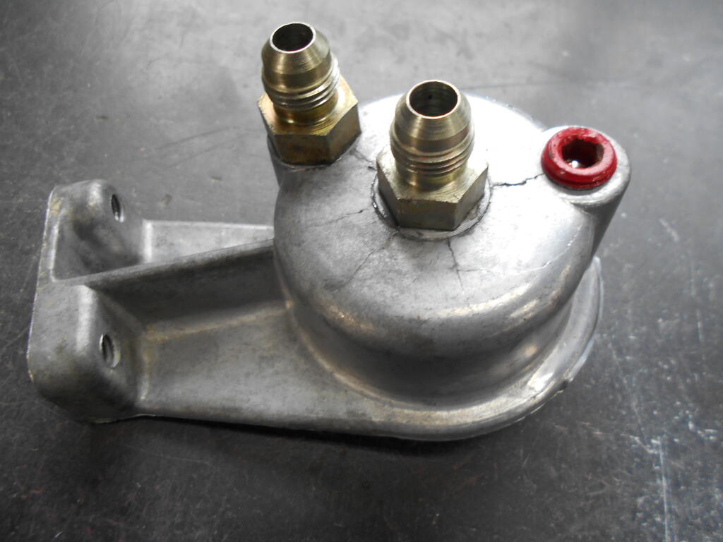

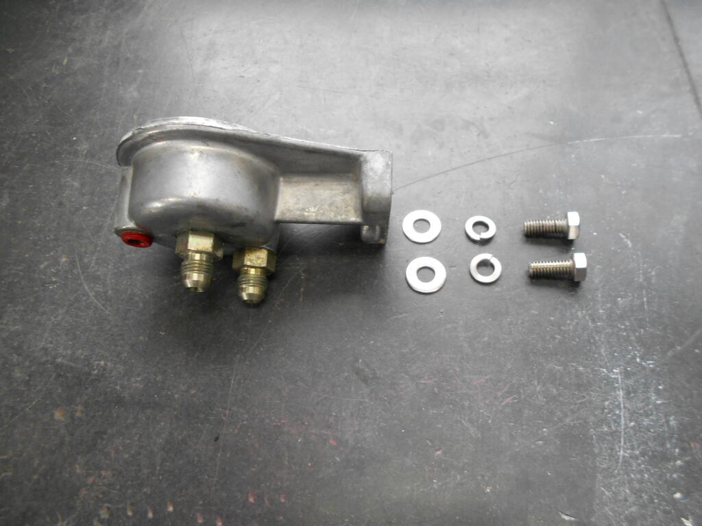

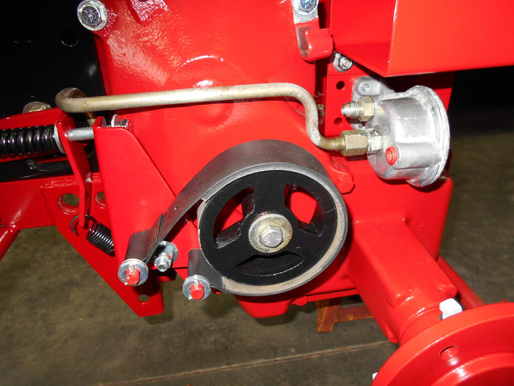

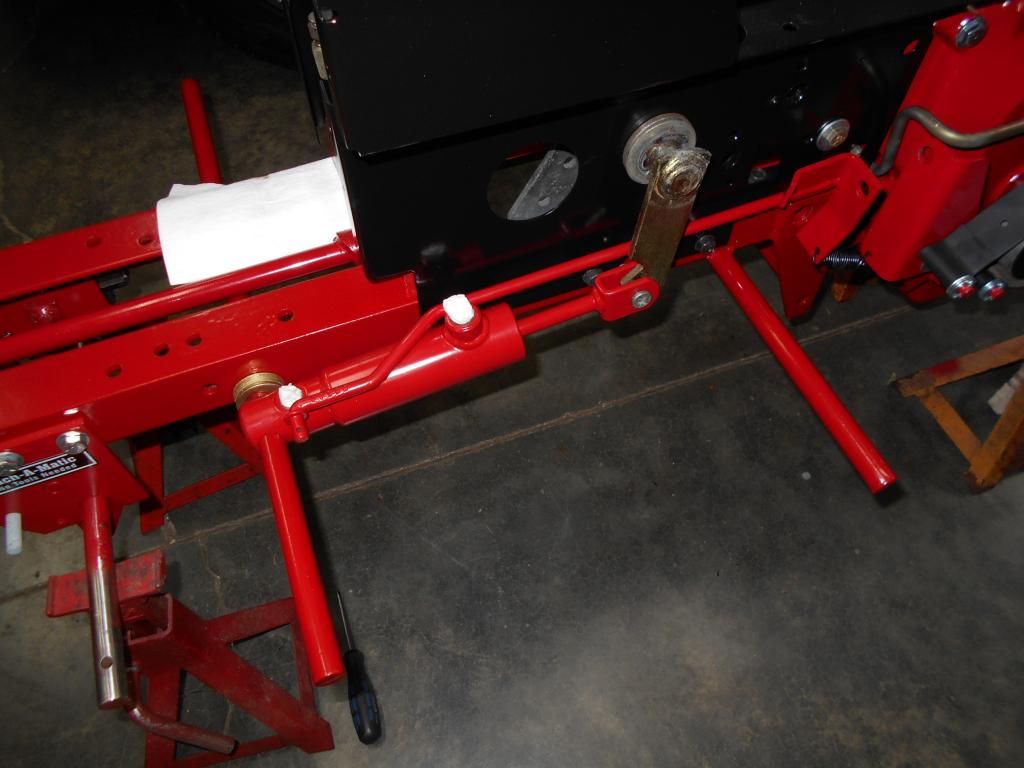

cleat 9,442 #159 Posted December 3, 2025 Hydraulic oil filter base fittings ready to install. Hydraulic oil filter base fittings #906 Viton "O" rings ready to install. Hydraulic oil filter base fittings #906 Viton "O" rings installed. Hydraulic oil filter base fittings 'O' rings oiled then fittings screwed into base and tightened. 6 Share this post Link to post Share on other sites

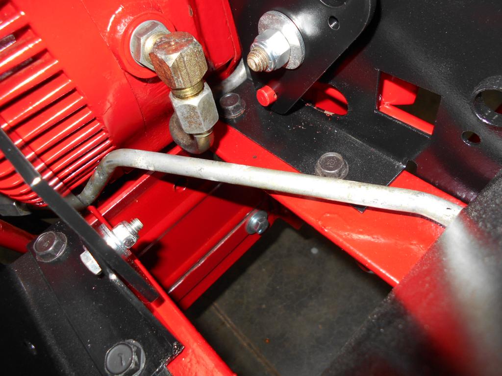

cleat 9,442 #160 Posted December 3, 2025 (edited) Hydraulic oil filter base ready to be installed. Note the extra set of holes for the filter base mount in the fender support bracket. The two rear holes are used for rigid supply and return tubing to the valve and the front holes are used when rubber hoses are used for the supply and return lines. Hydraulic oil filter base installed. Hydraulic return line fittings tightened at rear axle and filter base. Edited December 3, 2025 by cleat 7 Share this post Link to post Share on other sites

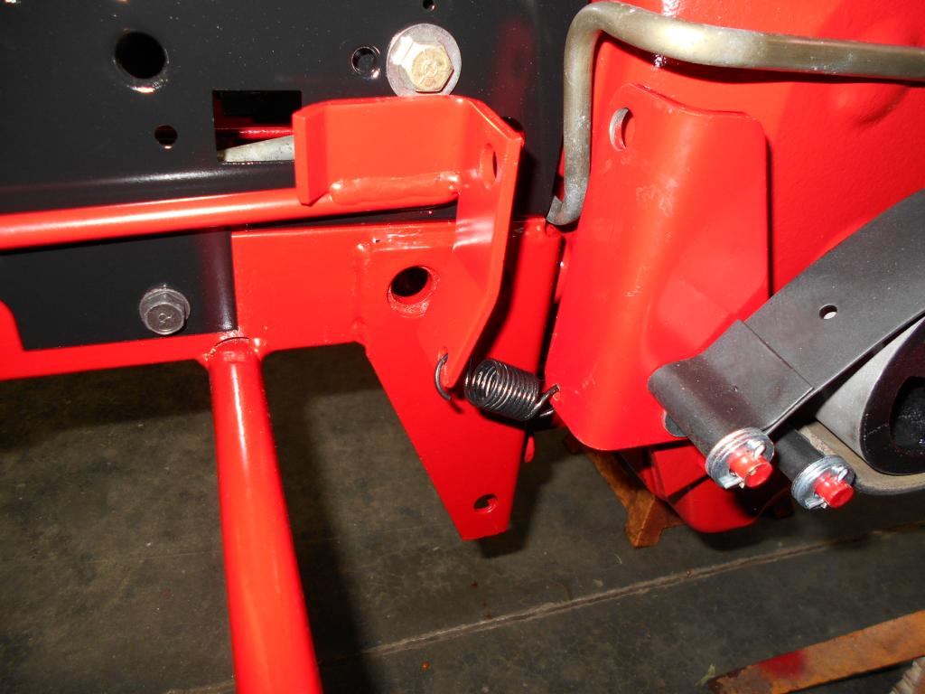

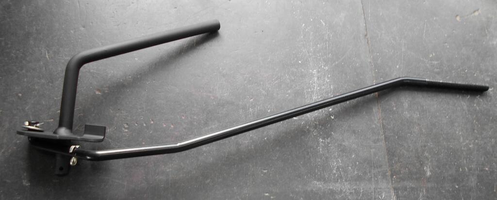

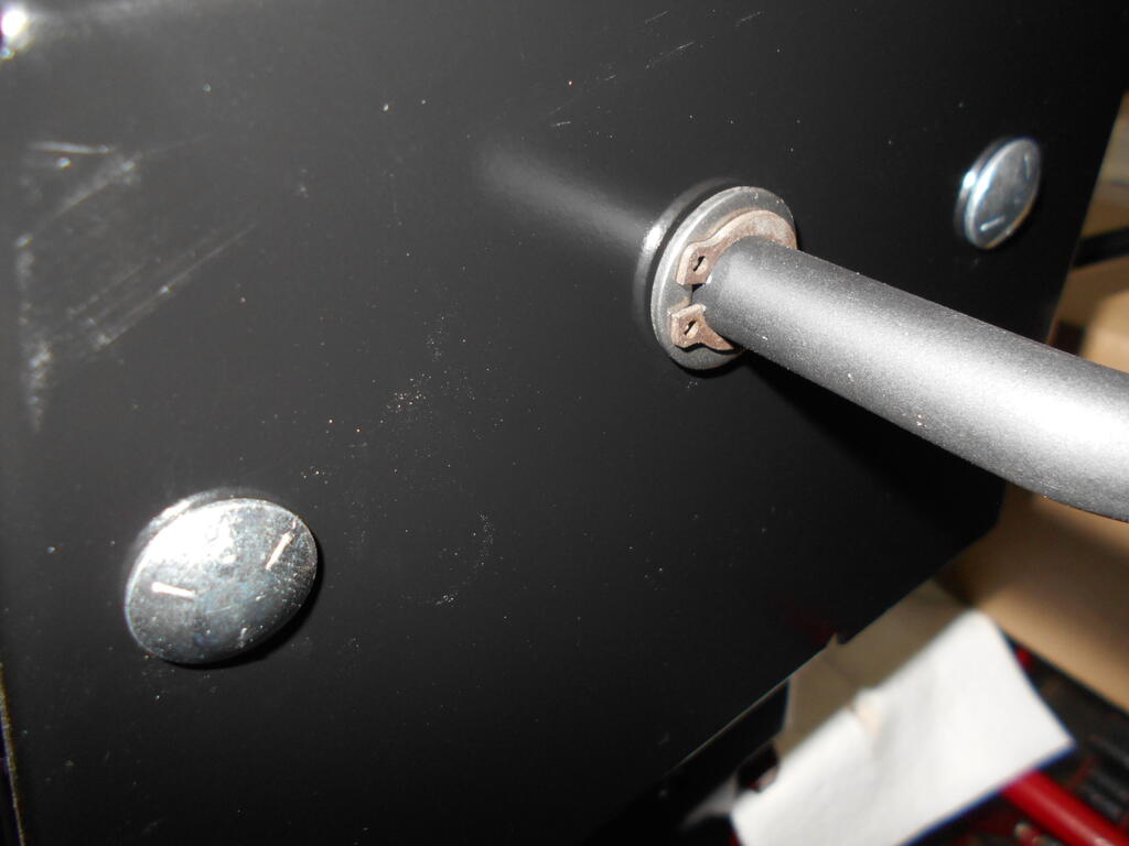

cleat 9,442 #161 Posted December 4, 2025 PTO clutch lever and rod ready to be assembled. PTO clutch release spring cotter pin installed. PTO clutch lever and rod assembled. 4 Share this post Link to post Share on other sites
953 nut 70,648 #162 Posted December 5, 2025 (edited) On 12/1/2025 at 7:12 PM, ebinmaine said: @JCM has one of these on a rebuilt transmission that's broken basically in half. How does that get removed from the transmission? Special puller? I use two small chisels facing in opposite directions one on each side of the base of the arm. Tap them lightly a couple of times each and the arm will pop off. Edited December 5, 2025 by 953 nut fat finger 2 Share this post Link to post Share on other sites

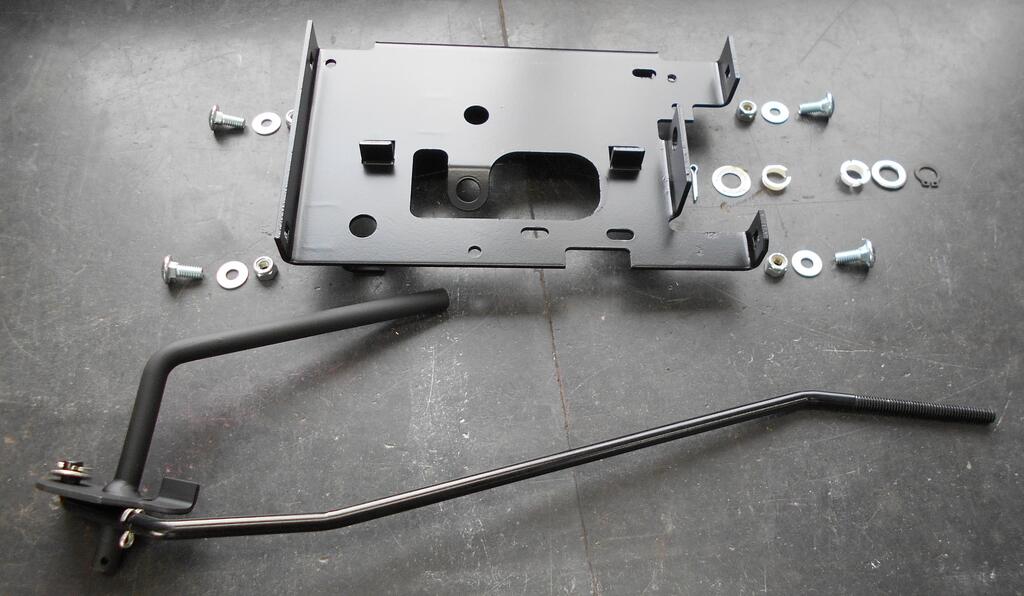

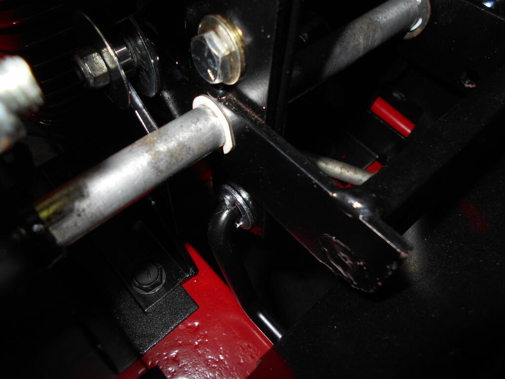

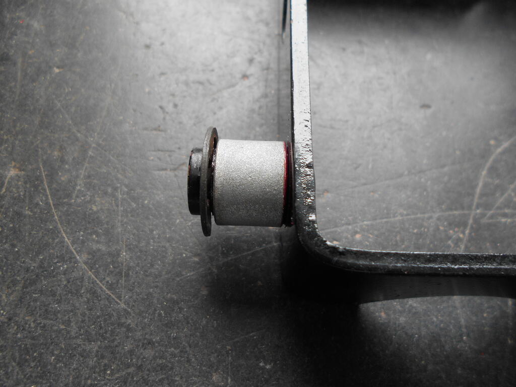

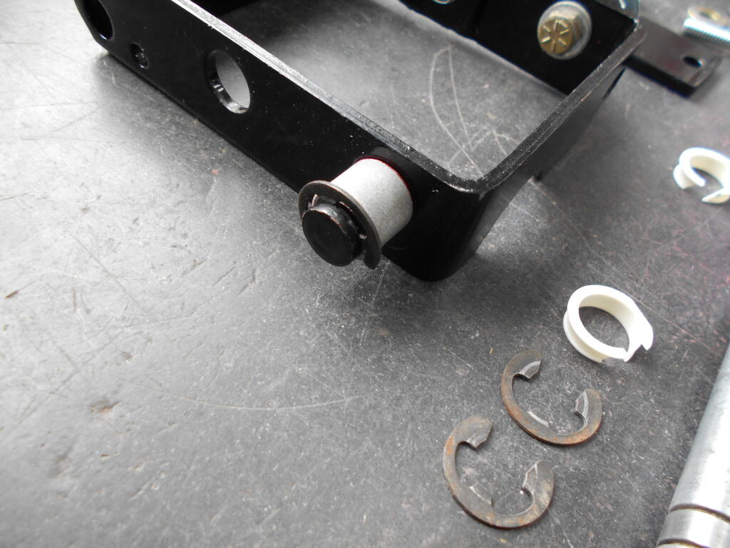

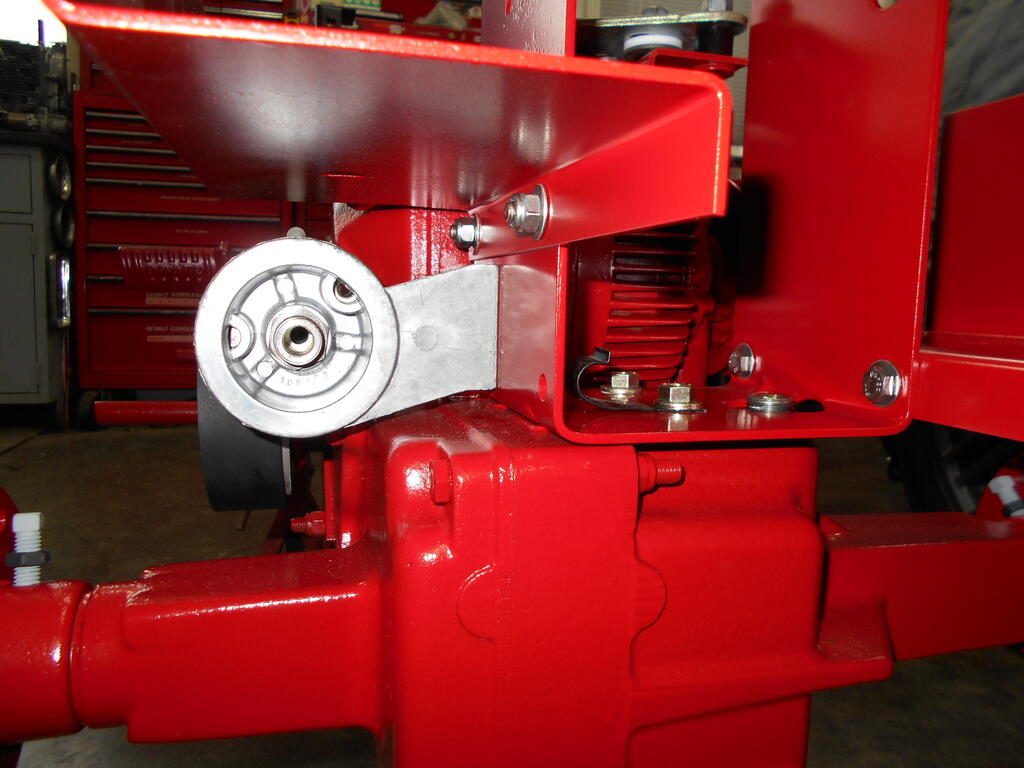

cleat 9,442 #163 Posted December 5, 2025 (edited) Battery support bracket and PTO clutch assembly ready to install. Nyliner bushing 5983 installed into battery support bracket. Picture shows the slit facing the front but at final assembly the slit should be facing the rear as the PTO lever gets pulled forward when clutch is engaged. PTO clutch lever slid into hole in side of hood stand. PTO rod supported on box. Battery support bracket slid onto PTO clutch lever then all 4 bolts loosely installed. Battery support bracket bolts torqued to 204 in-lb. Edited December 5, 2025 by cleat 2 Share this post Link to post Share on other sites
cleat 9,442 #164 Posted December 5, 2025 PTO clutch lever cotter pin slid into hole without washer. This will make the next steps easier. PTO clutch lever 5666 nyliner bushing installed. I rotated it so the slit in it faces rearward as when the clutch is engaged it pulls the clutch lever forwards. PTO clutch lever washer slid on then grip ring installed as close to the washer as possible. PTO clutch lever cotter pin and washer installed. If you have the grip ring in the right place there should be no in and out play of the clutch lever but it should rotate easily. 5 2 Share this post Link to post Share on other sites

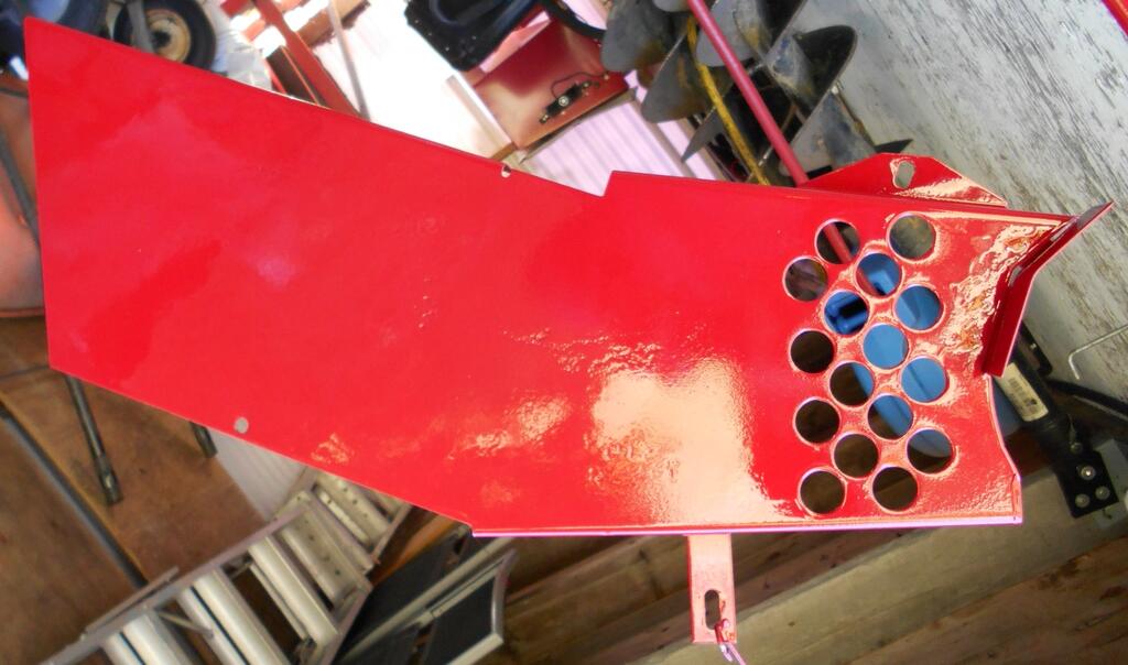

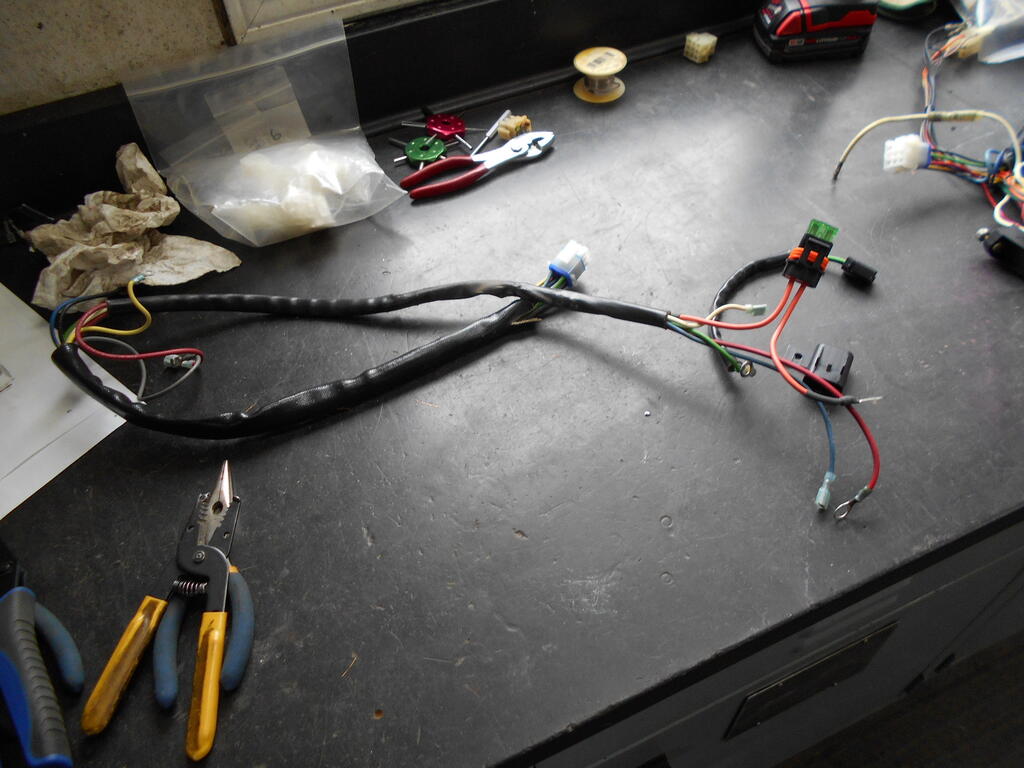

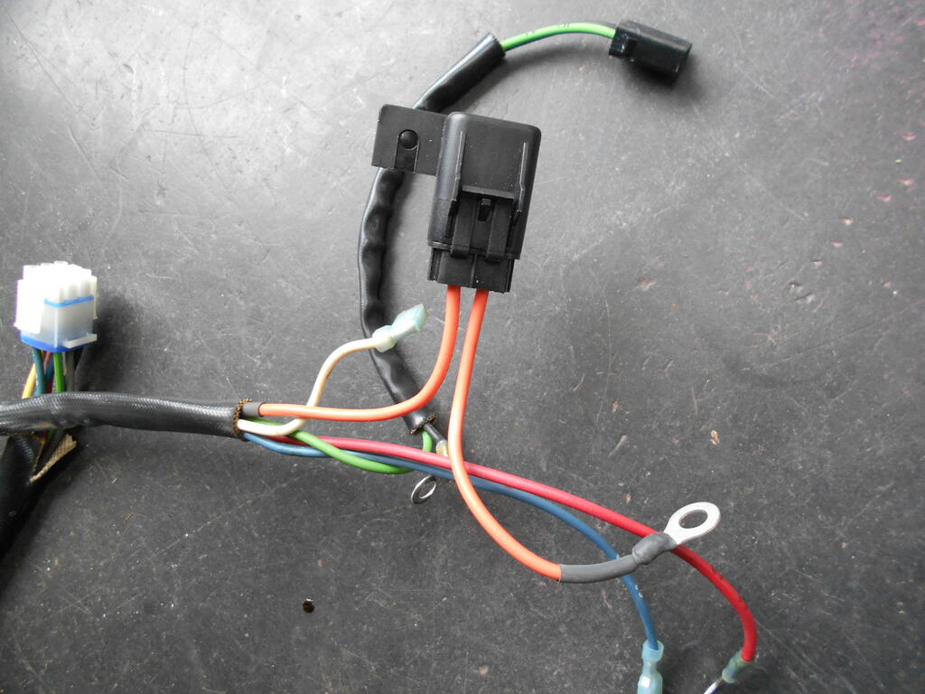

peter lena 10,123 #165 Posted December 5, 2025 @cleat on the toasty wiring , might get a metal shop hole punch , to aerate the belt drive guard , big heat removal increase , easily look up related patterns on line , you could also change the original wire routing to be closer to increased hot air discharge. repetitive . issue , showing you the way , just a thought , pete 1 Share this post Link to post Share on other sites
ebinmaine 81,274 #166 Posted December 6, 2025 20 hours ago, cleat said: PTO clutch lever cotter pin and washer installed. If you have the grip ring in the right place there should be no in and out play of the clutch lever but it should rotate easily. It's those little touches that mean the most to a quality build. 2 1 Share this post Link to post Share on other sites

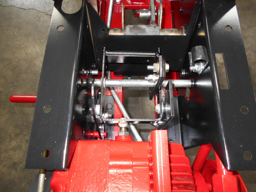

cleat 9,442 #167 Posted December 6, 2025 (edited) Motion control cam assembly ready to install. Foot control auto center bearing is already installed. See Matt's foot control instructions on this. Motion cam control greased where Cam bearing rides. Motion cam bearing installed. Foot control cam pivot lever bolted to control cam. Lower bolt is permanent, upper bolt is temporary until motion control rod gets installed later. Nyliner bushings installed into control cam. Motion control cam pivot rod partly installed. Motion control cam pivot rod installed through control cam nyliner bushings then bolted into place. Motion control cam pivot rod left E clip installed. Motion cam then slid over to the E clip. Motion control cam pivot rod right E clip installed. Foot control auto center lever lines up with motion control cam auto center bearing perfectly. Motion control cam assembly installed. Edited December 6, 2025 by cleat 7 Share this post Link to post Share on other sites
cleat 9,442 #168 Posted December 6, 2025 (edited) 19 hours ago, peter lena said: @cleat on the toasty wiring , might get a metal shop hole punch , to aerate the belt drive guard , big heat removal increase , easily look up related patterns on line , you could also change the original wire routing to be closer to increased hot air discharge. repetitive . issue , showing you the way , just a thought , pete Pete; Thanks for the suggestions. This machine came to me this way so I don't know how it was treated in it's previous life. Being that is was a later model it had the big plastic cover over the PTO. This is not getting re-installed in this build. Here is the belt guard that is going to be used. I use a Greenlee knockout punch normally used in electrical work to punch out the holes. Charge current was removed from the 9 pin and it now ties directly to the battery terminal on the solenoid through a 30A inline fuse as shown below. This fuse is a sealed type to keep out the elements. New sealed 9 pin connectors installed and the wiring will definitely be kept well away from the hot muffler. Edited December 6, 2025 by cleat 2 4 Share this post Link to post Share on other sites
peter lena 10,123 #169 Posted December 6, 2025 @cleat on the toasty wiring , might get a metal shop hole punch , to aerate the belt drive guard , big heat removal increase , easily look up related patterns on line , you could also change the original wire routing to be closer to increased hot air discharge. repetitive . issue , showing you the way , just a thought , pete Share this post Link to post Share on other sites
peter lena 10,123 #170 Posted December 6, 2025 @cleat you are right on it , make a point of original intension , yet more reliable . the knock out holes just make sense , as do the sealed pin connectors , also like the battery terminal connection , improvement . more often than not , just make a simple change , for function and reliability , eliminates a chronic issue . don't have any of the any of the bigger models as you do , but really go on a look see and improve anything . also use cable wrap on my rewire work , along with the peel and stick cable mounts , pete Share this post Link to post Share on other sites

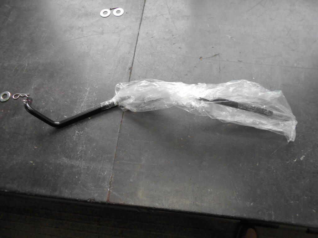

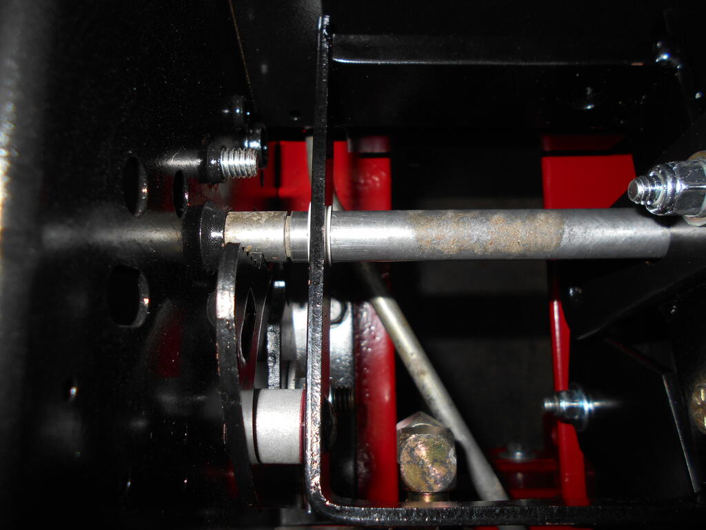

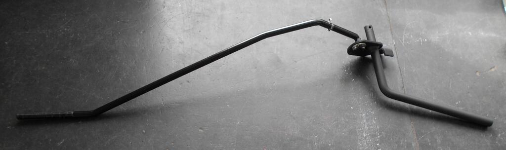

cleat 9,442 #171 Posted December 7, 2025 Foot control rod ready to install. Cotter pin is already installed. Foot control rod inserted into plastic bag to help prevent scratches where it passes through hoodstand until it is connected to foot control pedal. Foot control rod greased where it connects to cam pivot lever. Foot control rod carefully fished into position then a washer was slid onto it up to the cotter pin. Foot control rod was then inserted into the bottom hole of the cam pivot lever that was installed yesterday. Second washer then slid onto the rod and the hairpin clip was inserted. 4 1 Share this post Link to post Share on other sites

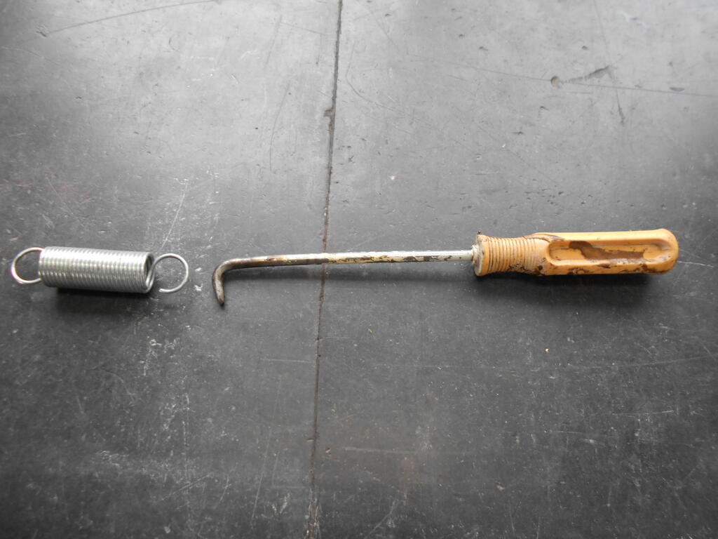

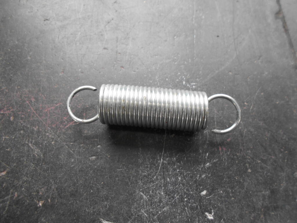

cleat 9,442 #172 Posted December 7, 2025 Foot control auto center spring ready to be installed. Spring hook tool made from an old screwdriver. Foot control auto center spring hooked into auto center lever. Spring hook tool ready to install spring. Foot control auto center spring installed. 5 2 Share this post Link to post Share on other sites

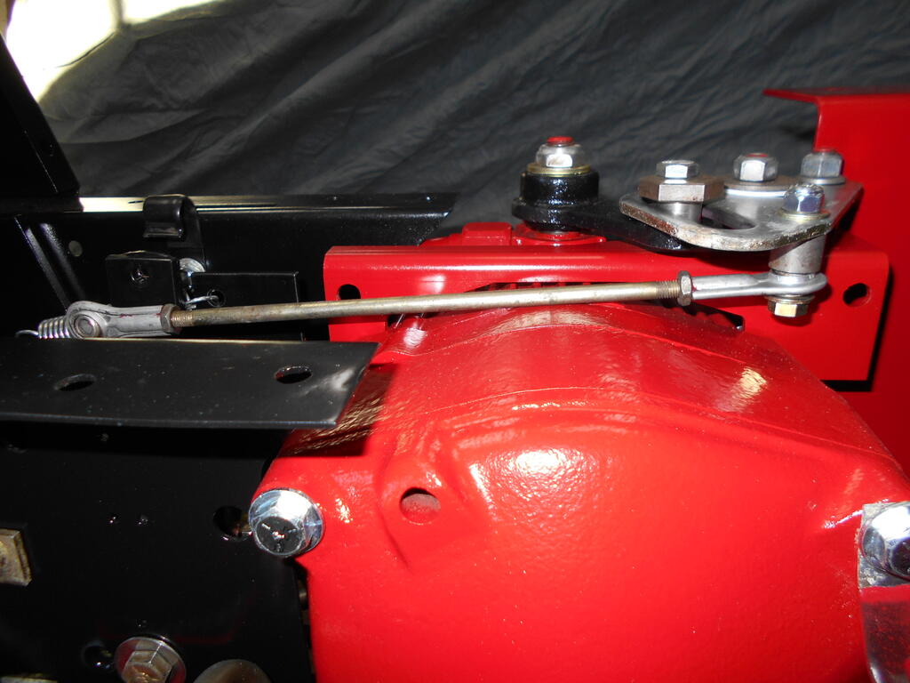

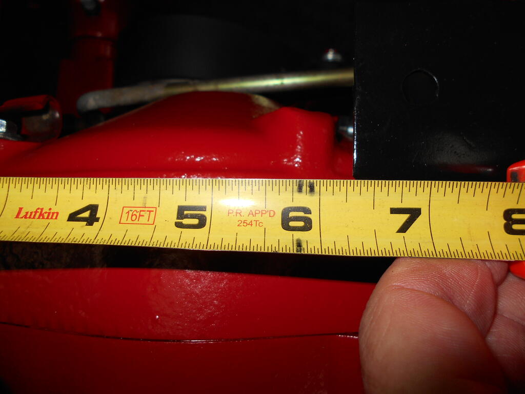

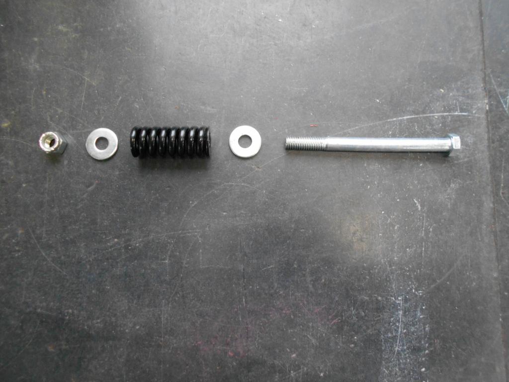

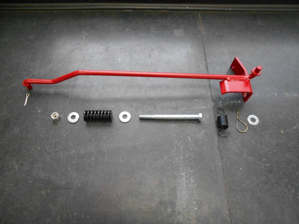

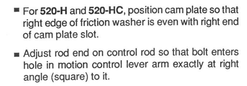

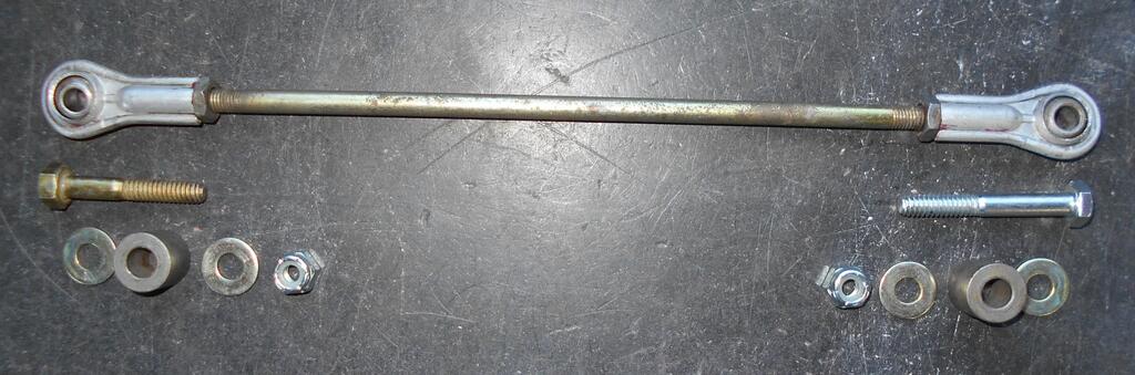

cleat 9,442 #173 Posted December 8, 2025 Control rod was taken apart and greased as per these instructions. Control rod assembly ready to install. Control rod bolted to hydro speed control cam plate. Bolt torqued to 96 in/lb. Control rod length set as per these instructions for a 520 ( same hydro unit as this 416H). Control rod bolted to motion control cam using a non-locking nut for now until I verify rod length is perfect. It is roughly the right length but may need some fine tuning later. Nyloc nut will be installed and torqued at that time. 5 Share this post Link to post Share on other sites

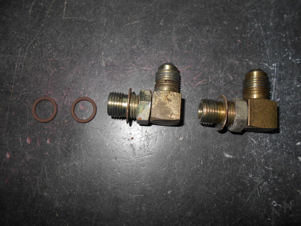

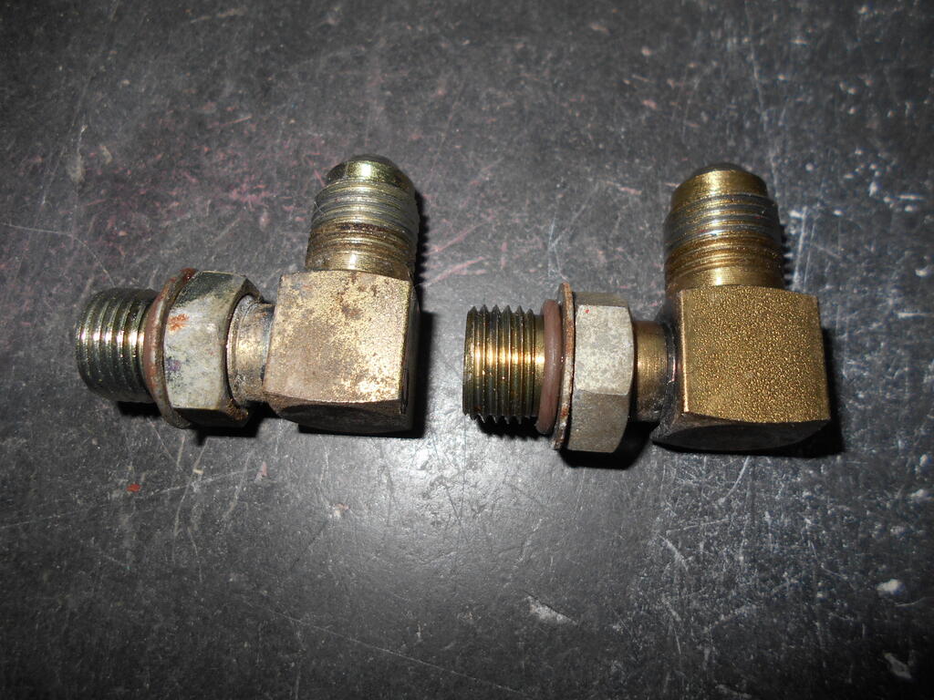

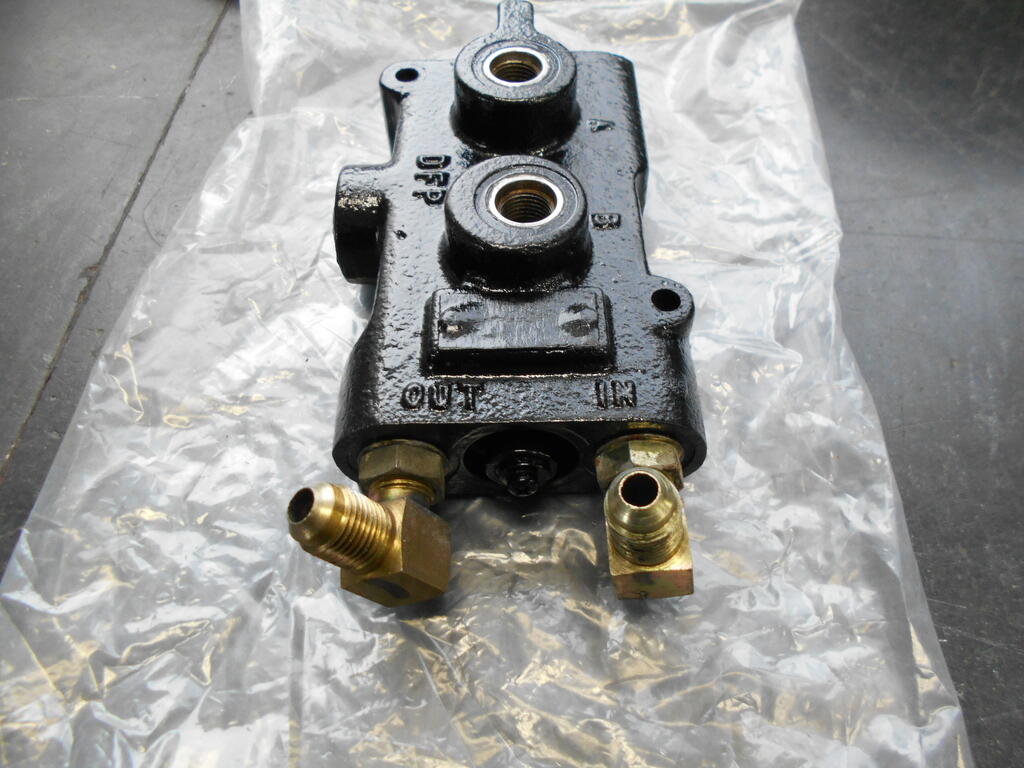

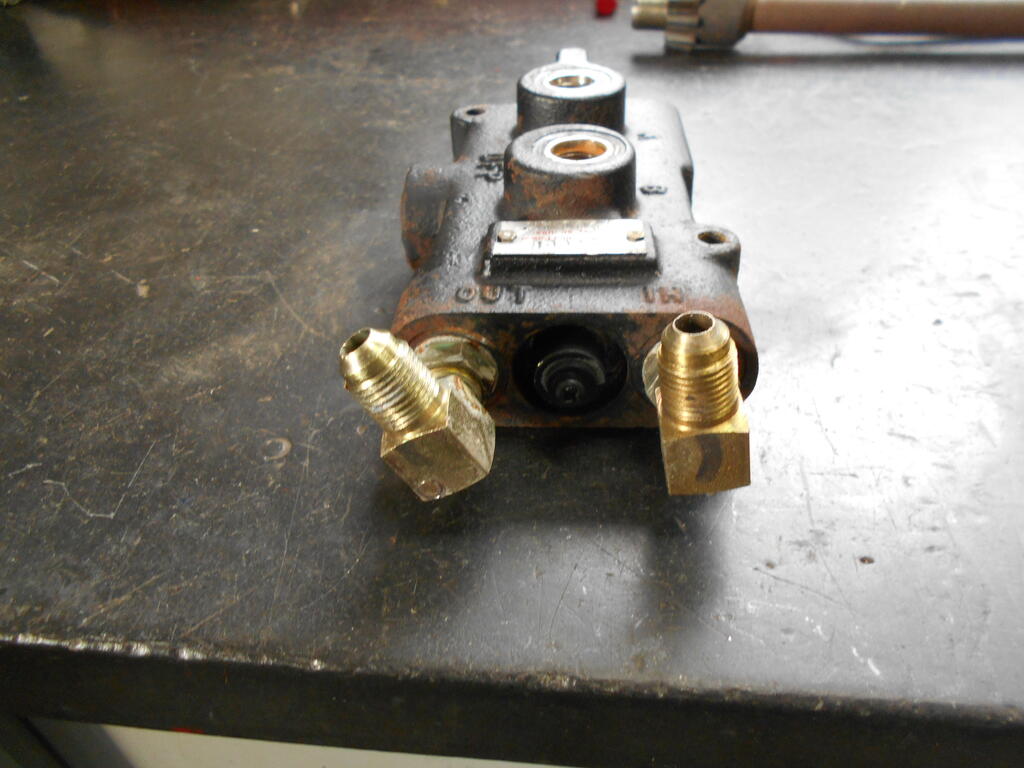

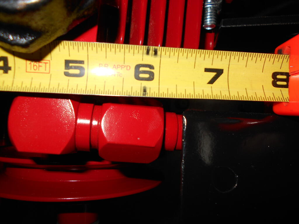

cleat 9,442 #174 Posted December 9, 2025 (edited) Hydraulic fittings and new #906 Viton O rings. Hydraulic fittings new #906 Viton O rings installed. Backup washer and nut screwed out until O ring is just contacted. This is the position to screw the fitting in and still have room to tighten the nut ensuring the O ring stays in the proper place on the fitting and not pushed into threaded areas. Hydraulic fittings ready to install into the valve. Valve has new #111 Viton O rings already installed. This is a picture I took of the valve as removed showing fitting orientation. Hydraulic fittings installed after oiling O rings, and orientated roughly the same as removed. This will make installation of the valve easier (I hope). Edited December 9, 2025 by cleat 6 Share this post Link to post Share on other sites

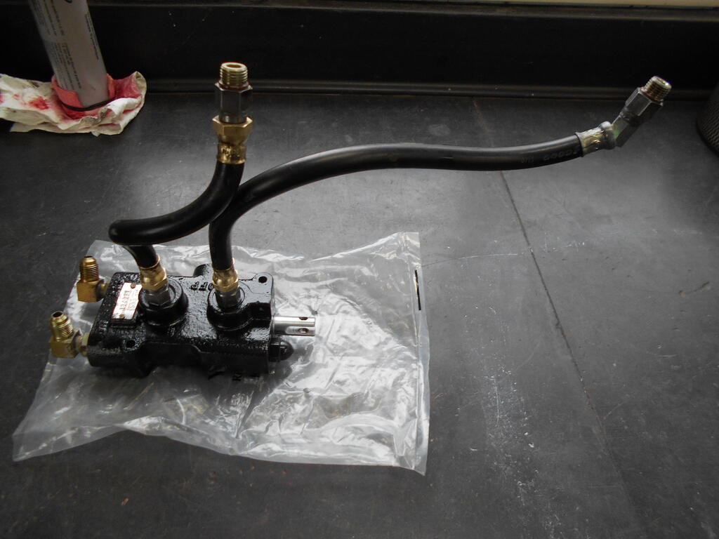

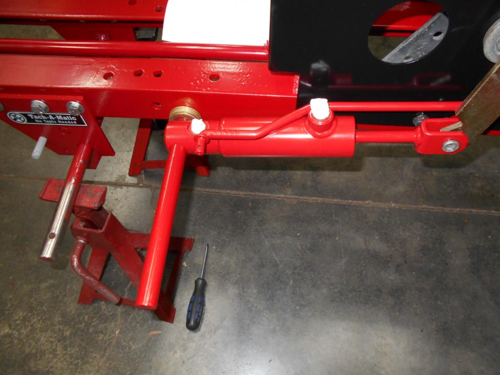

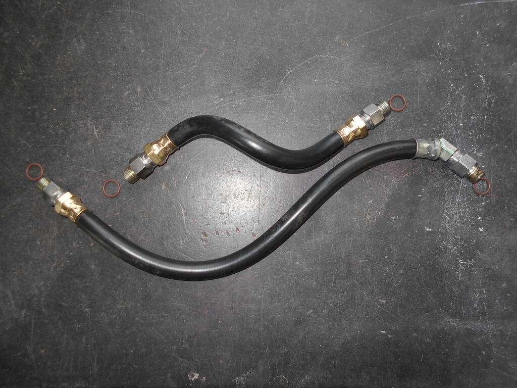

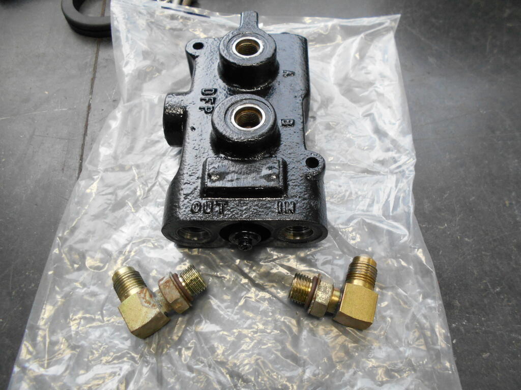

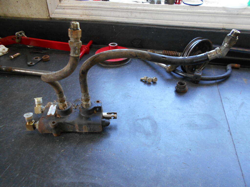

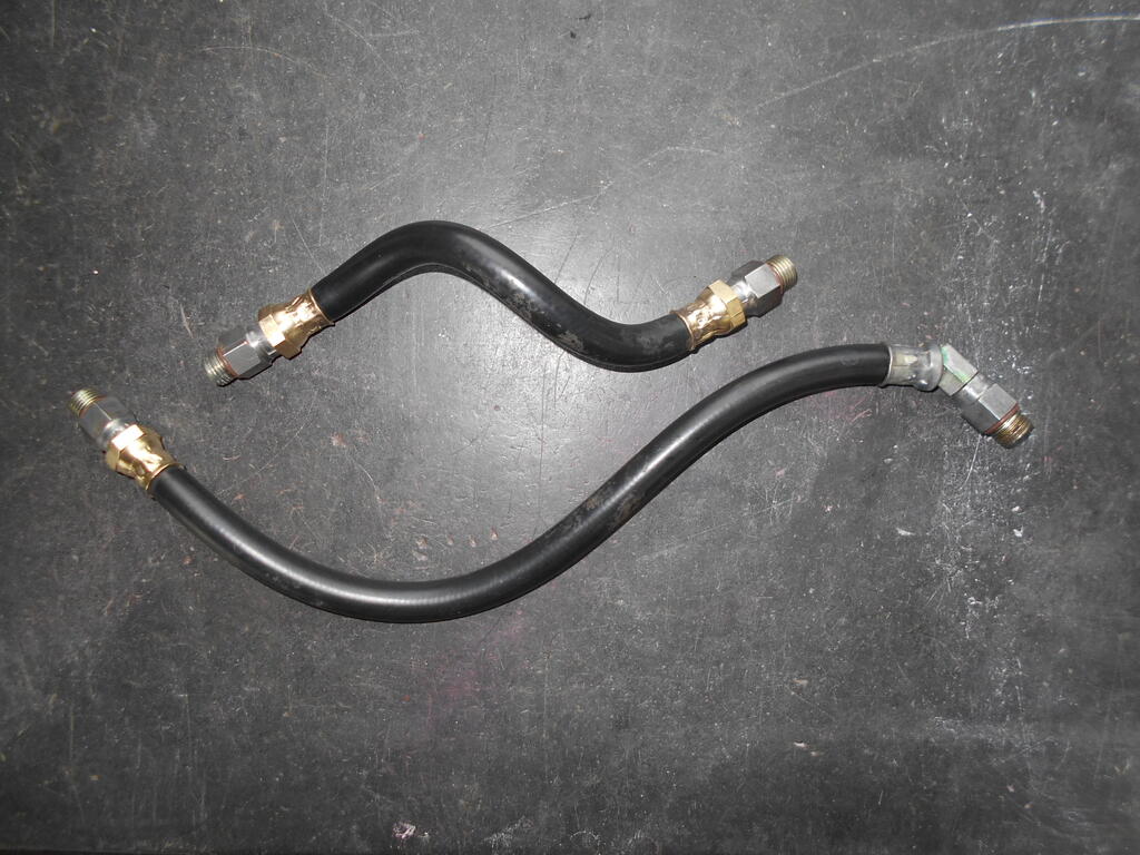

cleat 9,442 #175 Posted December 9, 2025 Hydraulic hoses #905 Viton O rings. Hydraulic hoses #905 Viton O rings installed. Hydraulic halve and hoses as removed. Make sure to install the hoses the same as removed or the hydraulics will work backwards (don't ask how I know). O rings on hydraulic hoses oiled then screwed tightly into valve. 6 Share this post Link to post Share on other sites
