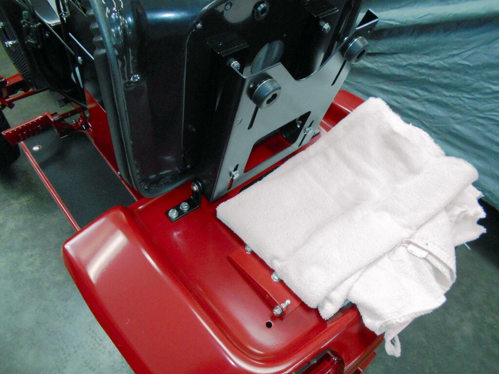

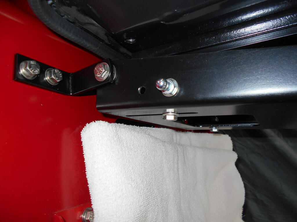

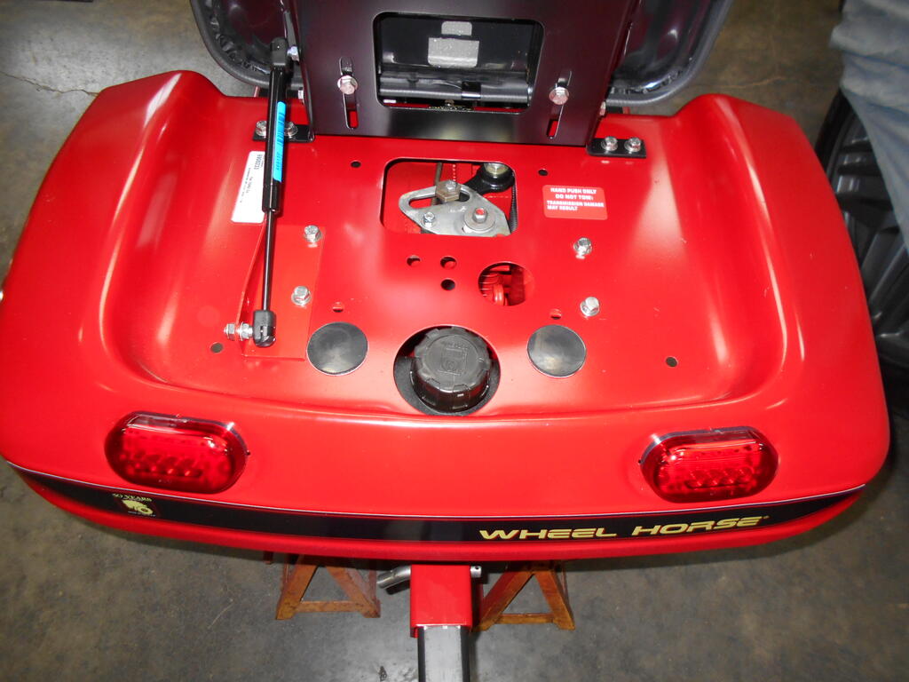

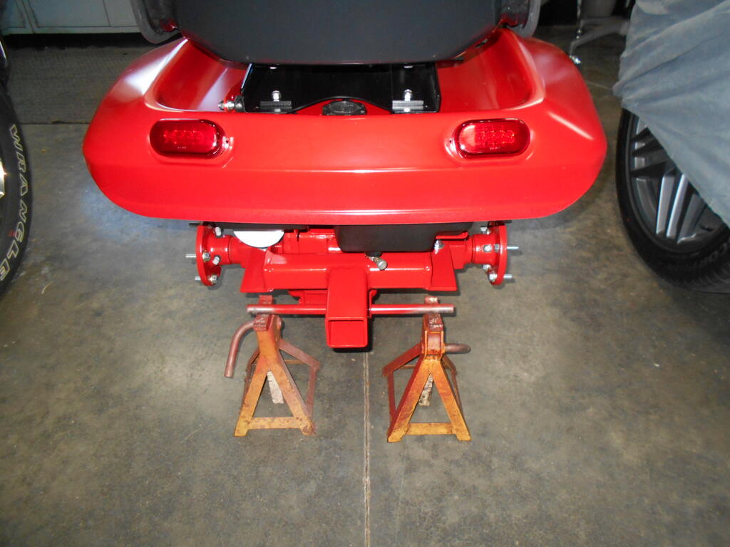

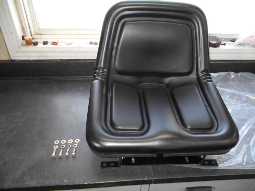

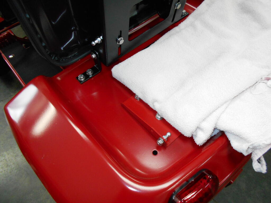

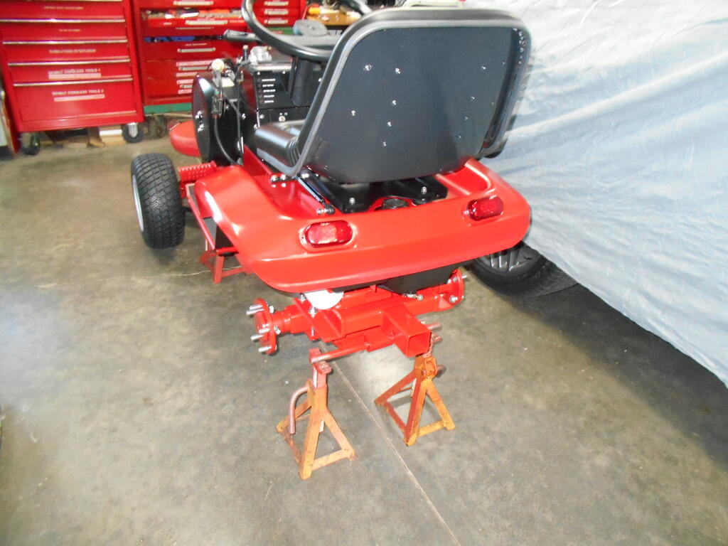

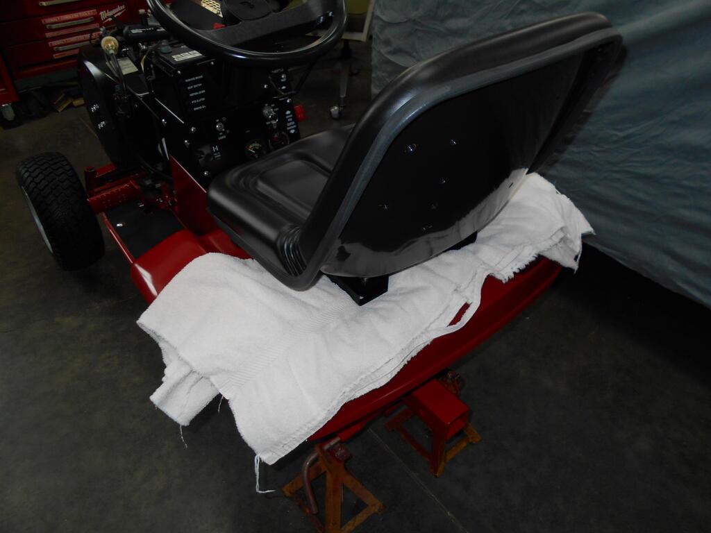

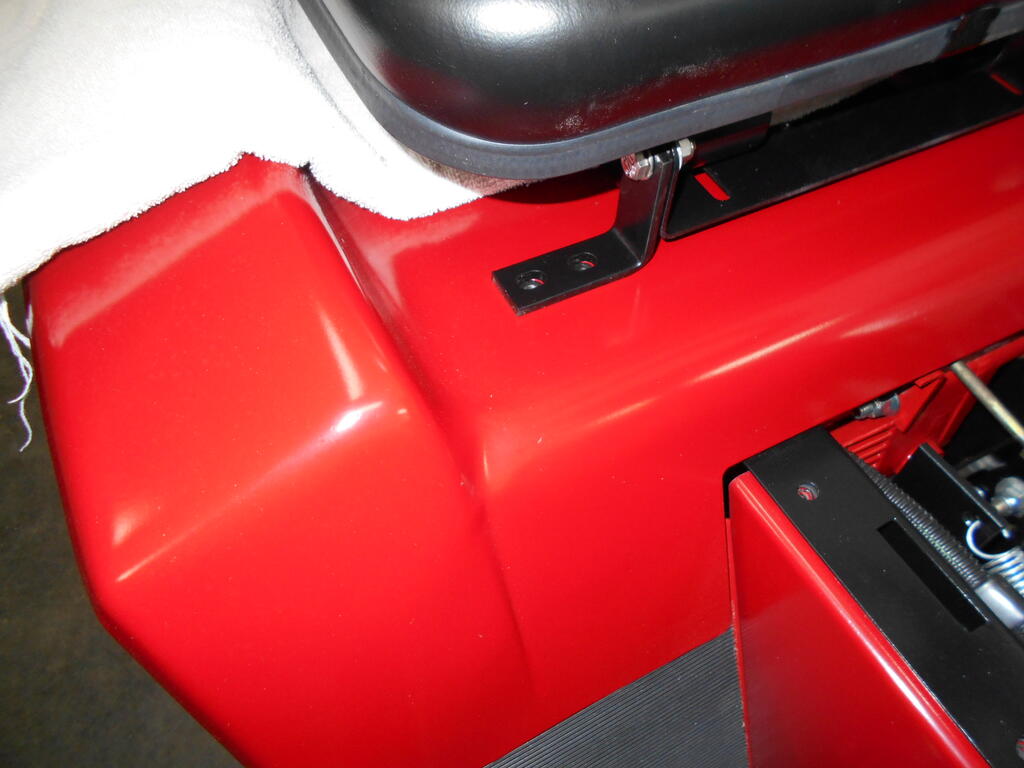

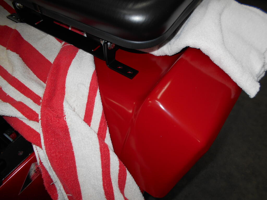

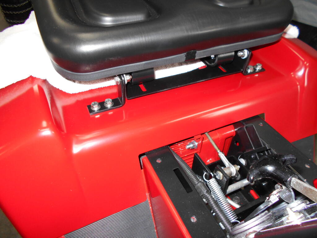

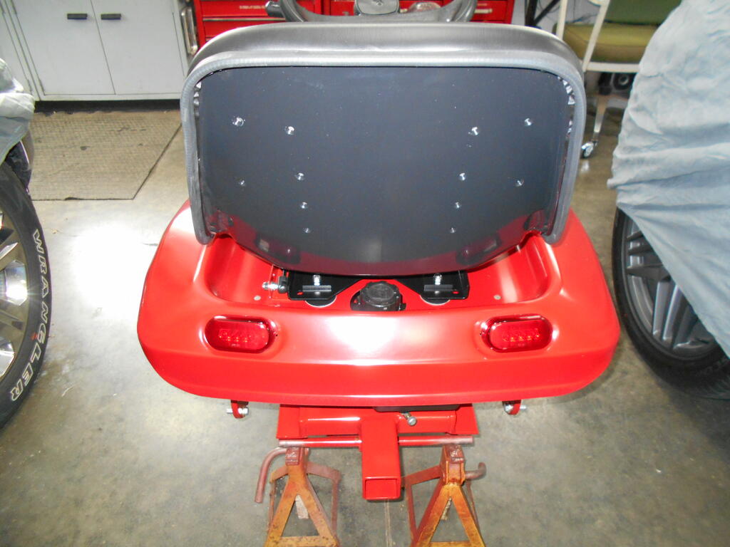

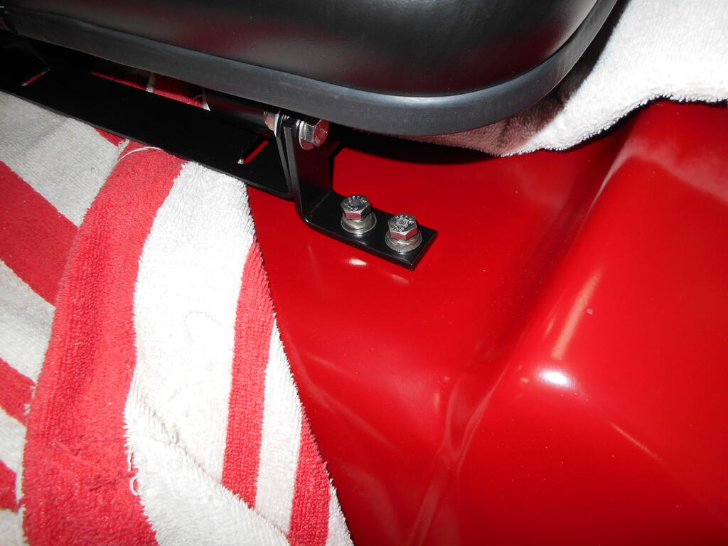

cleat 9,441 #326 Posted February 1 Seat assembly ready to install. Tractor ready for seat to be installed. Towels on tractor to protect paint. Seat sat on towels. Seat pivot bracket carefully sat on exposed fender. Because of the towels under the seat, the bracket is just barely touching the fender. Seat pivot bracket bolts loosely screwed into fender. Seat pivot bracket carefully sat on exposed fender right side. Seat pivot bracket bolts loosely screwed into fender right side. Seat was then centered side to side then bolts were tightened. All bolts then torqued to 200 in-lb. Seat installed. 3 Share this post Link to post Share on other sites

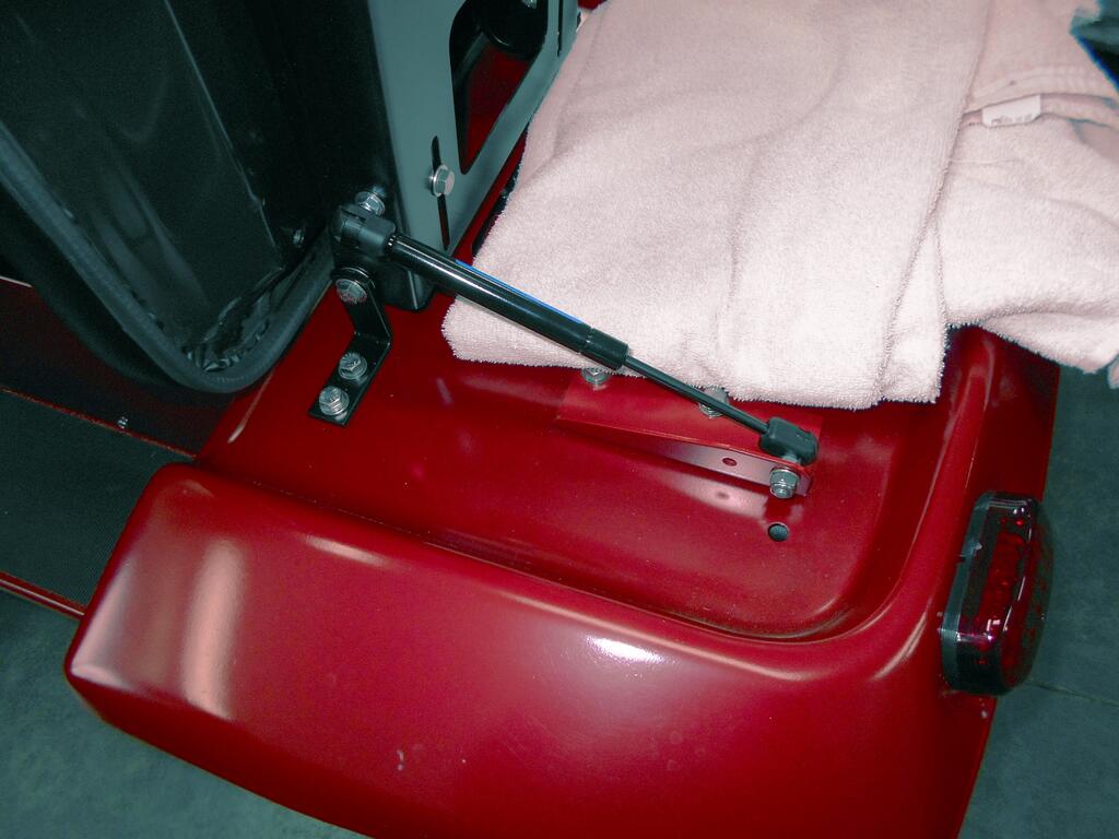

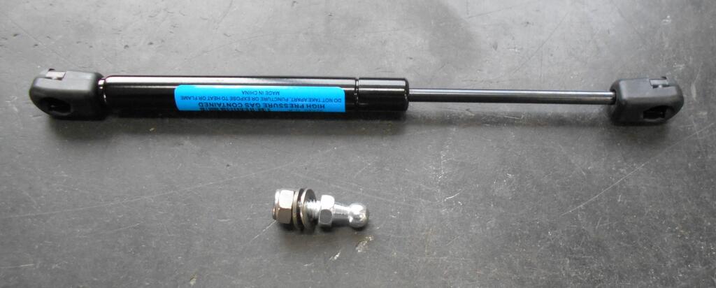

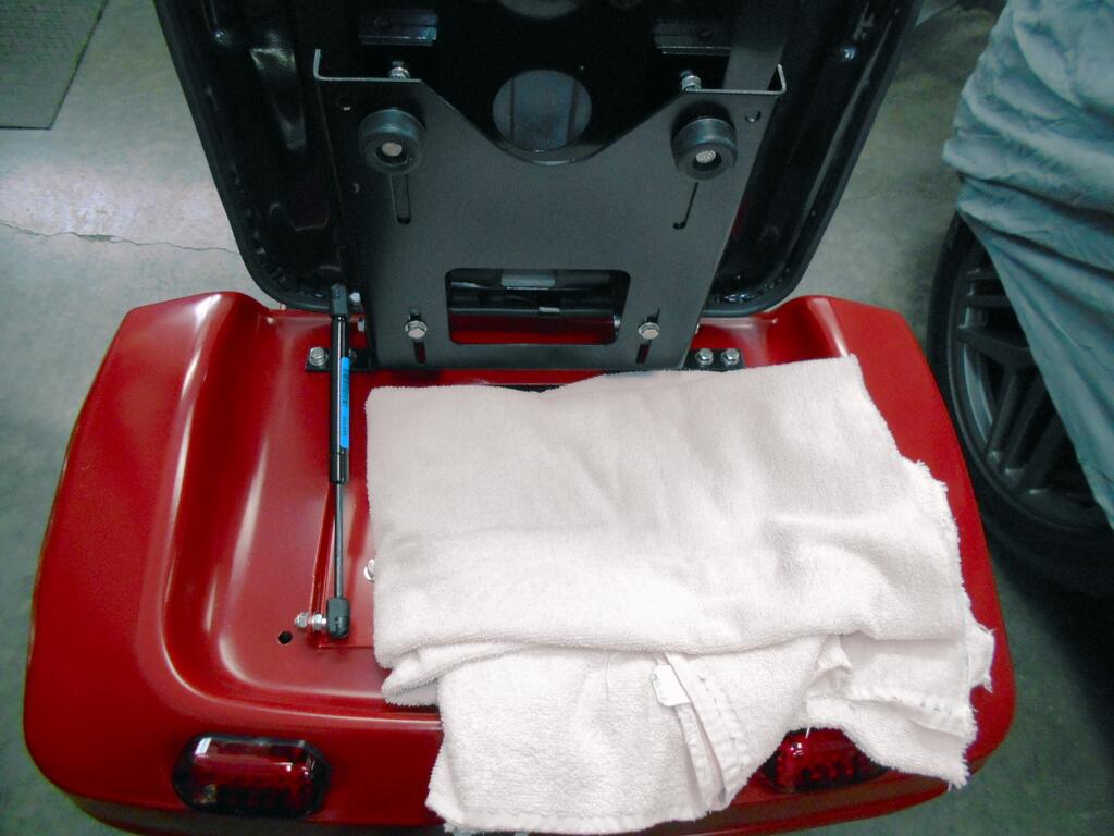

cleat 9,441 #327 Posted February 1 Seat gas lift ready to install. Seat pivot plate ready for gas lift ball to be installed. Seat pivot plate gas lift ball installed. Seat gas lift installed. It simply snaps onto the balls. 4 Share this post Link to post Share on other sites

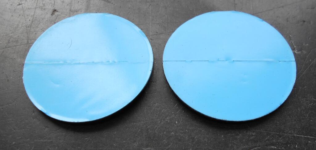

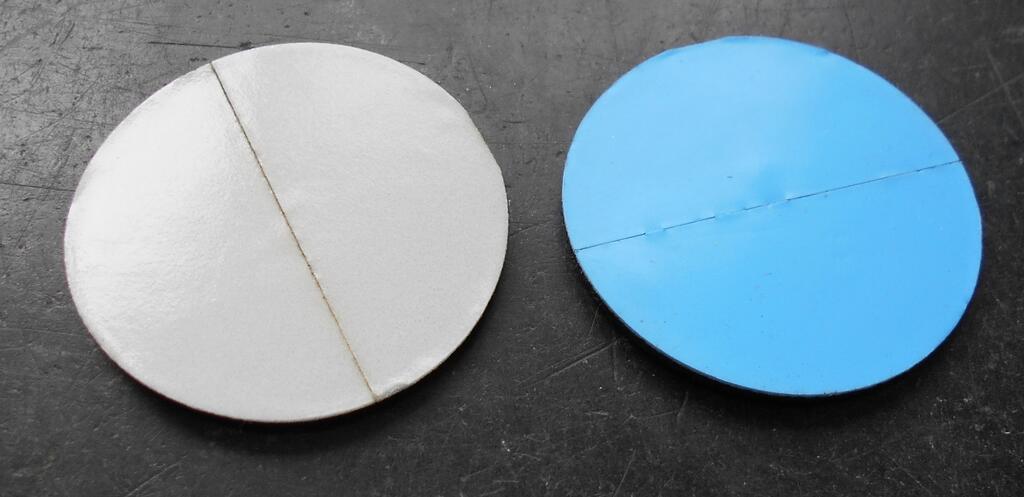

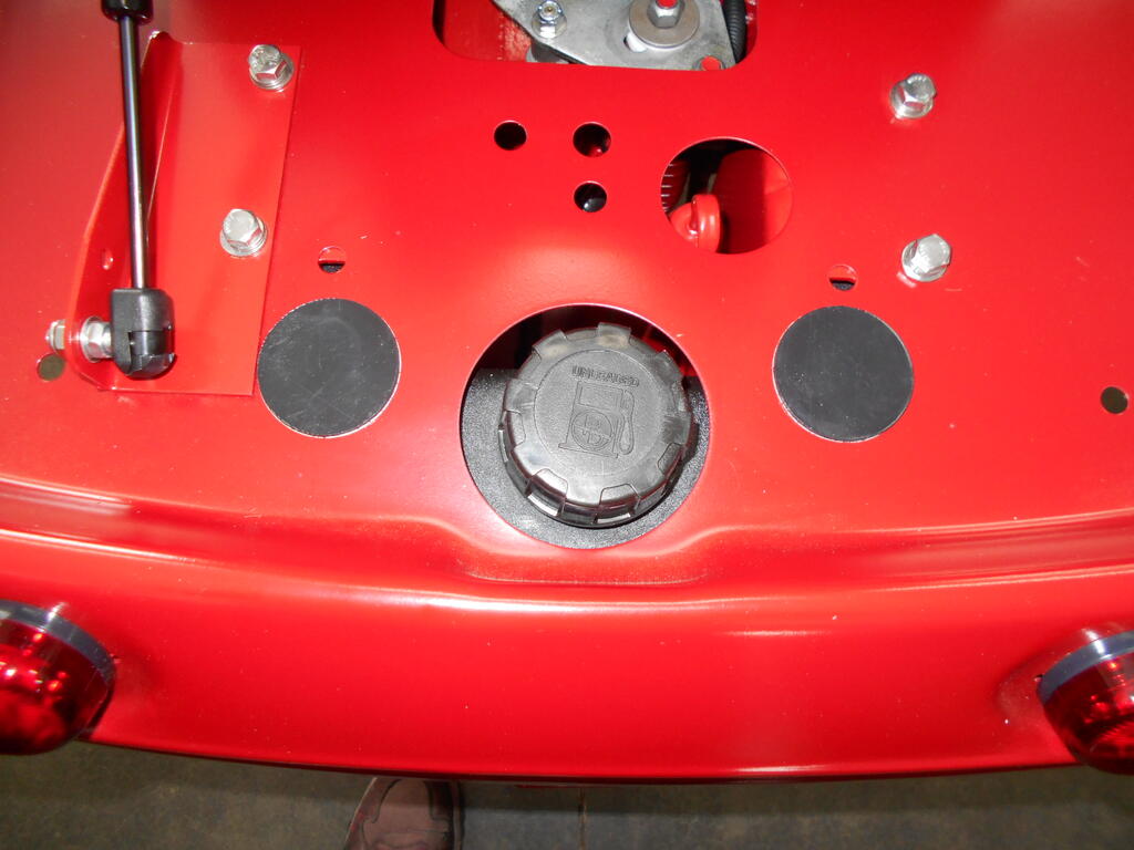

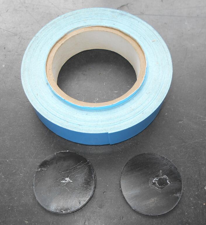

cleat 9,441 #328 Posted February 1 Fender protectors ready to install with double side tape. These protectors are just 2 inch diameter hard plastic discs that I grabbed from work years ago, I don't know what they were from. Fender protectors double side tape installed. Tape is 1" wide so two strips are required. 2 inch punch used to trim excess tape. Fender protector double side tape trimmed. Fender protector showing double side tape backing removed from one. Fender protectors installed. Seat installation complete. 4 1 Share this post Link to post Share on other sites

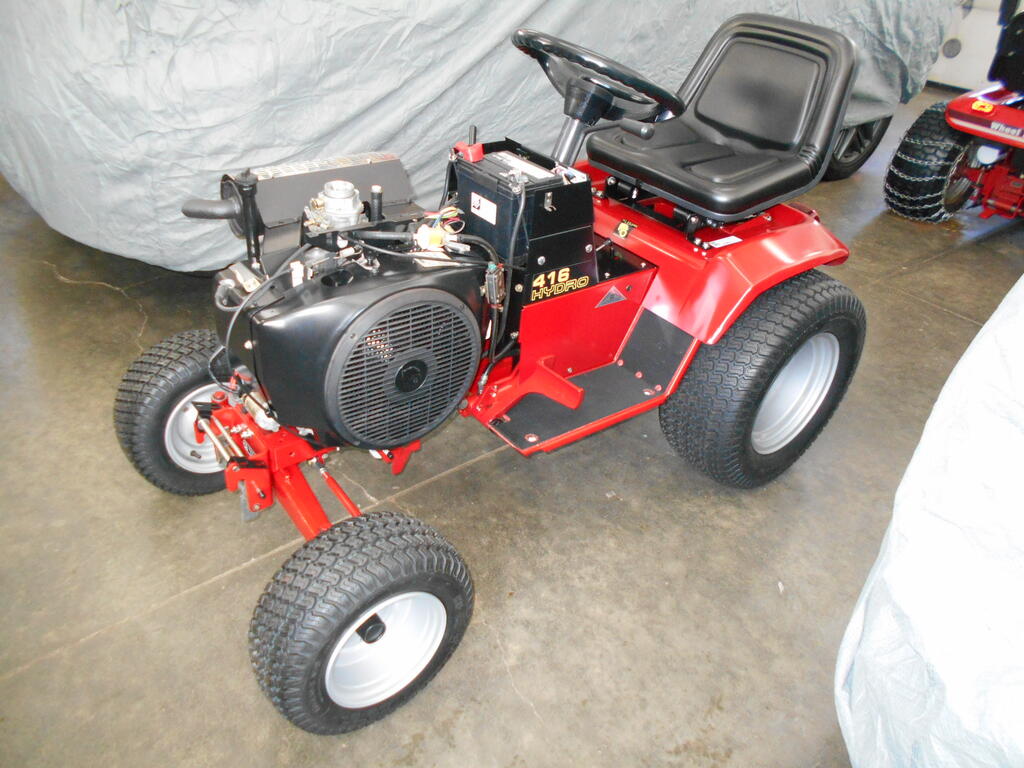

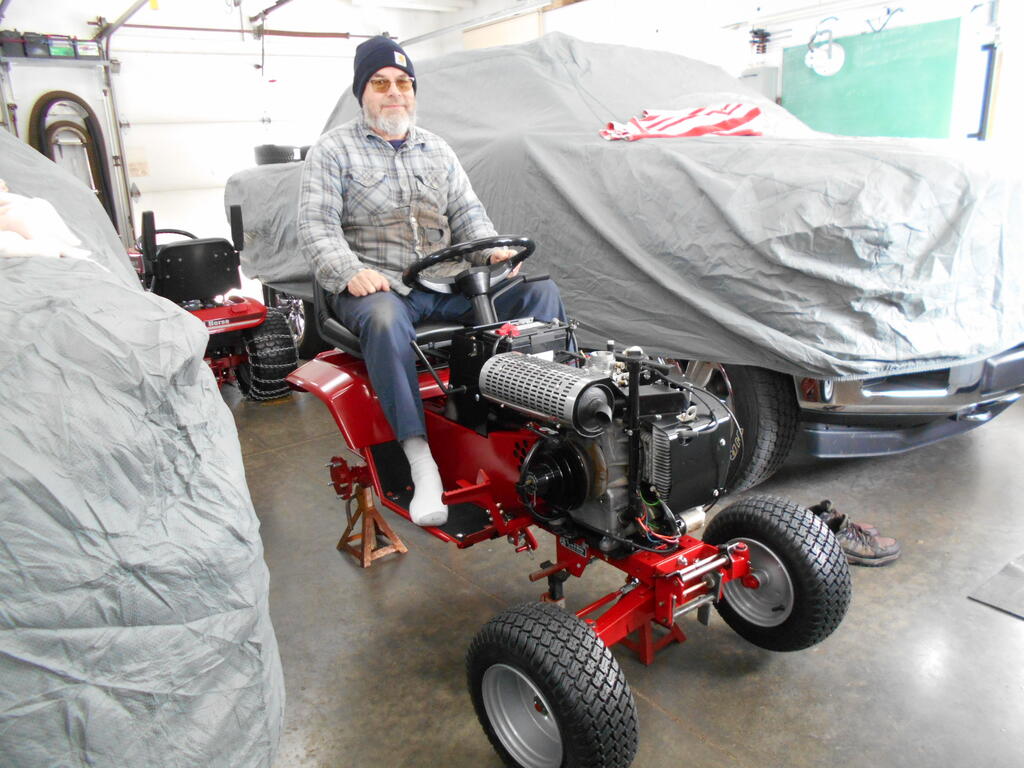

cleat 9,441 #329 Posted February 1 My wife came out to the shop to see what I was doing and took a couple of pictures of me on the tractor. Of course no shoes are allowed yet, have to keep it clean. My truck and her Explorer are sitting under cover waiting for spring whenever it finally gets here. Hopefully by mid April. 4 7 1 Share this post Link to post Share on other sites

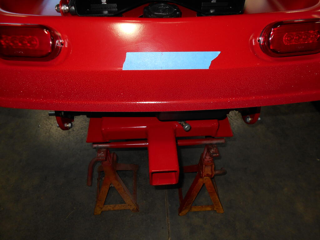

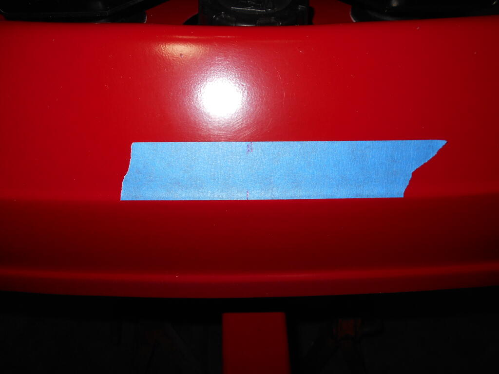

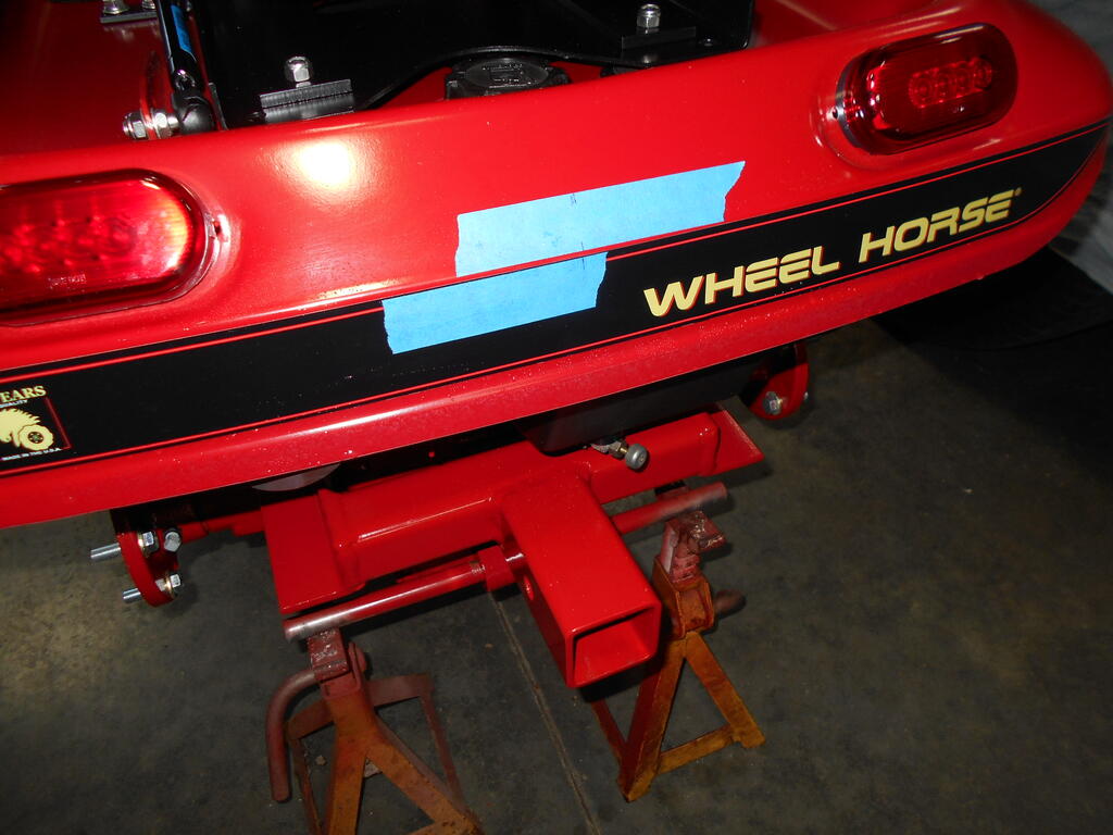

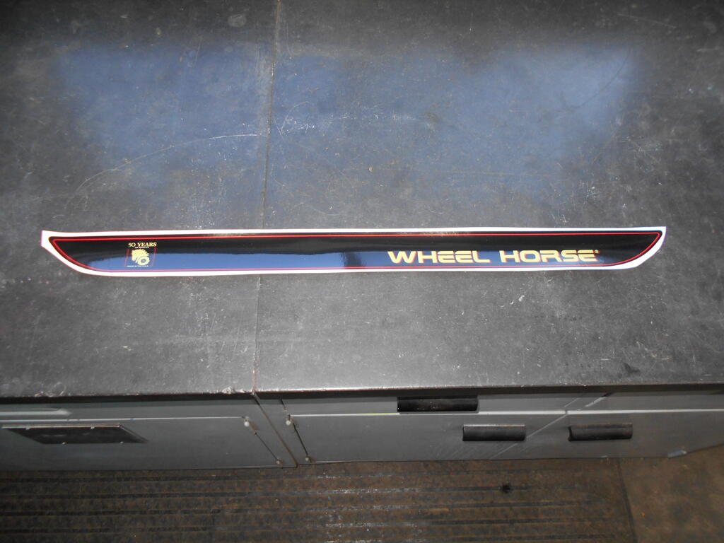

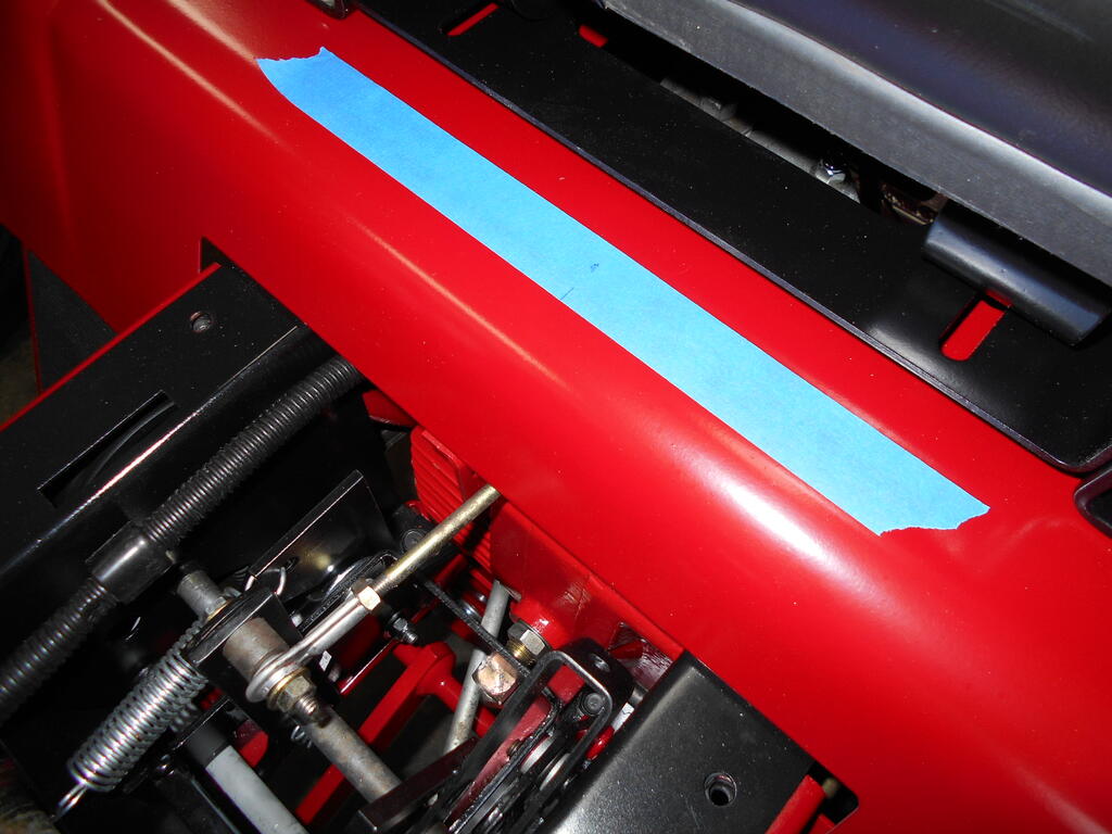

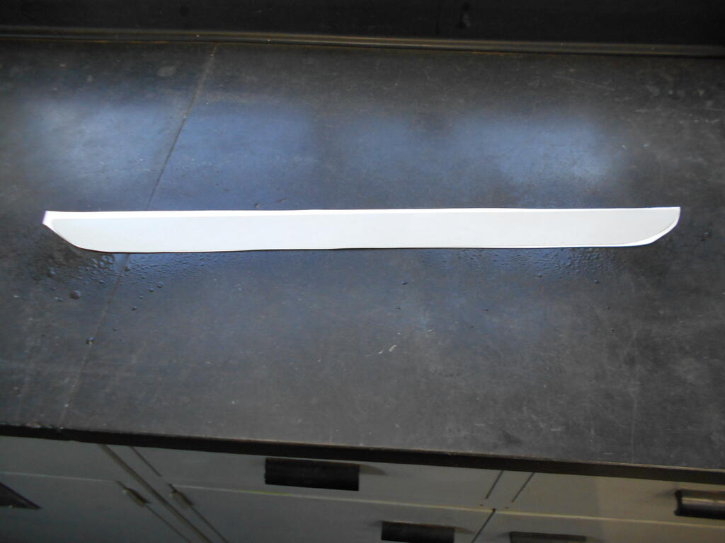

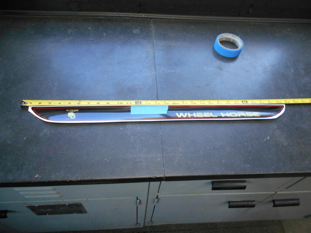

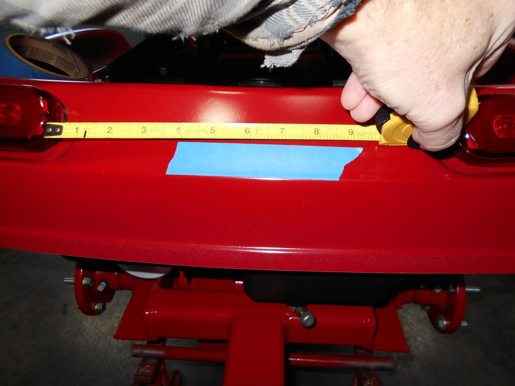

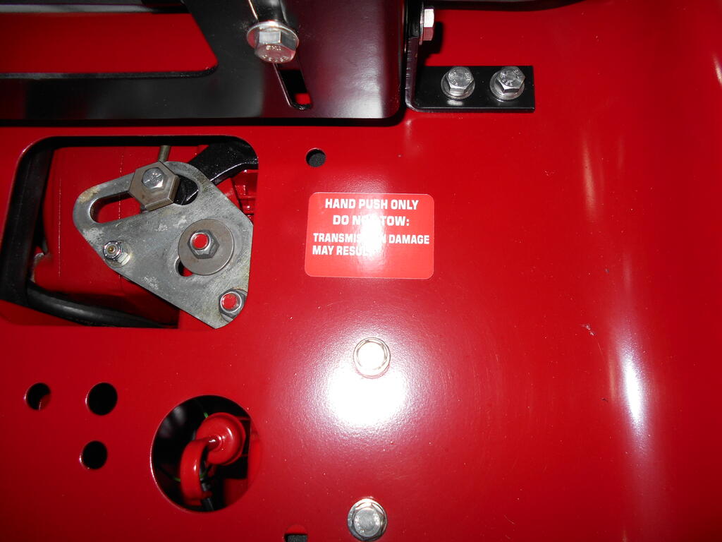

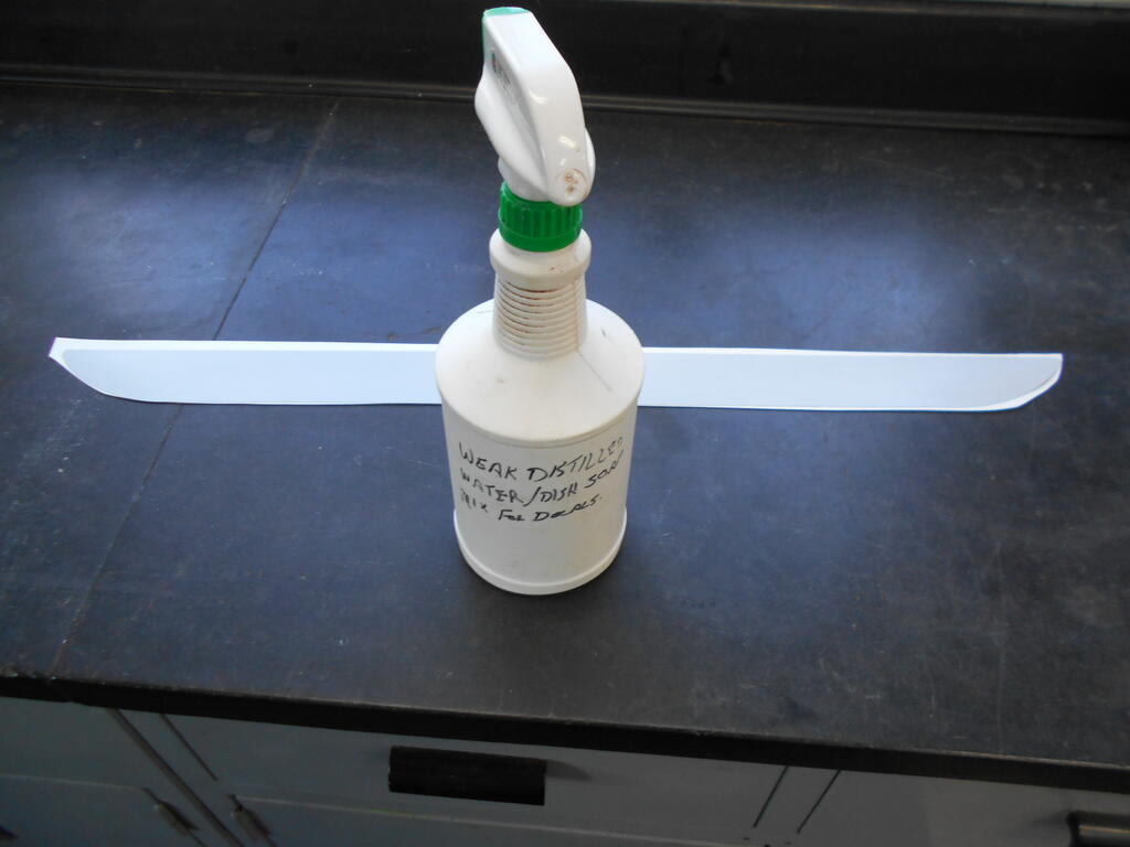

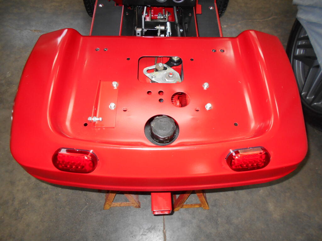

cleat 9,441 #330 Posted February 2 (edited) Fender decal ready to be applied. Terry's decal is perfect as always. Fender cleaned, de-greased and ready for decal. Fender decal measures 27.5 inches long. Fender decal center marked at 13.75 inches. Tractor ready to be raised. Tractor raised to make decal application easier. Distance between tail lights measures 11.75 inches. Fender center marked 5.875 (5-7/8") inches from a tail light (either one). Distilled water with a drop of dish soap used to wet down decal and fender for decal placement. Fender decal backing removed then the backside of the decal was sprayed with water soap mix. Fender sprayed with water soap mix. Fender decal gently applied to fender lining up the center marks and aligning just below the top body line on the fender. Water squeegeed out from behind decal ensuring the decal remains centered, even, and that there are no bubbles behind it. Squeegee is simply a piece of teflon wrapped in heavy duty paper towel. Fender decal applied. As the water dries from behind it over the next few days, some additional squeegeeing might have to be done. Edited February 2 by cleat 5 3 Share this post Link to post Share on other sites

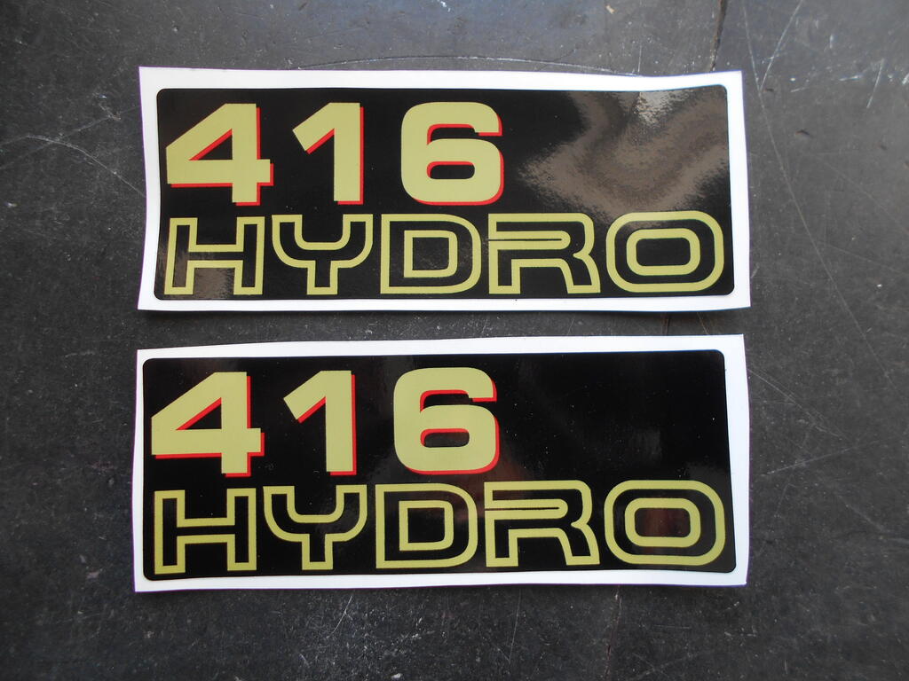

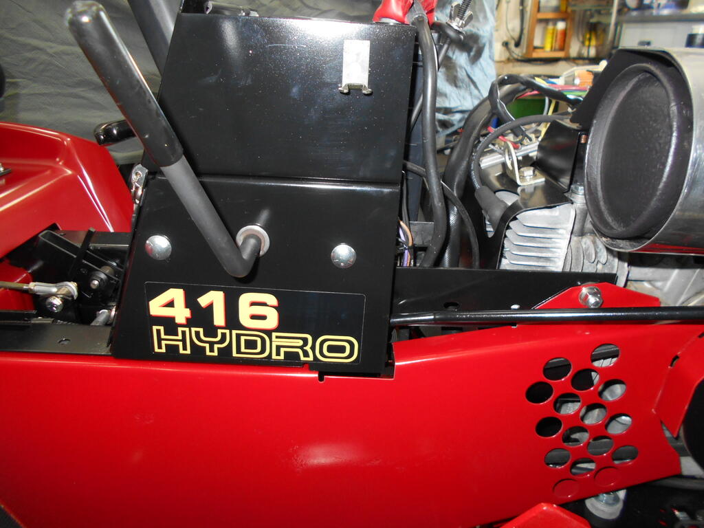

cleat 9,441 #331 Posted February 2 416 decals ready to apply. Tractor ready for 416 decals to be applied. 416 decals applied. Same procedure with the wetting and squeegeeing as used on the fender decal. Tractor as of now. 3 1 Share this post Link to post Share on other sites

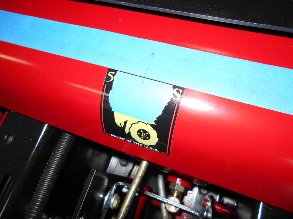

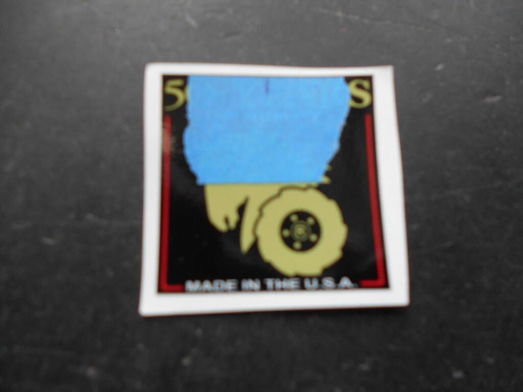

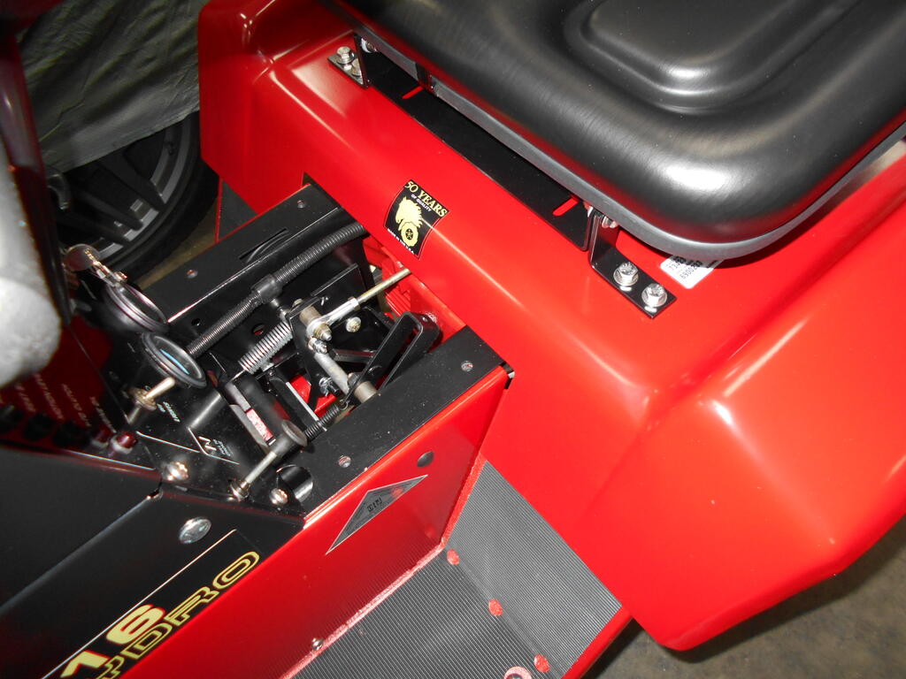

cleat 9,441 #332 Posted February 3 ID and clear overlay, do not tow, and front tach decals ready to install. ID decal and clear overlay applied. Do not tow decal applied. Fender decals applied. Masking tape applied to fender to align and center 50 years decal. Masking tape applied to 50 years decal and center marked (sorry for the poor focus). 50 years decal applied lining up to tape and matching center marks. 50 years decal applied. Front Tach decal applied. 4 Share this post Link to post Share on other sites

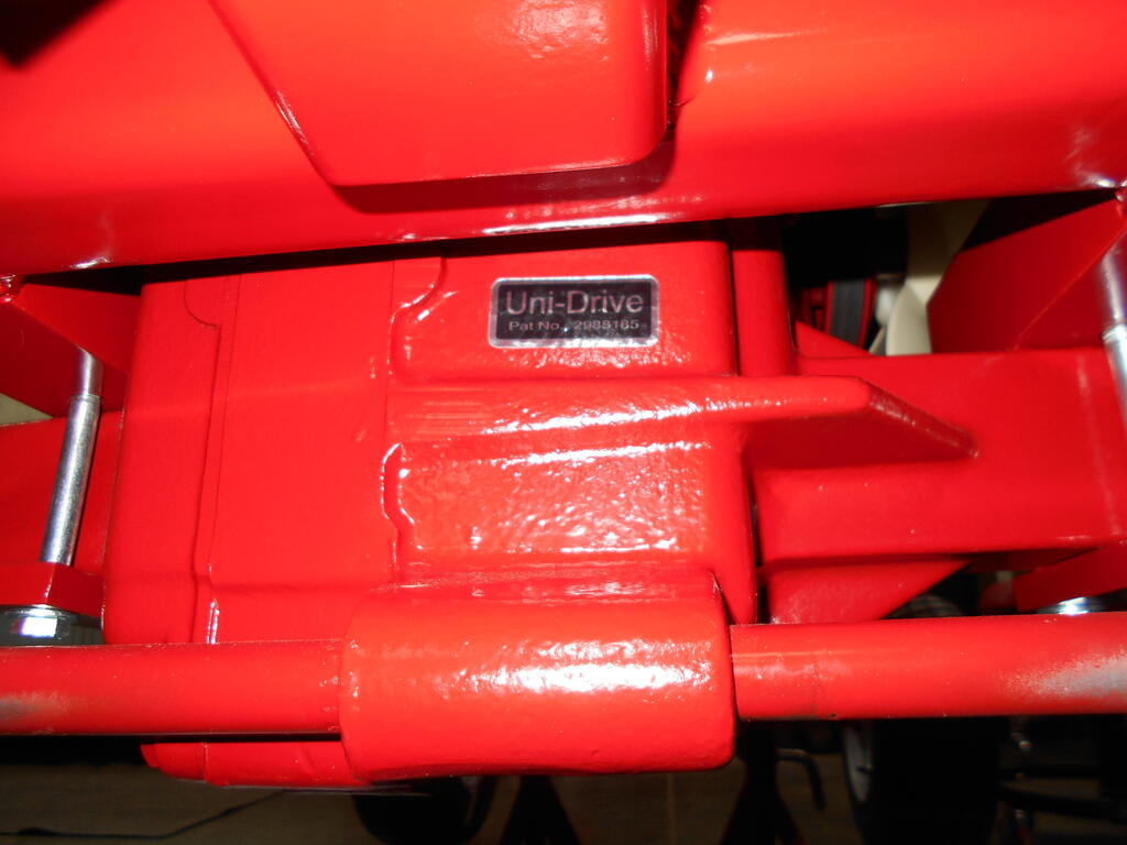

cleat 9,441 #333 Posted February 3 Uni-Drive decal installed. 6 Share this post Link to post Share on other sites

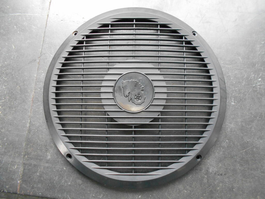

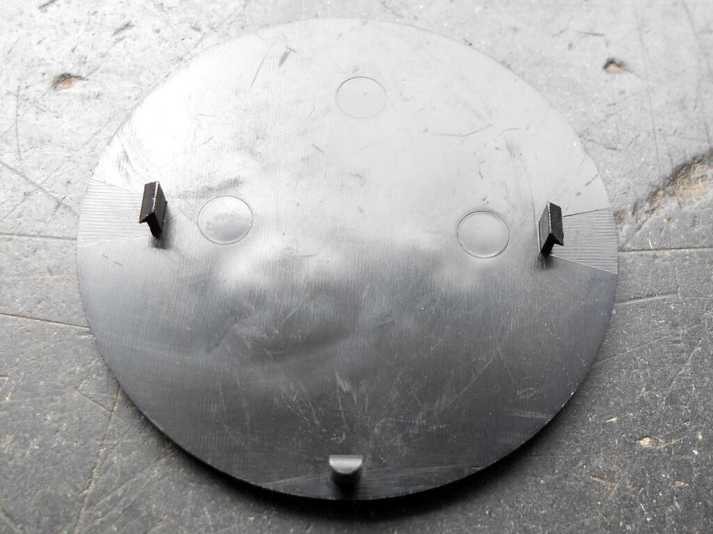

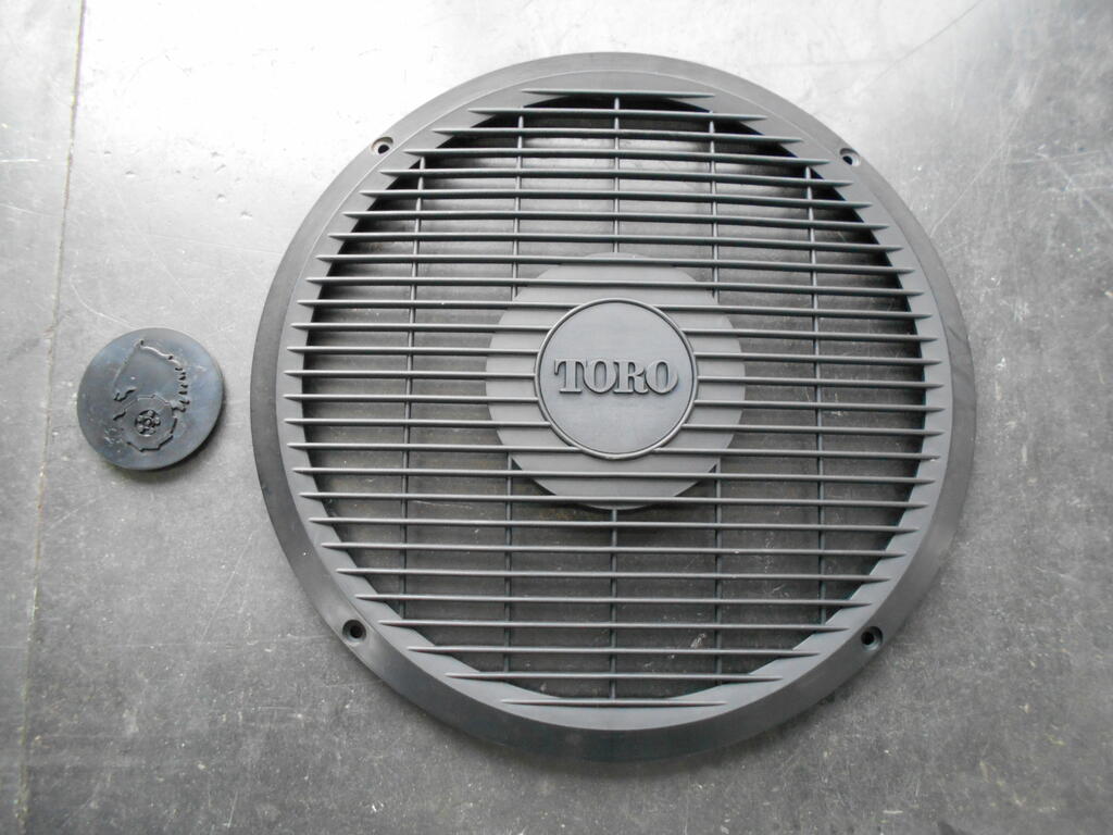

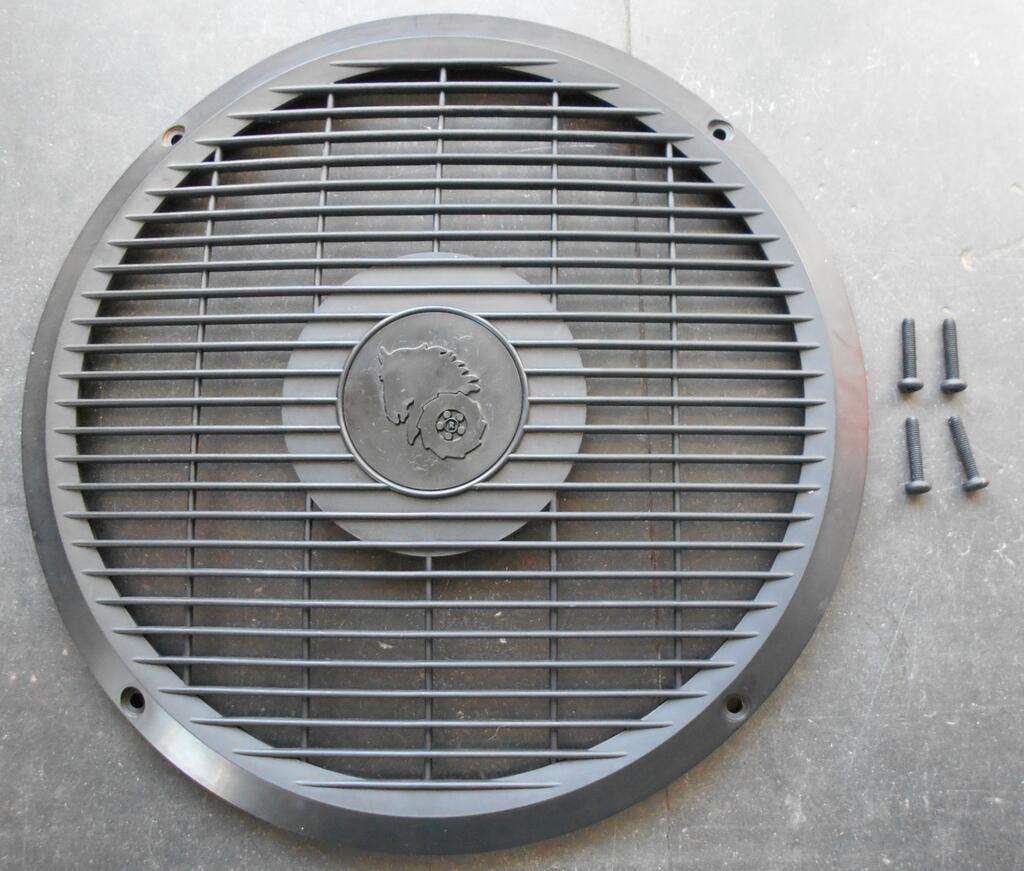

cleat 9,441 #334 Posted February 3 Onan engine stationary guard horse head insert bushing ready to be installed. Onan engine stationary guard TORO insert bushing removed after heating with hair dryer to prevent breaking clips. Onan engine stationary guard horse head insert bushing installed after heating with hair drier so clips do not break Bushing simply snaps into place and is properly orientated by a locating pin. Onan engine stationary guard horse head insert bushing back side showing retaining clips and locating pin. Onan engine stationary guard horse head insert bushing installed. Looks much better than the Toro insert. 2 3 Share this post Link to post Share on other sites

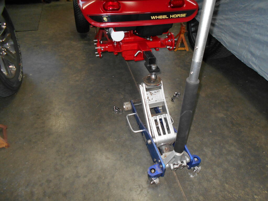

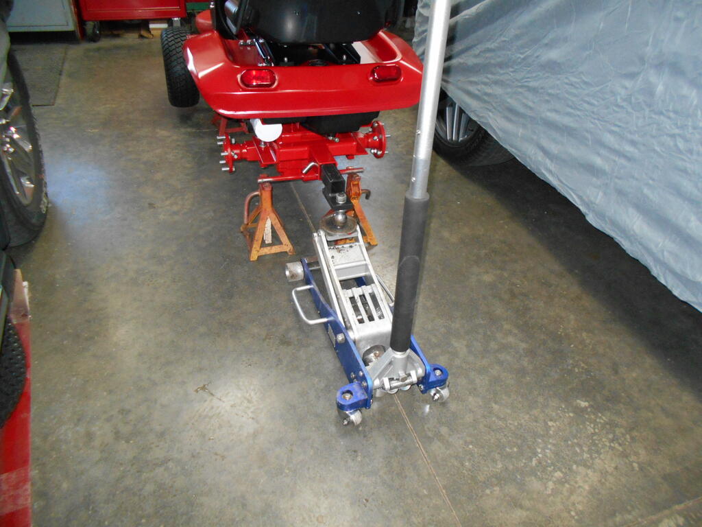

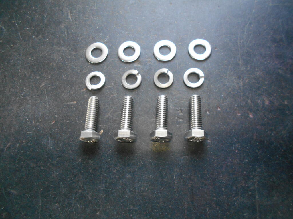

cleat 9,441 #335 Posted February 5 Rear wheels ready to be installed. Wheels were previously painted and had new tires installed. Rear wheel lug nuts ready to install. These are chrome open end 7/16-20 NF. GM used this size for years so they are not too hard to find. Tractor ready for rear wheels to be installed. Tractor lifted by rear receiver hitch then jack stands and bar through hitch shaft boss removed. This bar cannot be removed after the wheels are installed. Left rear wheel installed and lug nuts snugged. Right rear wheel installed and lug nuts snugged. Rear wheel clearance checked on both sides. I was a little worried because I installed 23x10.5-12 tires instead of the stock size of 23x9.5-12 mainly because the larger size is more readily available. Clearance is fine. Rear wheels installed and tractor on the ground for the first time. Rear wheel lug nuts torqued to 50 ft/lb after setting parking brake to hold tractor in place. 4 1 Share this post Link to post Share on other sites

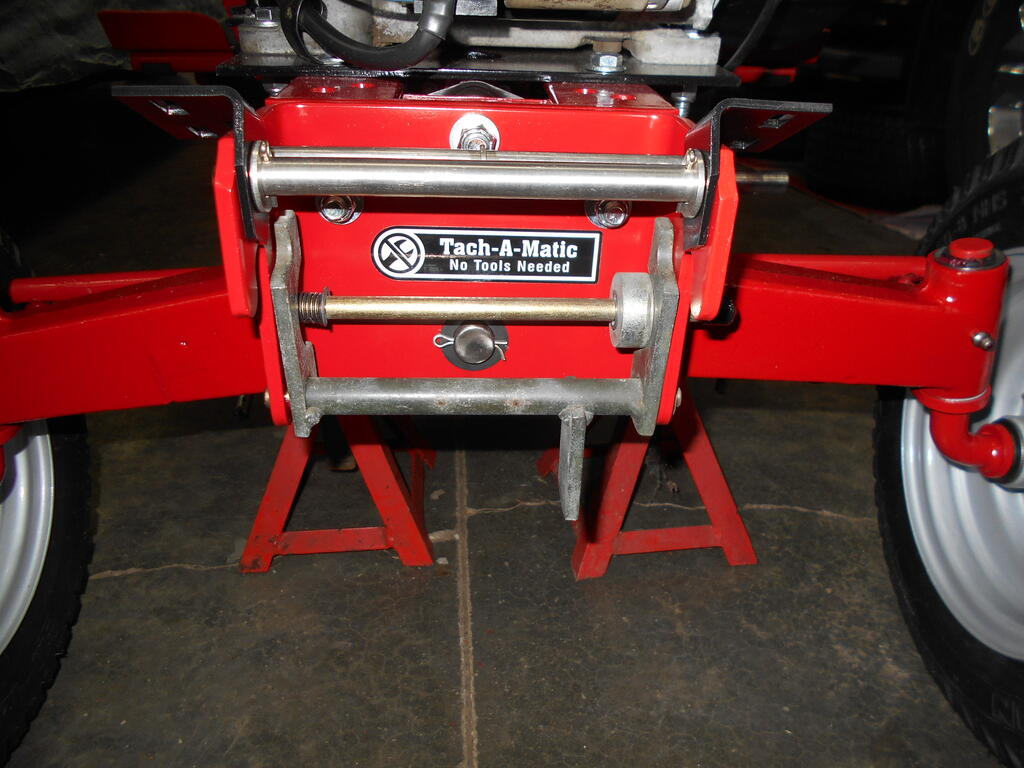

cleat 9,441 #337 Posted February 5 Front hitch installed. Receiver slid into front hitch then front end lifted off of jack stands. Jack stands and bar through mid tach removed. Tractor sitting on all four wheels. 2 3 Share this post Link to post Share on other sites

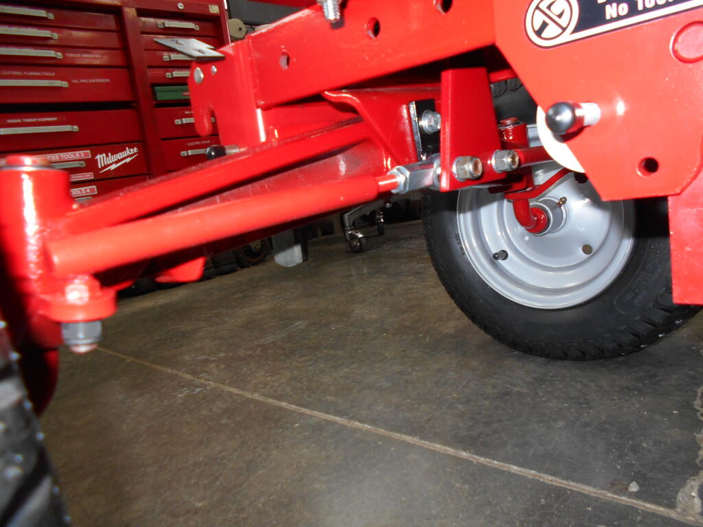

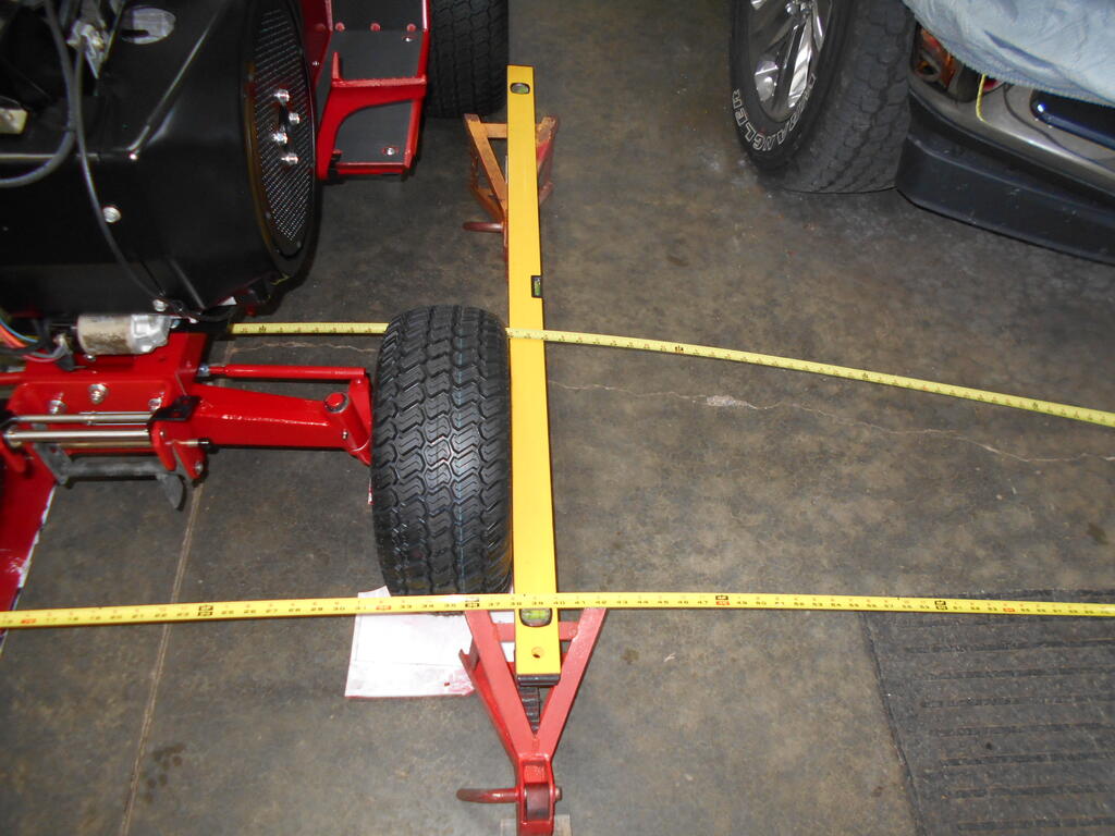

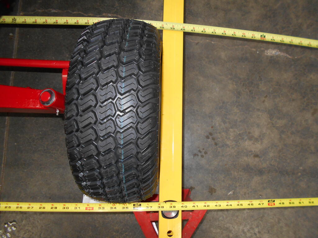

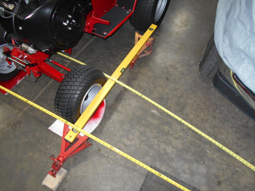

cleat 9,441 #339 Posted February 6 Getting ready to do front end alignment. I have two straight edges that are 4' long and some pieces of Teflon. Disregard the yard sticks as they were not used. Tires all set at 12 PSI and front wheels sitting on Teflon for east of movement. Straight edges sat on jack stands half way up front wheels. Steering wheel was set straight. Tape measures laid on top of straight edges with the hook end clamped on holding them tight to the edge just to hold them in place so they don't move. We have 1/4"" toe in but the manual calls for 1/8". Also the straight edge is even with the outside of the Left rear tire and is out slightly from the Right rear tire. I therefor shortened the Right side tie rod by one turn and bolted it back on tight. Alignment complete straight edge is in line with outer edge of rear tire on both sides. Alignment complete and we now have 1/8" toe in. With 1/8" toe in and straight edge aligned evenly to both rear tires means the steering wheel should sit straight while driving and the steering should have at least a little return to center. 3 1 1 Share this post Link to post Share on other sites
cleat 9,441 #340 Posted February 6 Tie rod lock nuts installed on both ends and tie rod jamb juts firmly tightened. Front end complete. 6 Share this post Link to post Share on other sites

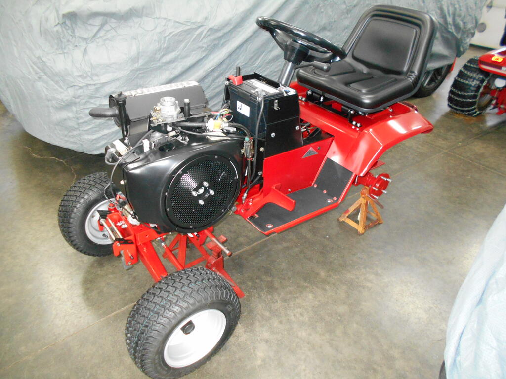

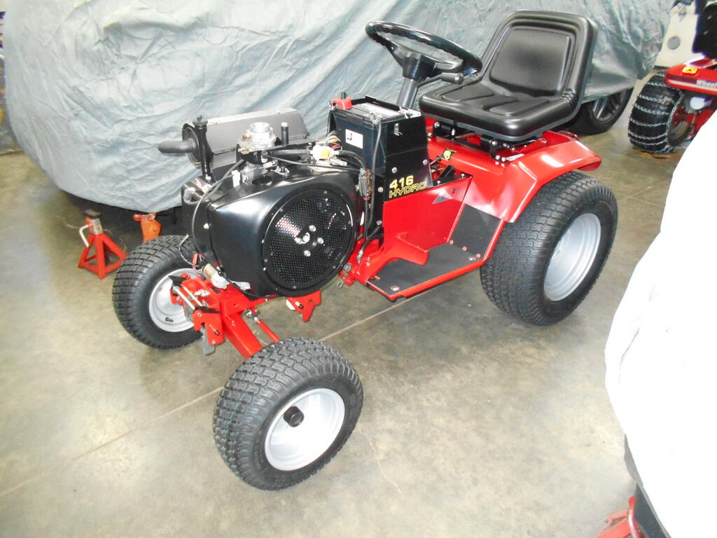

cleat 9,441 #341 Posted February 6 416 Anniversary complete except for final setup of carb and hydro, and hood which will be completed next summer. Wife took this picture. She laughed at me taking my shoes off to sit on the tractor. 5 2 2 Share this post Link to post Share on other sites
lynnmor 9,081 #342 Posted February 6 2 hours ago, cleat said: Alignment complete and we now have 1/8" toe in. With 1/8" toe in and straight edge aligned evenly to both rear tires means the steering wheel should sit straight while driving and the steering should have at least a little return to center. I found that the mold seams or colored lines run true when spun so I could use those for measuring. May not happen in all cases, but it worked for me with Kenda tires. I have turn tables for easy movement and a spreader bar to take out any slack in the spindles. I do my own wheel alignments on cars if they will accept my ancient Alemite equipment. 3 Share this post Link to post Share on other sites

ebinmaine 81,273 #345 Posted February 7 20 hours ago, cleat said: taking my shoes off to sit on the tractor. @JCM You and Cleat both got some niiiiice rigs. @cleat that front end alignment set up is the cat's meeeyoww. Nicely done. Beautiful tractor. That can NOT be overstated. 1 2 Share this post Link to post Share on other sites
WHX?? 58,387 #346 Posted February 7 2 hours ago, ebinmaine said: front end alignment set up is the cat's meeeyoww I always wrapped a string around the tractor but not sure if that's accurate. 1 Share this post Link to post Share on other sites

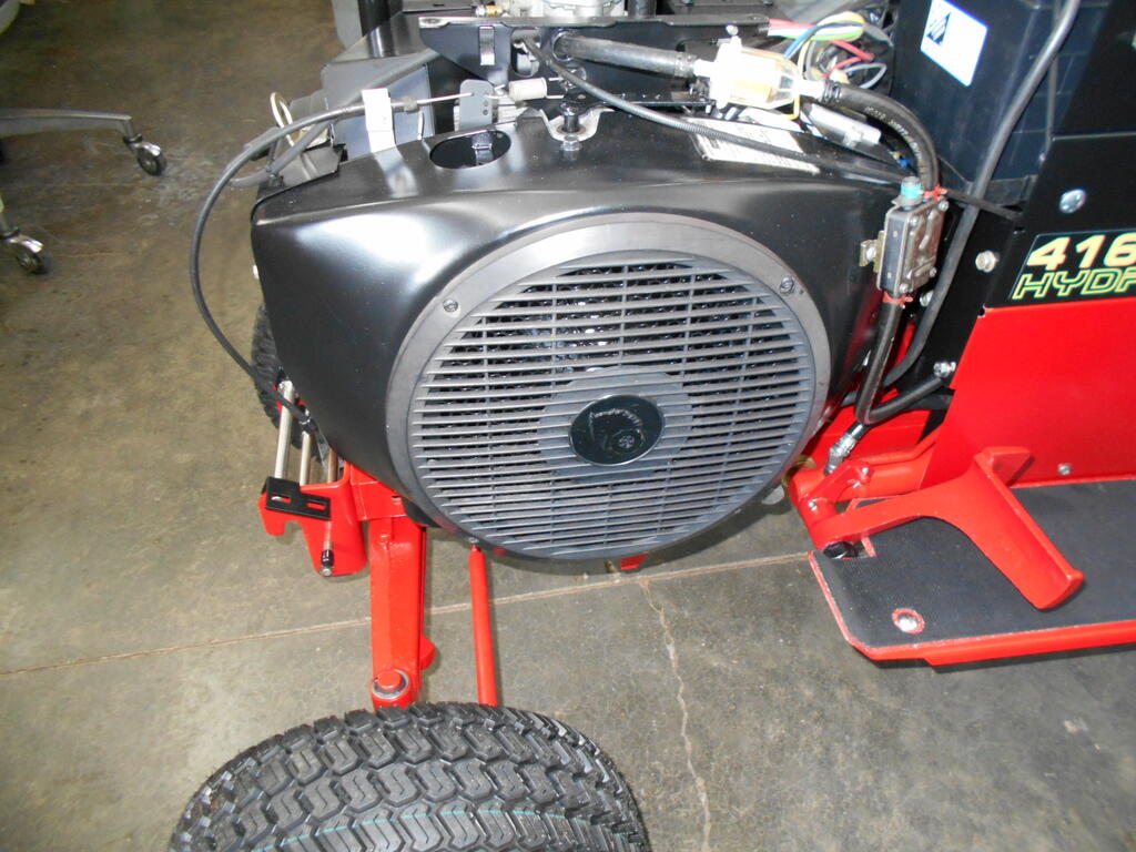

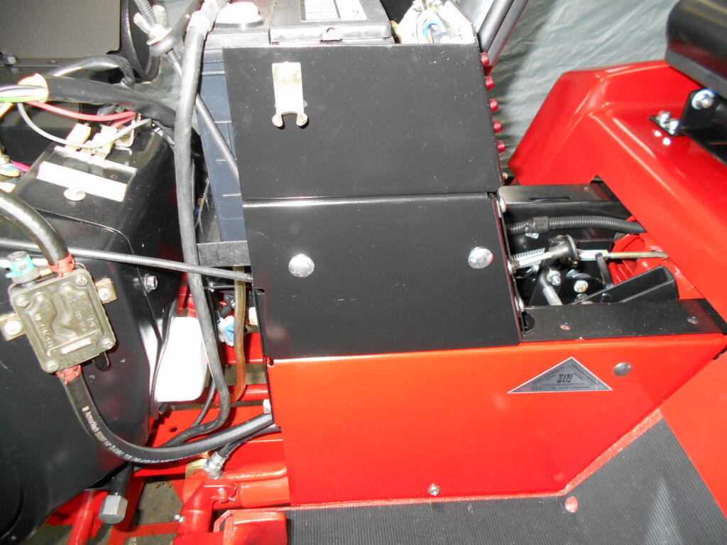

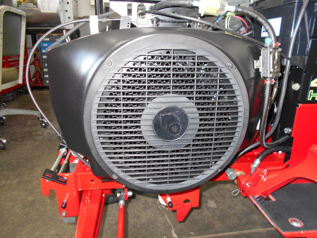

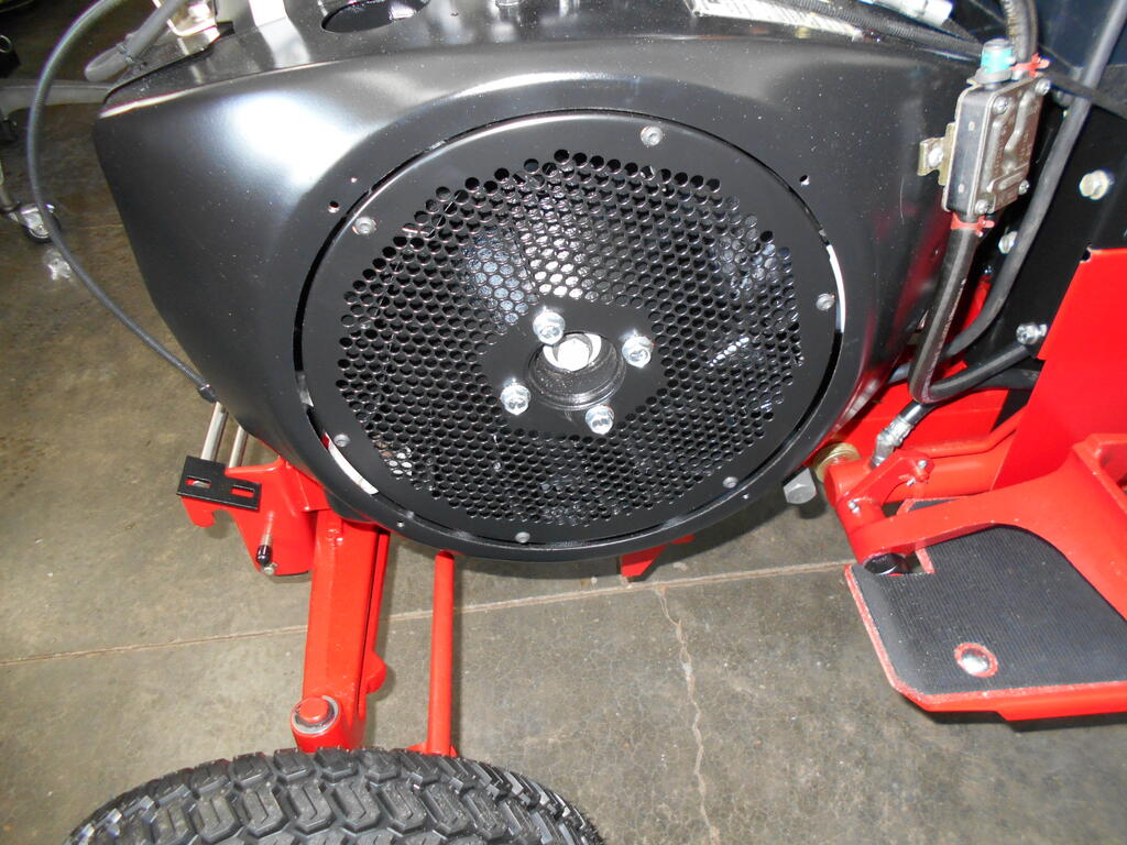

cleat 9,441 #350 Posted March 2 Onan engine stationary guard ready to be installed. Onan engine ready for stationary guard to be installed. Onan engine stationary guard installed and screws torqued to 22 in/lb. Tractor as of today. Hopefully it will warm up soon and I can get it out to set the carb. and hydro. 4 Share this post Link to post Share on other sites
