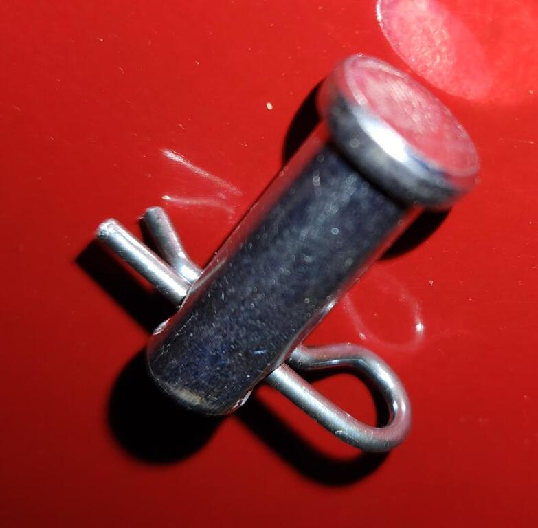

Handy Don 17,197 #58 Posted December 10, 2024 (edited) 10 minutes ago, Alrashid2 said: Hey guys, I think I am missing a few tiny components for my plow/frame setup. The two tiny pins that go on the rear axle bracket on either side, to keep the levers in place. Do any of you know where I can find replacements, or what I can search for at Ace hardware to relace? I rather not find a bolt/nut as I think I am going to be removing/installing this plow back and forth often and would prefer something closer to the original parts which were easy to pop on and off. Standard ¼” x ¾” clevis pins with R-clips to fit the pin’s holes. TSC, Hillman hardware drawers--any good hardware source. Buy a pack of each--they tend to run away from you and get lost! Edited December 10, 2024 by Handy Don Share this post Link to post Share on other sites
ebinmaine 80,087 #59 Posted December 10, 2024 11 minutes ago, Handy Don said: Standard ¼” x ¾” clevis pins with R-clips to fit the pin’s holes. TSC, Hillman hardware drawers--any good hardware source. Buy a pack of each--they tend to run away from you and get lost! We have at least a couple plow frames with smaller holes. We use a hairpin maybe 1/8" diameter? 1 Share this post Link to post Share on other sites
Handy Don 17,197 #60 Posted December 10, 2024 (edited) 3 minutes ago, ebinmaine said: We have at least a couple plow frames with smaller holes. We use a hairpin maybe 1/8" diameter? Excellent point. Details of the plow frame mounting bracket have changed over the years. If a ⅛” R clip (hairpin clip) works, go for it! Edited December 10, 2024 by Handy Don 1 Share this post Link to post Share on other sites
Alrashid2 476 #61 Posted December 10, 2024 (edited) That's easy enough! Clevis pin, that's the term I was looking for... Thank you guys I'll measure my axle bracket and see what size the holes are Edited December 10, 2024 by Alrashid2 1 Share this post Link to post Share on other sites

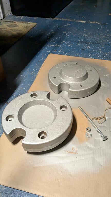

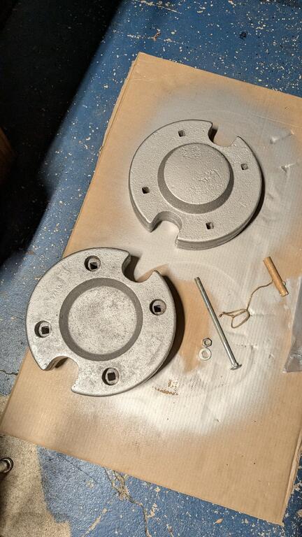

Alrashid2 476 #63 Posted December 11, 2024 Here are some photos of the wheel weights! Picture isn't doing it justice - they're a nice shiny metallic color now Any idea which way these go on the rear rim? I'm assuming these are not Wheel Horse brand? Share this post Link to post Share on other sites

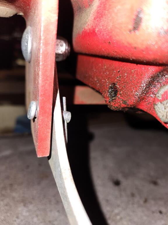

Brockport Bill 2,448 #64 Posted December 11, 2024 2 hours ago, Alrashid2 said: Hey guys, I think I am missing a few tiny components for my plow/frame setup. The two tiny pins that go on the rear axle bracket on either side, to keep the levers in place. Do any of you know where I can find replacements, or what I can search for at Ace hardware to relace? I rather not find a bolt/nut as I think I am going to be removing/installing this plow back and forth often and would prefer something closer to the original parts which were easy to pop on and off. here is photo of what i use for rear axle bracket - work well - - commonly available most hardware stores 2 Share this post Link to post Share on other sites

kpinnc 18,857 #66 Posted December 11, 2024 4 hours ago, Alrashid2 said: Any idea which way these go on the rear rim? I'm assuming these are not Wheel Horse brand? Doesn't matter on the brand. The recessed holes face the outside, for the carriage bolt heads to also be recessed. 1 Share this post Link to post Share on other sites

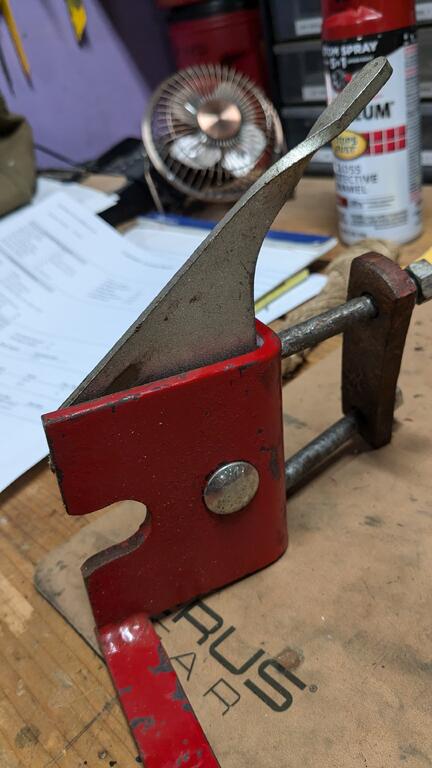

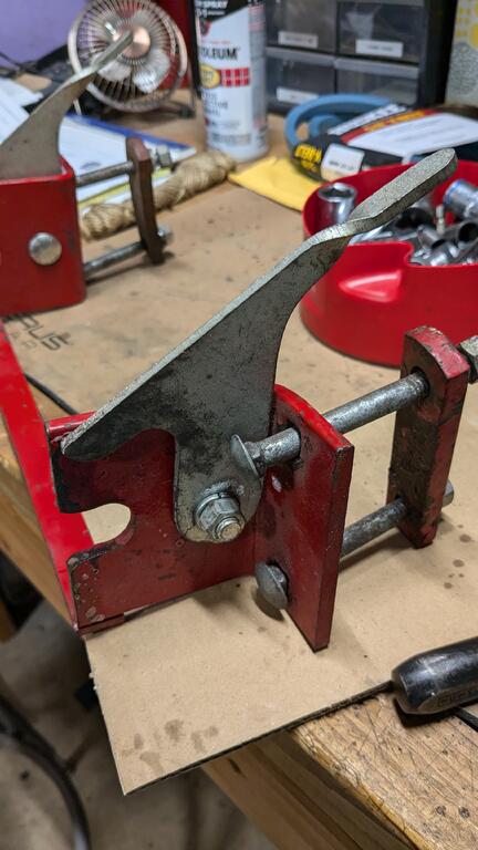

Alrashid2 476 #70 Posted December 11, 2024 Ha! I jumped the gun... Was going off of memory when I asked about the clevis pins. My axle bracket is missing the clevis pins because it doesn't have holes for them! Interesting... Did some of these come without them? Any of you have a rear axle bracket with no safety holes for pins? Think they'll hold fine without them? Share this post Link to post Share on other sites
ebinmaine 80,087 #71 Posted December 11, 2024 Just now, Alrashid2 said: Any of you have a rear axle bracket with no safety holes for pins? Think they'll hold fine without them? I do. I take the carriage bolts out and replace them with grade 8 regular bolts. Tighten that right up if you're leaving the plow frame on anyway. Share this post Link to post Share on other sites
Alrashid2 476 #72 Posted December 11, 2024 Thanks @ebinmaine for the advice. Curious why you swap the bolts? Couldn't I just tighten down with the carriage bolts? Share this post Link to post Share on other sites
ebinmaine 80,087 #73 Posted December 11, 2024 4 minutes ago, Alrashid2 said: Thanks @ebinmaine for the advice. Curious why you swap the bolts? Couldn't I just tighten down with the carriage bolts? Likely. My plow is VERY heavy so I use all new Grade 8 hardware. 1 Share this post Link to post Share on other sites
Wayne0 1,611 #74 Posted December 11, 2024 16 minutes ago, Alrashid2 said: Ha! I jumped the gun... Was going off of memory when I asked about the clevis pins. My axle bracket is missing the clevis pins because it doesn't have holes for them! Interesting... Did some of these come without them? Any of you have a rear axle bracket with no safety holes for pins? Think they'll hold fine without them? I would drill for the pins. You don't want the frame dropping off when you least expect it. Share this post Link to post Share on other sites
SylvanLakeWH 32,005 #75 Posted December 11, 2024 I've had both. No issue's either way, but tighten them up good if no pins... Easy to just drill out as well... added insurance... Share this post Link to post Share on other sites
