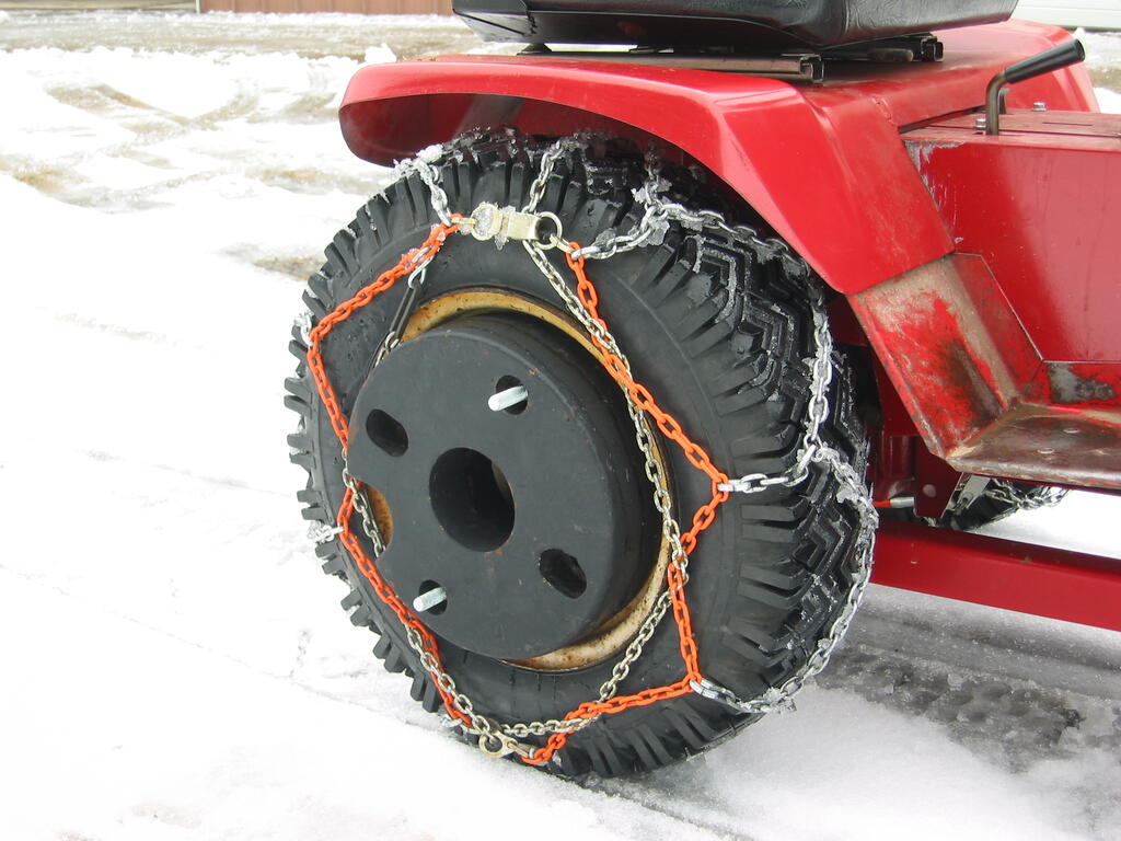

Ed Kennell 47,946 #26 Posted December 9, 2024 6 hours ago, Alrashid2 said: My thought was the added weight up front may help me stop my front end from jumping and doing wheelies at least! Having the weight of the plow out front will certainly be a plus in keeping the front end down especially when pulling those loads of firewood up the hill. Just get a set of Vee Bar chains. They work best on turf tires. I have chains for sale if you ever head west. 1 Share this post Link to post Share on other sites
Alrashid2 476 #27 Posted December 9, 2024 (edited) Thanks guys! Called Lincoln and we got the order squared away. I'll eventually make a post on how I did the retrofit of the Dial a Height, if i am successful... Also need to make a post update on replacing the belt when I get to that! Not a bad idea at all to go half a trailer... I need to haul up 4 carts worth every 3-4 weeks. The cart is small though, only 6 cubic feet, so I'll try a full cart first and worst case unload a bit if needed. We'll see. This is a grand experiment! May get some time this Sat to work on it. If not, it'll be next week. In the meantime, I did spraypaint the cast iron wheel weights that @davem1111 graciously sold me. Took a chance on this metallic aluminum Krylon paint and I think it'll match my rims pretty nicely!! EDIT: Scratch that, thought I snapped a photo but guess I didnt. will post one later! Edited December 9, 2024 by Alrashid2 1 Share this post Link to post Share on other sites
Alrashid2 476 #28 Posted December 9, 2024 Thanks @Ed Kennell will keep that in mind! Thought about doing chains but wasn't sure if they'd be too abrasive on a muddy yard. Yes, my lawn isn't pretty and has some ruts, but I didn't want to tear it up into a full on mud pit with chains 1 Share this post Link to post Share on other sites
ebinmaine 81,282 #29 Posted December 9, 2024 2 minutes ago, Alrashid2 said: didn't want to tear it up into a full on mud pit with chains Get the chains. Believe it or not you'll likely do LESS damage WITH chains. Chains prevent most of the wheel spin. From experience in mountain country..... you will NEED chains to move even the slightest distance uphill in frozen ground. 2 Share this post Link to post Share on other sites
Ed Kennell 47,946 #30 Posted December 9, 2024 2 minutes ago, Alrashid2 said: Thought about doing chains but wasn't sure if they'd be too abrasive on a muddy yard. IMO, just the opposite, Max traction with chains = less spinning when pulling and better control with less sliding when braking. 2 Share this post Link to post Share on other sites
ebinmaine 81,282 #31 Posted December 9, 2024 2 minutes ago, Ed Kennell said: IMO, just the opposite, Max traction with chains = less spinning when pulling and better control with less sliding when braking. Absolutely agreed Share this post Link to post Share on other sites
Ed Kennell 47,946 #32 Posted December 9, 2024 WOW, that's scary. The PeeAaa Ed dog and the Maine Bear typing the same message at the same instant. 1 2 Share this post Link to post Share on other sites
ebinmaine 81,282 #33 Posted December 9, 2024 2 minutes ago, Ed Kennell said: WOW, that's scary. The PeeAaa Ed dog and the Maine Bear typing the same message at the same instant. It should scare you ... that you think like me. 2 Share this post Link to post Share on other sites

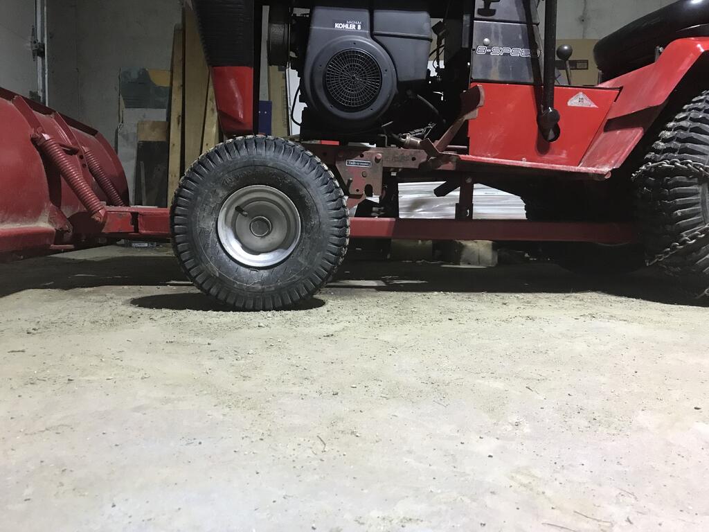

MainelyWheelhorse 3,208 #34 Posted December 9, 2024 7 hours ago, Alrashid2 said: Thanks all for the responses. I guess once i get the plow/frame figured out and installed, I'll be able to take her for a test drive and see how she does in the forest. Anyone have a side photo of a 300 series with a plow fully raised? I'd be curious to visually see how much ground clearance I lose with that frame under there @Alrashid2 On my 308 with the plow raised its roughly 5 3/4 to 6 inches at the lowest point and 6 1/2 out by the plow pivot. This is from a flat cement floor to the frame. 1 Share this post Link to post Share on other sites
Alrashid2 476 #35 Posted December 9, 2024 @MainelyWheelhorsethanks for this photo and for the measurements! Greatly appreciate it. Wow, so your photo shows the plow RAISED? That is much lower than I anticipated. I'll have to see if I can make that work or not! 1 Share this post Link to post Share on other sites
kpinnc 19,107 #36 Posted December 9, 2024 (edited) I’ll be the first to admit that snow isn’t something I normally deal with. That being said, my personal answer to the question about weights is what surface you use the tractor on making trips for wood. Weights and chains work great for pressing down against a prepared hard surface. Snow is displaced, and chains bite against the hard surface. Here at least, soft mud is more of an issue all year round. In that case, floatation mated with cleat and rib tires provides much better traction and control. Additional weight works against you, because the contact patch sinks. This makes every inch of forward motion is a climb out of a hole. Wheel spin is inevitable. Forgive me for being the monkey wrench bearer, but if you’re traversing snow covered wet ground, I am not sure extra weight and chains will benefit you. Of course if the ground is frozen (really frozen), you will be in better shape. Just something to think about… Edited December 9, 2024 by kpinnc Share this post Link to post Share on other sites
MainelyWheelhorse 3,208 #37 Posted December 9, 2024 @Alrashid2 I haven’t adjusted mine a ton from when I got it. I mounted mine off the mowing deck mounting arm. if yours has the chain to the mowing deck arm like my 308 you may be able to get more height out of it by moving the bolt on the arm further up the link or once you get the dial a height on cranking that all the way up. I haven’t had a huge problem with it unintentionally contacting the ground as it’s set up now. Share this post Link to post Share on other sites

ebinmaine 81,282 #46 Posted December 10, 2024 1 minute ago, Alrashid2 said: Question for you guys: do you need all 4 bolts on each wheel weight? Or is 2 enough, across from each other? We use 2 Share this post Link to post Share on other sites
Alrashid2 476 #47 Posted December 10, 2024 (edited) Nice! So no issue just using 2? anything i should be aware of? And do you have the nuts/threads on the outside or inside? I noticed my weights and rims both have square holes Edited December 10, 2024 by Alrashid2 Share this post Link to post Share on other sites
pfrederi 21,342 #48 Posted December 10, 2024 You use carriage bolts head to the inside with the square hole to anchor it. Share this post Link to post Share on other sites
Handy Don 17,735 #49 Posted December 10, 2024 (edited) 2 hours ago, Alrashid2 said: Nice! So no issue just using 2? anything i should be aware of? And do you have the nuts/threads on the outside or inside? I noticed my weights and rims both have square holes I agree that two is adequate when using iron weights. The concrete-filled plastic weights, however, have less internal structural integrity so I’d use all 4 with thick washers under the nuts to distribute the loading--and do NOT over tighten these lest you bend the plastic and crack the concrete inside. Also, with either type of weight, consider trimming and rounding the ends of the bolts so that they just barely protrude from the nylock nuts and don’t imitate the antagonist’s chariot in “Ben Hur” with your legs or shed door frame as targets! Edited December 10, 2024 by Handy Don 1 2 Share this post Link to post Share on other sites
