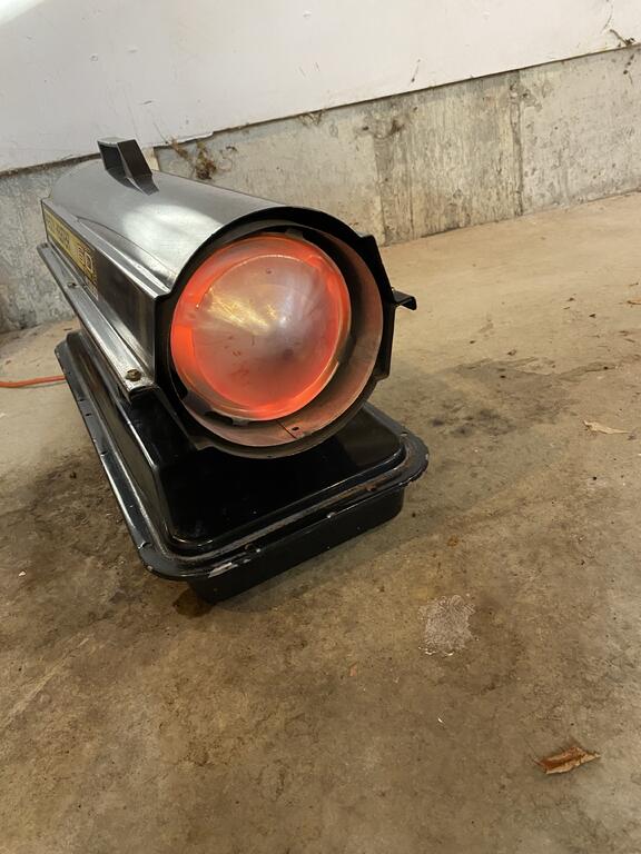

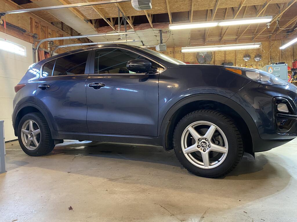

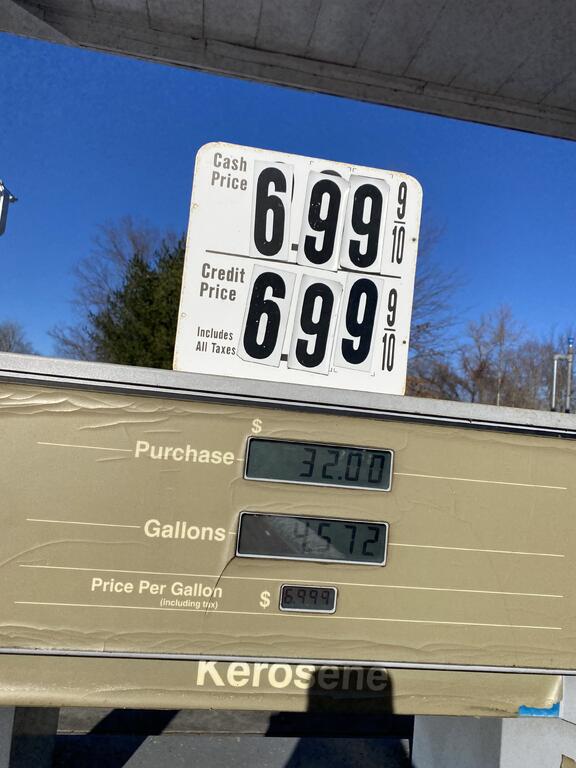

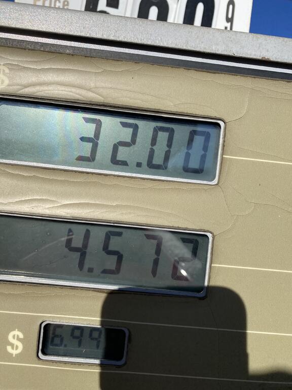

Sparky-(Admin) 25,982 #1 Posted December 6, 2024 In my garage I have a small kerosene salamander unit. Works great. Just used it today while I swapped on the snow tires on my daily commuter. Why is Kero so pricey? And I’ve heard you can run diesel in these? Is that true? Share this post Link to post Share on other sites

lynnmor 8,921 #6 Posted December 6, 2024 Diesel in a torpedo heater stinks more than kerosene. The year that the red dye came out two oil furnaces had their fuel pumps wasted, one furnace was on the second tank of fuel. The reason that kerosene is higher priced is simply that they want the money. 1 Share this post Link to post Share on other sites

Sparky-(Admin) 25,982 #8 Posted December 6, 2024 19 minutes ago, lynnmor said: Diesel in a torpedo heater stinks more than kerosene. The reason that kerosene is higher priced is simply that they want the money. Well I don’t want it to smell anymore than it does…I’ll probably just stick with kerosene, I won’t go thru enough that I need to be concerned about $$ 1 Share this post Link to post Share on other sites

c-series don 12,150 #10 Posted December 6, 2024 I have the same exact heater, I’ve had it for years and only ever ran on-road diesel in it. It smells a little bit on start up but then it goes away. I don’t think there’s any way to adjust it for different fuels? At the end of the winter I just make sure I run it out of fuel. It’s not my main source of heat for my garage, I only use it when it’s really cold to help take the chill off and then the LP gas heater can maintain the temperature. 2 Share this post Link to post Share on other sites

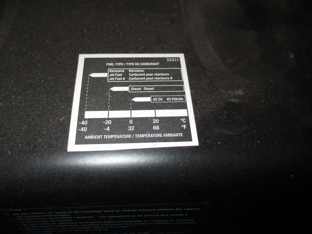

pfrederi 20,920 #14 Posted December 7, 2024 (edited) I have a Mr. Heater 175000 BTU Torpedo heater. Sticker shows what you can use depending on temperature. Been using dyed K1 for along time. Here if you have an outside fuel tank for your oil burner you have to use K1 and it is all dyed. doesn't seem to be an issue. There is a viscosity adjustment on the rear end. Edited December 7, 2024 by pfrederi Share this post Link to post Share on other sites

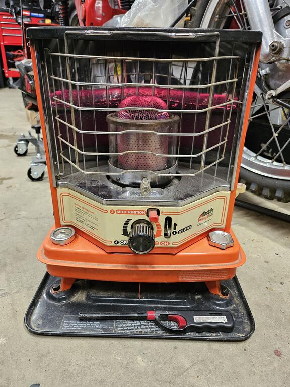

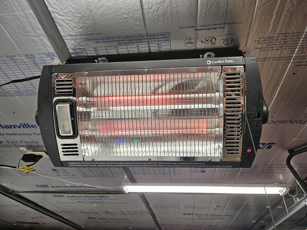

ML3 2,408 #17 Posted December 14, 2024 My garage is 24'x24'. Walls are insulated w/Rockwool insulation & then 5/8" OSB. Ceiling is 1" foil faced 4'x8' panels & then I blew 24" of insulation above that. I have 2 1500w electric heaters. Don't need the 2nd heater unless outside temps get down into the teens. I have an older kerosene heater & it works surprisingly well. Also have a torpedo heater but I don't use it as its too noisy & it stinks. Burning kerosene, diesel, Jet A, or anything still gives off odor (sometimes not easily detected) & carbon monoxide. Not so much an issue if your shop isn't insulated "tight" like my garage. Kerosene or any other fuel is expensive. With cost of electricity in my area its actually cheaper to heat with it. I buy plenty Jet A for my plane. I have just the one heater on a thermostat set @38° so my chemicals, etc don't freeze. Share this post Link to post Share on other sites
