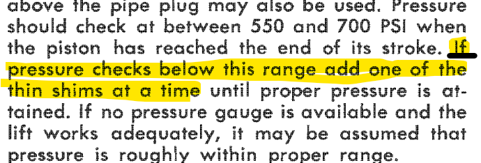

Bar Nuthin 3,205 #26 Posted April 30, 2025 5 hours ago, ebinmaine said: After a series of "delay in game".... I'm getting back to this soon. I'm interested to learn how you make out on the shims. That's the one item I don't have - and NOS seem expensive for what they are. I'm contemplating using washers or trimming a small piece off the end of a stainless machine screw. 1 Share this post Link to post Share on other sites
ebinmaine 80,692 #27 Posted April 30, 2025 1 hour ago, Bar Nuthin said: I'm interested to learn how you make out on the shims. That's the one item I don't have - and NOS seem expensive for what they are. I'm contemplating using washers or trimming a small piece off the end of a stainless machine screw. I'm reasonably sure I won't be needing new shims for my operation because I (should have) a set of the required parts in my own '70 Charger pump or the '78 C141 parts tractor. Share this post Link to post Share on other sites
ineedanother 2,864 #28 Posted May 1, 2025 This thread is timely...I just moved hydro lift from a spent, abused, '75 c-160 to a '73 Electro 12 with a manual lift but a 10 pinion L/S differential. I moved the K341 too because it was smokeless and I don't really care about the fuel consumption. The point is that the '75 c-160 with the 1140 didn't have any shims. Everything moved right onto the 1136 and is working fine. 2 1 Share this post Link to post Share on other sites
Bar Nuthin 3,205 #29 Posted May 1, 2025 1 hour ago, ebinmaine said: I'm reasonably sure I won't be needing new shims for my operation because I (should have) a set of the required parts in my own '70 Charger pump or the '78 C141 parts tractor. It sounds like there's a chance no shims are needed at all - othewise add one at a time. I guess I'll cross that bridge when I get to it. 2 Share this post Link to post Share on other sites

ineedanother 2,864 #32 Posted May 2, 2025 23 hours ago, Bar Nuthin said: It sounds like there's a chance no shims are needed at all - othewise add one at a time. I guess I'll cross that bridge when I get to it. ...and beyond that, what exactly are these rather pricey shims? Neither one of my hydros has them so I've never seen them but images don't show them to be anything that couldn't be duplicated in a shop pretty easily IMO. What says the brain trust who has experience with the "shim set"? 2 Share this post Link to post Share on other sites
