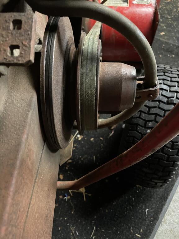

Canoetom85 21 #1 Posted December 4, 2024 Hi all, looking for some help regarding my clutch pad - can anyone tell me based off this picture if it needs replacing or should I just adjust Trunion more? Also if replacement is needed any suggestions on where to get one. I see amazon has some that match the original part number but no reviews on them. Thank you! Share this post Link to post Share on other sites
oliver2-44 11,847 #2 Posted December 4, 2024 From the picture there appears to be enough clutch surface. However I suggest you remove the hoop and slide the clutch off. Then you can make sure you’re not close to riding on the clutch brass rivets. It’s also an excellent opportunity to clean/wipe the inner bearing out with a very clean rag and regrease. Don’t put too much grease or it will sling it out onto the clutch. If needed you can get a new quality clutch from Wheel Horse Parts and More. 1 Share this post Link to post Share on other sites

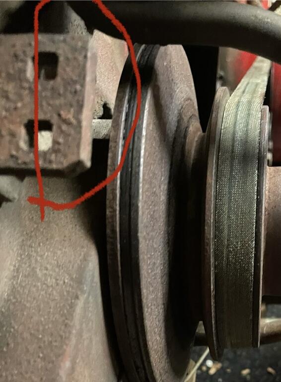

Canoetom85 21 #3 Posted December 4, 2024 Awesome thank you I wasn’t sure as the trunion adjustment was close to the end of the threaded area. Also any idea what this is for? Is there supposed to be something attached to this? (Circled in red) Share this post Link to post Share on other sites
lynnmor 9,081 #4 Posted December 4, 2024 The PTO brake bolts on there. https://wheelhorsepartsandmore.com/product/110665-94-6652-brake-assembly-for-wheel-horse/ 94-6652-Brake-Arm-Assembly-300x300.webp 1 Share this post Link to post Share on other sites
peter lena 10,125 #5 Posted December 4, 2024 @Canoetom85 https://www.ebay.com/itm/283925877502 hitch pin clip on pto cone drive is missing ! the puter round swing arm is not connected to the cone driven section ! center hole shaft cone about 9 o clock , outside swing connection , should share that , hitch pin clip , hiding in plane site , those 2 horizontal holes are connected with the hitch pin clip , pete 2 3 Share this post Link to post Share on other sites
peter lena 10,125 #6 Posted December 4, 2024 @Canoetom85 https://www.google.com/search?q=wheel+horse+clutch+pin+clip&rlz=1C1CHBF_enUS866US866&oq=wheel+ho&gs_lcrp=EgZjaHJvbWUqCAgAEEUYJxg7MggIABBFGCcYOzIGCAEQRRhAMgYIAhBFGDkyBggDEEUYQTIGCAQQRRhBMgYIBRBFGDwyBggGEEUYPDIGCAcQRRhBqAIAsAIB&sourceid=chrome&ie=UTF-8#oshopproduct=pid:14044100982790593695,oid:14044100982790593695,iid:3972225061938499147,pvt:hg,pvo:3&oshop=apv&pvs=0 same clip type , front / side view , looking right at ait , pete 1 Share this post Link to post Share on other sites
oldlineman 1,821 #7 Posted December 4, 2024 yup you nailed it Peter,that missing pin is your problem when installed will give you more adjustment. Share this post Link to post Share on other sites
ri702bill 13,394 #8 Posted December 4, 2024 A LOT of folks ditch the brake pad - easier to service the PTO without it. And the airgap needs to be set each time it is re-installed - that is why the bracket is slotted. Share this post Link to post Share on other sites
Ed Kennell 47,946 #9 Posted December 4, 2024 2 hours ago, peter lena said: hitch pin clip on pto cone drive is missing Yep. pete's eyes are still good. Put that pin in and remove the brake bracket. Readjust the trunnion tension. Share this post Link to post Share on other sites

peter lena 10,125 #14 Posted December 5, 2024 @ri702bill have also long removed my clutch brake pad set up , thought the set up only increased the trouble spot , also since going over to a 550 deg flash point grease , in every related movement point , including inner cone needle bearing , the movement / spin ease , is silent / smooth , if you looked at it , would not even notice the pad removal , but would notice the silent , rotational running ease . combine that with some , PTO LEVER start detailing , like eliminating sloppy start point . next to battery tray , also added the dreaded , heim joint, at lever end to clutch engagement point , no noise , no rust , just smooth quiet engagement . been road testing it for years now , with no issues , on 3 horses , pete 2 Share this post Link to post Share on other sites
Lee1977 7,813 #15 Posted December 5, 2024 (edited) There is one more thing to check while you in there. The short shaft in the end of the PTO pulley has a C-clip on the out side if it come out of the groove you won't be able to keep it adjusted. There is another inside C-clip but I've never had any trouble with it. I have had to replace that short shaft a couple of times in the last 47 years when they get worn to the point a C-clip won't stay in. Don't know when they changed the PTO pads or what model you have, but the later ones are glued on you may not have rivets Edited December 5, 2024 by Lee1977 1 Share this post Link to post Share on other sites
