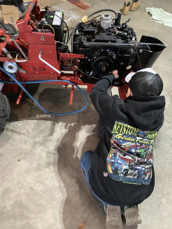

TonyToro Jr. 2,539 #51 Posted December 9, 2024 Urghhh! Well I guess I got too excited. Cranked great all last night and 2 times today, hooked spark test on and have good spark on both cylinders. Took off the spark tester and was good for one more crank. Then put fuel in it and didn’t crank when I went again. Took of the ignition plug fuse and wiring all was good. Put it back on and cranked. Then took the fuel filter off till I got fuel coming out and went to go and crank again and nothing, Checked ignition plug wiring harness good. But fuse is blown again. I didn’t like how the pedal interlock safety wires were loose so I replaced those. Help? Share this post Link to post Share on other sites

TonyToro Jr. 2,539 #69 Posted December 16, 2024 Sorry haven’t worked on the tractor since the last post. Had a town Christmas parade that we were in with ICU small engine. (This is the guy whose neighbor I got the tractor from). Probably will work on it again today and will get back to you. Hopefully we can figure it out 🤞 1 1 Share this post Link to post Share on other sites
TonyToro Jr. 2,539 #70 Posted December 18, 2024 Worked on the tractor yesterday. Don’t want to spoil anything so you guys need to wait until I get home!! 2 Share this post Link to post Share on other sites
TonyToro Jr. 2,539 #71 Posted December 18, 2024 Well here you go! IMG_0040.mov 1 4 Share this post Link to post Share on other sites
