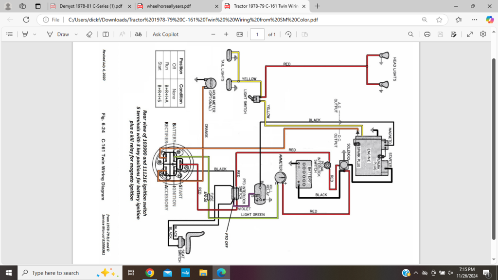

TonyToro Jr. 2,560 #13 Posted November 26, 2024 Do you think this wiring diagram would be the same even though this is a twin with electric ignition? Share this post Link to post Share on other sites

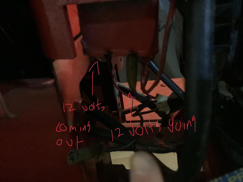

TonyToro Jr. 2,560 #14 Posted November 26, 2024 Working on the tractor right now. Hooked up amp meter and now getting power (12.66) volts to the ignition switch. Now getting 12.64 volts out of the ignition switch going to I guess some sort of rectifier. And if a wiggle the wires a bit the solenoid starts buzzing. Help? Share this post Link to post Share on other sites
TonyToro Jr. 2,560 #15 Posted November 26, 2024 Doing some more testing. When solenoid is buzzing I got voltage going too it and making it buzz, but I don’t think anything is coming out. Share this post Link to post Share on other sites
953 nut 70,654 #16 Posted November 27, 2024 11 hours ago, TonyToro Jr. said: electric ignition? Is the engine a Magnum Twin or a K twin with an ignition coil. 2 hours ago, TonyToro Jr. said: if a wiggle the wires a bit the solenoid starts buzzing. Is the solenoid well grounded? Make sure the transmission is in neutral. Use a small jumper wire from the battery side BIG terminal of the solenoid to the small terminal of the solenoid that goes to the ignition switch, the solenoid should close and turn over the starter. Share this post Link to post Share on other sites
TonyToro Jr. 2,560 #17 Posted November 27, 2024 2 minutes ago, 953 nut said: Is the engine a Magnum Twin or a K twin with an ignition coil. Is the solenoid well grounded? Make sure the transmission is in neutral. Use a small jumper wire from the battery side BIG terminal of the solenoid to the small terminal of the solenoid that goes to the ignition switch, the solenoid should close and turn over the starter. The engine is a Briggs ic 16 opposed twin. It’s a c-161 twin. I think the solenoid is well grounded. I have all 4 bolts holding on the plate and the 2 bolts securing the solenoid to the plate. The funny thing also is if my dad hits it it stops buzzing. Share this post Link to post Share on other sites

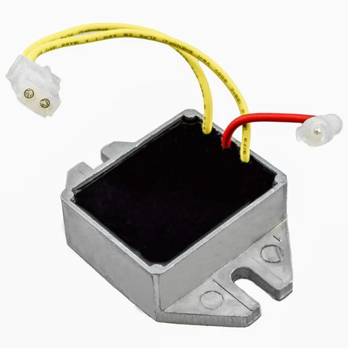

953 nut 70,654 #19 Posted November 27, 2024 10 minutes ago, TonyToro Jr. said: Briggs ic 16 opposed twin. It’s a c-161 twin. C-161 came with Kohler and Briggs engines, here is the wiring diagram for the Briggs equipped C-161. The kill relay for the magneto ignition is the major difference in the wiring and has NOTHING to do with the start5 function, it just grounds the ignition if the key is turned off or the PTO is on without someone in the seat. This may be what you have been calling a rectifier. Take another picture of the area where the solenoid is located with better lighting so we can make out what you are looking at. Just for your information the voltage regulator on a Briggs is under the engine cover and looks like this. 1 Share this post Link to post Share on other sites

953 nut 70,654 #21 Posted November 27, 2024 3 minutes ago, squonk said: Richard. Do you have a link to the older demistify guide. All I can find goes back to only 85 No I don't, this is listed with the owner manual wiring and was colored by Gary. Share this post Link to post Share on other sites
TonyToro Jr. 2,560 #22 Posted November 27, 2024 (edited) 4 minutes ago, 953 nut said: Take another picture of the area where the solenoid is located with better lighting so we can make out what Edited November 27, 2024 by TonyToro Jr. Share this post Link to post Share on other sites
TonyToro Jr. 2,560 #23 Posted November 27, 2024 Just now, TonyToro Jr. said: Will do! I will in the morning, garage doesn’t have very good lights. Share this post Link to post Share on other sites
