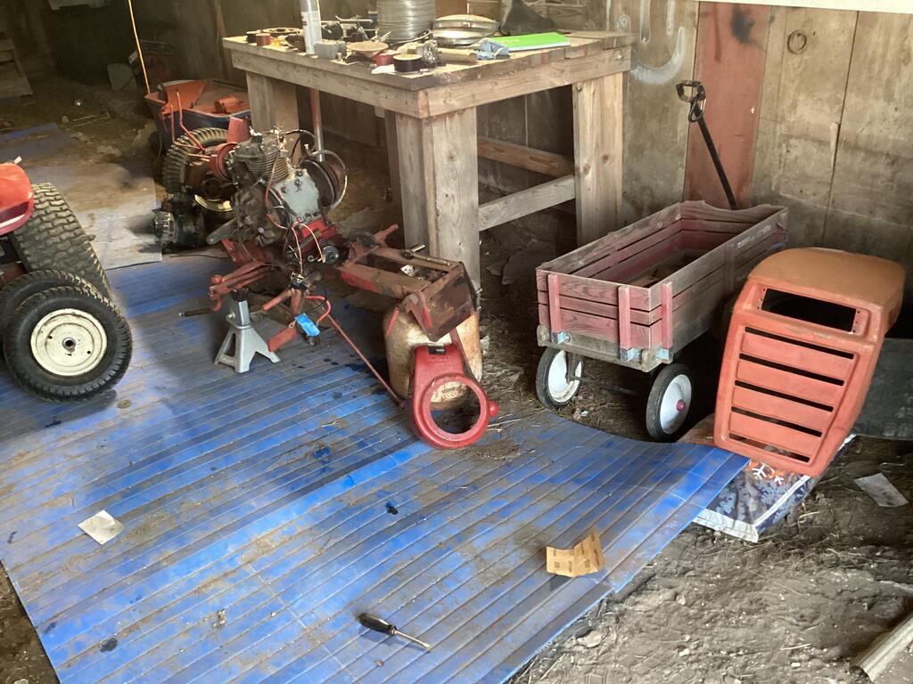

Easton Rich 1,250 #1 Posted November 22, 2024 I decided that since I was putting all of my restoration info under wh tractors I might get called out. So this is the restoration of my 1976 B-80 8-Speed 1 Share this post Link to post Share on other sites

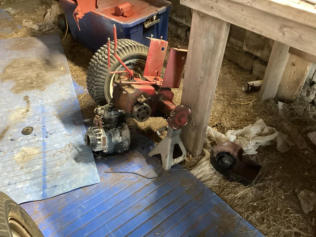

Easton Rich 1,250 #2 Posted November 22, 2024 I also have a question, why is my rear end leaking out of the top left bolt hole where it mounts to the frame? I split them and it’s leaking like a siv 1 Share this post Link to post Share on other sites
oliver2-44 11,529 #3 Posted November 22, 2024 We love restorations, no matter where you post them. The transmissions 4 frame mounting holes are drilled and tapped all the way into the case. So gear oil can easily pour out of them once removed. Screw a bolt back into the holes to reduce leaking. If you plan to drain it, now is a good time. 2 Share this post Link to post Share on other sites
kpinnc 18,413 #4 Posted November 22, 2024 (edited) 2 hours ago, oliver2-44 said: The transmissions 4 frame mounting holes are drilled and tapped all the way into the case. Yep. Gear drives are drilled all the way through. Hydros are not, at least not into the sump. Edited November 22, 2024 by kpinnc 1 Share this post Link to post Share on other sites
ri702bill 12,239 #5 Posted November 22, 2024 So, a B80 8-speed?? Nice!! Sounds like the dis-assembly has begun already. A couple of pointers - Pictures... take lots of pictures from different angles as you go. Particularly of the "little" stuff. Wire routing, linkage for carb, etc. The stuff that drives you crazy at re-assembly. Organization - bag & tag fasteners as you go. You will need a clean area at least 4x the footprint of the tractor for work & storage. Remove the engine and Unidrive (they can stay intact, for now) Bare frame - DO inspect the "F" plate on the frame mounts the Unidrive for cracks around the 4 bolt holes. If it is damaged, NOW is the time to fix it. Inspect anything that moves for wear. Front axle joints, clutch & brake linkages, upper & lower steering. Decide to repair or replace accordingly. "Do it once, do it right" Bill 1 3 Share this post Link to post Share on other sites

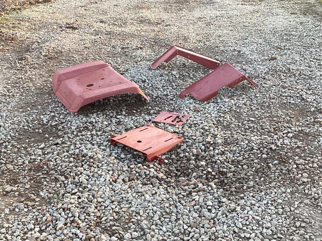

Easton Rich 1,250 #12 Posted November 24, 2024 Putting the tins away for the winter after I prime them due to me not having a temp controlled paint booth 3 Share this post Link to post Share on other sites

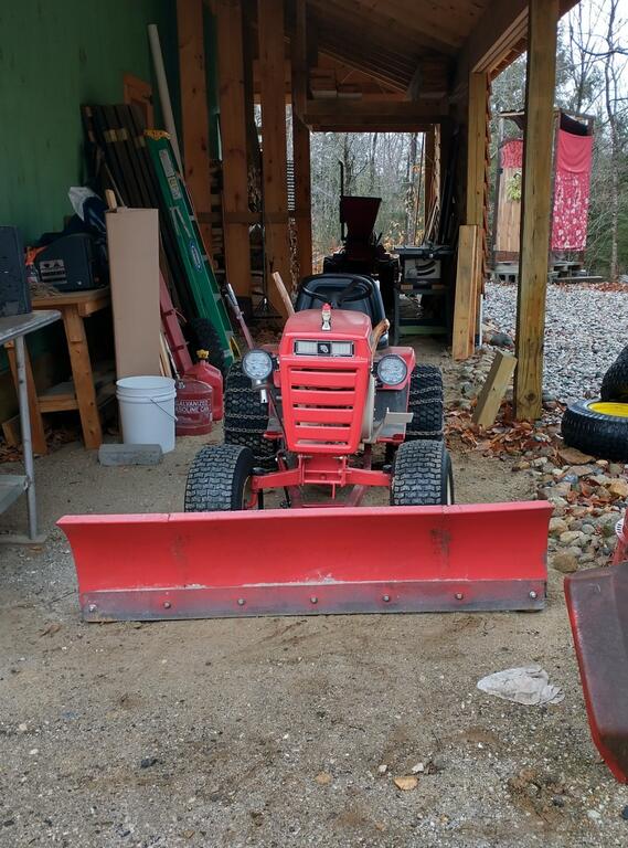

ebinmaine 79,136 #25 Posted November 27, 2024 12 minutes ago, Easton Rich said: Dang you’re lighting up the world Here's the beast... 6 Share this post Link to post Share on other sites
