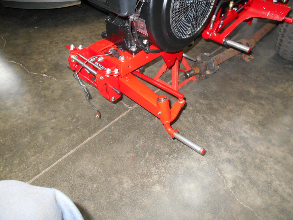

Wvtroutbum81 304 #4 Posted February 26, 2025 After letting paint cure I got the tower and lift arm installed 1 11 Share this post Link to post Share on other sites

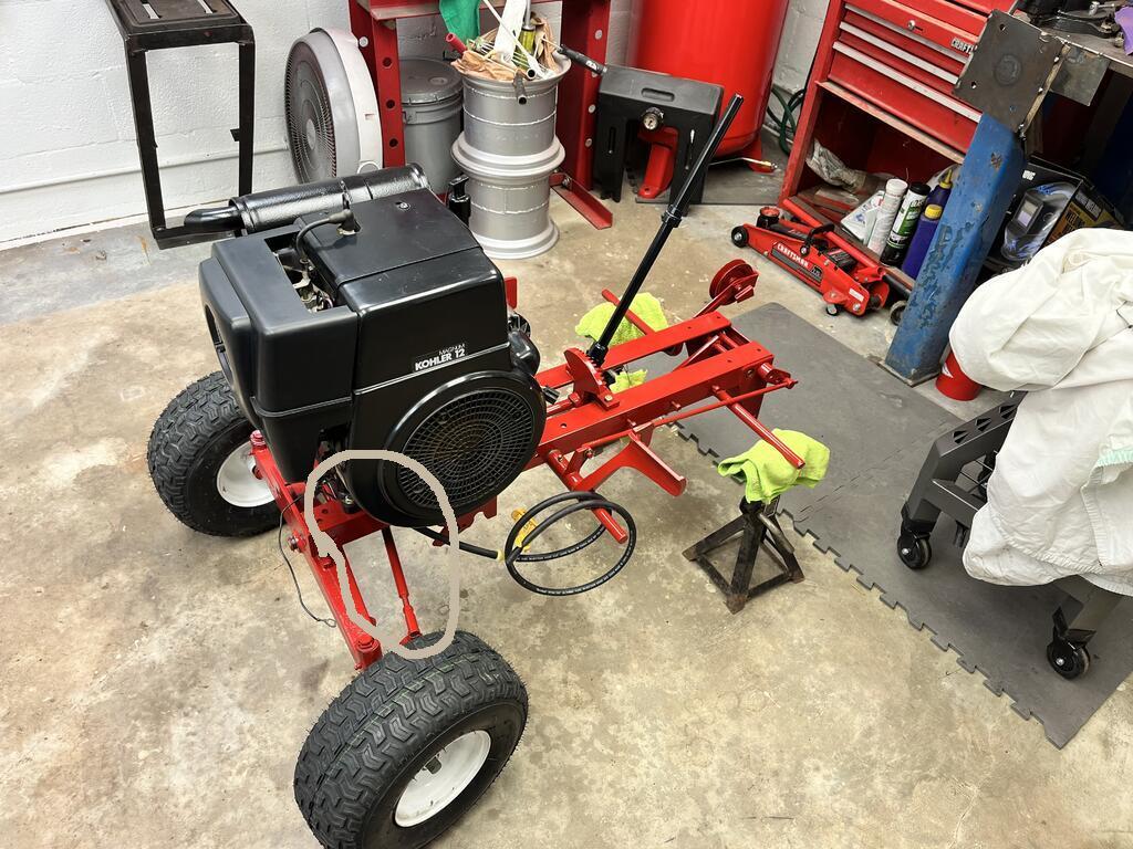

Wvtroutbum81 304 #10 Posted March 1, 2025 A little more progress. 1 6 Share this post Link to post Share on other sites

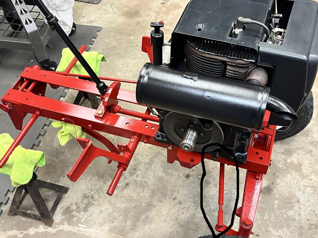

Wvtroutbum81 304 #11 Posted May 28, 2025 Finally got the transmission rebuilt, all new bearings and seals. Thank you @stevasaurus for the wisdom! 1 8 Share this post Link to post Share on other sites

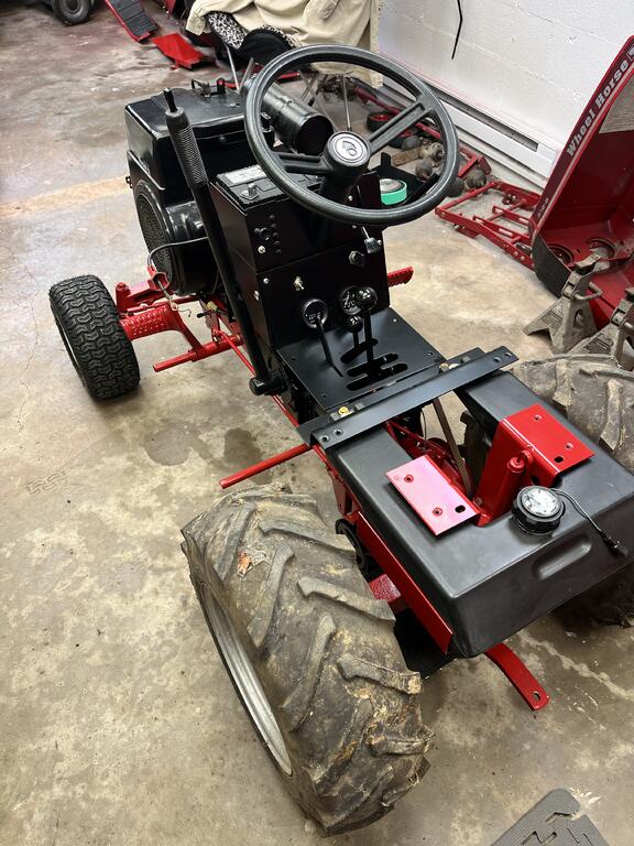

Wvtroutbum81 304 #15 Posted September 23, 2025 Finally had some time to put more together, it started and ran😁 Only problem was it would not shut off and I had to pull the plug wire. I did cut the harness down so🤷♂️ 3 2 Share this post Link to post Share on other sites
Wvtroutbum81 304 #16 Posted September 23, 2025 I had to add a wire here, I can’t remember if I pulled power from the start side or magneto side of ignition switch. I believe this is the problem. any suggestions 1 Share this post Link to post Share on other sites
953 nut 65,927 #17 Posted September 23, 2025 11 hours ago, Wvtroutbum81 said: can’t remember if I pulled power from the start side or magneto side of ignition switch. 11 hours ago, Wvtroutbum81 said: it started and ran Congratulations on completing your restoration, looks good. The magneto side of your ignition switch should never see any voltage. The "M" terminal should be grounded when the switch is OFF and have no continuity to anything in the ON and START positions. The failure to shut off could be not having a ground on the ignition switch body. Share this post Link to post Share on other sites
Wvtroutbum81 304 #18 Posted September 23, 2025 3 hours ago, 953 nut said: Congratulations on completing your restoration, looks good. The magneto side of your ignition switch should never see any voltage. The "M" terminal should be grounded when the switch is OFF and have no continuity to anything in the ON and START positions. The failure to shut off could be not having a ground on the ignition switch body. I have very limited electrical knowledge, there is a ground wire on the ignition switch thats grounded to the frame. Share this post Link to post Share on other sites
Wvtroutbum81 304 #19 Posted September 24, 2025 Sure has came a long way since I pulled it out of a brush pile.Don’t mind the tires. 1 1 Share this post Link to post Share on other sites
953 nut 65,927 #20 Posted September 24, 2025 (edited) 8 hours ago, Wvtroutbum81 said: limited electrical knowledge Lets do a bit of trouble shooting. With the engine running and the PTO on if you leave the seat does the engine quit running? If it doesn't then the dark blue wire from the PTO switch which joins a wire from the ignition switch "M" terminal is not connected to the engine. That is the wire that should shut down the engine. There is a five terminal connector (only four wires go through it) between the engine and the wiring harness. There is a light blue wire and a dark blue wire coming from the oil level switch at the base of your engine, ignore them. There is another dark blue wire that goes to the magneto on the engine and the PTO / ignition switch in the harness. If you have an ohm meter (or a friend that can come over and help) you can probe that dark blue wire and check it. With the key OFF that dark blue wire should read zero ohms to ground and should have no reading with the ignition key in the run position and the PTO off. Let us know what you find. Edited September 24, 2025 by 953 nut fat finger Share this post Link to post Share on other sites
Wvtroutbum81 304 #21 Posted September 24, 2025 34 minutes ago, 953 nut said: Lets do a bit of trouble shooting. With the engine running and the PTO on if you leave the seat does the engine quit running? If it doesn't then the dark blue wire from the PTO switch which joins a wire from the ignition switch "M" terminal is not connected to the engine. That is the wire that should shut down the engine. There is a five terminal connector (only four wires go through it) between the engine and the wiring harness. There is a light blue wire and a dark blue wire coming from the oil level switch at the base of your engine, ignore them. There is another dark blue wire that goes to the magneto on the engine and the PTO / ignition switch in the harness. If you have an ohm meter (or a friend that can come over and help) you can probe that dark blue wire and check it. With the key OFF that dark blue wire should read zero ohms to ground and should have no reading with the ignition key in the run position and the PTO off. Let us know what you find. Thank you. All the safety switches have been removed along with the circuit board. I will try tomorrow 1 Share this post Link to post Share on other sites

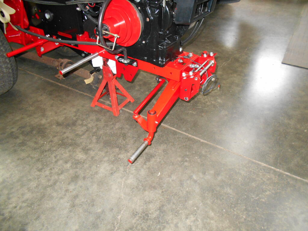

cleat 8,976 #24 Posted September 24, 2025 11 hours ago, Wvtroutbum81 said: Sure has came a long way since I pulled it out of a brush pile.Don’t mind the tires. I bet with a good cleanup those tires will look much better. Your tractor may steer just fine but I notice your tie rods are on an angle due to being on the wrong side of the lower steering shaft. If you put them in from the front like this they will be straight. Great job on the tractor, it looks better than new. 2 2 Share this post Link to post Share on other sites
Wvtroutbum81 304 #25 Posted September 24, 2025 9 hours ago, cleat said: I bet with a good cleanup those tires will look much better. Your tractor may steer just fine but I notice your tie rods are on an angle due to being on the wrong side of the lower steering shaft. If you put them in from the front like this they will be straight. Great job on the tractor, it looks better than new. Thanks, your tractor looks top notch also Share this post Link to post Share on other sites
