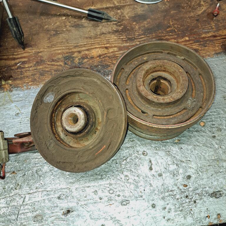

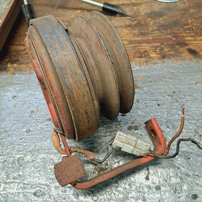

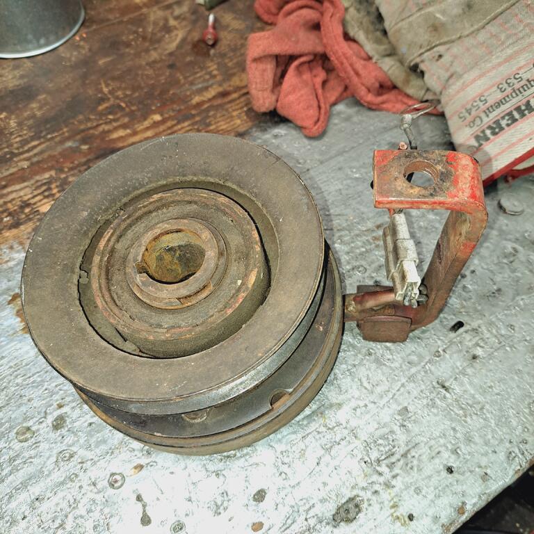

WHX?? 54,553 #1 Posted November 16, 2024 @kpinnc needs one and I have this one just laying around doing nothing. Will it fit his tractor? I think he said it's a Bronco 12 ? He'll be along to confirm. Like to make sure he can use it and if its any good 'fore we go thru the time and expense to get it to him. 1 1/8 crank size. The coil measures about 40 ohms and it does go click clack when I throw the juice to it. The bearing seems abit noisy but hard to tell without spinning it 3600. Guessing a replacement bearing can be had if needed?? 1 Share this post Link to post Share on other sites

953 nut 63,984 #4 Posted November 16, 2024 He probably will need to drill and tap the end of his crankshaft for the retainer bolt, otherwise no problem. 1 Share this post Link to post Share on other sites
WHX?? 54,553 #5 Posted November 16, 2024 1 hour ago, 953 nut said: He probably will need to drill and tap the end of his crankshaft for the retainer bolt, otherwise no problem. If this is going on one of his tractors that he repoed may have to remake the side arm? Does 40 ohms sound about right for the coil? I didn't check to see if it was shorted to gnd. Share this post Link to post Share on other sites
squonk 45,379 #6 Posted November 16, 2024 41 minutes ago, WHX?? said: If this is going on one of his tractors that he repoed may have to remake the side arm? Does 40 ohms sound about right for the coil? I didn't check to see if it was shorted to gnd. If it was shorted to ground, Mr. Sparkels would have stopped by to say hello! . Normal electomagnetic clutch coil resistance should be in the 3-5 ohm range. https://macsmobileairclimate.org/2021/09/07/facts-to-know-about-the-compressor-clutch-coil/ 1 1 Share this post Link to post Share on other sites

pfrederi 19,797 #8 Posted November 16, 2024 (edited) Most all WH Kohler big block cranks are tapped in the end 7/16 NF Will work fine for holding PTO on. Should bolt right on once in a while you need a small standoff spacer for the bracket. Most of my coils read 3.5-4.0 ohms...Your reading of 40 ....may have missread scale??? Outer bearing could be 6204NSL need to see face of the unit to be sure some older ones used a different outer bearing. inside (rear) bearing there are two types one is NLA but I thank you can use a newer one and some spacers. Edited November 16, 2024 by pfrederi 2 Share this post Link to post Share on other sites
squonk 45,379 #9 Posted November 16, 2024 35 minutes ago, pfrederi said: Most of my coils read 3.5-4.0 ohms...Your reading of 40 ....may have missread scale??? @WHX?? was probably using that UEI meter again! Share this post Link to post Share on other sites
