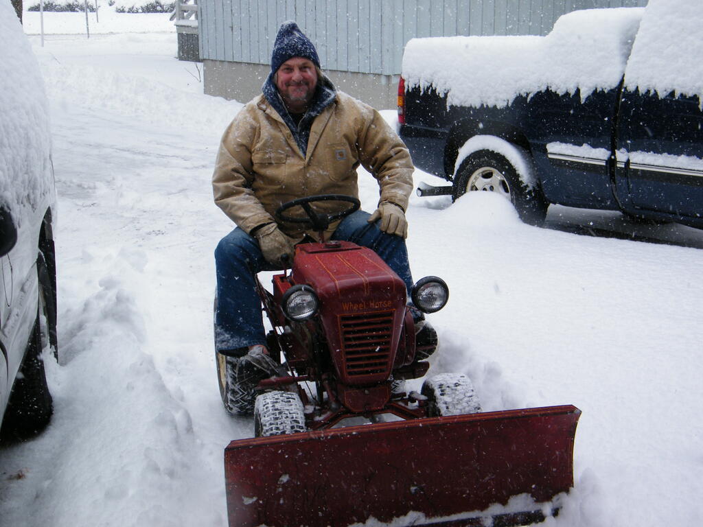

Alrashid2 476 #5 Posted November 13, 2024 Thank you all for the advice and giving your experience! Definitely helps me. I know some of this might be common sense to you guys, but to me it was a bit unintuitive compared to what I'm used to with modern engines (example: idling in a car is OK while idling with a Kohler is a no go!) @stevasaurus Thanks for the pics buddy! You look like youre having fun. Is that a 42" plow? I'll be buying a 42" from @davem1111 hopefully soon! I'm hoping to run 30W oil all year as well. My tractor isn't garage kept, but I'll be sure to let her warm up nice and good before going to work. I'll rarely use this for snow plowing and more for refilling firewood from the house. I usually choose the nicest day of the week to do that anyhow, so doubt I'd be running much below 25F if at all. Great point about the gear oil! I hadn't even put together that the transaxle gears are moving around in there even when sitting still... And I think you are thinking of another tractor with the cupholder - but now I want to see that too! You now have me thinking of buying a magnetic cup holder and putting one on mine... Which now makes me think of another question I wanted to ask on here, though unrelated to this conversation: I'd like to put some sort of satchel or pouch on the back of my seat/tractor somehow... any ideas? Just to get the tractor out and moving, I have been using it to take rifles and ammo down and back from my little shooting range. It'd be nice to have a little something to throw some bullets and mags in! 2 Share this post Link to post Share on other sites

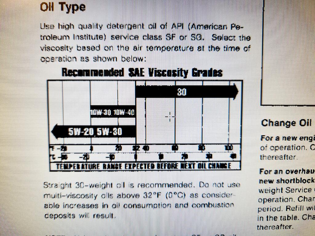

gwest_ca-(File Mod) 12,505 #6 Posted November 13, 2024 Engine operator manual may help 2 Share this post Link to post Share on other sites
stevasaurus 23,857 #7 Posted November 13, 2024 Yes...42" blade. You have that nice receiver on that horse now, why not fabricate a device to come off that with the basket or what ever you need to haul the ammo and such ?? Might be able to even buy something that fits the receiver you can use. 4 Share this post Link to post Share on other sites

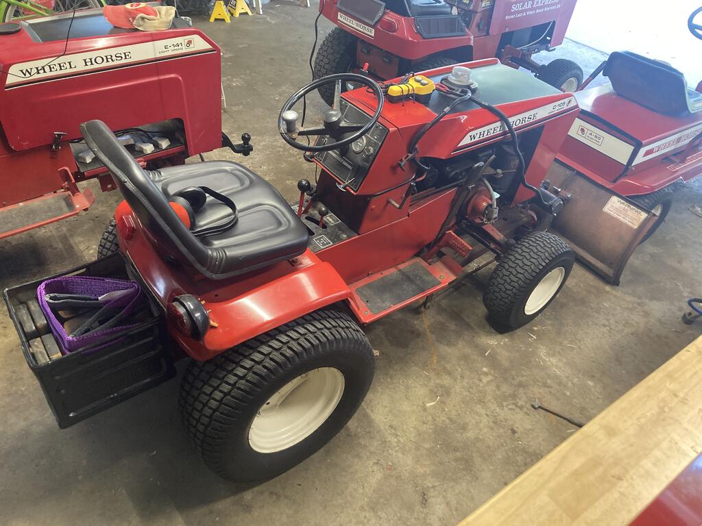

SylvanLakeWH 32,685 #9 Posted November 13, 2024 Milk crate bolted to a harbor freight winch plate that goes into 2" hitch... i use it for weight but you can use it for whatever... 3 Share this post Link to post Share on other sites
Alrashid2 476 #10 Posted November 13, 2024 My lord @SylvanLakeWH that is exactly what I was envisioning! Totally looking into that now... maybe I can make a little wooden box or something out of scrap. Thank you for sharing! This place ROCKS 2 Share this post Link to post Share on other sites

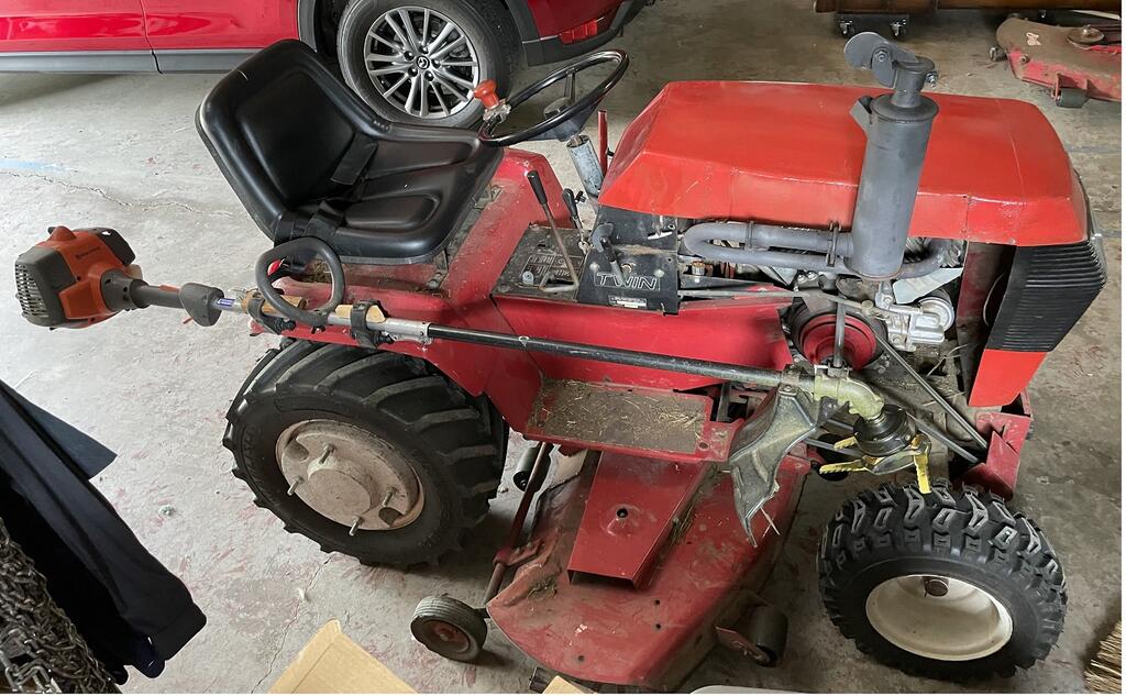

davem1111 2,382 #11 Posted November 13, 2024 Regarding carrying stuff with the tractor - I got these tool holders at Tractor Supply a while back and mounted them on the fender. They're great for carrying an axe, shovel. loppers, even a weed whacker as you can see here. Could probably carry a rifle on there, or maybe even make an "A" frame sticking up that you could put several pairs of these on, or a truck gun rack. Ammo box would be easy. The limit is how far your imagination can go.... 1 2 Share this post Link to post Share on other sites

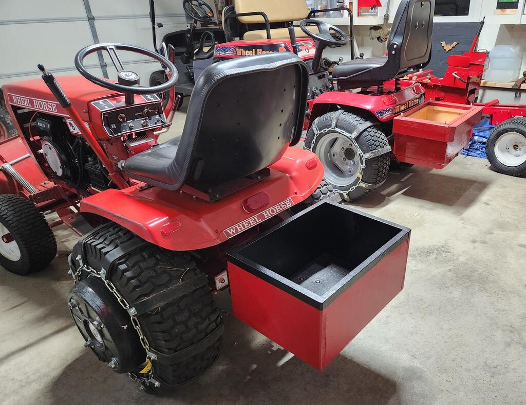

Racinbob 13,210 #14 Posted November 14, 2024 I know generators and some other things are fixed throttle but I still cringe when I hear a cold engine start up and immediately go full throttle. I use straight 30w all year in my K-Series and Magnum, 10w30 in the pressurized Command. My garage seldom gets below freezing. I'll run at low rpm for a few minutes then at whatever the job dictates. Full throttle for PTO driven attachments with some exceptions. My sickle bar mower is one of those. I've never worried about running a splash engine at low throttle. There's still plenty of air movement and do the math on how many times that little dipper slings oil around per second. No problem. Here's what I do for cargo and addition weight. Both go into Lowells receivers. The box on the 76 is mounted on a ATV winch mount and fairly light. The box on the 05 was never intended for this use but converted later. It has a 2" solid bar and is heavy making it harder to mount/dismount but can hold pretty much unlimited weight. 1 2 1 Share this post Link to post Share on other sites

Alrashid2 476 #16 Posted November 15, 2024 @Greg Cullison I'm with you, was confused at first too. What bothered me so far is running with 10w30 in the hot summer seemed problematic. Burning oil and I noticed more leaks from old gaskets, which has happened to me with older cars and using lighter oils in the past. Seems many are using 30W all year and are fine. I'm not far from you - Bucks County PA - but my tractor will be in an unheated shed. Planning on just warming her up longer. But we'll see! 2 Share this post Link to post Share on other sites

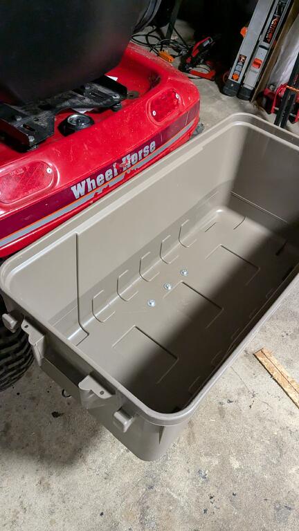

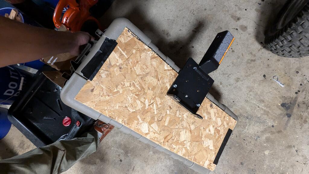

Alrashid2 476 #17 Posted November 17, 2024 Wanted to share, working on a nice cargo box that can hold firearms and chainsaws and the like! Unfortunately my bucket of spare nuts and bolts didn't have the right length I needed, so this project is on hold until morning. TBD! 2 Share this post Link to post Share on other sites

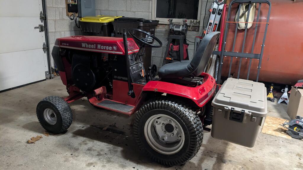

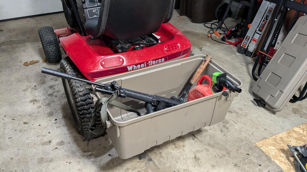

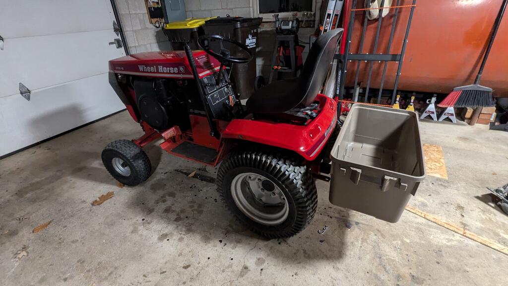

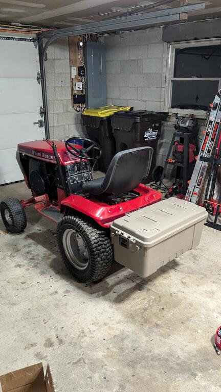

Alrashid2 476 #18 Posted November 17, 2024 (edited) Found some bolts in an old drawer. Cargo bin is done! Edited November 17, 2024 by Alrashid2 1 2 Share this post Link to post Share on other sites
