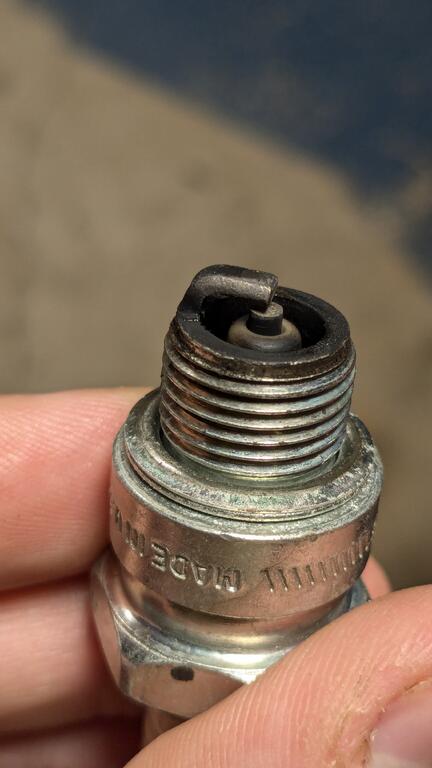

Alrashid2 476 #1 Posted November 12, 2024 (edited) Hey yall. Thanks for the advice here. I know this is an old engine, so if this is just par for the course please tell me. I have a tendency to get obsessive over these things! Bought this new-to-me 312-8 about 3 weeks ago. Did some various maintenance on it, including changing spark plugs, and have not used it all that much yet. Maybe 2-3 hours, if that. Unrelated (or maybe it is related?) but I'm dealing with my oil smelling like gas. Hoping it's just the fuel pump but we will see. For whatever reason I decided to pull the spark plug just now and saw it is already blackened. Any idea what causes this? I've looked at charts online but having trouble pinpointing it, and thought you guys might have an idea. I was leaning toward it running rich - I will say when it's running the exhaust definitely has a gassy smell to it, kind of like when you cold start a car on a winter day. If it is too rich, how hard is it to adjust these K series carbs? The engine seems to start and run perfectly, so I hate to make things worst by adjusting jets, but want to do what's right. Thanks guys for the advice. Edited November 12, 2024 by Alrashid2 Photo and typo 1 Share this post Link to post Share on other sites
oliver2-44 11,632 #2 Posted November 12, 2024 Do I recall this tractor/engine had been sitting awhile? The 2-3 hours you're put on it probable haven't been working it hard, lots of starts, idles, short runs, etc working on and adjusting things. Then with the gas in the oil that's not a normal situation to compare things. On you plug ceramic insulator I see some tan (good) on one side and black on the other. Could be running a little rich, but with the recent gas/oil problem I wouldn't want to adjust it yet. But these carbs are not hard to adjust, read the carb section in the Kohler manual for starters. For my 2 cents, that engine needs several hours of good working run time to really be able to say what a plug reading is telling you. PS, I have a 1965 Case 180 with Kohler k301. The cylinder is wore .009ths over new (that's a lot). I only run it taking it to shows, so no hard running. It smoke a touch on startup, but really don't see blue oil smoke while running. it fouls a plug to a no start point in about an hour, but no knock and no balance gears. Thankfully, I finally found a machine shop that will grind these small engine crankshafts. So its on the rebuilt list. 1 1 Share this post Link to post Share on other sites
Alrashid2 476 #3 Posted November 12, 2024 Hey @oliver2-44, thanks for the help yet again! Yes, I think this tractor was sitting for a bit before I got it, though it looked to be well maintained. You are right about my time with it so far - a lot of short runs, idling, and adjusting. I think the longest I've ran this at full throttle in 1 go was 20 minutes if that. I'm only on 1.5 acres so only so much I can do with it unless I'm pulling wood back and forth, which I havent gotten to do yet! Is the spark plug shot? Or will the black burn off as the engine gets more normal use? Should I clean it? Thanks for sharing your example of your tractor. I suppose mine must not be as bad as yours, as I can run longer than an hour and have no blue smoke. I'll keep running this thing! And I'll wait to adjust the carb until after I replace the fuel pump and get fresh oil in this thing. Thank you 1 Share this post Link to post Share on other sites
oliver2-44 11,632 #4 Posted November 12, 2024 (edited) I would keep running that plug. The little bit of black will burn off in a good/normal hot run or 2. Edited November 12, 2024 by oliver2-44 2 Share this post Link to post Share on other sites

8ntruck 9,057 #6 Posted November 12, 2024 I'd want to get the gas in the oil sorted before further running. Plug condition is secondary to that. I'll agree with @oliver2-44. Run the plug. 2 1 Share this post Link to post Share on other sites
953 nut 67,452 #7 Posted November 12, 2024 Your spark plug looks about normal for not having worked hard. With small air cooled engines running a bit on the rich side of the fuel mixture is preferable to being on the lean side. If the fuel to air mix is too lean it contributes to overheating. 3 1 Share this post Link to post Share on other sites
rmaynard 17,431 #8 Posted November 12, 2024 So I am going to go out on a limb here. Your plug looks almost normal to me. However, a sooty plug indicates a very rich carburetor mixture. That can happen if the carburetor floods a lot. Flooding is generally caused by the float valve being dirty and sticking open, or the float has a hole in it causing it to not float up to shut the valve. This, over a period of time can also be the cause of gas in the oil. However, you would notice a definite change in the running of the engine, and more black smoke. 1 Share this post Link to post Share on other sites
Alrashid2 476 #9 Posted November 12, 2024 41 minutes ago, 953 nut said: Your spark plug looks about normal for not having worked hard. With small air cooled engines running a bit on the rich side of the fuel mixture is preferable to being on the lean side. If the fuel to air mix is too lean it contributes to overheating. Ok, that's great to know. All of my other engines are new or more modern, and wasn't sure what to expect from a nearly 40 year old engine with no hour meter to tell me how much she's been ran... Great to know about better to be rich. I took photos and put witness marks on my carb adjustment screws. I'll follow the Kohler service manual instructions on adjusting carb and remember to keep it slightly rich. She runs perfectly to my ear, so maybe she won't even need any adjustment! 25 minutes ago, rmaynard said: So I am going to go out on a limb here. Your plug looks almost normal to me. However, a sooty plug indicates a very rich carburetor mixture. That can happen if the carburetor floods a lot. Flooding is generally caused by the float valve being dirty and sticking open, or the float has a hole in it causing it to not float up to shut the valve. This, over a period of time can also be the cause of gas in the oil. However, you would notice a definite change in the running of the engine, and more black smoke. Thanks for weighing in. I did check my carb and it seems to be working fine. That float valve was sticking just a bit, but I ran some brake cleaner through it and cleaned the area with a q tip, and it's much better now. If anything it's sticking shut, not open. Also took the float out and put it in a container of gas. Checked it 30 min later and it was still floating, and didn't sound like any liquid inside it. Likewise, no smoke or engine issues, so thinking that isn't what's happening. Still bothers me that the fuel pump diaphragm looked A-OK to me... but replacing anyway. Hopefully that does it but we'll see! Share this post Link to post Share on other sites
