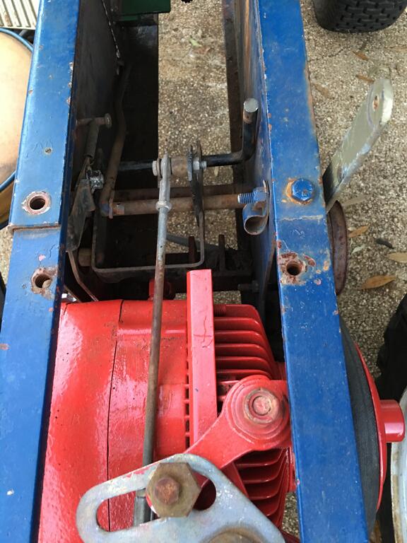

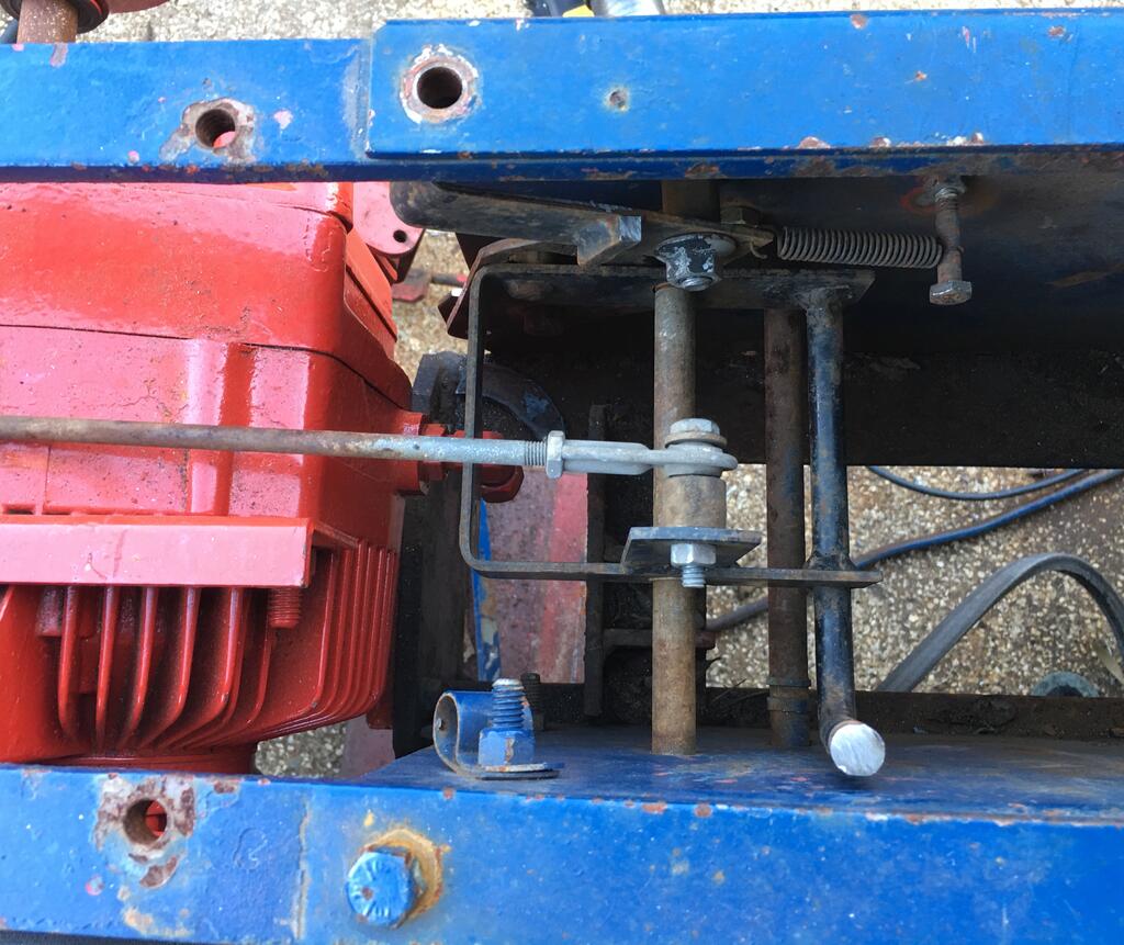

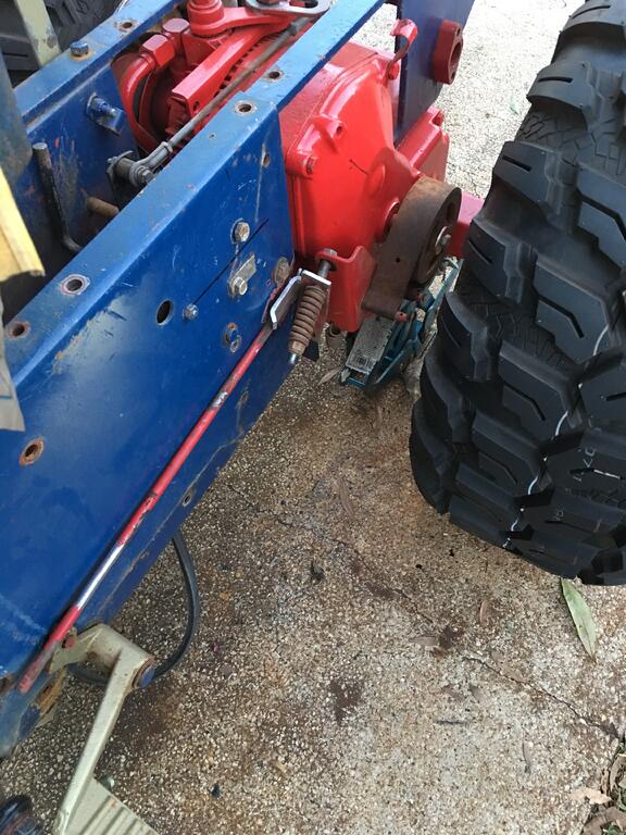

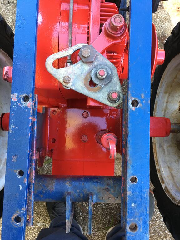

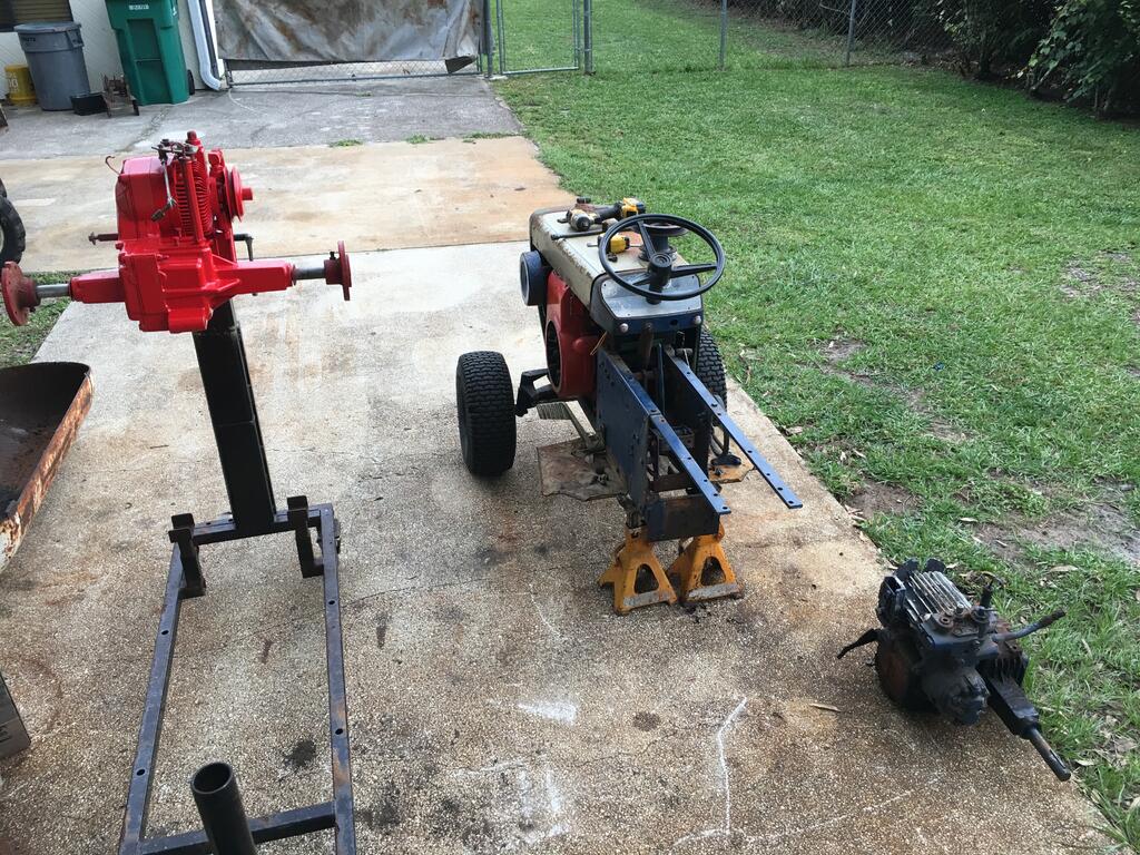

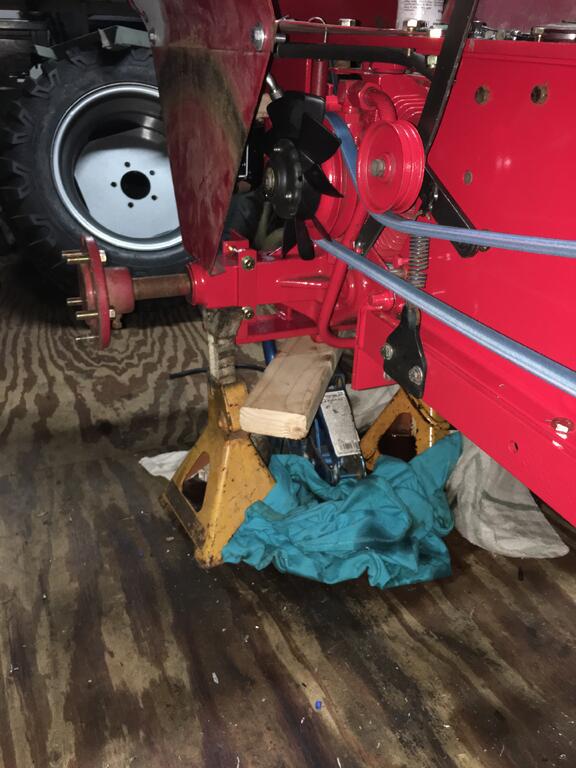

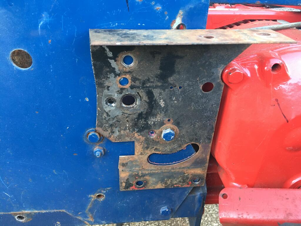

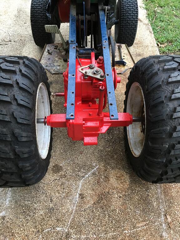

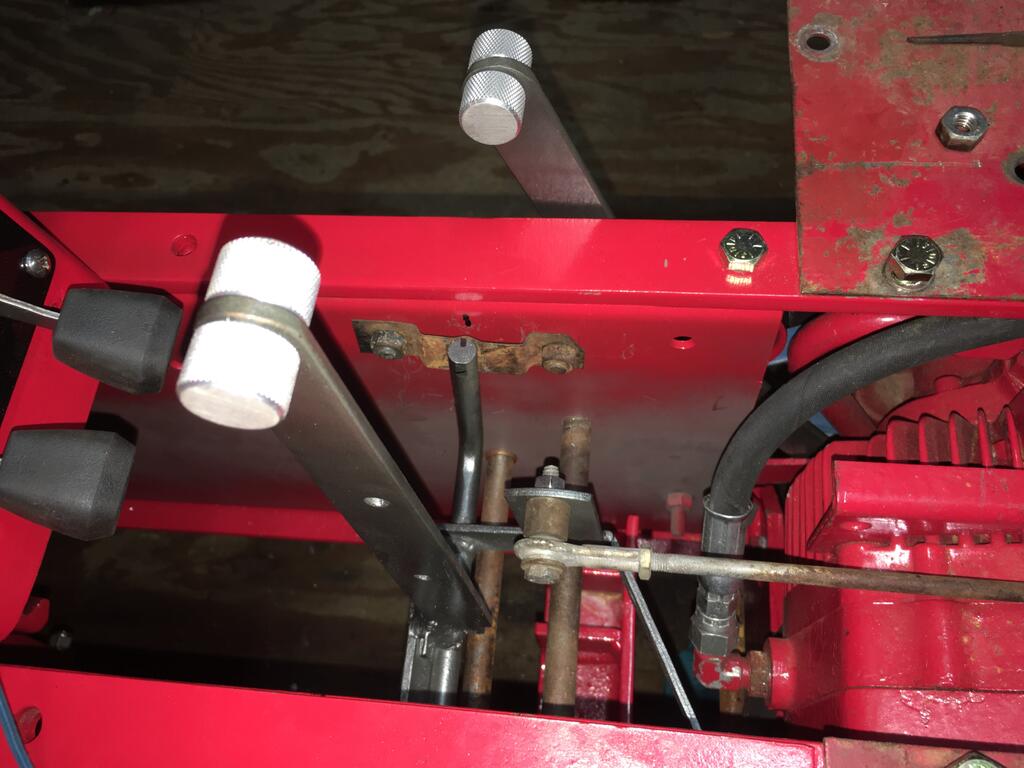

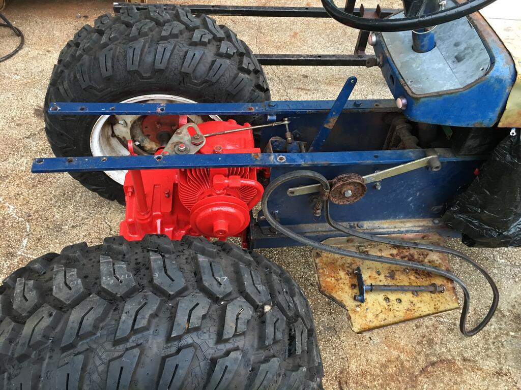

19richie66 17,951 #1 Posted November 7, 2024 I know a couple of people that have swapped them into their machines so I wanted to try and get as much info in here as possible to help others and get ideas on linkage and set-ups. So if you have done one, please feel free to post up pictures with how you did yours. If you have ideas, feel free to post them. I’m sure there are more ways than one to set it up. I’ll include a link to my transaxle build that I did for mine and my wife’s 1054. Thanks 👍 Transaxle thread 6 Share this post Link to post Share on other sites

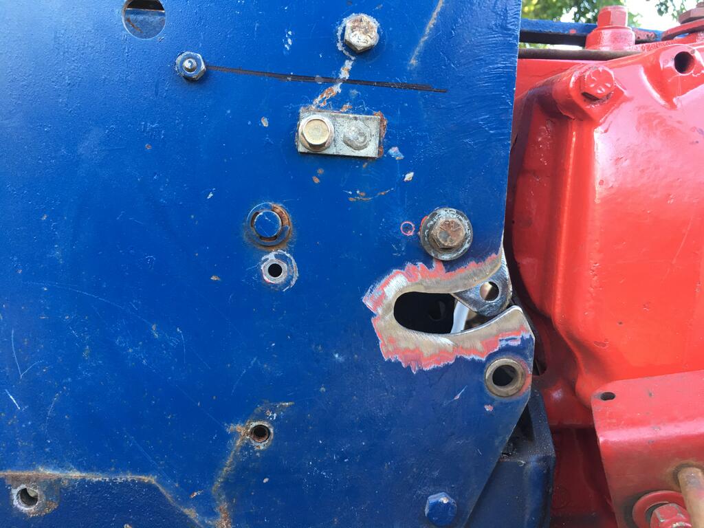

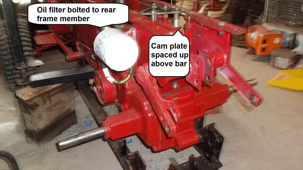

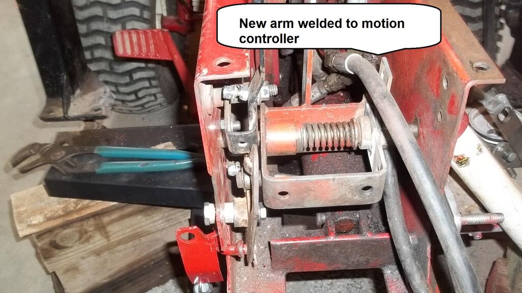

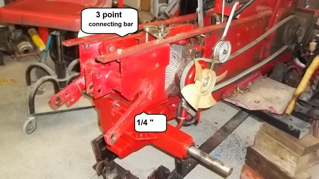

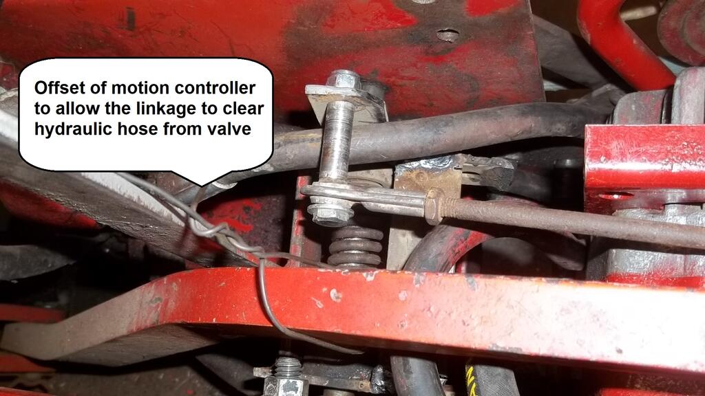

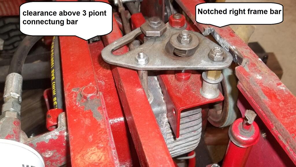

953 nut 70,661 #2 Posted November 8, 2024 @19richie66 Richie, your post gave me the confidence to do likewise on my GT-14. The only minor difference is that the three point lift necessitated some modification of the linkage from the motion controller, which I will document in the attached photos. A new arm was welded to the motion controller and an off-set from it needed to be added to clear a hydraulic hose. It was a bit time consuming but the outcome was well worth the effort. A 1/4" spacer was needed to raise the Rear Frame Member enough allow the 3 point connecting bar to clear the Eaton transmission. The cam plate needed to be spaced high enough to clear the 3 point connecting bar without interfering with the seat support. The hardware used was just stuff I had around the shop, nothing fancy, just functional. The right frame bar had to be notched too. Tight quarters in the motion controller area requires a bit of an offset for the linkage. 2 5 Share this post Link to post Share on other sites

19richie66 17,951 #4 Posted November 8, 2024 (edited) 8 minutes ago, ebinmaine said: Interesting stuff people. Good information for the future. Thanks for posting this. You bet! When I did mine, it was all learn as you go. Yes there are mods that have to be made but nothing to serious. I used the 418-A motion linkages and as many parts of it as I could. With as many Eatons that there are out there, it’s a viable swap. Just have to get around the little hurdles. Going with an independent 3 point would let you get rid of the large connector bar that runs down the middle of the tunnel. A little creativity and you can build the link and lever for that. I also like the fact I have a working brake. Edited November 8, 2024 by 19richie66 1 1 1 Share this post Link to post Share on other sites

19richie66 17,951 #6 Posted November 8, 2024 I still haven’t gotten around to making the brake lock but it is just a matter of getting the pawl and linkage set. I built this back in 2018 in a friendly little “build off” with Aldon so it got to where it is and the little things got put off as I ran out of time. So it still needs some small things done but the functionality of it it there. Well satisfied for sure. 2 Share this post Link to post Share on other sites

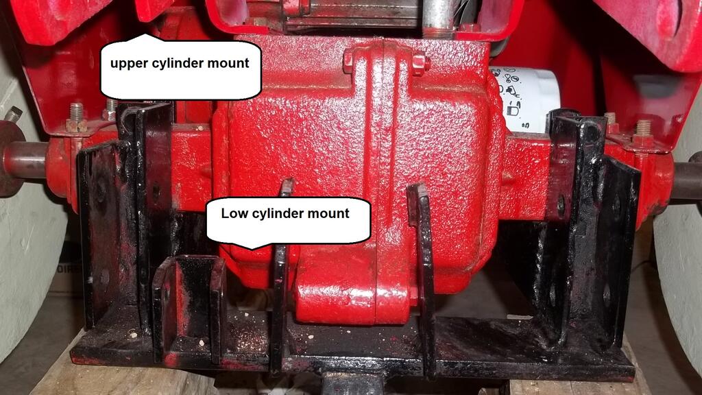

953 nut 70,661 #9 Posted November 9, 2024 2 minutes ago, kpinnc said: You could use a second cylinder and spool valve to actuate it I gave that some consideration and my 3 point has the brackets for the cylinder. By the time I added a cylinder, spool valve miscellaneous fittings and hoses I would have been into it for a few hundred dollars. Being as thrifty cheap as I am it was an easy decision to find a way to gain enough clearance to use what I already have. This photo is when the Sundstrand was in place but the loader sb frame and rear frame member with three point are the same. 1 Share this post Link to post Share on other sites
kpinnc 19,107 #10 Posted November 9, 2024 7 minutes ago, 953 nut said: I gave that some consideration and my 3 point has the brackets for the cylinder. How exactly did you route the lift mechanism to the rear? The Eaton leaves very little room to do it from what I’ve seen. I considered running a link beside the transmission a while back and decided against it. Share this post Link to post Share on other sites
953 nut 70,661 #11 Posted November 9, 2024 The GT-14 is a bit taller than its little brothers. The lift bar went above the Sundstrand but wouldn't quite clear the Eaton so I had to add a spacer under the rear frame crossmember. Share this post Link to post Share on other sites
kpinnc 19,107 #12 Posted November 9, 2024 2 hours ago, 953 nut said: The GT-14 is a bit taller than its little brothers. The lift bar went above the Sundstrand but wouldn't quite clear the Eaton so I had to add a spacer under the rear frame crossmember. Very nice. I failed to notice that in the previous pics. I had thought of doing the same thing on a manual lift. My thought process is if I can lift a tiller or large mower deck with a manual, then most “size appropriate” implements should be the same. 1 Share this post Link to post Share on other sites
19richie66 17,951 #13 Posted November 9, 2024 (edited) I welded a plate between the two side bottom tabs on the seat stand and I guess you could weld another 1/4” plate below that if you needed the room. Edited November 9, 2024 by 19richie66 1 Share this post Link to post Share on other sites
