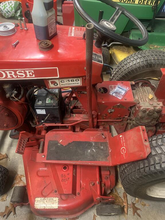

Bluehill_2 3 #1 Posted November 5, 2024 I’ve got a 77’ C160 Auto. The lift arm from the deck seems to be missing some parts. Can someone please show me a picture of their lift mechanism? Ive looked at an IPL but I’m not getting it. My issue is that I can lift the deck, but there is nothing to lift the serrate stop on the lift handle. 2 Share this post Link to post Share on other sites
Ed Kennell 46,557 #2 Posted November 5, 2024 (edited) to the Your 160 is missing some lift parts. Looks like this was originally a hydro lift that someone crudely fabricated a make shift manual lift mechanism. Go to our manuals section and download the operating manual for your tractor. Click on the file download and scroll down the file to find the correct manual lift parts. The other option is to restore it back to the hydro lift. Either way, you need some major parts. If you are happy with the lift as is, you could add a rod sticking out to the foot rest where you could raise the locking bar with your toe. BTW, there should only be two positions on the deck lift. Completely up for transport and completely down for mowing. For mowing the deck should be supported by the drear deck wheels and not hanging from the lift. Edited November 5, 2024 by Ed Kennell 1 Share this post Link to post Share on other sites
Lee1977 7,709 #3 Posted November 5, 2024 (edited) That's some Jerry Rigged system some one has put on there. You best look for some who has scraped a C-series tractor and get all the parts. From your picture looks like all 18 parts are missing or destroyed building that. Maybe Qwest will be along the show the parts diagram. My computer won't let me up load. Edited November 5, 2024 by Lee1977 1 Share this post Link to post Share on other sites
Bluehill_2 3 #4 Posted November 6, 2024 I kind of suspected that it was probably a hydro lift but everything had been removed. Is there a way to tell if it was actually a hydro model or are all of these capable of adding a hydraulic lift without modifying the hydro? I like the idea of adding a peg to lift the serrated bar to make the current setup work. 1 Share this post Link to post Share on other sites

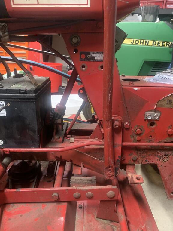

Ed Kennell 46,557 #7 Posted November 6, 2024 1 hour ago, Bluehill_2 said: Is there a way to tell if it was actually a hydro I'm guessing those two holes below the ID plate is where the control valve was mounted. 1 Share this post Link to post Share on other sites
Lee1977 7,709 #8 Posted November 7, 2024 On 11/5/2024 at 10:39 PM, Ed Kennell said: I'm guessing those two holes below the ID plate is where the control valve was mounted. That don't tell you anything as both the hydrolic control and the dial-a-hite mount up in the same holes on a C-series. Share this post Link to post Share on other sites
Bar Nuthin 2,594 #9 Posted December 16, 2024 (edited) On 11/5/2024 at 10:39 PM, Ed Kennell said: I'm guessing those two holes below the ID plate is where the control valve was mounted. On 11/7/2024 at 2:35 PM, Lee1977 said: That don't tell you anything as both the hydrolic control and the dial-a-hite mount up in the same holes on a C-series. @Bluehill_2 If you look - it has the rockshaft for a hydro-lift and the bracket to extend the step away from the frame (to accommodate) the lift hydraulics. @ebinmaine would probably trade you the parts for a proper manual lift for that rockshaft I'm surprised that homemade lever lifts anything. Edited December 16, 2024 by Bar Nuthin 2 Share this post Link to post Share on other sites
