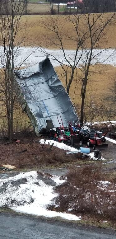

gt14rider 1,278 #7 Posted November 5, 2024 (edited) Lasted 3 days, 60 70 mph winds. Dec 25 2020 Edited November 6, 2024 by gt14rider Date 4 Share this post Link to post Share on other sites

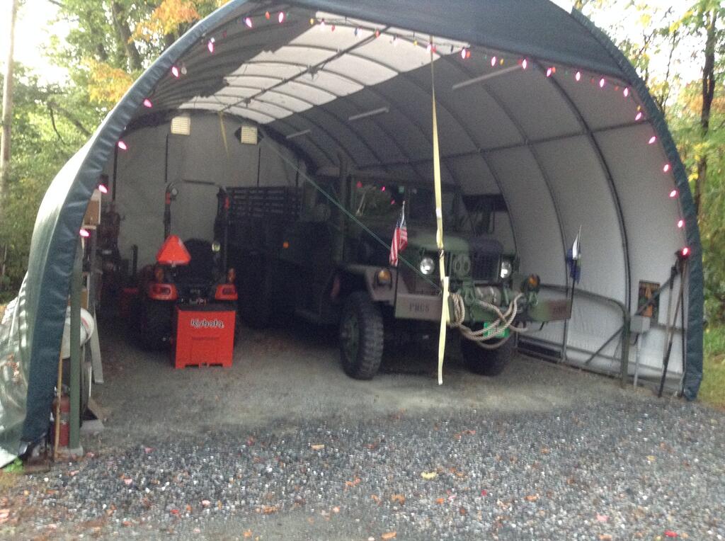

C-85 822 #8 Posted November 5, 2024 We looked at Shelter Logic and then we went with Farm Tek. They both seem heavy duty, but this one had the clear roof, so we went with that. This one is pretty heavy duty and came with a 15 year warranty. We've managed to keep the snow off from it as much as we could and it is doing good, it is 7 years old now. C-85 3 4 Share this post Link to post Share on other sites
WHX?? 58,134 #9 Posted November 5, 2024 40 minutes ago, gt14rider said: 60 70 mph winds. All bets are no matter race color or creed. 24 minutes ago, C-85 said: went with Farm Tek. The HD type EB spoke of right there. $$ but worth it if you want it to go awhile. That one is huge ... almost fit two deuce and a halfs in there. 1 Share this post Link to post Share on other sites

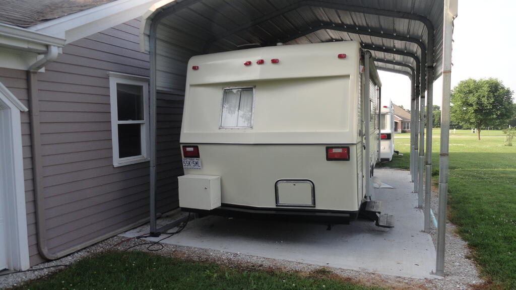

Beap52 2,497 #12 Posted December 3, 2024 Our kids had a 24x30 metal carport installed. The non English speaking installers got it up in a couple of hours. I laid treated 2x6's down so they could set the bottom runners up on the boards keeping the runners off of the ground. They drove rods (I'm guessing 24" long) through the runners and 2x6 to hold the carport in place. I can't see how the rods the fellows used could hold the carport but it's been there three or four years. Fortunately, they are surrounded by trees and don't catch much wind. I had a 12x28 carport given to me as a basket case. I installed it over a cement slab and then made brackets attaching it to my shop. I priced carports on local marketplace sales and they didn't seem to expensive and Menards sells carports but free was hard to beat. I had to purchase extension legs for my carport to get the height needed for camper. 3 Share this post Link to post Share on other sites
