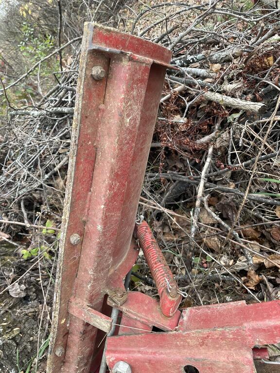

davem1111 2,314 #30 Posted November 3, 2024 On 11/2/2024 at 8:45 AM, Alrashid2 said: Ah interesting. I'll have to look on Dave's and see if his has them. Maybe I could custom drill some? Thanks for letting me know Doesn't look like it has any holes. If you have good metal drill bits it might not be too difficult to drill some new ones and mount some skids on it. Might need to do some cutting and/or welding unless you can find something that will just bolt on there. Maybe just some flat 3/16-1/4" steel with an appropriate bend in it would work.... Share this post Link to post Share on other sites
Alrashid2 476 #31 Posted November 3, 2024 1 hour ago, davem1111 said: Doesn't look like it has any holes. If you have good metal drill bits it might not be too difficult to drill some new ones and mount some skids on it. Might need to do some cutting and/or welding unless you can find something that will just bolt on there. Maybe just some flat 3/16-1/4" steel with an appropriate bend in it would work.... Thanks for the pic my friend! No worries at all. I'll try her out first and see how she does! Share this post Link to post Share on other sites

rjg854 13,269 #33 Posted November 4, 2024 21 hours ago, davem1111 said: By the looks of that wear bar, if it hasn't been flipped already, you might think about doing that before you start wearing off the plow itself. 1 Share this post Link to post Share on other sites
davem1111 2,314 #34 Posted November 4, 2024 1 hour ago, rjg854 said: By the looks of that wear bar, if it hasn't been flipped already, you might think about doing that before you start wearing off the plow itself. Hmmm... good idea. I only got this plow about a year ago and have only used it a few times, so I didn't think to check that. Should look at my other one too. 1 Share this post Link to post Share on other sites

Handy Don 17,197 #36 Posted November 4, 2024 59 minutes ago, Alrashid2 said: Since we're on the topic, where do you guys source wear bars? Is that a generic part or does it have to be Wheel Horse specific? Dave is selling me this plow so planning ahead! They are pretty generic. Amazon and eBay for sure. I’d bet that TSC and others carry them as well. One variant that some folks are pleased about is using a high density plastic bar using the worn steel bar as a clamp. Some folks have used heavy rubber, as well. Both to try to avoid excessively scraping up the pavement. Share this post Link to post Share on other sites

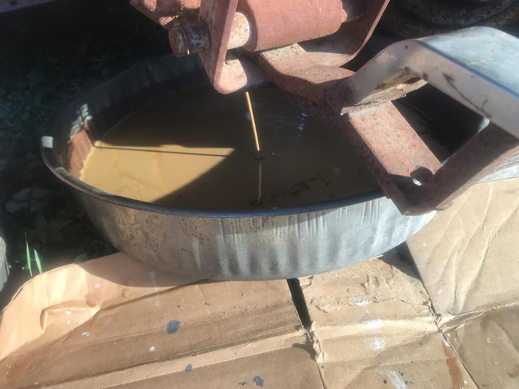

oliver2-44 11,662 #37 Posted November 5, 2024 On 11/3/2024 at 12:52 PM, Alrashid2 said: 2. Drained my transaxle from the bottom bolt and let it drain for over 30 min while I was inside and working on something else. Filled with 2 quarts and found it way overfilled. I've drained back out about 3/4 quart of gear oil and she's still slightly overfilled! I decided to do this after seeing all frothy the oil was after use. Anyone seen this? The transmission has a hump on the bottom that traps fluid on the front side. You have to lift the front of the tractor up to get that area to drain. But I don't think that would hold 3/4 quart. How did the old oil look? If it was creamy brown or white it had some water in it. Like this. If it had water run the new oil a while and change it again. If it had a bunch of "free (separated) water" you need to fluid it with diesel or kerosene, run it around on the road or on jack stands, then flush it again. a couple of times. 1 Share this post Link to post Share on other sites
Alrashid2 476 #38 Posted November 5, 2024 Thank you @oliver2-44. I did something somewhat similar. I'll admit, didn't tip the front wheels up when draining though. I drained the old murky fluid - yes it had water in it - and then refilled with 1 quart of 80w90 gear oil, and 1 quart of kerosene. Drove it around the yard for 15 minutes, then drained that mixture and refilled with 2 quarts of 80w90. Was a bit overfilled, so drained some of that out - now that I've taken that and measured it in an old quart oil container, it looks like it was just 1/2 quart overfilled, not 3/4 quart. So far running smoothly! Am I safe to assume that, now that I've flushed, drained, refilled, and replaced the old ripped shifter boot, the fluid shouldn't need changed anytime soon? Old manual doesn't talk about draining ,just keeping it topped off, which it is now. 1 Share this post Link to post Share on other sites
Handy Don 17,197 #39 Posted November 5, 2024 1 hour ago, Alrashid2 said: Am I safe to assume that, now that I've flushed, drained, refilled, and replaced the old ripped shifter boot, the fluid shouldn't need changed anytime soon? Old manual doesn't talk about draining ,just keeping it topped off, which it is now. Generally, yes. Especially if it’ll be stored in moderate humidity conditions. The top curve of the dipstick is a hollow tube so the transaxle is always able to breathe! A look at the dipstick every year will tell you what you need to know: low level? creamy? water droplets? blackened? speckles of metal? Yes to any and attention needed. 1 Share this post Link to post Share on other sites
