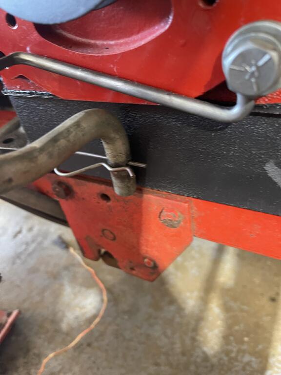

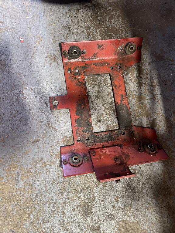

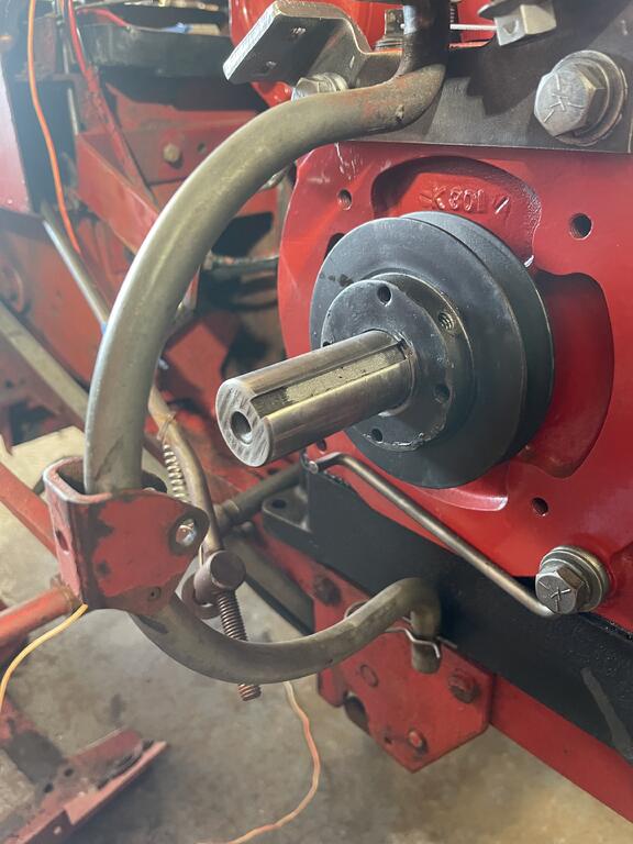

Wheelhorse#1 1,953 #1 Posted October 23, 2024 (edited) Swapping out a 10hp for a 12. Had to remove the shaker plate, that had the mount for the PTO at the bottom. Does anyone know how to modify this or I’m think maybe an earlier model had an eyelet that bolted to the frame ? Edited October 23, 2024 by Wheelhorse#1 1 Share this post Link to post Share on other sites

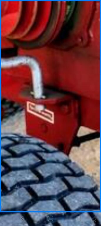

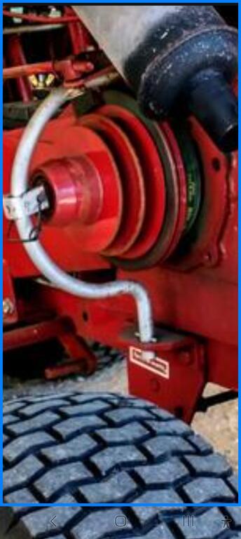

ebinmaine 79,536 #2 Posted October 23, 2024 Here's a couple shots of my 1975 C160 Automatic 1 1 Share this post Link to post Share on other sites
kpinnc 18,724 #3 Posted October 23, 2024 (edited) I think most any year and model that didn’t use a shaker plate OR had an engine plate like the 520 should have the bolt-on bracket- of course provided it used the hoop-style PTO. Every 1973 and up had them as well as every 300-400 series that I’ve owned. Should be very easy to find and inexpensive. Edited October 23, 2024 by kpinnc 2 1 Share this post Link to post Share on other sites

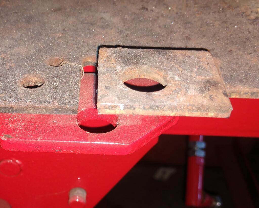

Handy Don 16,917 #5 Posted October 23, 2024 2 hours ago, Wheelhorse#1 said: I’m think maybe an earlier model had an eyelet that bolted to the frame ? Yep--nice picture @ebinmaine! Onan-powered models have a base plate that extends out past the frame with a hole that accepts the PTO bail. 1 Share this post Link to post Share on other sites
ebinmaine 79,536 #6 Posted October 23, 2024 6 minutes ago, Handy Don said: Yep--nice picture @ebinmaine! Onan-powered models have a base plate that extends out past the frame with a hole that accepts the PTO bail. Briggs too. I looked at the one here from @Maz91.. 1 Share this post Link to post Share on other sites
kpinnc 18,724 #7 Posted October 23, 2024 1 hour ago, Handy Don said: Onan-powered models have a base plate that extends out past the frame with a hole that accepts the PTO bail. And just FYI don’t use an Onan plate as a template to make your own bracket. Where the hoop goes is different for those engines. The pic below is an Onan plate bolted to a C120 frame. 2 Share this post Link to post Share on other sites
Wheelhorse#1 1,953 #8 Posted October 24, 2024 (edited) 3 hours ago, ebinmaine said: I've got a couple tractors that are disassembled so I can get the measurements if it'll help. Thanks all I was going to attempt to make one but I have enough to do as is . Found one on the Fleabay for 12.00 including ship…pretty reasonable I’d say. Thanks for all the helpful comments. Edited October 24, 2024 by Wheelhorse#1 2 Share this post Link to post Share on other sites
Wheelhorse#1 1,953 #9 Posted October 24, 2024 5 hours ago, kpinnc said: I think most any year and model that didn’t use a shaker plate OR had an engine plate like the 520 should have the bolt-on bracket- of course provided it used the hoop-style PTO. Every 1973 and up had them as well as every 300-400 series that I’ve owned. Should be very easy to find and inexpensive. Yes I’ve been looking and most all seem to be the same with the hoop style. thx Share this post Link to post Share on other sites
