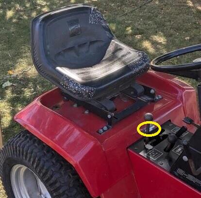

gwest_ca-(File Mod) 12,323 #30 Posted October 22, 2024 Looks like the ID decal is below your seat. Should be model number, serial number and 4-digit Julian build date on it. 5 Share this post Link to post Share on other sites
