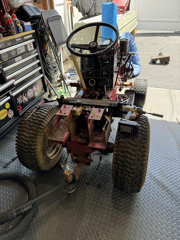

Gabe 32 #1 Posted October 18, 2024 I’m currently restoring my wheelhorse 314A I’m looking to find rear tires 22-7.50-12 can’t seem to find new ones, can anyone guide me to other compatible sizes? 4 1 Share this post Link to post Share on other sites

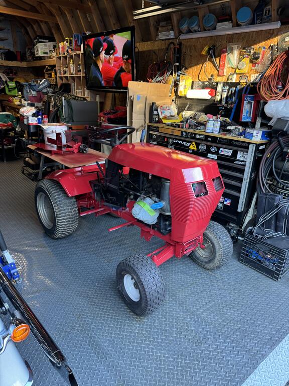

Gabe 32 #13 Posted October 20, 2024 Need to weld the mount points of the seat pan bar, slowing me down lol. Share this post Link to post Share on other sites

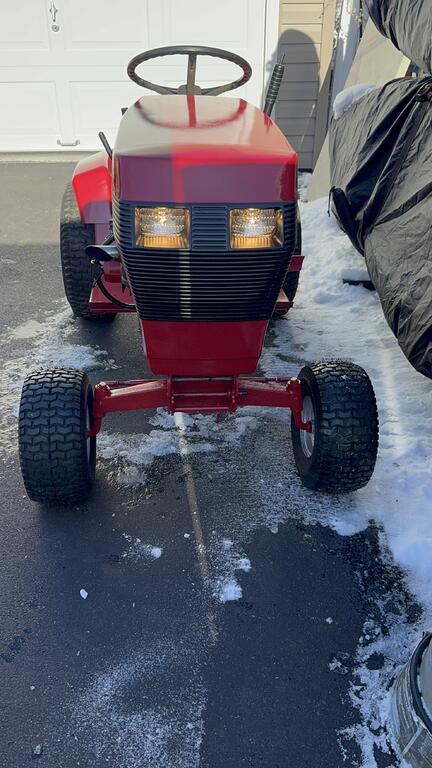

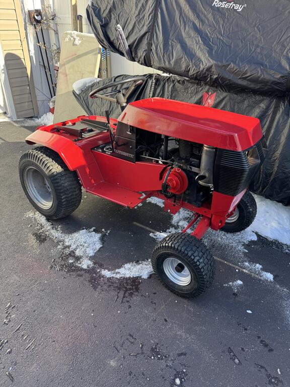

Gabe 32 #14 Posted December 22, 2024 Well she is up and running, just have to order the decals, clean up the rear wheels and tires, attach my plow (need to get weights and chains though and a seat). I got an estimate of $200 to redo the factory seat. 4 Share this post Link to post Share on other sites
Bar Nuthin 3,246 #15 Posted December 22, 2024 2 hours ago, Gabe said: I got an estimate of $200 to redo the factory seat. With the price of decent aftermarket seats , $200 isn't unreasonable at all. 1 Share this post Link to post Share on other sites
Gabe 32 #16 Posted December 23, 2024 I agree, but not a comfortable lol. 1 Share this post Link to post Share on other sites

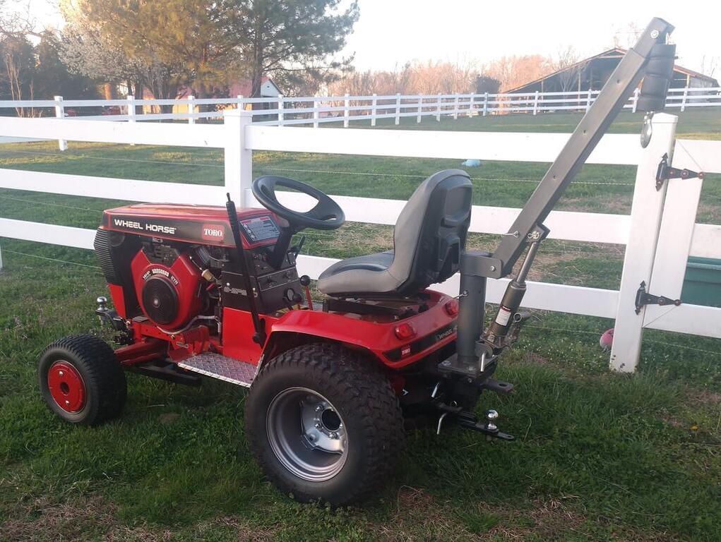

kpinnc 18,969 #17 Posted December 24, 2024 Your tractor looks to be off to a good start for sure. On your rear wheels: 23x8.50-12 will fit just fine. That size ag cleats look very good on a 300-series machine. You can also go as wide as 10.50 with turf tires. Ag tires on your 7.5 rims can be tricky due to the bars forcing all the flex to the sidewalls. The tires in the pic below are 10.50 turfs on 7.5 wide rims. 2 Share this post Link to post Share on other sites

Gabe 32 #20 Posted December 26, 2024 Thanks for all the advice gents, @kpinnc what seat manufacturer is that, it looks comfortable. Share this post Link to post Share on other sites
