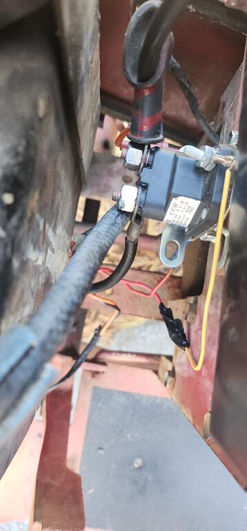

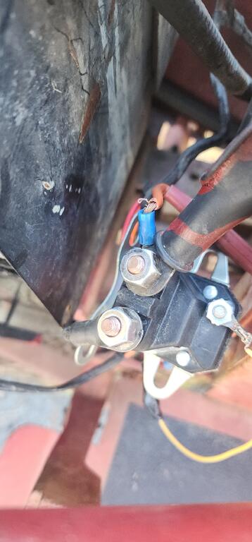

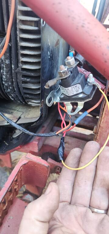

Thisguy68 2 #1 Posted October 17, 2024 (edited) Hey all. 👋🏻 I have a C175 Wheel Horse tractor. I use it to plow and as a back up mower. I had some trouble with the starter solenoid and it would just click. I could feel the click when touching the unit. I installed a new one, but now it won't even click. I checked the PTO several times to make sure it wasn't engaged. I checked to make sure it's getting 12V from the battery and that checked out. Also verified there is power at the starter. Could it be a faulty new solenoid? Or wiring issue? I included some pics. I would think a faulty starter would at least show some sign of life and not go the same time as the solenoid. Happy for any help/suggestions. Thank you. Also I forgot to mention I replaced the points and condenser at the same time. I attached the wire from the coil and condenser to the points, maybe that's wrong? I will update with a picture when I get home. Edited October 18, 2024 by Thisguy68 Share this post Link to post Share on other sites
953 nut 70,659 #2 Posted October 17, 2024 The solenoid body needs to be grounded. Share this post Link to post Share on other sites

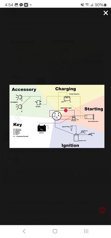

Thisguy68 2 #4 Posted October 18, 2024 (edited) I grounded the solenoid to the body and was hoping that's all it was. The solenoid DID start clicking again, but the starter is still not engaging or spinning. Then, I tried to jumpstart it because the battery had been sitting and only measured at 12.2V. Unfortunately, that just made the starter smoke. I found a diagram here, but the wiring looks correct to me. Thanks for the help and responses 21 hours ago, 953 nut said: The solenoid body needs to be grounded. 8 hours ago, TonyToro Jr. said: Edited October 18, 2024 by Thisguy68 Add pictures. 1 Share this post Link to post Share on other sites

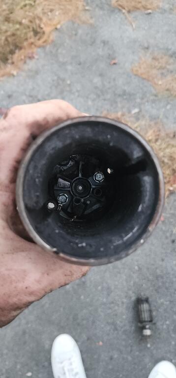

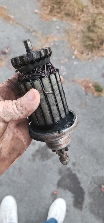

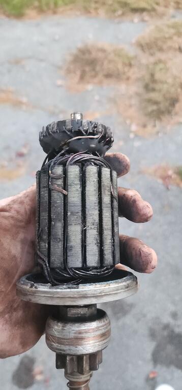

Thisguy68 2 #9 Posted October 18, 2024 Update: I pulled the starter and figured I'd open it up since I'll likely replace it anyway. Smells burnt and looks awful. I'm an amateur as far as electronics but I don't think the copper from the windings is supposed to embed in the arbitrage. Share this post Link to post Share on other sites
TonyToro Jr. 2,560 #10 Posted October 19, 2024 1 hour ago, Thisguy68 said: Update: I pulled the starter and figured I'd open it up since I'll likely replace it anyway. Smells burnt and looks awful. I'm an amateur as far as electronics but I don't think the copper from the windings is supposed to embed in the arbitrage. Since it does look like that I would get a new one. I don’t think it’s supposed to look like that. Share this post Link to post Share on other sites
