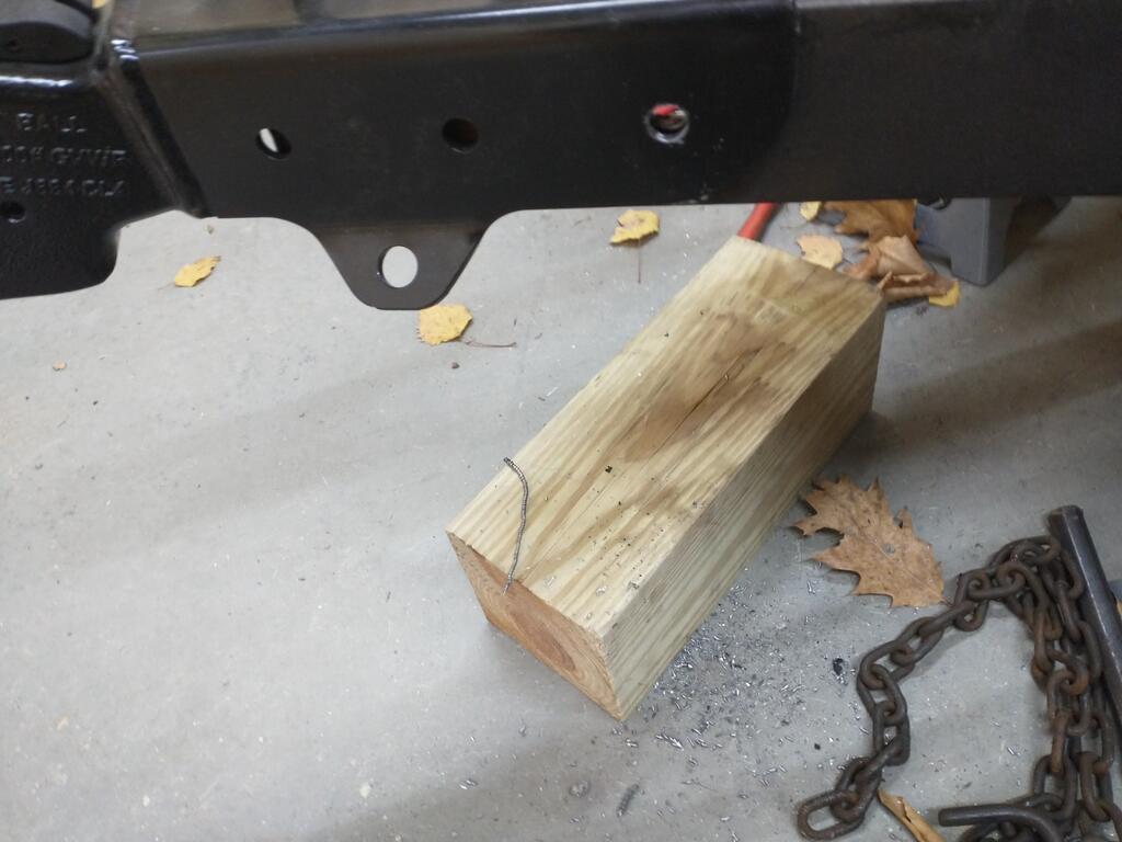

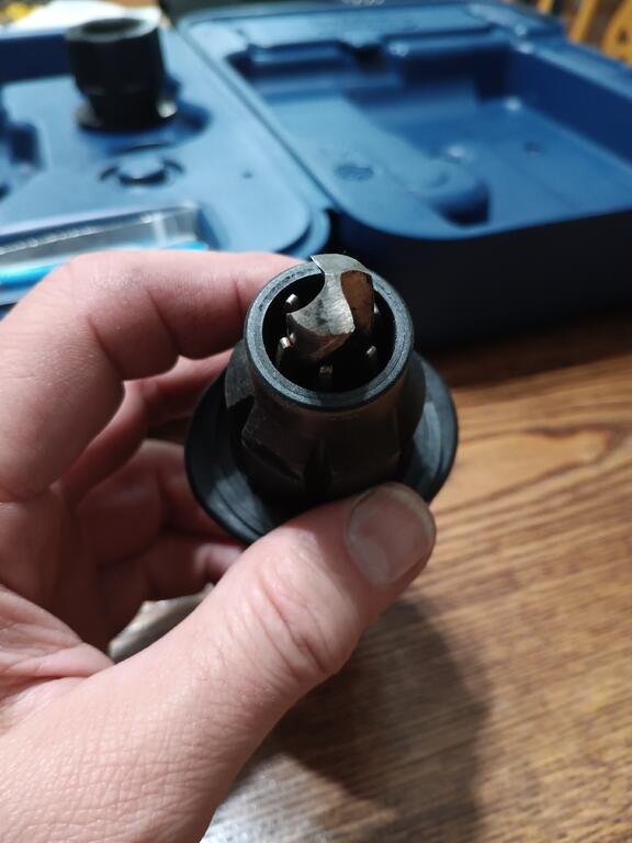

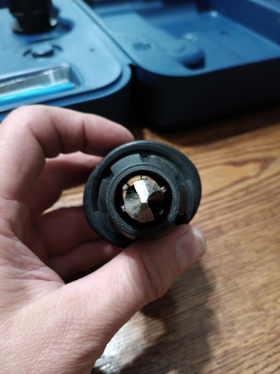

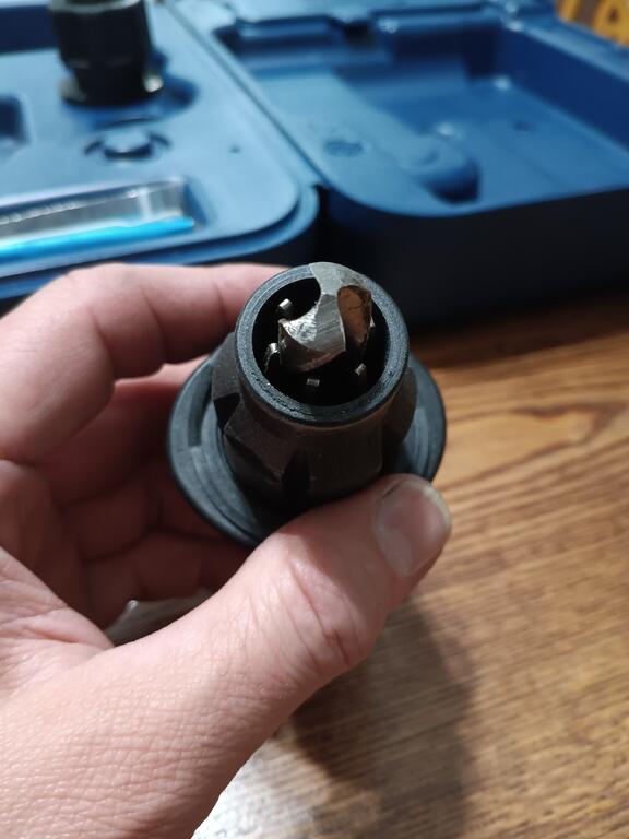

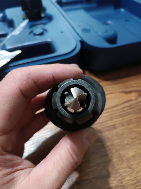

ebinmaine 81,282 #27 Posted October 31, 2024 I took a few minutes to try the new to me Drill Doctor 400 this evening. I grabbed two 1/2" drill bits to sharpen. Here's some BEFORE pics. And here's an AFTER Pic. It's certainly not a 40 million dollar mo-chine but it's FAR AND AWAY better than what my inaccurate unsteady poorly coordinated hands can do. 4 Share this post Link to post Share on other sites

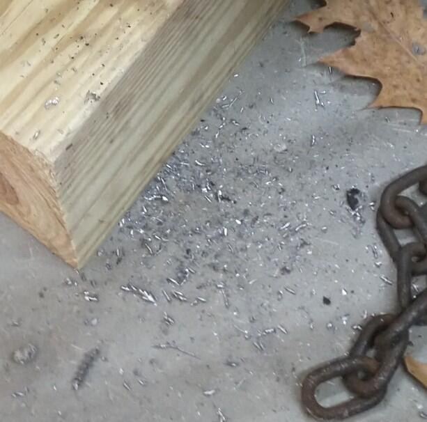

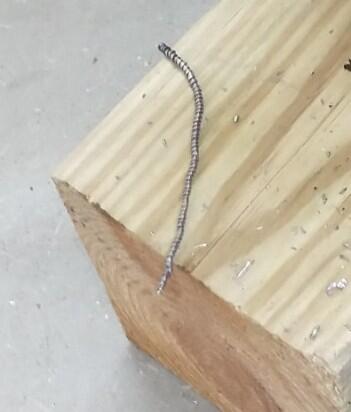

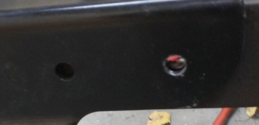

ebinmaine 81,282 #30 Posted November 2, 2024 My first time using Drill Doctor sharpened drills. Overall... pretty impressive. As stated above or other places it's like many things in that there's a definite learning curve. I had sharpened 2 different types of 1/2" drill bits. The gold one worked well, stayed sharp for 4 holes and didn't experience much wear at all. The silver one..... sucked. Why? 'Ellifino.... Certainly different steels but the silver drill made NO effort to make a cut. I tried reshaping and resharpening. Nope. Another thing to report. I used the 1/2" bit by itself for the first 4 frame holes. That was to create holes that lined up with pre-existing coupler holes. No problems. Then I had to add a set of holes in a slightly different location. I measured and punched to make a centering point. Started with a 5/32 drill bit. Went to around 7/32 or so. Both cut great. I tried to use the SAME 1/2" drill bit from the other holes. Nada. Nope. Wouldn't go. I had to use a 3/8", followed by a 7/16", then the 1/2". Dunno why..... the largest drill bit would just slip and spin.... Share this post Link to post Share on other sites
lynnmor 9,081 #31 Posted November 2, 2024 Show us the drills, maybe we can see the problem. Perhaps the web is much thicker on one and the drills indexed differently in the grinder. 1 Share this post Link to post Share on other sites
ebinmaine 81,282 #32 Posted November 2, 2024 1 hour ago, lynnmor said: Show us the drills, maybe we can see the problem. Perhaps the web is much thicker on one and the drills indexed differently in the grinder. Appreciate that. I'll get pics tomorrow. Share this post Link to post Share on other sites

ebinmaine 81,282 #37 Posted November 10, 2024 On 11/2/2024 at 5:43 PM, lynnmor said: Show us the drills, maybe we can see the problem. Perhaps the web is much thicker on one and the drills indexed differently in the grinder. I forgot to get pics but you were correct. The drill bit that wouldn't work was a cheapo and could not be lined up in the Drill Doctor manual's description. Share this post Link to post Share on other sites

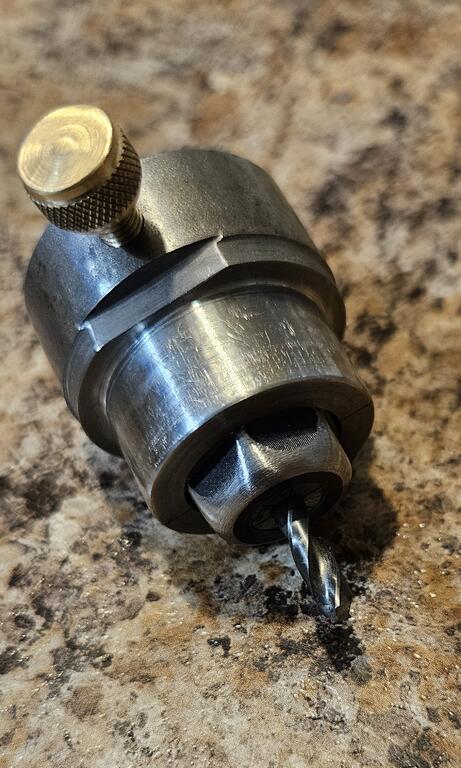

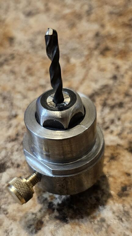

Mickwhitt 5,259 #38 Posted November 16, 2024 The machine I bought only does 3mm drills as the smallest so I had a go at making a new bit holder to go down to 1mm. Involved turning a holder to carry an ER11 collet chuck. It's a bit Heath Robinson but it works fine. 1 Share this post Link to post Share on other sites
