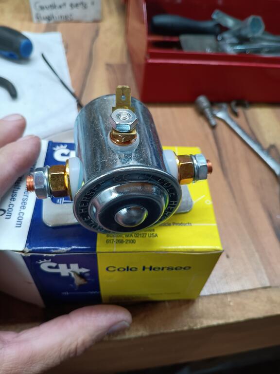

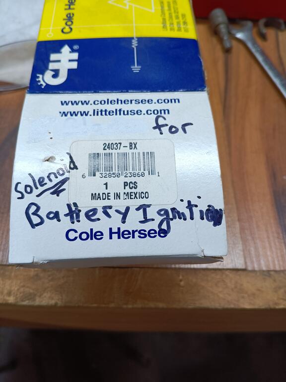

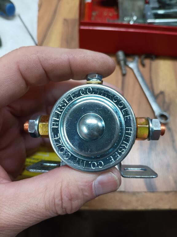

ebinmaine 80,078 #29 Posted October 20, 2024 20 hours ago, EB-80/8inPA said: These replacement parts are kinda cheezy I stopped buying the wee little solenoids years ago for the same reason. I've been using HD units made by Cole Hersee. They're not cheap 1. by money spent or 2. on quality build. Worth it. 1 Share this post Link to post Share on other sites
EB-80/8inPA 2,083 #30 Posted October 21, 2024 On 10/20/2024 at 4:02 PM, ebinmaine said: I’ve been using HD units made by Cole Hersee. Is there any particular model number you might suggest? They have quite a selection. And they do look pretty robust. TIA. 1 Share this post Link to post Share on other sites
953 nut 68,140 #31 Posted October 21, 2024 Go with the Ford solenoid as suggested by @Racinbob, all auto parts stores have them on the shelf and the price is reasonable. https://www.google.com/search?sca_esv=969a37d7d8df40c7&rlz=1C1JZAP_enUS981US981&sxsrf=ADLYWII4NE-azts1Xg9jsxgoNC58E7Q3jg:1729551989449&q=1976+ford+f150+solenoid&udm=28&fbs=AEQNm0Aa4sjWe7Rqy32pFwRj0UkWd8nbOJfsBGGB5IQQO6L3J03RPjGV0MznOJ6Likin94oGSh4l60tfPppA0C5BN3Bom6kHGpJHn7EVuNALQGJ5ECLZXcQeFVI9ZjFEYIlvC4A0X1A5hYXVZIchksHpMH7WV02tkRK7mBeeFqk9Ny5yKL-imh-pD9ICs2NKoknEXBlMy1ySIrn9rDpp5YVd48typlFRTQ&ved=1t:220175&ictx=111&biw=1366&bih=607&dpr=1 Share this post Link to post Share on other sites
ebinmaine 80,078 #32 Posted October 22, 2024 On 10/21/2024 at 4:18 PM, EB-80/8inPA said: Is there any particular model number you might suggest? They have quite a selection. And they do look pretty robust. TIA. Ignore the part about "battery ignition" 24037 bx 1 1 Share this post Link to post Share on other sites
EB-80/8inPA 2,083 #33 Posted October 23, 2024 4 hours ago, ebinmaine said: 24037 bx Muchos gracias, signor! or something apropos like that, I guess. Your helpfulness is forever helpful! And appreciated! 1 Share this post Link to post Share on other sites
