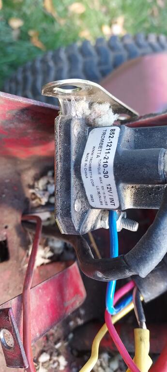

Jason Miller 24 #1 Posted October 16, 2024 My wheelhouse 856 has a bad solenoid. I can’t seem to find the one that is currently on it online. Need some help please. This is the current one. When I turn the switch i get nothing. I replaced the battery, have spark and can jump the solenoid and it starts but nothing when I turn the switch. Share this post Link to post Share on other sites
Jason Miller 24 #2 Posted October 16, 2024 Forgot to say cant find this particular one one internet. All the numbers match except the -30 last 2 numbers not sure. Thanks Share this post Link to post Share on other sites
ebinmaine 80,750 #3 Posted October 16, 2024 That tractor didn't have a solenoid as built so don't be concerned with getting correct/ matching numbers. It's a popular conversion. Most any solenoid with 2 big terminals and 1 small one will do fine. Old fords and jeeps used them. Big box stores may have a generic tractor one too. 2 Share this post Link to post Share on other sites

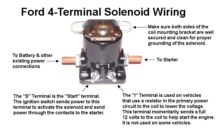

953 nut 69,380 #8 Posted October 16, 2024 Many of the solenoids you will find at auto parts or big box stores will have two big terminals and two small ones, here is how they hook up. 1 Share this post Link to post Share on other sites

Racinbob 13,193 #10 Posted October 17, 2024 You can pick up the style Ford used just about anyplace and what I usually use. But it's wired a bit different than the two small terminal solenoid Richard is referring to. The small terminals are marked I and S. The I terminal is a bypass and sends full voltage to the coil. Just ignore it and don't use it. The mounting bracket must be grounded for the coil to operate. 3 2 2 Share this post Link to post Share on other sites

WHX?? 58,163 #14 Posted October 17, 2024 7 hours ago, Racinbob said: The I terminal is a bypass and sends full voltage Here I thought that was a ground... Share this post Link to post Share on other sites
Racinbob 13,193 #15 Posted October 17, 2024 1 hour ago, WHX?? said: Here I thought that was a ground... It is on some of them. But I cringe when somebody is told that if your solenoid has two small terminals one is + and the other is -. Hook up a Ford solenoid like that and it becomes a fuse tester. 1 1 Share this post Link to post Share on other sites
