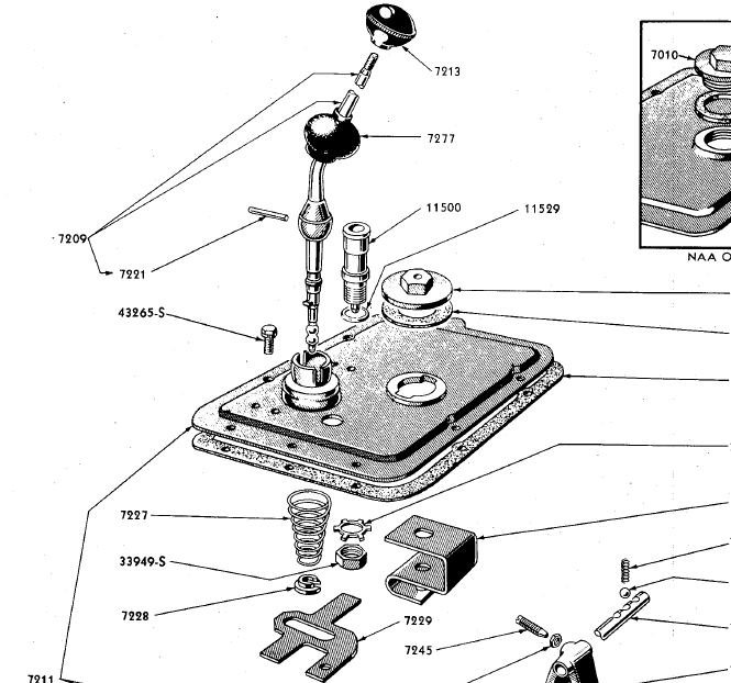

T-Mo-(Moderator) 4,864 #3 Posted October 16, 2024 Is this a front mount distributor? Also, I would highly recommend you get the push button starter on the gear shift functioning for safety purposes. Most of the parts you can find on the 'net. Below is a few places that carry mainly 8N parts: https://www.dennis-carpenter.com/ https://www.just8ns.com/ https://fixthatford.com/?fbclid=IwAR3Vp_oah4dhpuLvTARKpsRl8_Oy5yCTq9Qmuu7YP0Vd2SssbkZ156AycsY https://arthurstractors.com/ https://www.brokentractor.com/c/ford-new-holland-tractor/ There is also yesterday's tractors that sell parts for Ford tractors. 1 Share this post Link to post Share on other sites

T-Mo-(Moderator) 4,864 #6 Posted October 17, 2024 The starter button in front of the shifter has forks that go around the shifter below the panel that when in any gear will not allow the button to be depressed. When in neutral, the button can be depressed to start the tractor. There is a video on youtube that shows a guy getting run over with his 2N because of not having the proper starter button functional and not checking to see if the tractor is in neutral. Below is the setup. Item 7229 is the lock that goes around the shifter to lock it and while item 11500 is the starter button. Share this post Link to post Share on other sites
8ntruck 8,978 #7 Posted October 18, 2024 @T-Mo I found that diagram in my service manual last night. Looks like something to look into once I get a permanent shop in our Ky location to work on the tractor. I finished off the new wiring today. Push the starter button, EJ cranks. Turn the ignition on and no magic smoke escaped. Crank with the ignition on, no fire. Give him a huff of starting fluid, still no fire. I've got power at the coil, so I pulled the distributor again to check the point gap. Just for grins I checked for continuity with the points closed. Upon closer inspection, the points were not closing. I have a new set of points, so I decided to install them. The old points were hard to get off of the pivot pin in the distributor. The new points went on with about the same resistance as the old ones came out. By this time, I had the points plate out of the distributor. The spring on the new points could not close the points. Either the pivot pin is damaged, or the points of offshore origin have a bore that is too small. Whatever the case, I was out of time to work on EJ this trip, so I packed the distributor and the air cleaner into the truck for more complete inspection and cleaning once we get back to our MI location. Share this post Link to post Share on other sites

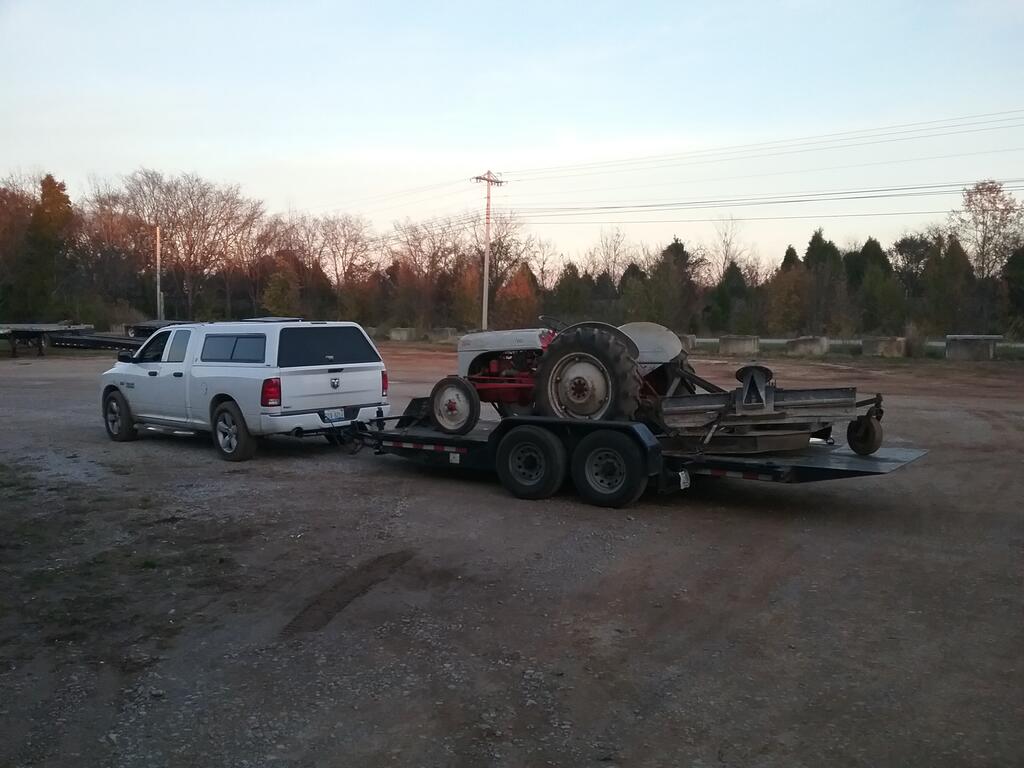

8ntruck 8,978 #8 Posted November 27, 2024 Got back to EJ the 8N today. I pulled the distributor off and took it to Michigan, where I've got a regular work bench instead of using the truck tailgate in a poorly lit, dusty warehouse. I got a set of premium Blue Streak points and installed them. Had to file clearance in the mounting bolt holes to get the correct gap setting. I also discovered that I was missing some gaskets in the distributor. I also discovered that the distributor shaft and bushings were worn. Time, again was an issue, so the distributor went back together and back onto the engine with the worn shaft/bushings. Figured it was running with these components before, so it will probably run with them again. Not optimal, but I need a running tractor now, rather than a perfect one later. Parts will be ordered and those issues will be addresses at a later time. After tweaking the spring fingers on the distributor end of the plug wires to improve the friction fit in the cap, EJ came to life. My rewire job seems to be good. The volt meter on the dash reads 15 volts, but the digital multi meter reads 13.9 at the battery, so all is good. His hydraulics made the attached brush hog go up and down, all of the gears worked, the pto made the bush hog spin, so we loaded him up on a tilt bed trailer and drove him out to our 20 acre wood. While waiting for left turn lights in adjacent left turn lanes. I got a couple of grins and thumbs up from other drivers. While reinstalling the air cleaner, I shined a flashlight into the carb. Man, it it filthy in there. Looks like, I'll be taking both the carb and distributor with me for further work. Lots of other items need to be addressed. List is being developed. Brakes are near the top of that list. I won't always have an implement attached to drop as a substitute. Yes, I know pictures are mandatory. I have not figured out how to get them from one device to another and attached here. Probably next week. 2 Share this post Link to post Share on other sites

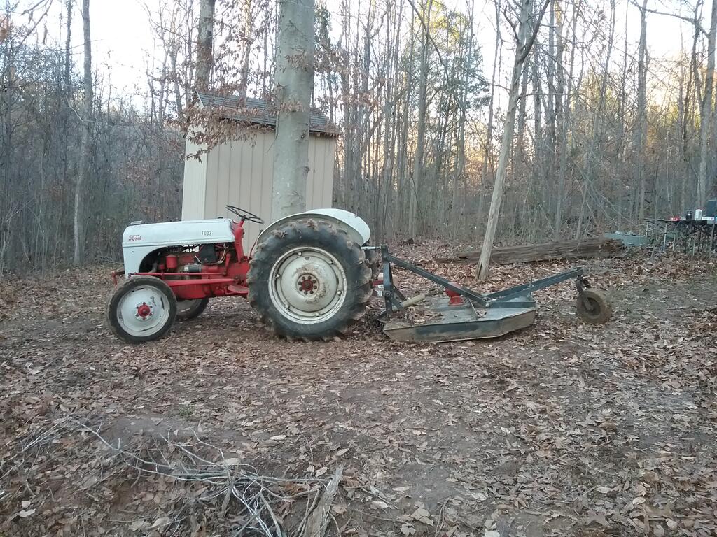

8ntruck 8,978 #11 Posted December 8, 2024 Pictures! EJ leaving the warehouse. EJ out in the woods. 2 Share this post Link to post Share on other sites
T-Mo-(Moderator) 4,864 #12 Posted December 8, 2024 Nice looking 8N. 1 Share this post Link to post Share on other sites
8ntruck 8,978 #13 Posted December 8, 2024 . It looks good from afar, but it is far from good. Got a to do list on it about 3 yards long. Since I've gotten it out to our woods, brakes and axle seals have risen rapidly to the top of that list. That picture was taken at one of the 'more reasonably' leves spots on the property. For reference, the shed behind the tractor is plumb..... 1 Share this post Link to post Share on other sites
