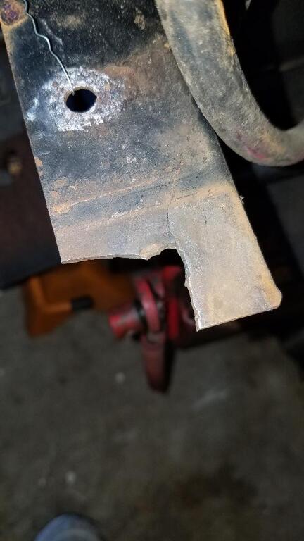

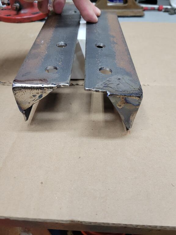

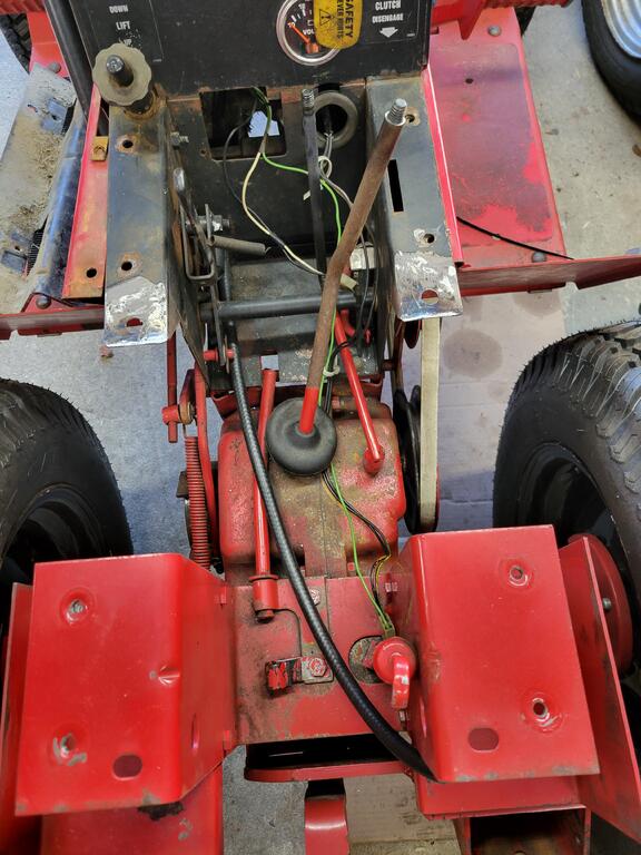

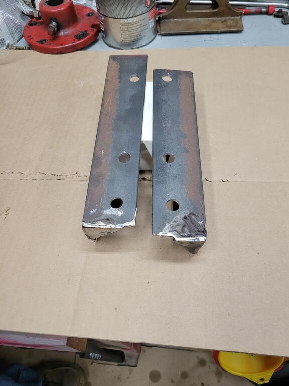

mrc 1,075 #1 Posted October 15, 2024 hello all, the seat mount cracked on my SIL's 414-8. no surprise they all do eventually. welded and ground the cracks. then fabbed some brackets which go on top of the seat mounts. should never have a problem again. 1 5 Share this post Link to post Share on other sites
ri702bill 12,075 #2 Posted October 15, 2024 Mike - did you weld them in place or just sandwich them in?? Share this post Link to post Share on other sites

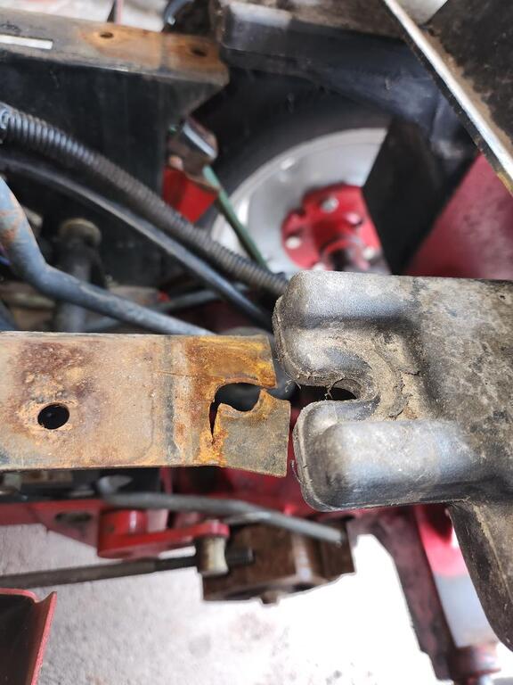

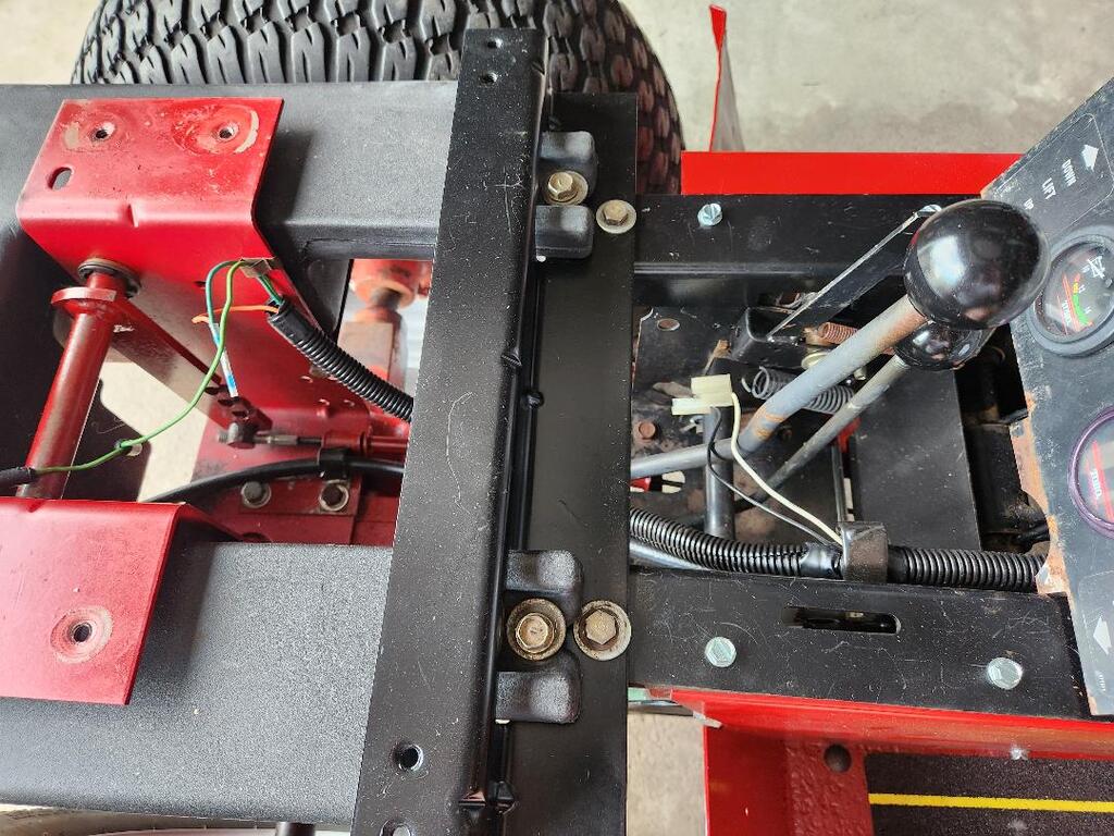

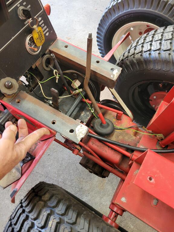

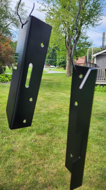

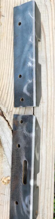

Brockport Bill 2,327 #3 Posted October 15, 2024 sadly, there is this hoodstand design shortcoming in these horses -- i have used large washers for reinforcement for those with minor emerging cracks - others have been welded if repairable --- and others I went the full fix by installing fabricated overlay brackets -- i actually had the brackets produced ( thanks to copies from Bill D. ) by a local fabricator/welder shop and he put the design specs/images on his computer software so in future i can just have new added units made by him. Took them home then painted and installed - - have some temporary screws in for alignment - but will work well after tunnel plate is installed. 4 Share this post Link to post Share on other sites

mrc 1,075 #8 Posted October 15, 2024 ri702 bill, just sandwiched them in 1 Share this post Link to post Share on other sites
Brockport Bill 2,327 #9 Posted October 15, 2024 love the heavy duty springs Share this post Link to post Share on other sites
mrc 1,075 #10 Posted October 15, 2024 hi brockport bill, i used angle iron because it is what i had on hand. plus i do not have a sheetmetal brake. how much per pair from your fab guy? does he have some for the hydo's as well? i think they may be a tad different. thank you mike Share this post Link to post Share on other sites
Brockport Bill 2,327 #11 Posted October 16, 2024 Hi Mike -- the units i used on the 416-8 are same as those i used on 314h - there are some subtle differences for the wh design of the tunnel/hoodstand ( cut outs - slots ) -- however, the set in photos on the 416-8 are modeled after the set on the 314h - I do not recall exact $$ price i paid but the first set in these circumstances always cost more because it included his set up of the graphic images on his computer software - I have not asked him a cost to reproduce because I ordered 2 sets for his first production and have not needed additional. If you are considering buying some i will ask him his fee to produce? Share this post Link to post Share on other sites
mrc 1,075 #12 Posted October 16, 2024 yes i am considering buying some. please ask for price. they look like heavy sheetmetal. any idea what gage? they look well made Share this post Link to post Share on other sites
Brockport Bill 2,327 #13 Posted October 16, 2024 30 minutes ago, mrc said: yes i am considering buying some. please ask for price. they look like heavy sheetmetal. any idea what gage? they look well made it will be a couple days before i can get to his shop -- are you in a rush? Not sure the guage he used - - i will ask? Share this post Link to post Share on other sites
Bill D 2,838 #14 Posted October 16, 2024 I've made several sets using 2" x 1 1/2" angle steel. 1/8" thick. Made mine from old bedframe steel. 1 1 Share this post Link to post Share on other sites
mrc 1,075 #15 Posted October 16, 2024 brockport bill, no rush. appreciate your help. Bill D, i made mine from 2 x 2 x 1/8 inch angle iron. nothing wrong with old bed frames. use what you got! Share this post Link to post Share on other sites
lynnmor 8,803 #16 Posted October 16, 2024 1 hour ago, mrc said: nothing wrong with old bed frames. use what you got! Bed frames are usually much stronger steel than what you will find at the local hardware store. 2 Share this post Link to post Share on other sites

johnnymag3 2,646 #19 Posted October 16, 2024 9 hours ago, Brockport Bill said: it will be a couple days before i can get to his shop -- are you in a rush? Not sure the guage he used - - i will ask? they are bedframe Share this post Link to post Share on other sites
