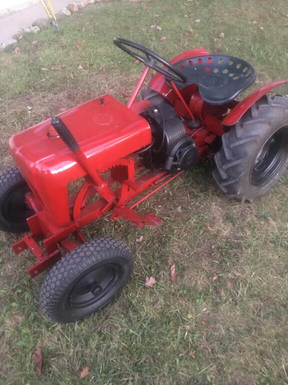

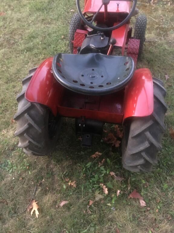

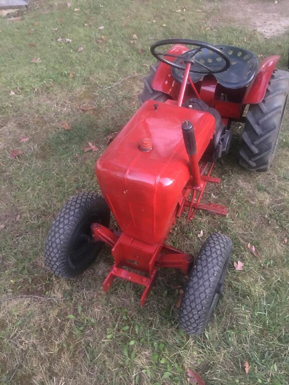

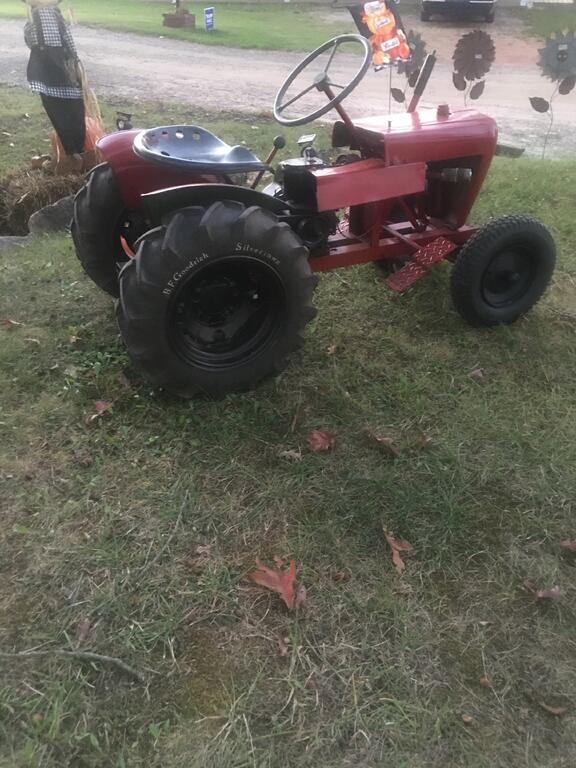

ShawnsRJ 16 #1 Posted October 12, 2024 Hello and thanks for adding me to your group. I was wounding how many different years of parts are on my Suburban obviously it’s not original. I’ve been trying to contact a fellow on the web named VINSRJ since I use to own a few back in the 90s but we’re lost in a fire. I am getting back into them and was wondering when is the big wheel horse show in south mountain. Thanks Shawn 8 Share this post Link to post Share on other sites
wallfish 20,384 #2 Posted October 13, 2024 The frame and trans is 1960. The 1960 400 and 550 are the same tractor except for the engines and electric start stuff Kohler K91 is correct but probably a replacement engine The foot rests are 1960 Looks like the gas was changed and probably not an original tank. The cap is sitting up too high The front wheels have been changed. Looks like new tires on wheelbarrow rims. The bracket on the front is for a dozer blade. The big show in PA is always the weekend after Father's Day at the end of June 3 Share this post Link to post Share on other sites

wallfish 20,384 #5 Posted October 13, 2024 There will be a cast code on the trans next to the shifter. If it ends with 0 it's 1960 trans. Your tractor is most likely a 400. Too bad someone cut the hood off but it still makes for a good tractor. Fun to drive and especially at engine shows 1 Share this post Link to post Share on other sites
ShawnsRJ 16 #6 Posted October 13, 2024 K 26-9 is casting numbers 1 Share this post Link to post Share on other sites

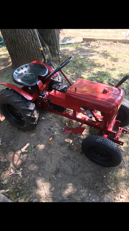

wallfish 20,384 #7 Posted October 13, 2024 14 minutes ago, ShawnsRJ said: K 26-9 is casting numbers 10/26/1959 They skipped the letter I because it could be interpreted as a 1. That casting is from late in 1959. Most likely it was an early 400 tractor. The side plates for the suburban are different than the RJ, whereas the brake band tab would be different. On a 45 deg angle for the suburban. Vertical straight up and down tab on the RJ. Of coarse it's always possible parts are changed over the years but...who knows. I can see the 45 tab on your trans. Think I found the back of your hood LOL It's a 400 cut off in just about that exact same spot 5 Share this post Link to post Share on other sites
