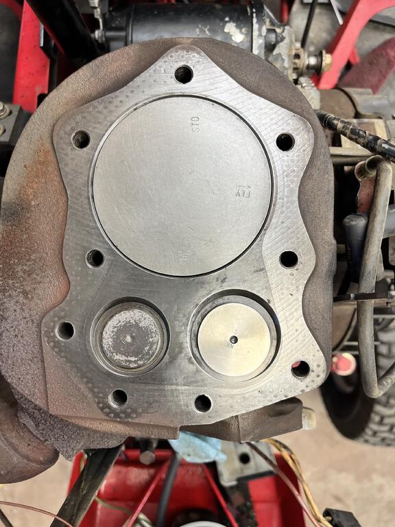

Wvtroutbum81 327 #1 Posted October 5, 2024 Engine experts, M12 with 2,201hrs. Oil has always been changed twice a year. Does not smoke or use oil, the head gasket was leaking on exhaust side. This is post cleaning Share this post Link to post Share on other sites
Wvtroutbum81 327 #2 Posted October 5, 2024 17 minutes ago, Wvtroutbum81 said: Engine experts, M12 with 2,201hrs. Oil has always been changed twice a year. Does not smoke or use oil, the head gasket was leaking on exhaust side. This is post cleaning Is there anything i should inspect while apart Share this post Link to post Share on other sites
adsm08 5,006 #3 Posted October 5, 2024 The mating decks of the block and head should be inspected for any deformation. The correct way to do it is with a machinist's straight edge and some feeler gauges. I usually just pass the straight edge over the surface with a flash light behind it. If I can't see light under the bar I don't bother with the feelers. If the head needs any straightening you can deck it yourself by coloring in the entire surface and sanding it with a piece of sand paper wrapped around a piece of glass. There are others who are more familiar with that process than I am. 1 Share this post Link to post Share on other sites
kpinnc 18,884 #4 Posted October 6, 2024 (edited) It looks clean, but of course impossible to tell if the bore is still within spec. As @adsm08 said, it’s a good time to check the head. @ebinmaine has some posts on here doing it the right way. If the engine still made good power and didn’t smoke, I say true the head and run it. Edited October 6, 2024 by kpinnc Share this post Link to post Share on other sites
leabassett@sbcglobal.net 174 #5 Posted October 6, 2024 New head gasket and head bolts. Than let her rip. Share this post Link to post Share on other sites
Wvtroutbum81 327 #6 Posted October 6, 2024 20 minutes ago, leabassett@sbcglobal.net said: New head gasket and head bolts. Than let her rip. Where is a good source for the bolts? do they have to be replaced Share this post Link to post Share on other sites
ebinmaine 80,285 #7 Posted October 6, 2024 39 minutes ago, kpinnc said: true the head and run it. 18 minutes ago, leabassett@sbcglobal.net said: New head gasket and head bolts. Than let her rip. Gotta true the head. It's almost certainly warped even if only a small amount. I do NOT install a cylinder head without trueing it. Ever. We use a piece of known flat steel. Tape a piece of sandpaper to the steel. There should be a thread on here describing the procedure. 3 minutes ago, Wvtroutbum81 said: Where is a good source for the bolts? do they have to be replaced If the engine has NEVER been apart the head bolts MIGHT be reusable. Older K series use normal Grade 8 bolts. Not sure about a Magnum. Share this post Link to post Share on other sites

oliver2-44 11,694 #9 Posted October 6, 2024 Now would be a good time to pull the carb so you can clean the breather and adjust the valve clearance. If the head checks out to be flat with a feeler gage go with it. But do check it’s 1 Share this post Link to post Share on other sites

Wvtroutbum81 327 #12 Posted October 6, 2024 Thanks, I ordered a new Kohler gasket, Going to adjust valves and replace the breather. Also got copper spray! 1 Share this post Link to post Share on other sites
