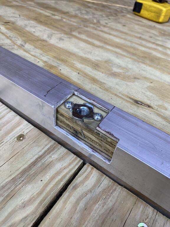

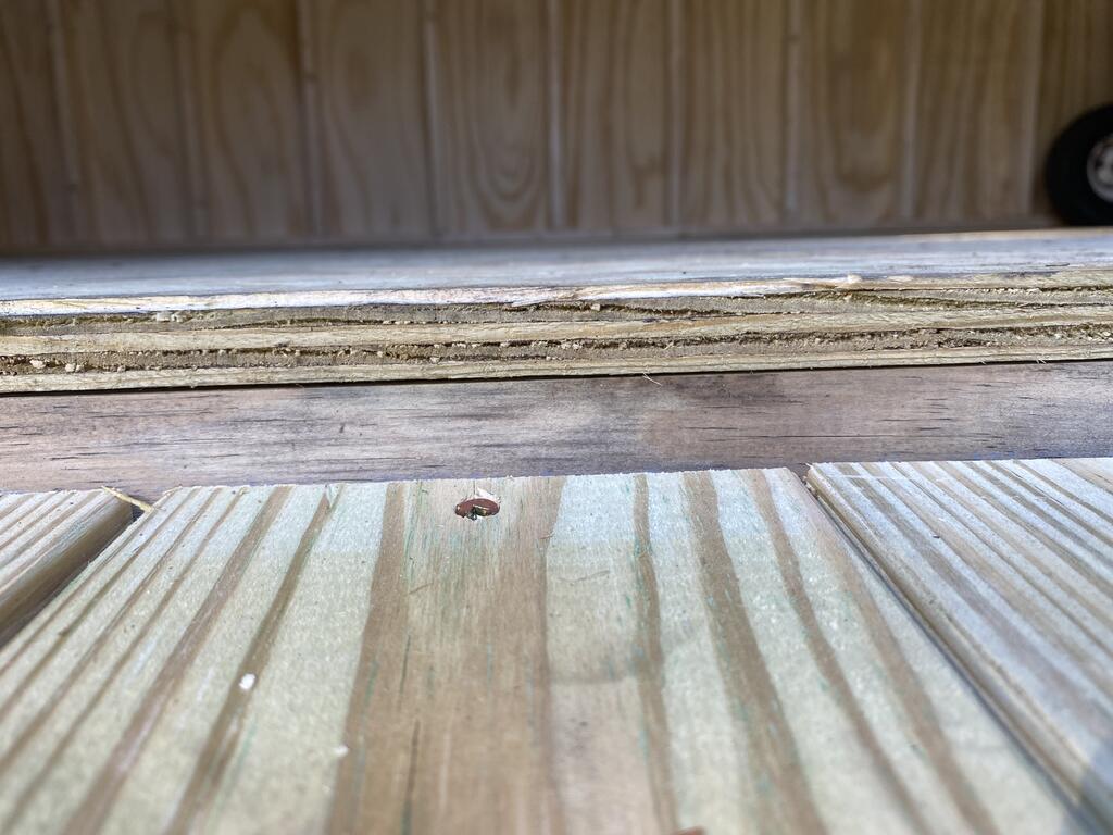

Sparky-(Admin) 26,263 #26 Posted October 6, 2024 Making my first shed modification. Backed the B-80 in with the 36” deck on it and the deck chunked out a small bit of wood on the lip at the top of the ramp ! Can’t have that!! Bought 1.5” x 1.5” aluminum angle, had to make a custom hole/notch so I could maintain a continuous strip. 5 Share this post Link to post Share on other sites

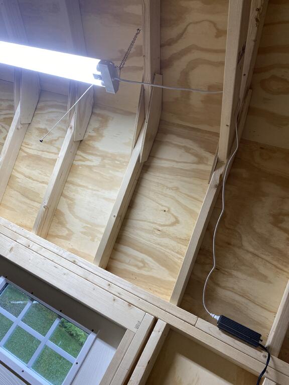

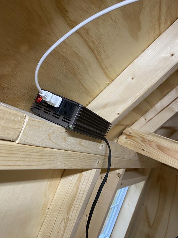

Sparky-(Admin) 26,263 #28 Posted October 7, 2024 Tree hugger approved lights ! Just temporary till I can get real power trenched. Solar panel in the window (as needed) to a 12v tractor battery to a 12v to 300w/120v converter to an LED shop light. 3 1 Share this post Link to post Share on other sites
Brockport Bill 2,468 #29 Posted October 7, 2024 Sparky - Can you send a link or provide mfg info for the charger system? Thanks, Bill 1 Share this post Link to post Share on other sites
wallfish 20,553 #30 Posted October 7, 2024 5 hours ago, Sparky said: Tree hugger approved Hmmm, is all that wood for the shed responsibly harvested? Doubtful. I'm turning you in to the tree hugger police either way. YOU are on notice sir! 4 Share this post Link to post Share on other sites
Sparky-(Admin) 26,263 #31 Posted October 7, 2024 3 hours ago, Brockport Bill said: Sparky - Can you send a link or provide mfg info for the charger system? Thanks, Bill Bought this at Harbor Frieght like 12 years ago to charge up the trolling motor on my boat while it sat in a slip. It’s unregulated, so I don’t hook it up and let it “run” forever. 2 1 Share this post Link to post Share on other sites

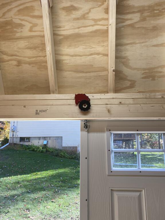

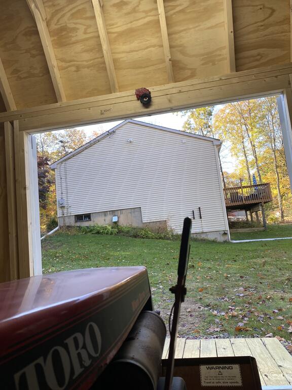

Sparky-(Admin) 26,263 #33 Posted October 19, 2024 Finally have a place to hang this now….thanks Ed! @Ed Kennell 2 4 1 Share this post Link to post Share on other sites
rjg854 13,330 #34 Posted October 21, 2024 That should be on the outside 1 Share this post Link to post Share on other sites
WHX?? 57,904 #35 Posted October 21, 2024 1 hour ago, rjg854 said: That should be on the outside Weather & sun would kill them. 1 Share this post Link to post Share on other sites
