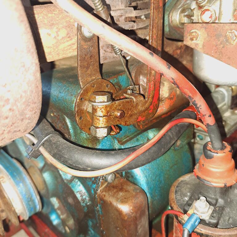

WHX?? 56,843 #1 Posted September 30, 2024 I have had them weep before but never as bad as this one. Pretty good sized drop every minute. Anyone seen this before and have a cure? Share this post Link to post Share on other sites
oliver2-44 11,515 #2 Posted September 30, 2024 The k181 (gray replacement engine) on my C81 likes to slobber out the governor shaft when the oil level is at the full mark. it doesn't do it if its on the low end of the normal range. I've had the breather off and verified with the manual that it was installed correct and the little drain hole back into the block was open. I've also lapped the valves, valve guides seem a little loose, cleaned carb, etc. De-carboned head and measured bore and it was just within spec but, I really suspect the rings have more blow by than the breather can handle. It was missing the carb and had sat open for ? years before I got it. So for a $100 tractor I just run it at the low-side of normal and try to keep an eye on it. So, I'm interested if you figure anything out. 1 2 Share this post Link to post Share on other sites
WHX?? 56,843 #3 Posted September 30, 2024 1 minute ago, oliver2-44 said: oil level is at the full mark. it doesn't do it if its on the low end of the normal range. Interesting enough I had just changed the oil and is right at the full mark. It didn't do it before the change and only had less than a quart in and didn't do it. I use the patented @Racinbob method of draining old oil into a marked juicy juice bottle. Will recheck level and maybe remove a little ... see if that helps. it definitely is coming out the guv shaft. Will check the breather as well. 2 Share this post Link to post Share on other sites
squonk 46,835 #4 Posted September 30, 2024 I'm betting blow by is over- pressurizing the breather / gov area . There shouldn't be an excess amount of oil way up top unless overfull. A cylinder leakage test could confirm. I had a K341 that ran fine but leaked a tad out of the gov. Had half of the piston skirt missing. 2 Share this post Link to post Share on other sites
gwest_ca-(File Mod) 12,273 #5 Posted September 30, 2024 Another possibility 1 1 Share this post Link to post Share on other sites
squonk 46,835 #6 Posted September 30, 2024 Worn guides will also over pressurize the breather area. 1 Share this post Link to post Share on other sites
wallfish 20,031 #7 Posted September 30, 2024 Yup, crank case pressure pushing it out 1 Share this post Link to post Share on other sites
