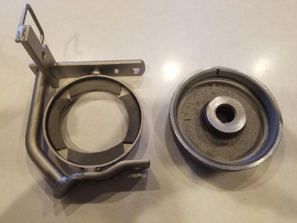

WHX?? 57,644 #1 Posted September 27, 2024 (edited) This might be a long shot but what the heck. Nice older gentelman walks into my shop the other day looking to get the friction material lining replaced on a clutch cone that was used on many late 70's Simplecities & Allis Chalmers. Told him I was a guy but would take a stab at it. Broaden my horizons don't ya know... Same type of clutch used on a few horses ... C-195 & early RERs come to mind. Turns out of course the part is made of unobtainium and NLA. Wondering if anyone has a gently used one or could at least tell me what the thickness of the lining is. Maybe Maynard's brake band lining would work? Or material from McMaster Carr? Edited September 27, 2024 by WHX?? Share this post Link to post Share on other sites

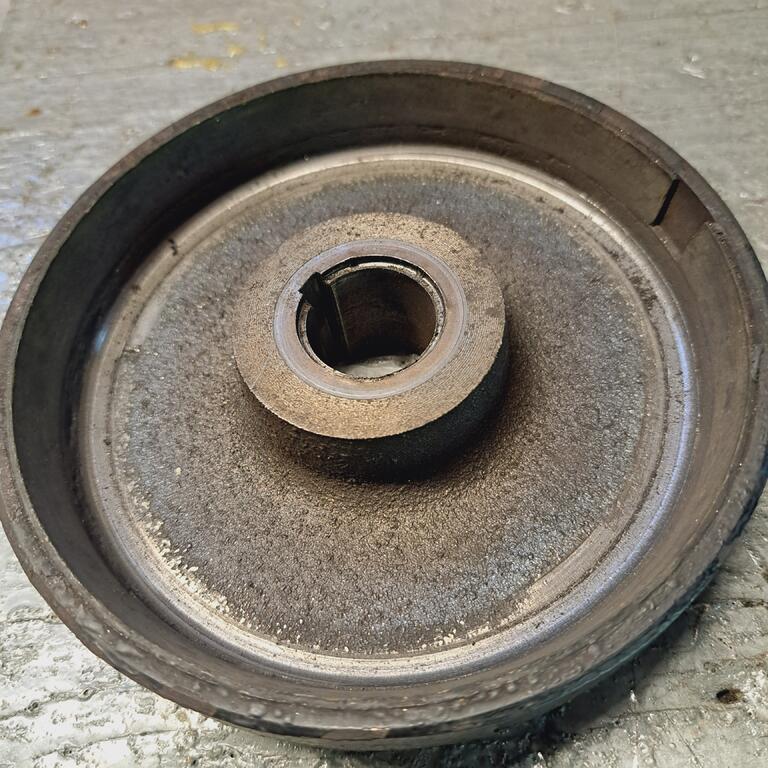

WHX?? 57,644 #2 Posted September 27, 2024 I did steal your pic from another thread @Wild Bill 633 and this is why I was lurking around on that other site... I may just send it out to one of the place mentioned in another thread ... thanks @squonk y. Would like to try and reline myself ... just for practice. 1 Share this post Link to post Share on other sites

8ntruck 9,176 #4 Posted September 27, 2024 The lining for a cone clutch will be a curved piece - sort of a smile shape - when it is flat so it will curl into a conical shape. A brake band lining curls into a cylindrical shape, not a cone. Simple shape to develop with the proper CAD program. Possible to do on a drafting board with paper & pencil, too. Been a long time since I've done that. I'd have to look that method up. 1 1 Share this post Link to post Share on other sites

WHX?? 57,644 #10 Posted October 2, 2024 Sent it out to the place @Wild Bill 633 mentioned ... 50 clams + 20 shop fee & shipping. Gal said they have done quite a few this year. https://www.brakematerialsandparts.com/ Will have to ask if they do horse clutches. . 2 Share this post Link to post Share on other sites
