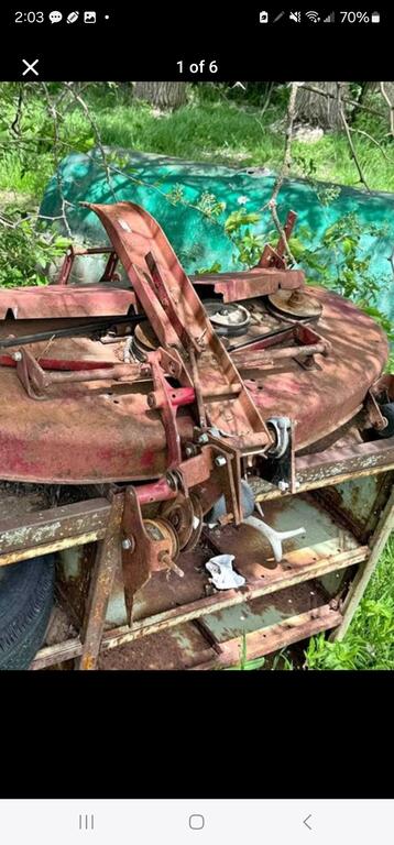

OKC123 1 #3 Posted September 16, 2024 I'll have to look into the differing connections. The mower deck I was looking at is in the picture. Can't find much info on if it'll connect. Parts tree had a very similar layout for the Raider 12 Share this post Link to post Share on other sites
Lee1977 7,709 #4 Posted September 16, 2024 (edited) That looks like a Raider deck one came with my Raider !2. I took mine off to haul it home and decided not to used it. I did install he required hitches for the later model decks but found my Raider 12 was too low on power to handle a .42" deck Edited September 16, 2024 by Lee1977 Share this post Link to post Share on other sites

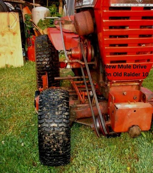

daveoman1966 3,884 #5 Posted September 16, 2024 (edited) The old Raider 12 has the side mule drive on it. All you need to do is mount a front mule drive to the tractor...then you can use the C-175 deck... maybe have to get new belt. Here is my self-made UPGRADE .pdf file to show you what/how to do this. Takes about an hour. MULE DRIVE UPGRADE DETAIL.pdf Edited September 16, 2024 by daveoman1966 Share this post Link to post Share on other sites
953 nut 67,385 #6 Posted September 16, 2024 Once you have the side mounted mule drive properly adjusted they work fine. The photo you have of the deck seems to have all the needed hardware for a Raider mounting but it doesn't appear to be from a C-175. By 1981 when the C-175 was built they had gone to the front Tach-A-Matic and Mule Drive for decks. Share this post Link to post Share on other sites
OKC123 1 #7 Posted December 7, 2024 @daveoman1966 we were able to get the front mule drive installed per your direction. At this point we're missing a connecting rod / part needed to lift the deck. Would you mind providing any details or pictures of the part used to lift the deck between the lever and deck? Those we've tried fabricating are hitting certain frame parts when lifting the deck. Share this post Link to post Share on other sites

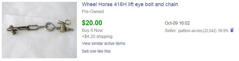

daveoman1966 3,884 #9 Posted December 7, 2024 Use just a 3/8 Eye-Bolt and short chain link. like this: The part that slides up/down on the eye-bolt dhaft is the Trunion. Wheelhores Parts-n-More should them....see the VENDORS section. Share this post Link to post Share on other sites

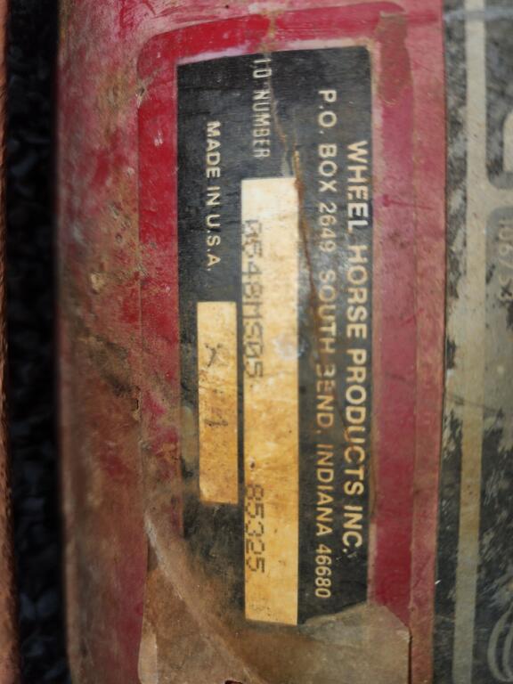

OKC123 1 #10 Posted June 21, 2025 On 9/16/2024 at 6:43 PM, daveoman1966 said: The old Raider 12 has the side mule drive on it. All you need to do is mount a front mule drive to the tractor...then you can use the C-175 deck... maybe have to get new belt. Here is my self-made UPGRADE .pdf file to show you what/how to do this. Takes about an hour. MULE DRIVE UPGRADE DETAIL.pdf So I've added the mule drive to my raider 12 with the mower deck listed below but I'm having a hard time choosing the right belt. I've gotten belts too short that have ripped up, too thick that flung off. My question is which belt would fit this setup? Share this post Link to post Share on other sites
gwest_ca-(File Mod) 12,348 #11 Posted June 21, 2025 The belts for this deck on a long frame tractor in 1986 should work. Click on the fuzzy picture in the link to see them. Share this post Link to post Share on other sites
