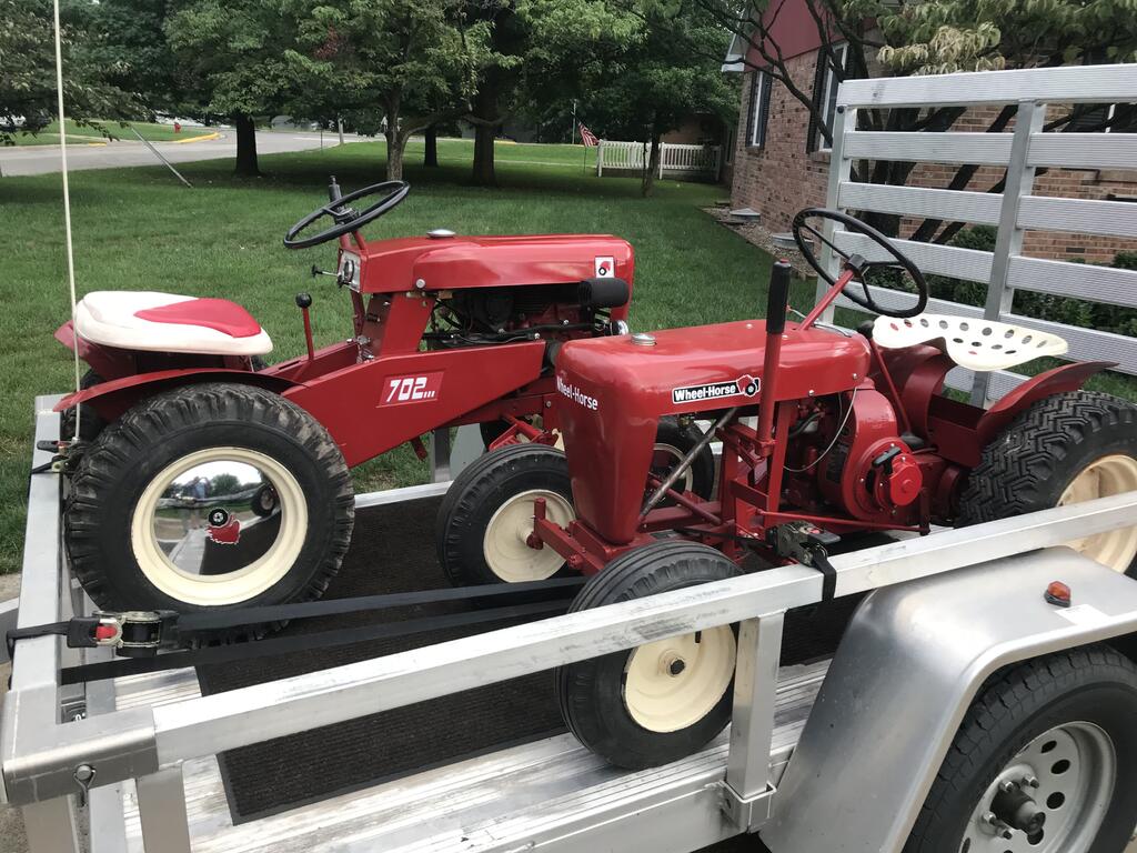

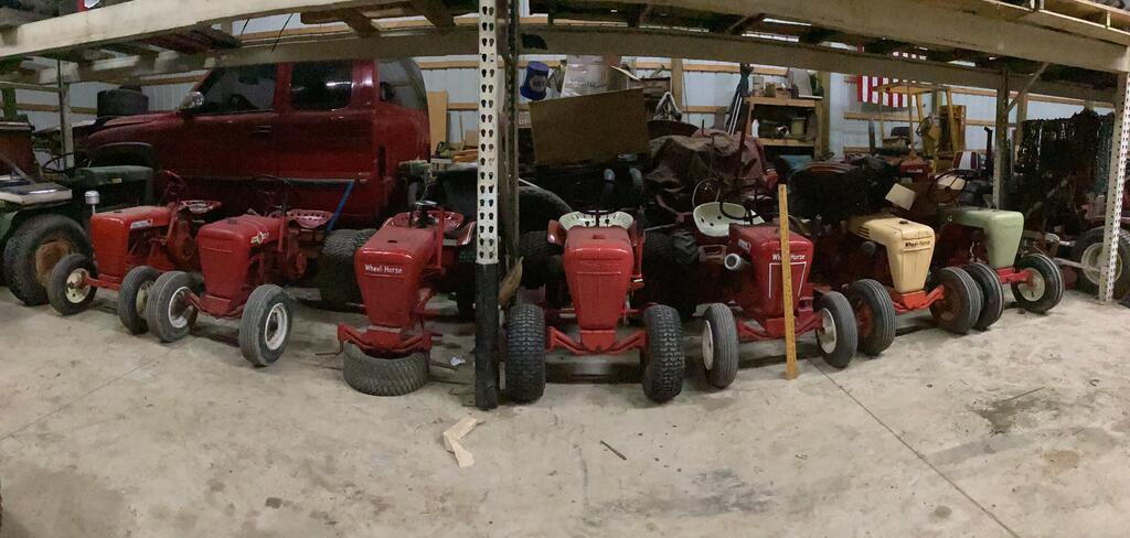

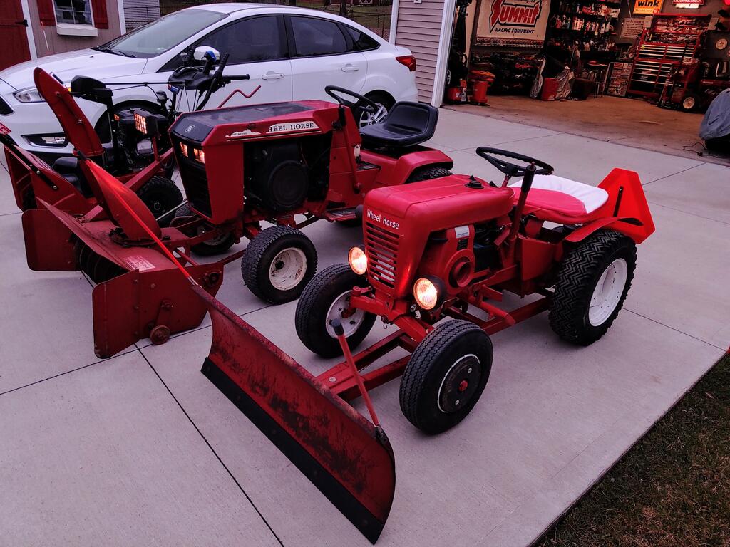

Pullstart 71,563 #7 Posted September 9, 2024 Round Hoods Rule! 3 5 Share this post Link to post Share on other sites

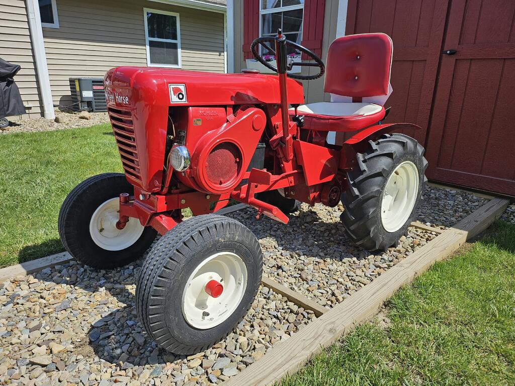

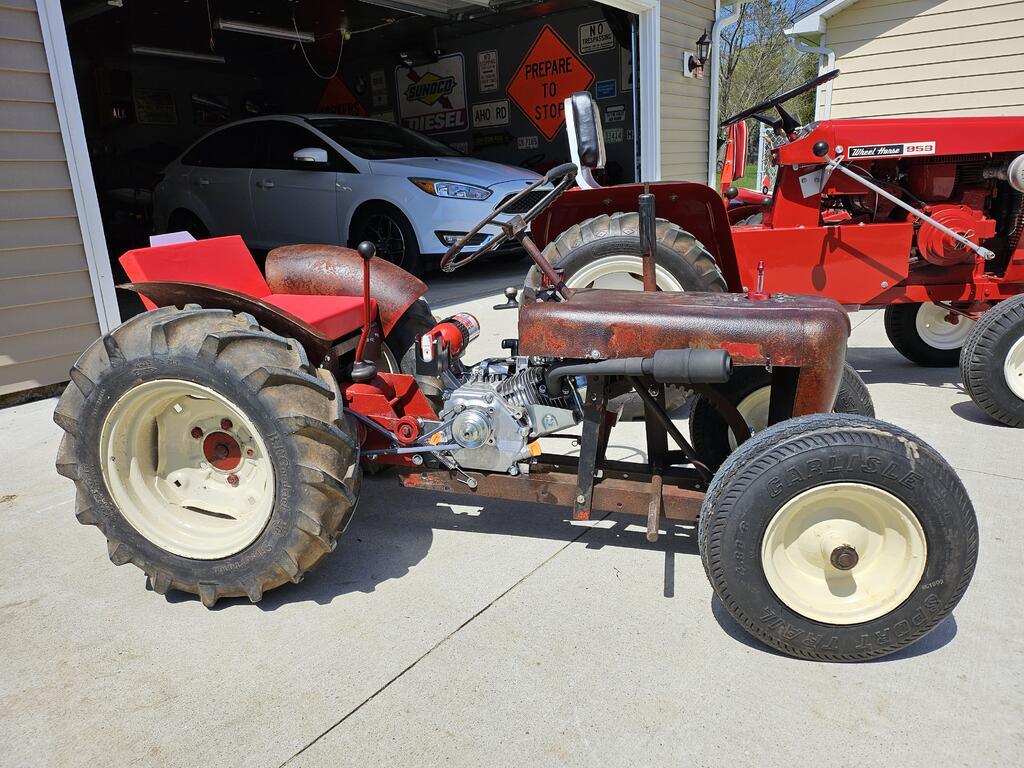

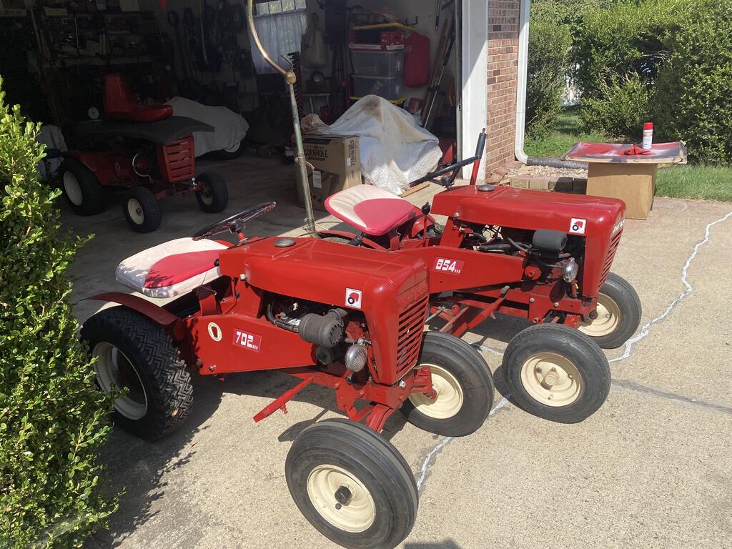

ML3 2,571 #13 Posted September 9, 2024 4 hours ago, WHX?? said: and yes your best source for parts is right here and the Big Show. Quit showing off your round hoods Kev... Round Hoods????? I got a couple...... 2 6 Share this post Link to post Share on other sites

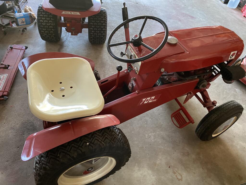

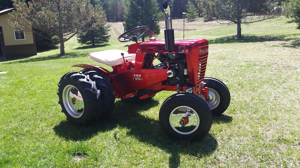

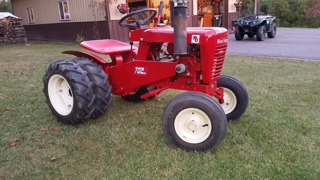

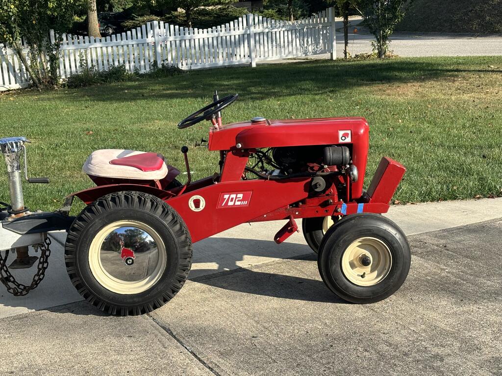

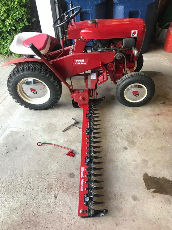

Lane Ranger 12,167 #14 Posted September 9, 2024 My 702 has probably had better attention on maintenance, repair etc than any of my other Wheel Horse tractors. It is not my favorite but I do still enjoy riding and working with this tractor. The speed with which Wheel Horse innovated with new devices, attachments and features on their tractors made a quick end to the round hoods but boy they got a lot right early on! 2 10 Share this post Link to post Share on other sites
