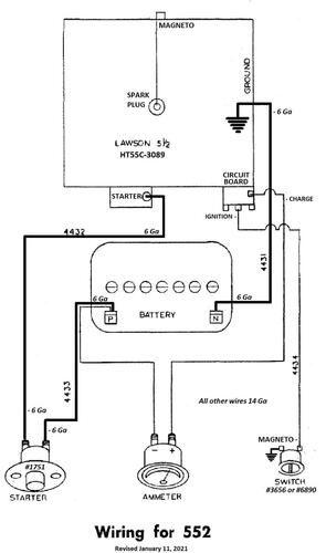

552 Wiring revised
1 page 217KB

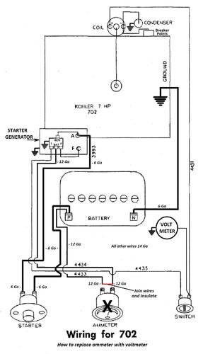

702 Wiring revised
1 page 247KB
Diagram showing how to replace ammeter with voltmeter
1 page 75KB

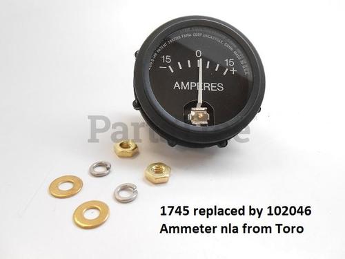

Photo of 1745 replaced by 102046 ammeter - nla from Toro

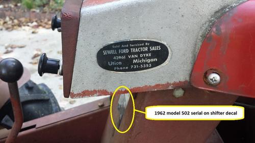

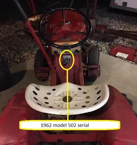

1962 model 502
1962 serial numbers that have shown up for the 502

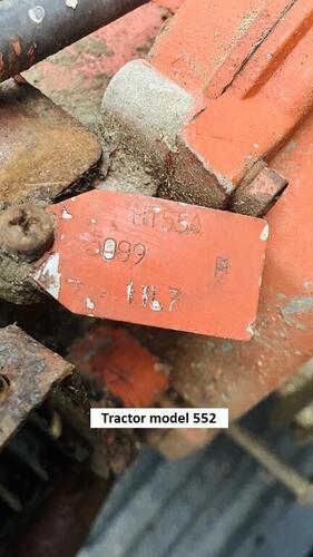

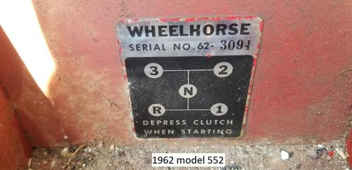

1962 model 552
1962 serial numbers that have shown up for the 552
