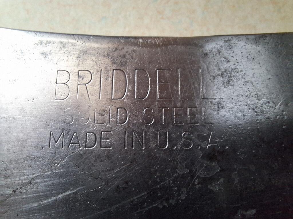

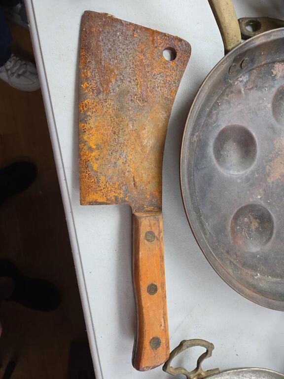

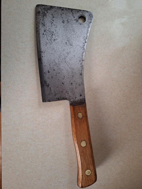

D_Mac 9,339 #1 Posted September 7, 2024 (edited) So I went to another estate sale today. I picked up this rusty old cleaver for 10 bucks. Watched a few videos on restorations but I wanted to clean it up without using any power tools. Came out pretty good but I'd like to get some more of the stains out of the metal. I used steel wool, vinegar, some emery cloth. Sanded the handle and rubbed linseed oil over all of it. Looked up the brand name... Briddell. I guess it's a pretty good one. Don't really have a use for it but I thought it was pretty cool. Any suggestions on cleaning it up some more without using any power tools? Edited September 8, 2024 by D_Mac 5 Share this post Link to post Share on other sites
peter lena 10,125 #2 Posted September 8, 2024 @ D-MAC , MINERAL OIL ON THAT , just an initial soaking will help on existing PATINA . linseed oil was a good start , I go very easy on any old pick up , just want to retain what's there . saved a lot of original paint , pete 1 Share this post Link to post Share on other sites
Mickwhitt 5,259 #3 Posted September 8, 2024 Nice buy, I love old knives and cookery tools. Hard to recover the surface once it's pitted, but you have managed to keep a lot of the character there. I'd have probably bought it too, despite having no use for it. Sometimes it's just nice to have a thing for the sake of it. 2 Share this post Link to post Share on other sites

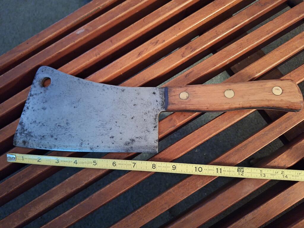

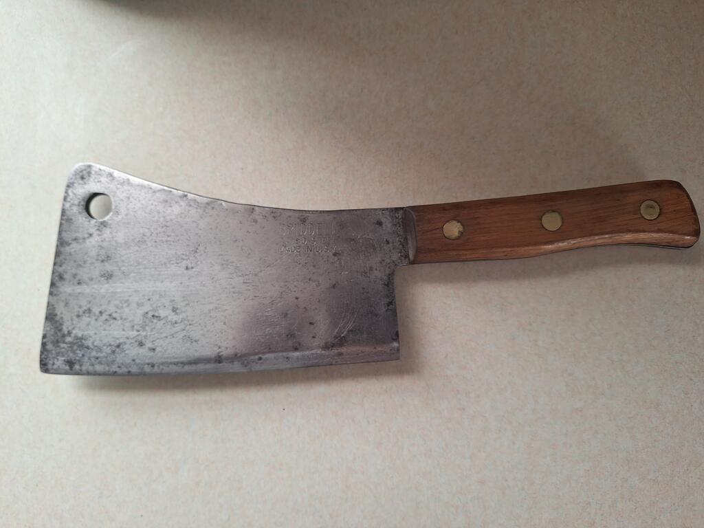

D_Mac 9,339 #4 Posted September 8, 2024 (edited) Worked on it some more with some metal pollish. Looking better. I also put a little edge on it. Calling it done. I sure wouldn't want to be on the business end of this thing. Edited September 8, 2024 by D_Mac 5 Share this post Link to post Share on other sites
