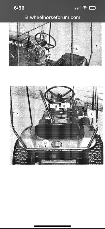

gwest_ca-(File Mod) 12,346 #4 Posted September 6, 2024 Your model number is not complete but likely does not matter. Click on the fuzzy picture to see what we know about this. In short it fits the 1978-79 and others with the wide hood stand.but should be easily modified for the C-160. A C-160 and C161 are almost identical. Perhaps the operator manual will help. Share this post Link to post Share on other sites

gwest_ca-(File Mod) 12,346 #6 Posted September 6, 2024 This is one for the C-160 1 Share this post Link to post Share on other sites

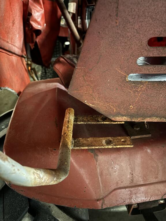

fourwheelhorseman 362 #7 Posted September 6, 2024 So I have a 1977 or 1978 cab, with an odd modification on the rear bracket , I should have the bar that runs under the tailight. I can make what I have work, but I’m wondering if I can get that bar, it’s called “H” Share this post Link to post Share on other sites
fourwheelhorseman 362 #8 Posted September 6, 2024 (edited) Or even the correct rear attaching bracket for the model of the cab that I have would be great too. This is what I have as of now… Edited September 6, 2024 by fourwheelhorseman 1 Share this post Link to post Share on other sites
fourwheelhorseman 362 #9 Posted September 7, 2024 I’ve got the cab figured out, I did call the original cab company to request a rear bracket, I got the answering machine so I’m waiting for them to call me back.. Share this post Link to post Share on other sites

ebinmaine 79,658 #12 Posted September 8, 2024 On 9/6/2024 at 7:02 AM, fourwheelhorseman said: Or even the correct rear attaching bracket for the model of the cab that I have would be great too. This is what I have as of now… I have a '75 C160-8 that had a cab many moons age when the PO's dad owned it. Along the way someone cut it off near the legs after a damage event. I may have the H feet..... Share this post Link to post Share on other sites
