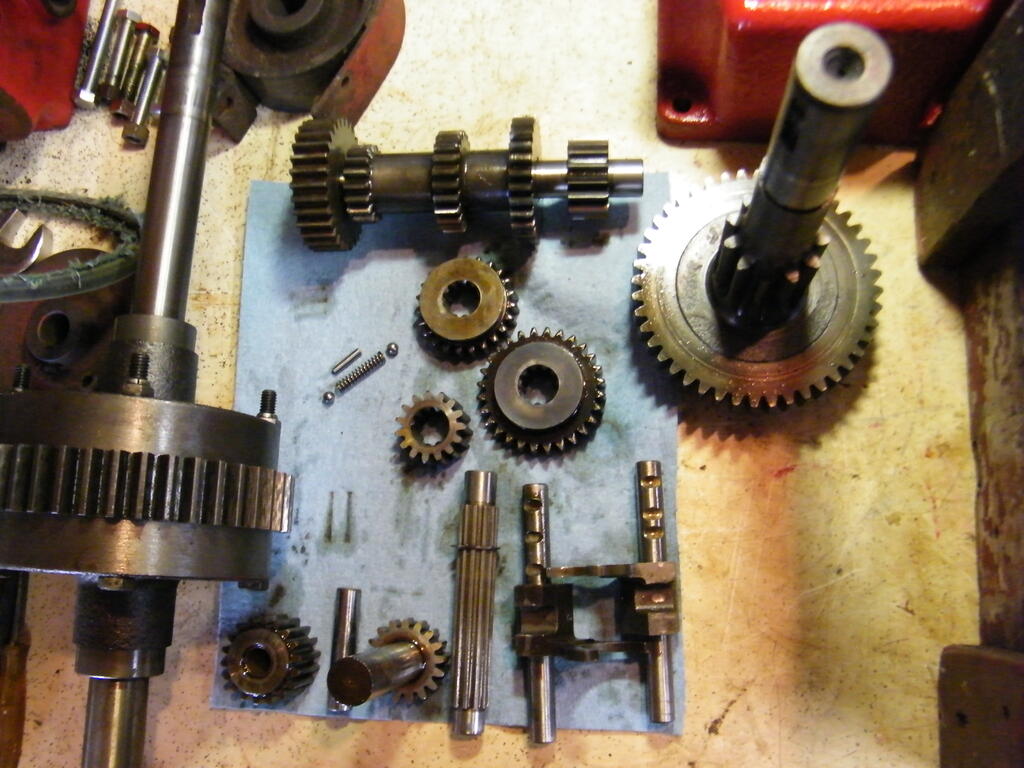

Handy Don 17,735 #51 Posted October 11, 2024 20 minutes ago, Scott from ontario said: No I did not I’m in Ontario Dang, that spring looks like it was pilfered from a retractable ball point pen! Share this post Link to post Share on other sites

Scott from ontario 3 #54 Posted October 29, 2024 Good afternoon everyone so I tried a pen spring with the 1/4 inch ball bearings and that does not work for the 953 tractor I have no idea on how long the spring should be and the amount of pressure to compress it anyone have information on the spring ? Share this post Link to post Share on other sites
Handy Don 17,735 #55 Posted October 30, 2024 4 hours ago, Scott from ontario said: Good afternoon everyone so I tried a pen spring with the 1/4 inch ball bearings and that does not work for the 953 tractor I have no idea on how long the spring should be and the amount of pressure to compress it anyone have information on the spring ? My comment about the pen spring was intended as a joke. Sorry if it confused you. The actual spring in the transaxle is heavier and stronger, I know @stevasaurus has posted the dimensions and might kindly do it again! Share this post Link to post Share on other sites
stevasaurus 23,892 #56 Posted October 30, 2024 @Handy Don , I know I measured that spring, but I can not find my notes or where I might have posted it. Shynon's post in post #48 is correct. MacMaster Carr should have a spring that should work...3/16 to 1/4" outside diameter & 1 1/4 to 1 1/2" long. Springs have 2 purposes...1. to pull something 2. to push something You want a spring that looks like the spring in a ball point pen...ie...it pushes the detent balls into the notches in the shift rails. Scott, try calling Lincoln at A to Z. I can't believe TORO does not have these in stock. Share this post Link to post Share on other sites
