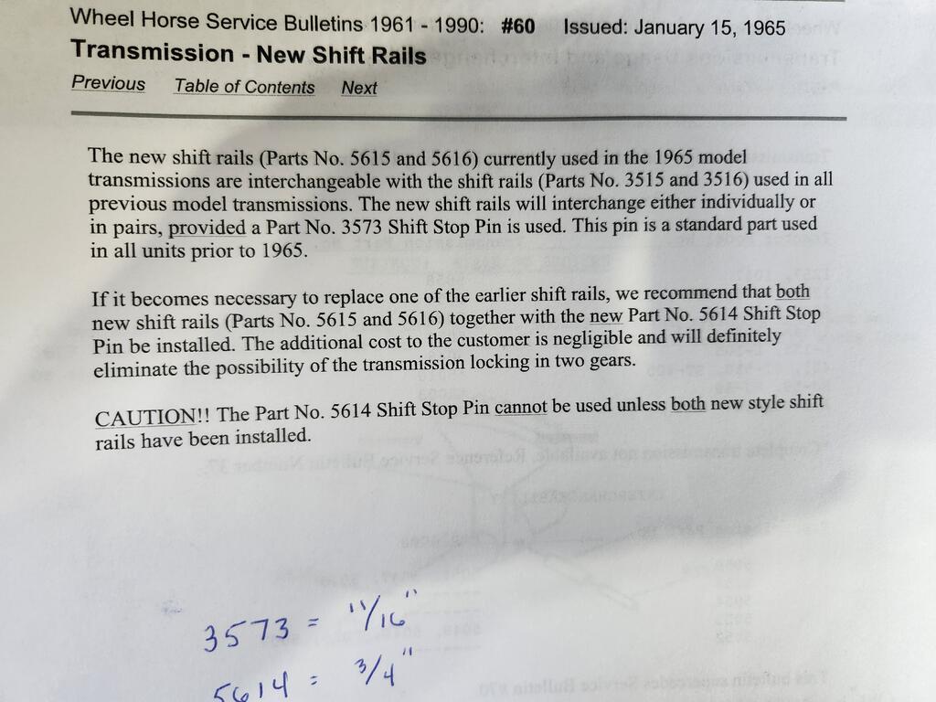

Racinbob 13,192 #3 Posted September 4, 2024 (edited) This is a common problem on the older transmissions. It's caused by the shift rails allowing it to find two gears the same time. Basically the rails ride in blind holes and suction causes them to lag behind. Careful shifting as mentioned will minimize the issue. Wheel Horse knew of the problem and initially issued a service bulletin stating to switch to 40w oil. This was in hopes the thinner oil would minimize the suction. Very so-so results. In 1965 they came up with a solution. Shift rails with a deeper center (neutral) detent groove along with a longer (3/4" vs 11/16") stop pin. This would not allow the rails to move into a gear unless the other one was in neutral. The left rails are the newer type. Keep in mind that there are two types on the newer style. One as pictured with the grooves machined all the way around and the type with just the center groove ground deeper. Both work the same and since the rails don't rotate it doesn't matter. Note the installation exceptions. In order for this to be effective both rails must be replaced and a 3/4" stop pin installed. The detent balls and springs are the same. At this point they changed their specs back to the heavier gear oil but the 40w had made it's way into some owners manuals and didn't get changed making some people thing that's what should be used. In reality, it really doesn't matter. 40w will work fine but I prefer the 80w90 stuff. Edited September 4, 2024 by Racinbob 1 2 1 Share this post Link to post Share on other sites

953 nut 69,341 #5 Posted September 4, 2024 As Bob @Racinbob said, the post 1965 shift rails were improved and they will fit the 953 transaxle. If you can find a used pair or a parts transmission that should solve the problem. You can place a free wanted ad on this site. https://www.wheelhorseforum.com/classifieds/wanted/ 1 Share this post Link to post Share on other sites

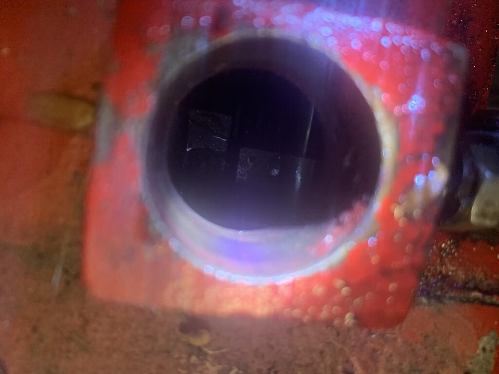

Scott from ontario 3 #21 Posted September 21, 2024 Not sure if you can see in the picture but that is how the shift rails end up and it locks itself up in two gears Share this post Link to post Share on other sites
Racinbob 13,192 #22 Posted September 21, 2024 It's hard to see but I'd say yup, locked in two gears. Use a screwdriver to line them up, reinstall the shifter and adjust. You'll be good to go........until the next time. I'd suggest doing the simple upgrade to really fix it. Share this post Link to post Share on other sites

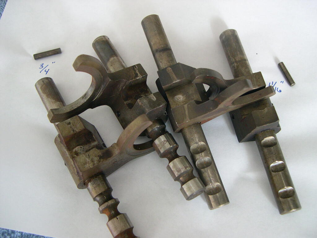

Scott from ontario 3 #24 Posted September 22, 2024 Would I just need the new updated shifter rails or do I need the pin that is posted in the picture was also wondering if the ball on the end of the shifter would make a difference if it was worn down? Share this post Link to post Share on other sites
Racinbob 13,192 #25 Posted September 22, 2024 (edited) 11 minutes ago, Scott from ontario said: Would I just need the new updated shifter rails or do I need the pin that is posted in the picture was also wondering if the ball on the end of the shifter would make a difference if it was worn down? Yes you'll need the updated rails with the deeper neutral detent. Don't be misled by the picture though. Some of the early upgraded rails had deeper neutral detents ground into them rather than going all the way around like the rails on the left. The difference in the two styles was simply a different manufacturing process. The detents don't need to go all the way around as the rails don't rotate. And yes, you'll need the longer stop pin (3/4") in order for the upgrade to be effective. The worn ball on the shifter isn't good but doesn't cause the issue. Edited September 22, 2024 by Racinbob Share this post Link to post Share on other sites
