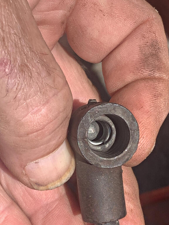

Only other odd thing I can see is that the  spark plug wire is rubber at the top of the boot and so the connection to the plug is the metal wrapped around the inside of the s.p. boot.
Is there a specific plug for this kind of boot.
Anything else I should be looking at?

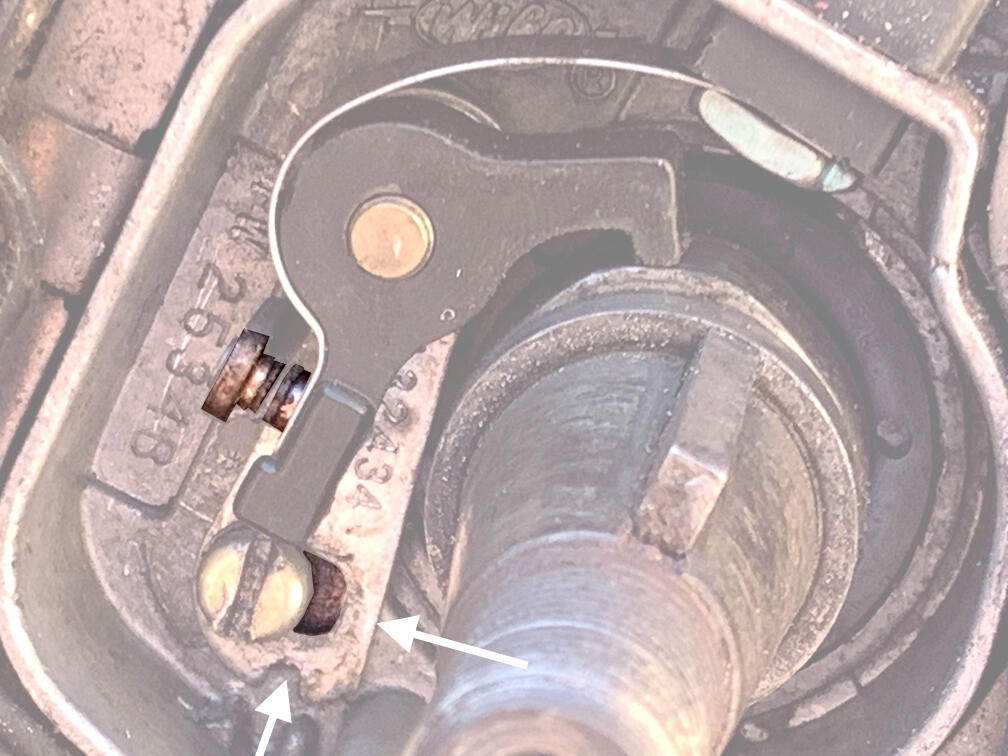

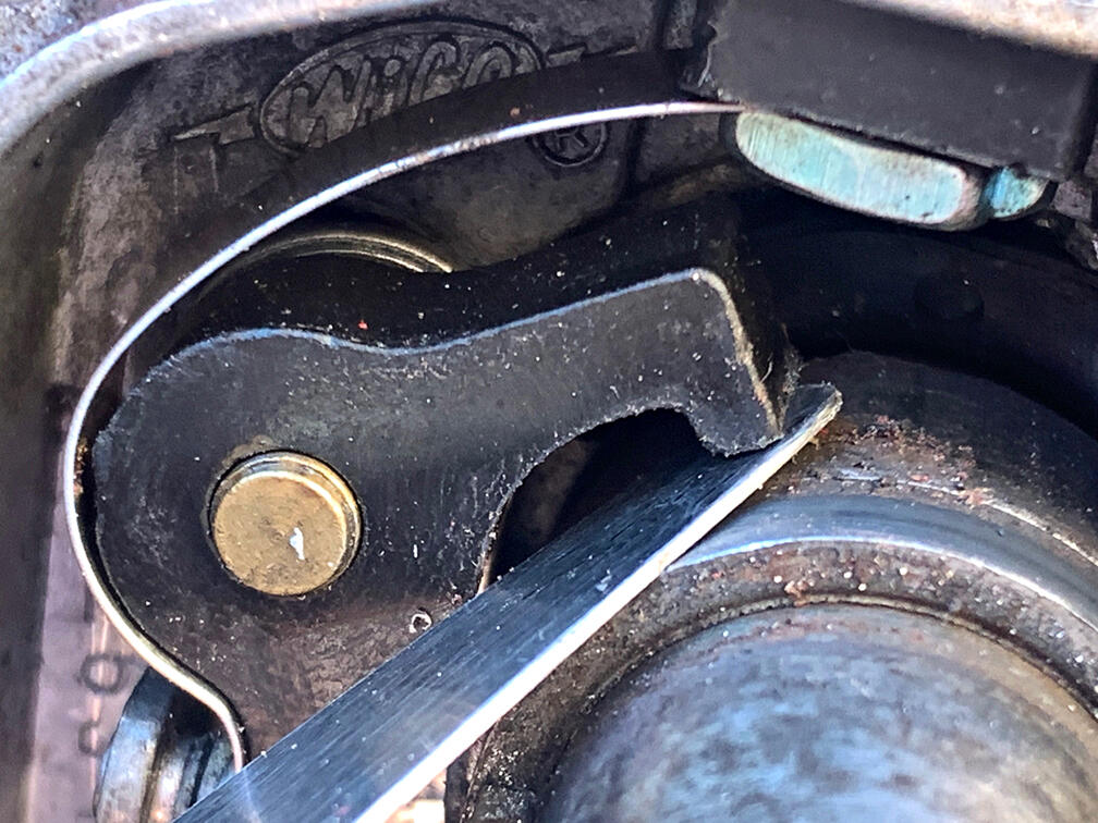

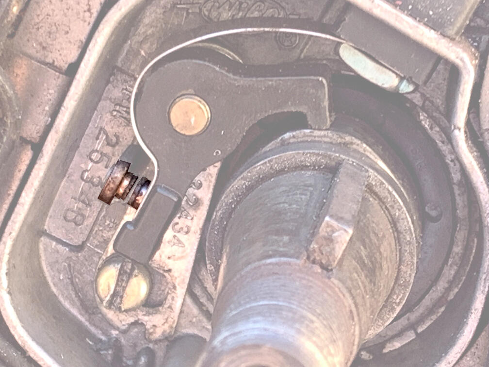

So the points definitely aren't opening to .020
What I have figured out is that there is a gap between the black armature and the flywheel shaft.
I can't see any way to adjust that.  Also can't figure out how to widen the gap to .020 when that arm is centered on the cam portion of the shaft.
Are these adjustments possible?

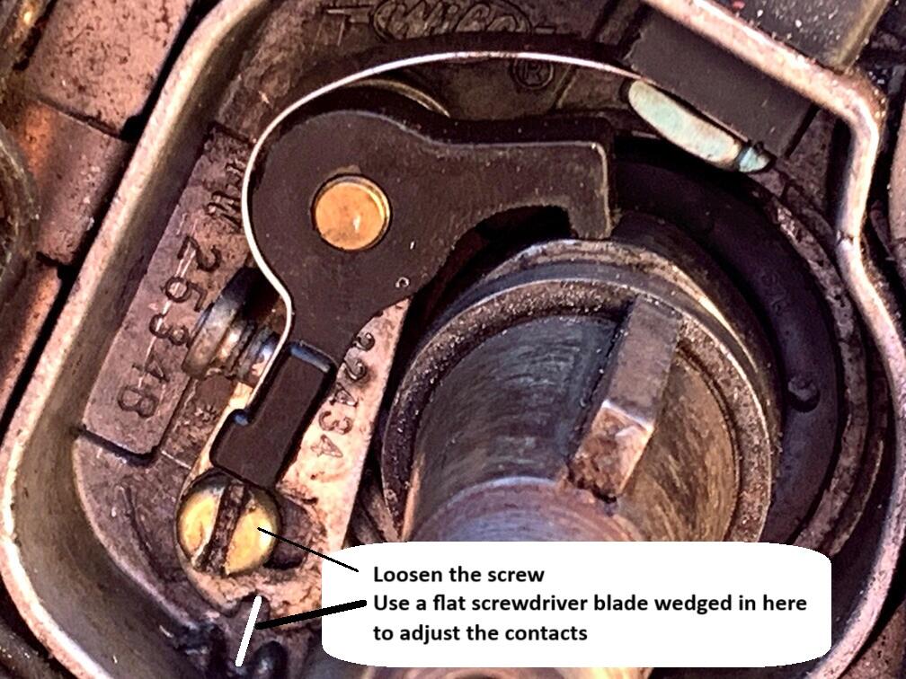

ri702bill
You just moght be looking in the wrong spot !!
The gap is adjusted with the single screw, with the rubbing block pad at the top of the cam lobe.... Loosen the screw and wiggle the bracket side to side to get the pionts to open .020. Next to the screw are 2 notches where a flat blade screwdriver when twisted will move the bracket WITH the screw not-quite snug...Set the gap, tighten the screw. Those points look to be beyond being usuable - time for a new set.....
wallfish
:text-yeahthat:  It only matters when that lobe is in contact with it. That's when the points open and what opens it. Those contact surfaces need to be clean in order to make contact. Even new points too as they are coated so they don't oxidize in the package.

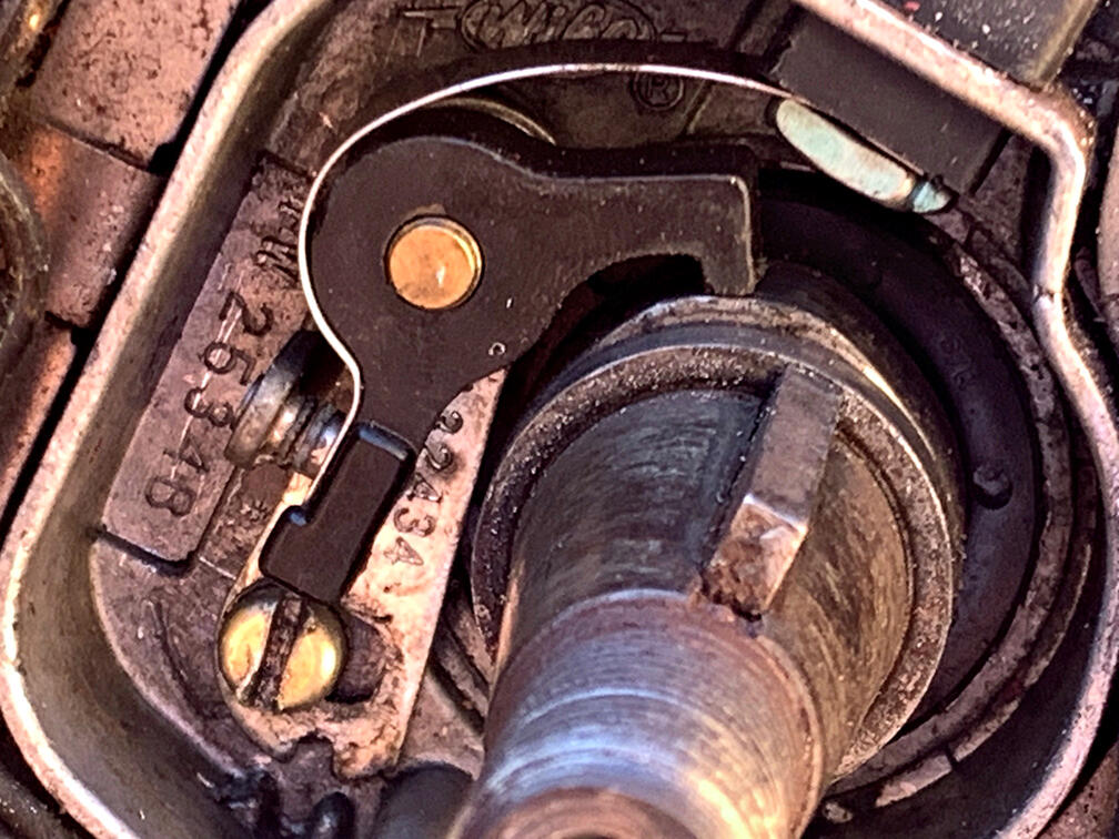

jsp_333
SPARK!   -  turning the flywheel by hand no less.
I was able to adjust the points as described by wallfish & ri702bill  BUT not until I moved the cam so the points were in the closed position.
I then tweaked  by loosening the screw and moving the  adjustment lever to the right. Now when the cam opens the points the gap is .020
Still going to get new points especially after seeing Packrats excellent video & technique for setting magneto timing.
