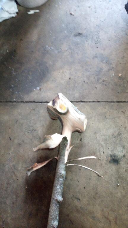

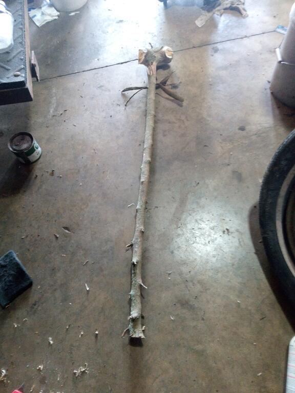

ohiofarmer 3,525 #1 Posted August 27, 2024 The history of the shillelagh is when the Brits conquered the Irish. The people were prohibited from carrying weapons and the home made stick canes made from blackthorn bushes became the go to defense tool. After back surgery and limited recovery, I noticed that I was using tree trimmings for support while cleaning up cut brush. I decided to peel the bark off and experiment with the leftovers,and gradually some sort of skill set developed. The early ones had massive shrink cracks, and would not take stain or finish well. But I pretty much have that behind me. My latest stick canes have a very deep finish that is clear coated with water based polyurethane . I need to try linseed oil as well. Here's a picture of a roughed out blank with a substantial head basher potential. 1 1 Share this post Link to post Share on other sites

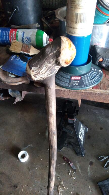

ohiofarmer 3,525 #2 Posted August 27, 2024 The stick laid on the ground for a time as they must to keep from cracking. The worms got in under the bark, which is a cool thing to me. They left tunnels behind. The bark is stripped at this point, but another layer remains in spots the worms were active 2 Share this post Link to post Share on other sites

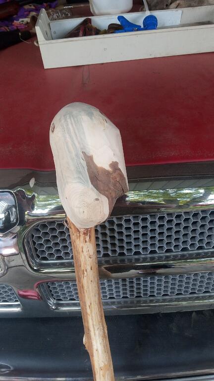

ohiofarmer 3,525 #3 Posted August 27, 2024 Here is the head after being through the radial arm saw to rough shape. The bark came off pretty nice 1 Share this post Link to post Share on other sites

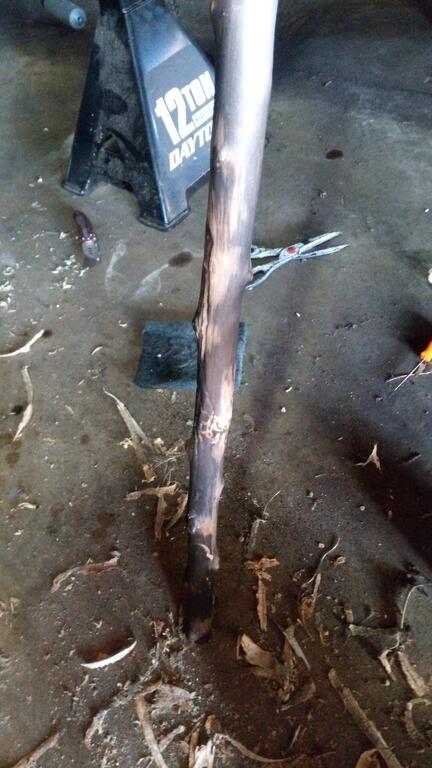

ohiofarmer 3,525 #4 Posted August 27, 2024 (edited) As you can see, the worms had a little fun under the bark The shaft of the cane has had it first chemical sanding as well as taking a bit if color. I applied varnish to the ends to prevent checking. When you view the big end head on, it is the shape of a rattlesnake head . I'm going to contact a friend to see if he will carve the face of a rattlesnake on it It's coming along with deep coloring treatment and sanding through the stuff to highlight the worm damage. I found that the worm tunnels can be left in the white or if they turn black, sand around them for a photo negative effect. That's all for now Edited August 27, 2024 by ohiofarmer 4 Share this post Link to post Share on other sites

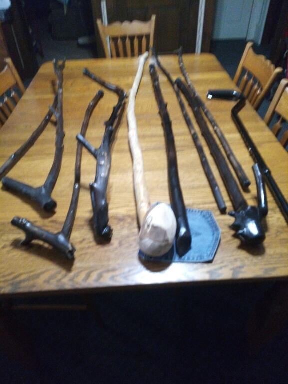

ohiofarmer 3,525 #10 Posted August 27, 2024 This egg shaped head is the more traditional shape of a shillaligh. It's harder to find the bush or tree that permits harvesting. This happens to be from an evergreen and is walking stick length . The reason I think sticks make such good canes is that leaving each one in it's natural shape means all the fibers of the plant are lined up straight and they can be very strong for their size and weight.. The ones that are bent do flex somewhat. Also the taper saves wright with even a taper to 5/8th at the top being plenty strong. As you can see, patience can produce a very dark finish ,but I like to sand or even wet sand through at places because the layer just beneath the grainy living layer can produce a glowing golden layer that looks amazing in the sun. Not all these canes are usable shapes, but even the wildly bent ones can be made into cudgels. My wife's metal cane is on the right for size reference The Blackthorn ones from Ireland have an asking price of more than a hundred dollars . Pretty stiff money for a crude one with the bark left on. We were at a family reunion a few weeks ago and a cousin really liked what I had. She wants a nicely finished mushroom stick tall enough to rest her chin on to keep her head perfectly still. Those are easy. I usually let the T handle ones too long on the handle as they may crack or check at the end. They get cut down after they dry out slowly. 2 Share this post Link to post Share on other sites
