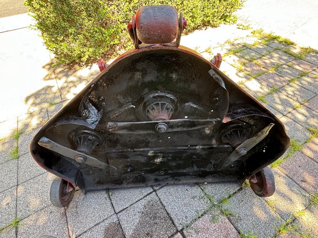

JimSraj 583 #1 Posted August 26, 2024 (edited) Earlier this year I bought a 1991, original owner, 312-8 with a 42” deck. Except for leaking axle seal the tractor and deck seem to be I good condition. The only problem I’m having is the cut quality of the deck. I mow in 2nd gear at full throttle. The cut is leaving strips of poorly cut grass between the blades. I’ve tried using 1st gear and the cut improves some but not much. I know the blades are after market but they measure(diagonally) at 13-13/16” which I think is darn close to what OEM blades were. Oh yeah, it’s a side discharge. Anyone have suggestions? Thanks in advance. Edited August 26, 2024 by JimSraj Share this post Link to post Share on other sites

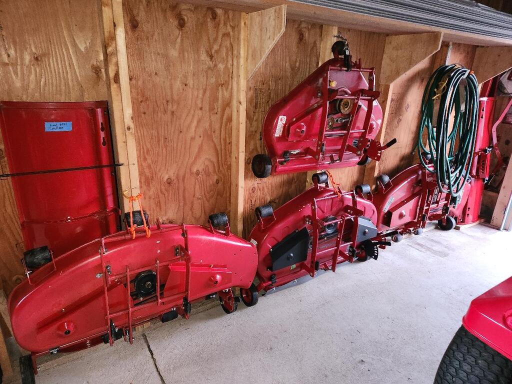

peter lena 9,993 #9 Posted August 27, 2024 @Lane Ranger agree with you on the deck detailing , been at that for years , all my transitions have come from , REPEDITIVE ISSUES , thats just a regular thing for me , basically find out what works , change it , BTW , made up some 5 /16 steel rod S HOOKS about 6-8" long , hook that into a firm extension spring , screw in eye bolt to wall , makes end of season hold up easy , hook it into deck lift frame , chock up wheels , deck facing out to you , lets you verify what that oil soaking is doing . like a small fine file for blade touch up , break the grunge cycle , pete 1 Share this post Link to post Share on other sites
Brockport Bill 2,449 #10 Posted August 27, 2024 2 hours ago, peter lena said: @Lane Ranger agree with you on the deck detailing , been at that for years , all my transitions have come from , REPEDITIVE ISSUES , thats just a regular thing for me , basically find out what works , change it , BTW , made up some 5 /16 steel rod S HOOKS about 6-8" long , hook that into a firm extension spring , screw in eye bolt to wall , makes end of season hold up easy , hook it into deck lift frame , chock up wheels , deck facing out to you , lets you verify what that oil soaking is doing . like a small fine file for blade touch up , break the grunge cycle , pete Pete always has terrific ideas and suggestions 1 1 Share this post Link to post Share on other sites
pfrederi 20,997 #11 Posted August 28, 2024 Nice picture who picked up the RD hanging up high. Don't want to get in an argument with that guy. My old shoulders aren't going to tolerate that kind of lifting.. 1 Share this post Link to post Share on other sites
Brockport Bill 2,449 #12 Posted August 28, 2024 51 minutes ago, pfrederi said: Nice picture who picked up the RD hanging up high. Don't want to get in an argument with that guy. My old shoulders aren't going to tolerate that kind of lifting.. i have stubbornly adjusted to being much more careful and cautious in my senior years of how i move and lift items -- when we all grow up in active or athletic early years its hard to accept father time -- but i have had to realize they are just so many cortisone shots i can reasonably get - - haha --------- in the case of that mower on the wall i smartly asked my wife for help as was the case the other day with another lifted item -- so just having to learn to be humble - - of course she like may partners are usually very supportive but that doesn't mean we all don't get occasional frowns 1 1 Share this post Link to post Share on other sites
Ed Kennell 46,798 #13 Posted August 28, 2024 (edited) 1 hour ago, Brockport Bill said: -- in the case of that mower on the wall i smartly asked my wife for help as was the case the other day with another lifted item Lucky you that has a wife that can lift heavy items while you tie them to the wall. Edited August 28, 2024 by Ed Kennell 2 3 Share this post Link to post Share on other sites

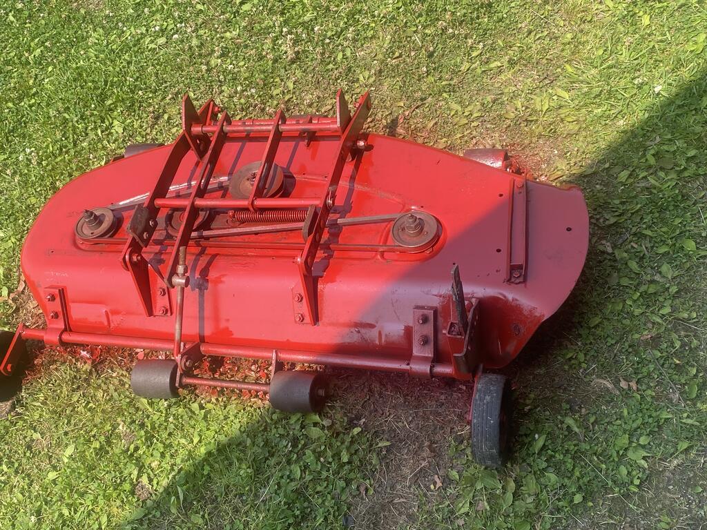

JimSraj 583 #15 Posted August 31, 2024 So I took the deck off today and had a good look at the top side. The idler bar shows some wear at the slide points although the nylons are in decent shape. It can be rocked side to side a little. All of the spindles spin freely and are quiet. I decided to replace the deck belt and the PTO belt. I’m kind of embarrassed to say, Big improvement in cut. Still leaving slightly higher grass between the center and the blade on the discharge side blade. Next timeI sharpen the blades I’ll check to see if one is bent. As I was cleaning the underside I wondered if the shape of the spindle housings and the cast aluminum body is to help cool the bearings. They sure catch and hold a lot of clippings. 1 Share this post Link to post Share on other sites
