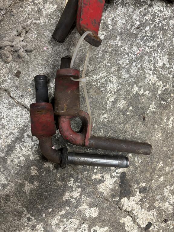

fourwheelhorseman 359 #1 Posted August 23, 2024 I bought these off a local fella last week. They look like they will fit my 160, same shaft diameter, unsure of the length of the ones that are currently on my 160. I have one single spindle and it’s about 1/4 inch shorter than my others, the single one also has c clips that hold in both ends. The one with the gussets has a c lip for the top and a bolt for the wheel side. I’m hoping they will work for my 160 or I’ll have to keep looking and sell the ones I got. Anyhow, any ID or thoughts? 2 Share this post Link to post Share on other sites
ebinmaine 77,016 #2 Posted August 23, 2024 The ones with the gusset are 80s optional HD for loaders or dual stage snowblowers. If the WHEEL SIDE of the spindle is the same length as your own then they'll work fine. Or.... Get a set of 80s wheels. 2 Share this post Link to post Share on other sites
fourwheelhorseman 359 #3 Posted August 23, 2024 14 minutes ago, ebinmaine said: The ones with the gusset are 80s optional HD for loaders or dual stage snowblowers. If the WHEEL SIDE of the spindle is the same length as your own then they'll work fine. Or.... Get a set of 80s wheels. I had suspected as much. I’m doing a valve on the tractor tomorrow, if I get time I’ll jack the front end up and pull the front axles and see what I’ve got. 1 Share this post Link to post Share on other sites
pfrederi 19,740 #4 Posted August 23, 2024 Wheel horse used Cotter pins E clips and bolts at various times to hold the wheel on.. Clean the up any one should work. 2 Share this post Link to post Share on other sites
ebinmaine 77,016 #5 Posted August 24, 2024 11 hours ago, fourwheelhorseman said: I’ll jack the front end up and pull the front axles and see what I’ve got. If the HD spindles are a little longer just toss a few washers on the shaft between the inside of the wheel and the gusset. Those are substantially stronger. 2 Share this post Link to post Share on other sites
fourwheelhorseman 359 #6 Posted August 24, 2024 45 minutes ago, ebinmaine said: If the HD spindles are a little longer just toss a few washers on the shaft between the inside of the wheel and the gusset. Those are substantially stronger. I had planned on that, thanks! 1 Share this post Link to post Share on other sites
fourwheelhorseman 359 #7 Posted August 24, 2024 I had never seen the gussets on the normal sized spindle before.. I wonder if they’re for a 520 or a newer tractor? 1 Share this post Link to post Share on other sites
ebinmaine 77,016 #8 Posted August 24, 2024 1 minute ago, fourwheelhorseman said: I had never seen the gussets on the normal sized spindle before.. I wonder if they’re for a 520 or a newer tractor? Not a 520 because they had larger size spindles. I have a C121 and had a 417A with the gusseted ones. The C121 had a loader at one point. I know they were an optional dealer purchase but I'm not sure if they were ever "Standard Equipment" on any models. @JCM ? Share this post Link to post Share on other sites
